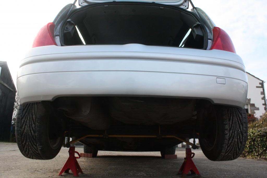

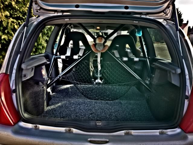

Fitted my anti roll bar and half cage

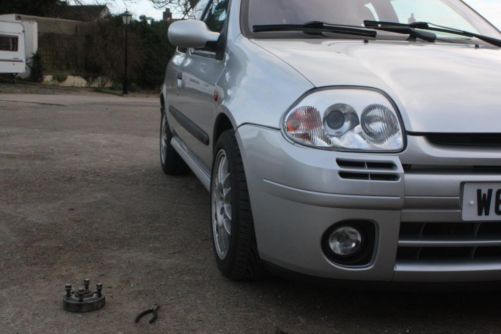

30mm spacers on the front
Before
After

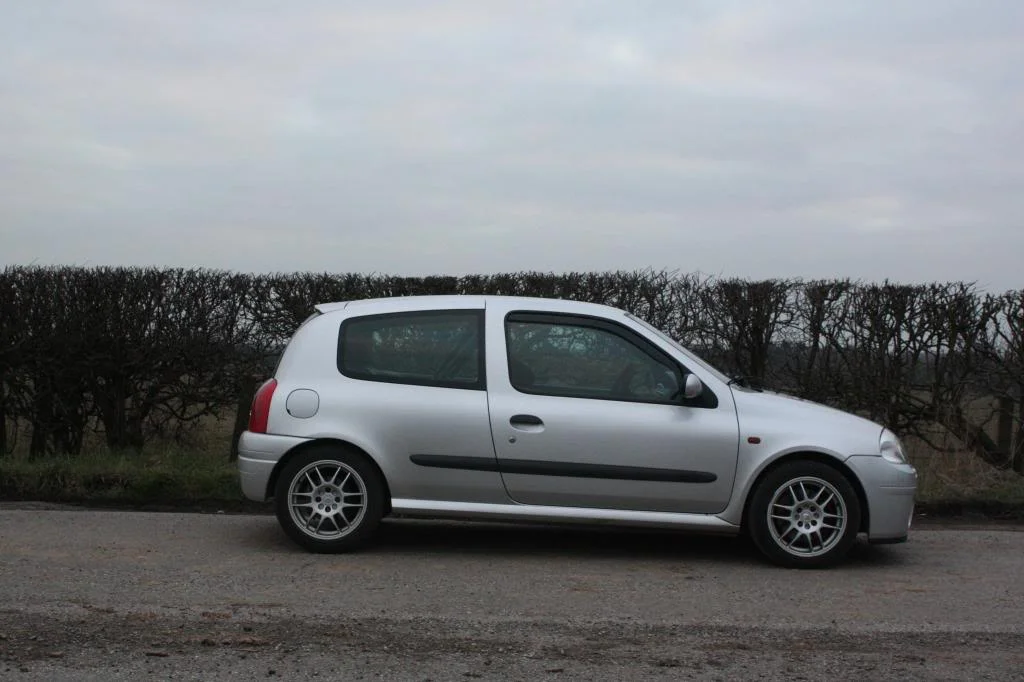

Its been a while so i thought i would update my thread

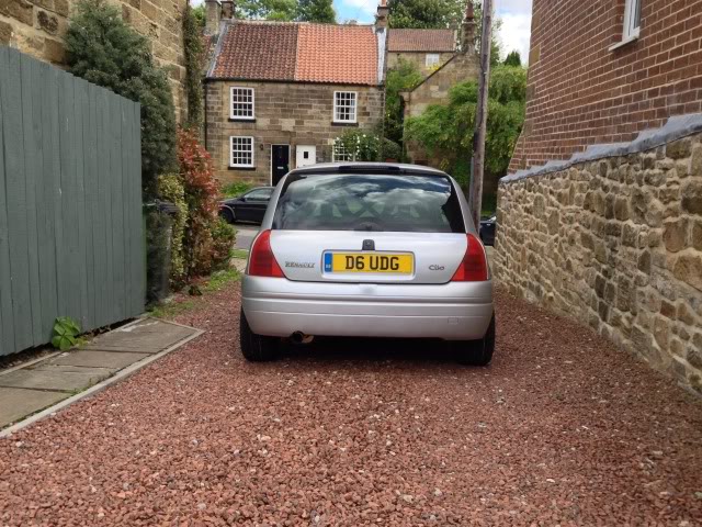

-20mm's rear spacers, sits lovely now (30mm's on the front)

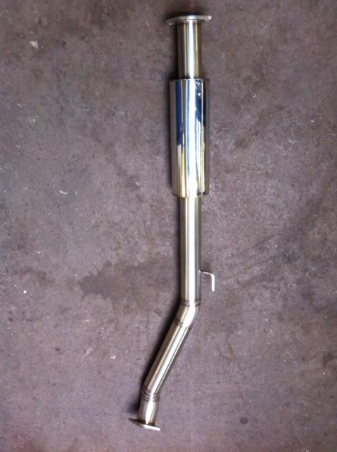

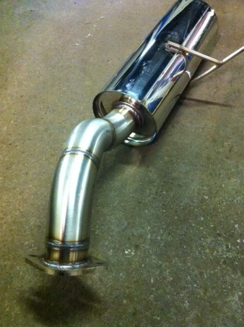

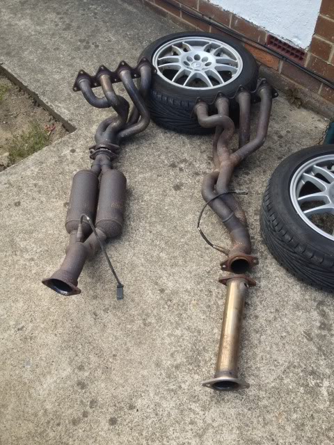

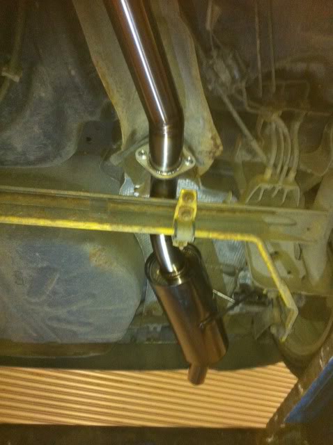

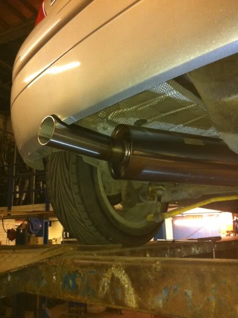

-Fitted my 182 manifold, poly bushed dogbone and decat and also got a friend of mine to fabricate a centre section and back box Pea shooter style and i love it

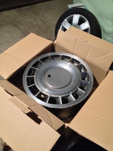

I love the look of ph1's however fancied a different set of wheels, had some Borbet A's but they need adaptors to fit.
However managed to source some of these complete with original centre caps :D

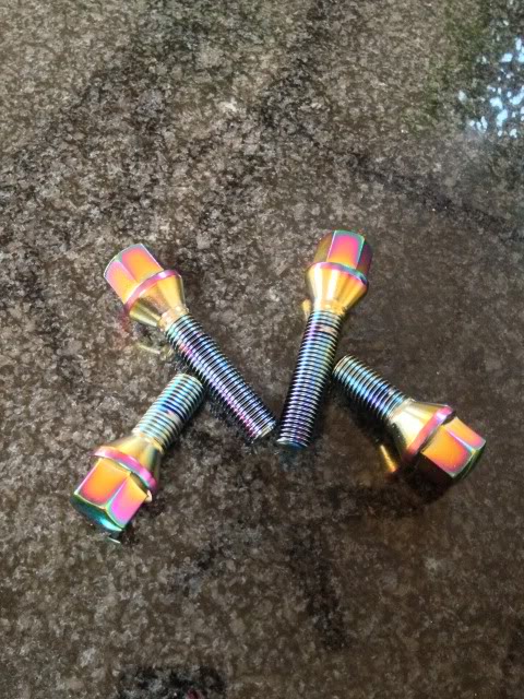

Got some lovely bolts too and locking b*****d's

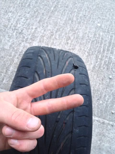

Started a new job this week, got a puncture and replaced my lower ball joints.

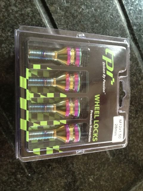

I know the centre caps are a must however i just bought a full set of TPI locking wheel nuts and bolts and wanted to show them off however there is no point now with the centre caps on.

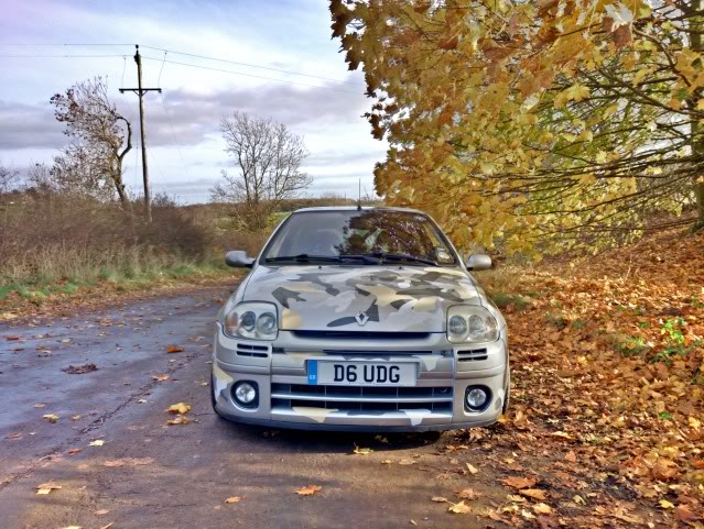

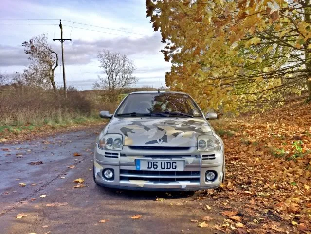

I have not posted pictures of the Camo in the project thread but having been adding little bits here and there, finished the roof off and added more to the boot, all in all it looks different and i am slightly regretting doing it as i loved the look when it was OEM silver but i will keep it on as hopefully when i get back from holiday to South Africa for a Month a week tomorrow it will have snowed and i can get a good shoot in some snow drifts so the camo will look right at home i hope. Next year i will be removing the AC, sourcing some cams, New ARP Rod bolts, dephaser, belts, Engine/ Gbox uprated mounts and PMS top mount and strut brace kit also very tempted buy the uprated gear linkage set up they offer but will have to see how the cash monies are nearer the time.
Hope some people like the look of it.

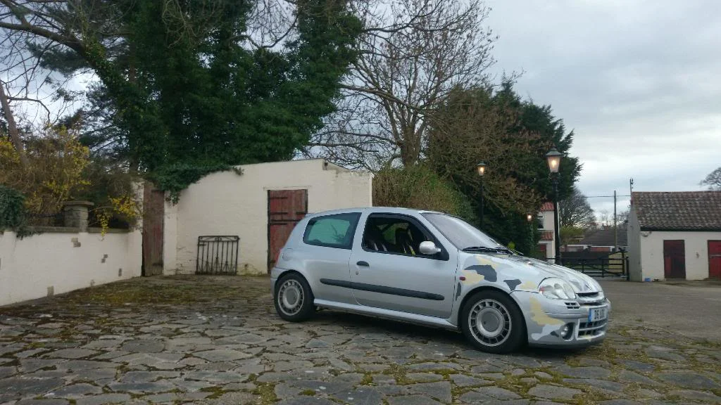

Re: Coco - Camo Ph1 soon to be ITB & Cammed

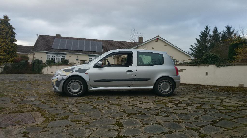

Not much has changed really with the clio.

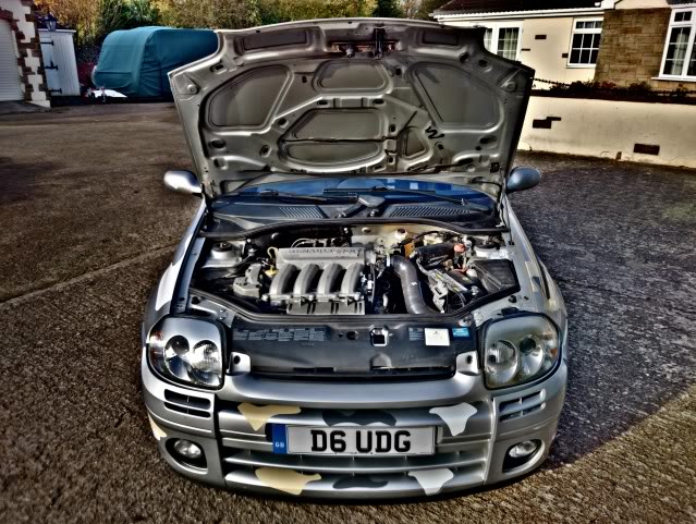

Decided to take the camo off however after doing the spoiler, bootlid, rear bumper, both back quarters and doors i decided to call it a day as my fingers were in tatters. They did come off much easier than i thought they would which was rather good.
I have purchased some hammerite so i can underseal her properly.

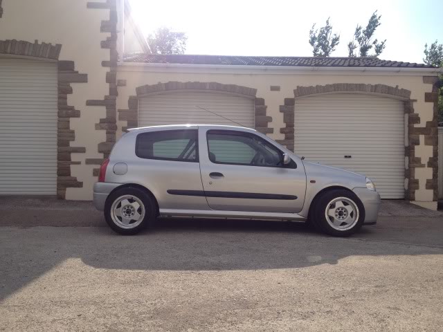

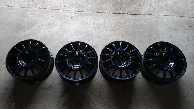

Also got some new 15's for her at a bargin price along with 2 look a like OZ F1's but multi fitment which i am going to fit a set of R888's on which i got cheap.

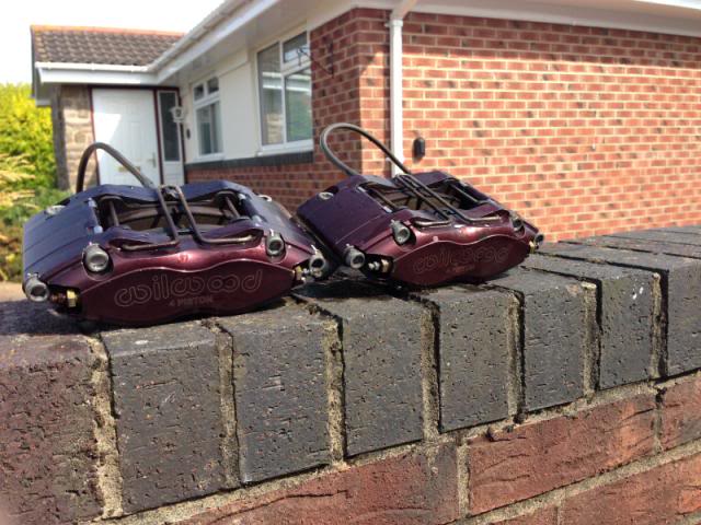

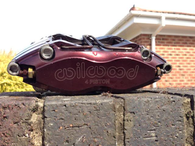

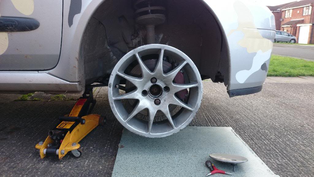

Here is a cheeky photo showing off her lovely brakes that are currently being hidden by the turbines, but other things have priority at the moment. They do need a good refurb but all are straight and there is only one with a nasty curb on the outside lip. But should look lovely with the TPI anodised wheel bolts i have still to fit.

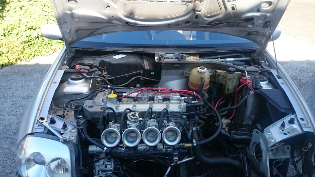

So now onto the engine side,
I have set myself a target to get all the engine work done for the Malton Big breakfast run (20th April)
The plans are to take the engine out so I can remove the aircon system, and fit the cup alternator setup i have and give the bay a good clean, Still undecided on whether or not the relocate my battery to under the driver/ passenger seat as i am always throwing the dogs, bmx and other things in the back so want it out of the way completely.

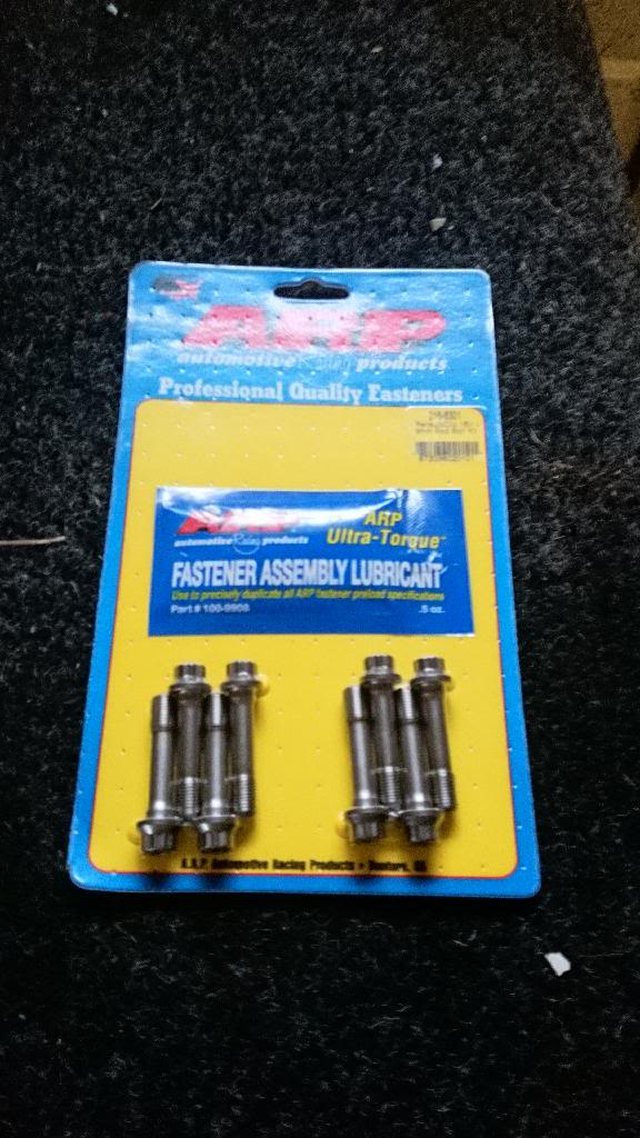

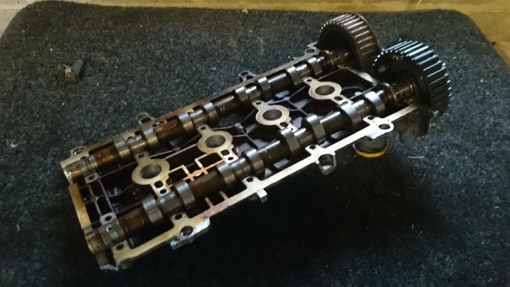

Andyrg is fitting the new belts, dephaser, rod bolts, 172 cams reprofiled by piper cams and once i have refitted the engine along with the ITBS he is collecting coco up and taking her to get mapped on the Gen90 ECU i got for her for just before christmas.
172 cams to get reprofiled by Piper.

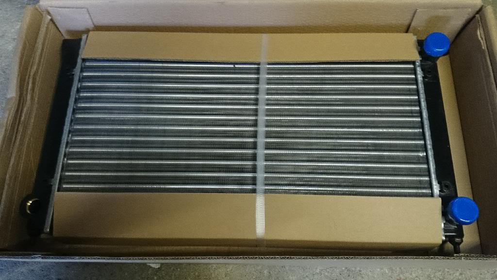

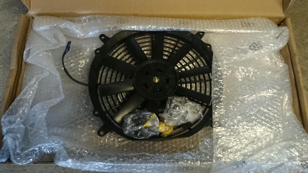

New radiator and fan

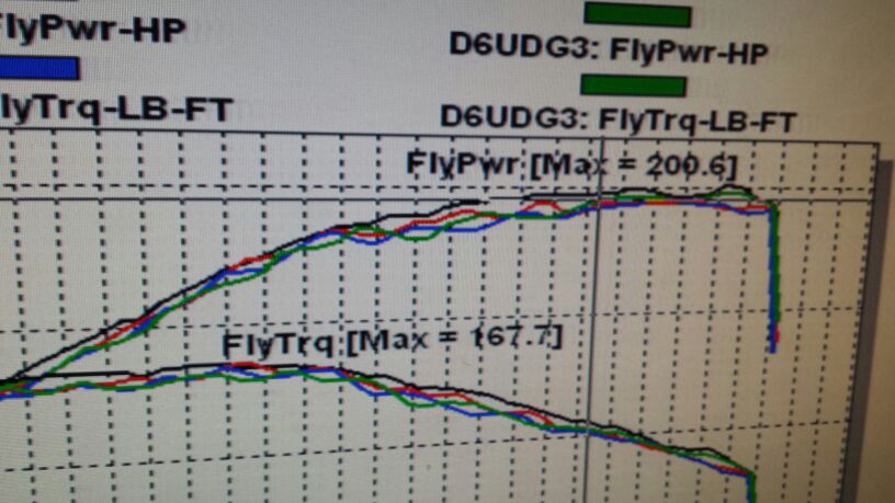

I will leave these here.....
Turbines will be going up for sale.
And the money shot, just getting mapped at EFI today as we speak...................
gudger12345
  Ph1 172
Finished mapping at EFI

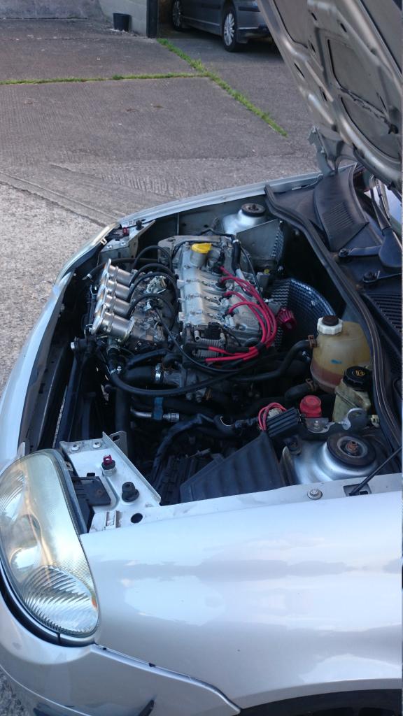

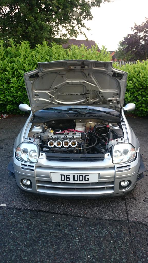

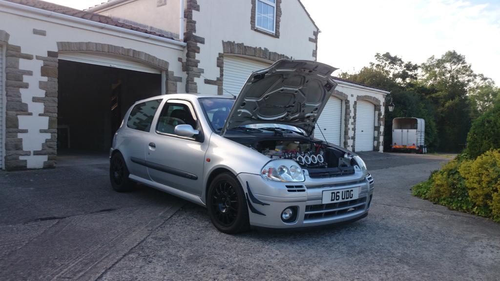

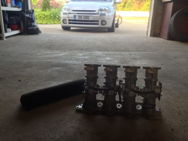

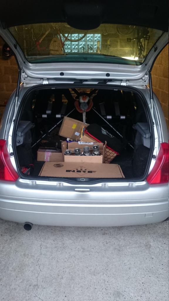

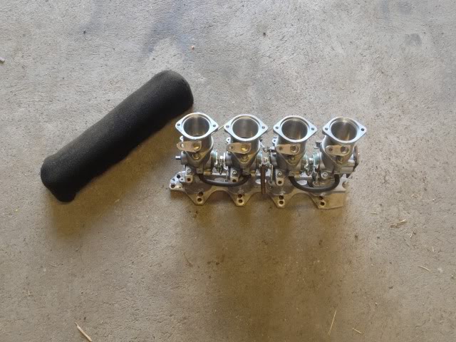

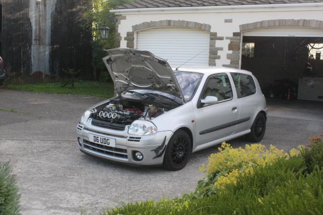

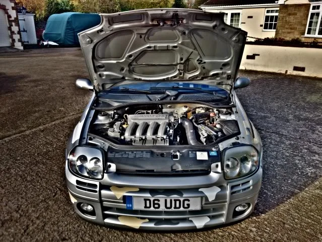

Well its been a while since i collected the car from clioturbo.co.uk so thought i should do a proper right up.
How she went full of all the bits and pieces required (Cams, ITB's, Cup alt setup, rad and other bits)
All dropped off at Andy Greer's, whilst i went to Ibiza for a week :cool:
Got a few messages from Andy asking about who had previously done the timing belt as it was not timed up correctly, however that could of been due to the dephaser as i had known that it needed replacing.

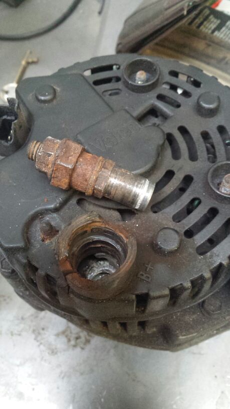

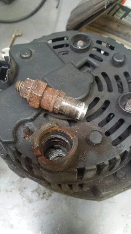

Also purchased a second hand alternator setup with pipes however the alternator had seen better days, so i purchased another through Andy the gentlemen.

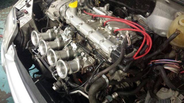

I then received these pictures and the video from Andy whilst in the airport departure lounge in Ibiza.
A friend gave me a lift through to collect the car on the night.
Andy had done a really good job, in fitting everything as the actual throttle bodies are not for a Clio 172 (F4R), however these particular ITB's have been previously fitted to Korky and Jon R's ph1's.
How i collected her after a week away from one another.
There has been some small issues that had to be sorted out but Andy has been awesome in helping me rectify them. The problems were that the speedo did not work but that just needed a new speedo drive. Whilst i was away he asked if i wanted pops and bangs mapped to the car at EFI which i stupidly agreed to.
I Hate them!!!!
However as the car is running adaptronic Andy just uploaded the map that had no bangs on which has in my eyes transformed the car for when i drive through towns and villages. Don't scare school kids on the way to school in the morning, she does still pop etr however only when giving her a bit of grief.
Full economy has improved massively as well.
Outside ClioTurbo HQ
I would like to say a huge thanks to Andy Greer at Clioturbo for all his help after the work he has carried out on my car. His input and dedication to Renault cars is visible and the face he is willing to help you when he can is a god send.
Thank you to Chris at EFI for balancing and mapping the car. it drives so well in all gears and has no problems with cold starts, just starts to get a bit hot when stood in traffic however the radiator which i purchased is not good and i plan to invest in a custom alloy one soon.

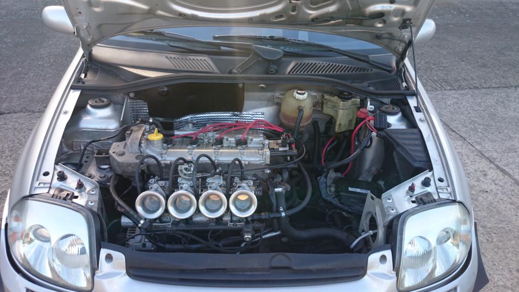

Now i had a few things to carry out myself.

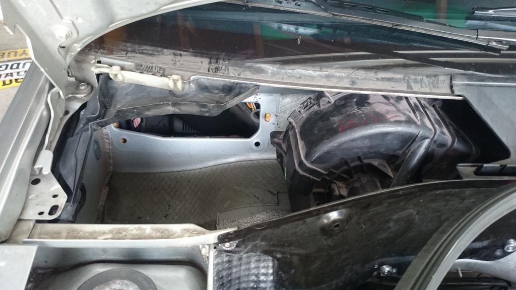

Removed the rest of the aircon and fitted a cup fan blower, the A/C parts weigh so much when i compared it to the cup items.
Cut a numberplate to fit the gap and jobs a gooden, will get a ph1 non ac clio bulkhead cover when i get time to go to the local scrappy.

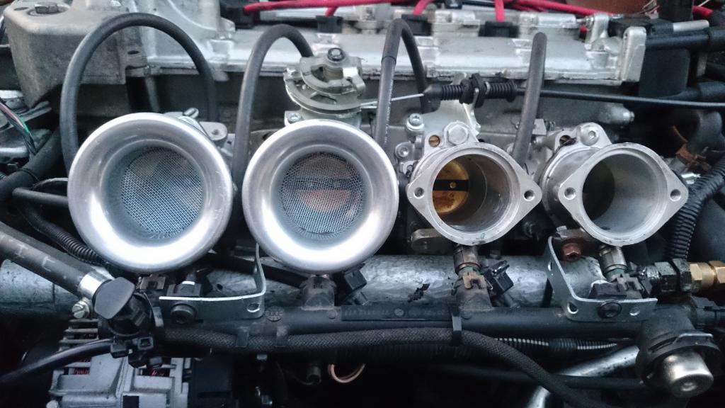

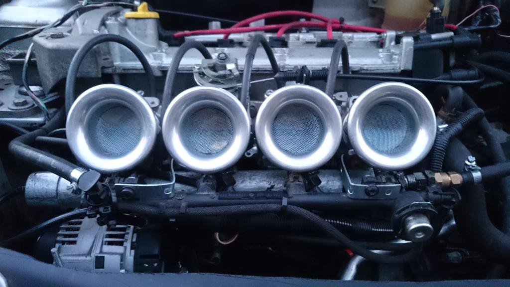

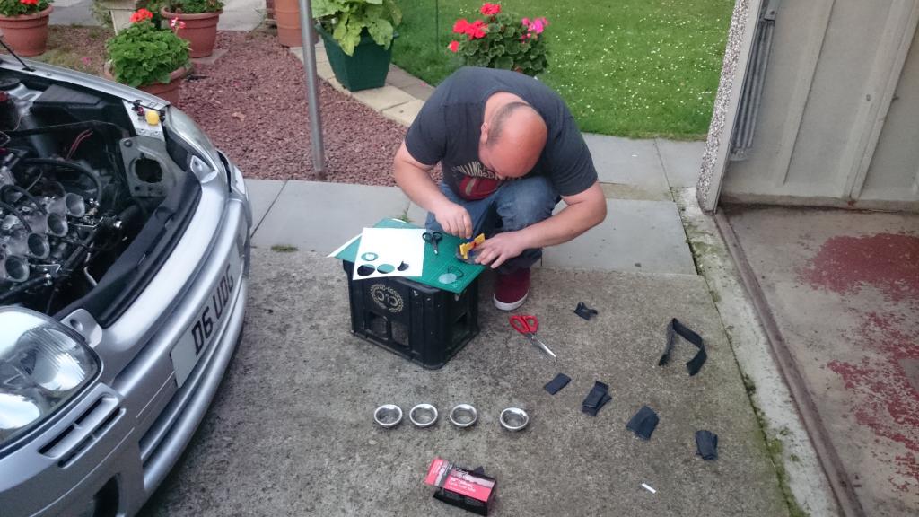

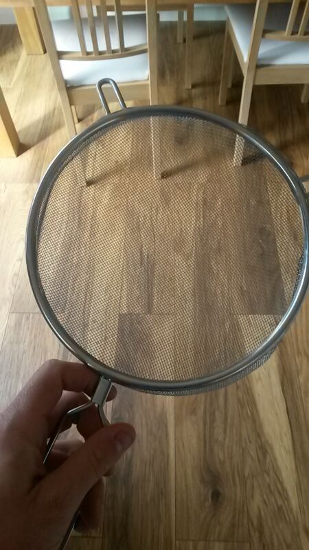

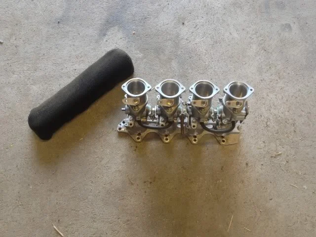

I had to make a filter for each of the throttle bodies as the injectors are in front of the butterfly valve not behind, they literally only just fit under the bonnet.
So decided to use the same method adopted in my mates Almeria GTI's (Nissan Factory Standard) and its worked a trick, only cost me £2's.
Involved 1 of these.
And a bike inner tube.
Me and my friend made rubber gaskets with the inner tubes and cut the metal sieve to size to make metal filters to stop all the naughties getting in.
Half way through, brew time.

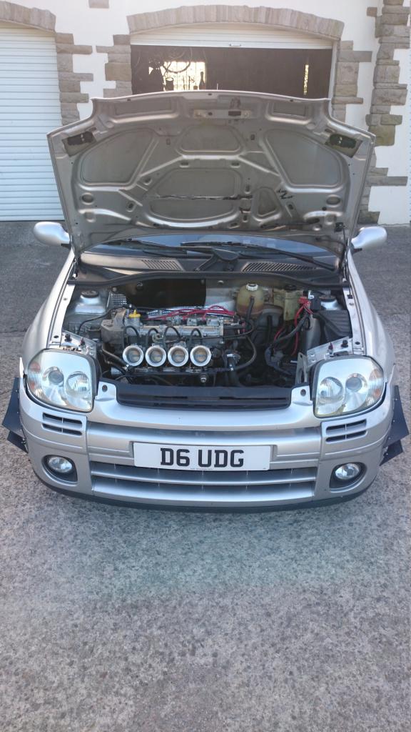

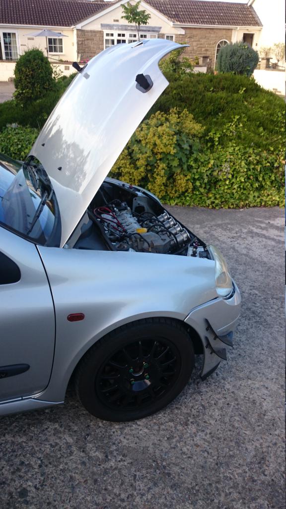

I have been tidying all the wires up in the bay and mounting everything correctly and it looks so much better.

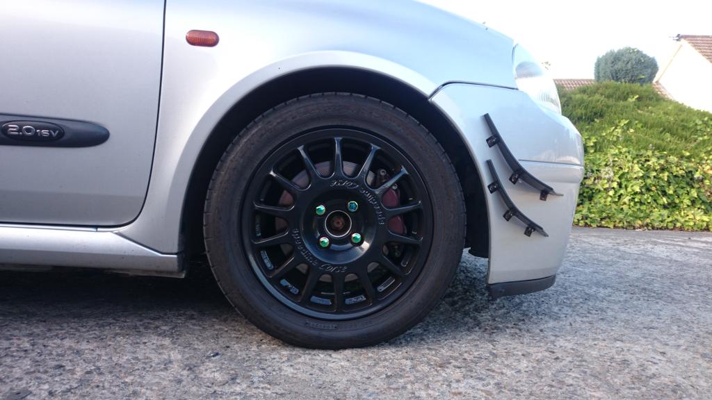

Thats how she stands at the moment, also got the Speedline Corse fitted and finally can show off the lovely willwoods.
Thanks for looking.
Here are some pictures.

How have you secured the mesh in the trumpets?
Looks good, underside of the bonnet could do with a clean thougj ;)
Mr R.
  A special one.
Little bit of a warning, ive seen this type of mesh break up with age.
Keep an eye on it.
