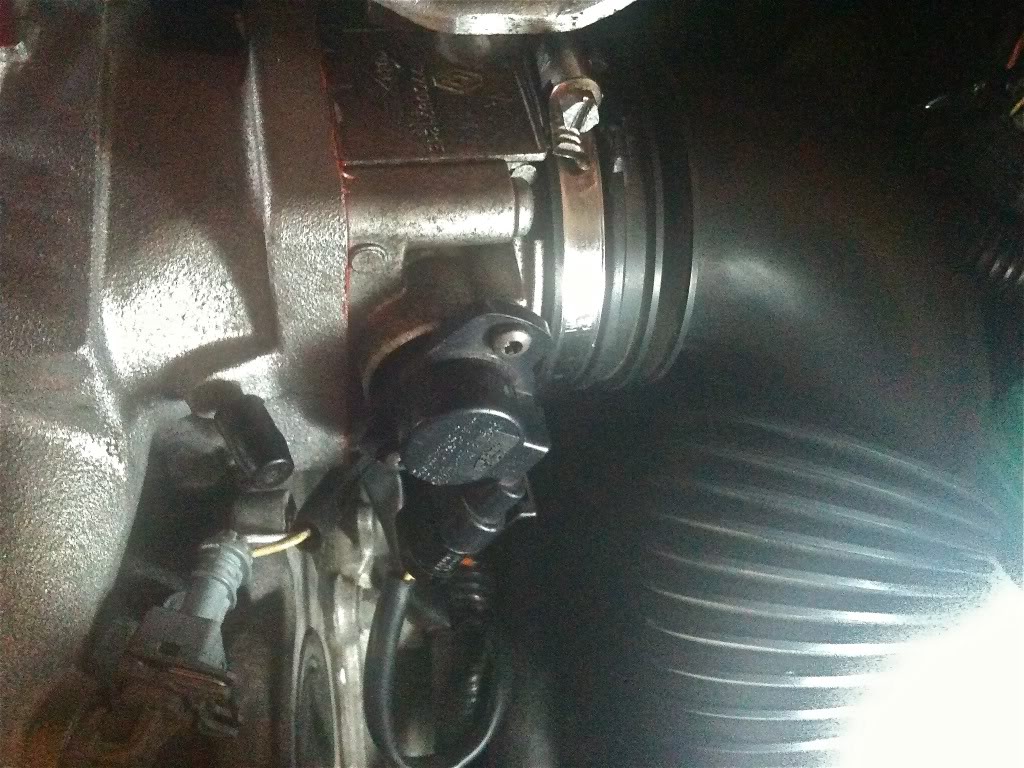

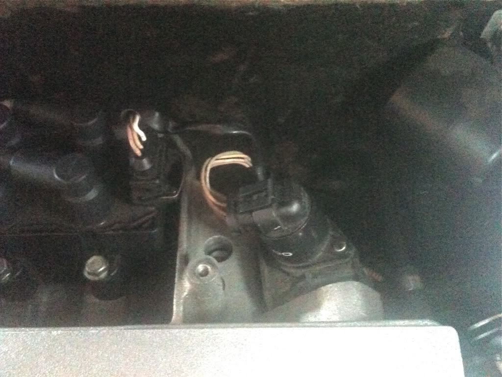

So from research, I think it may be one of the following..
The ICV pictured here:
or the TPS here:

This Idle valve is breakdown.But I found that it saw the first video(Thortle is teases )
First you will buy new Idle valve and after control

Personaly i'd try to clean the icv first, take it off, spray some wd40 in it and then try and clean it out with a cotton bud or something, thats what i did with mine, got loads of oil and gunk out of it, helped a bit but mine wasnt anywhere near as bad as yours from the looks of it, would just die occasionally

well, I cleaned it, it made a slight difference for the better, but looks like I am going to have to get another one. Got quoted around £190 for it here :(

I have had many idling problems with my ph1 172 and the best fix overall was a replacement throttle body (and replacement cable). There isn't a sensor under the pedal on ph1's. I tried three second hand TBs before I got a good one and it's made a massive difference in terms of idle and smoothness. If the ICV is malfunctioning the car will stall. If it revs higher than it should it is the TB or an air leak on the manifold. For rough idling I fixed it by changing the lamdba (oxygen) sensor on the exhaust. TPS seem to me to be bullet proof so not a likely problem on a ph1. I'd bet the issue is your TB - they need to feel really smooth via the pedal.

to check for air leaks, you could spray some brake cleaner on the inlet! manifold and check if the idle gets better. but personally i would check the TB and TB cable!
