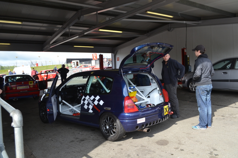

Arrived about 7pm Fri evening, set up next to Ian had a bit of a chat with a few people, a few beers, and a few laughs, the paddock was a very friendly place as usual. All was well with the world so we went to bed excited for the racing tomorrow.
Scruteneening
This is the first time the car has gone through scrutineering without a single issue, I guess we must be learning. The chap even commented how tidy everything was, he gave me a ticket and sent us on our way. I was very happy.

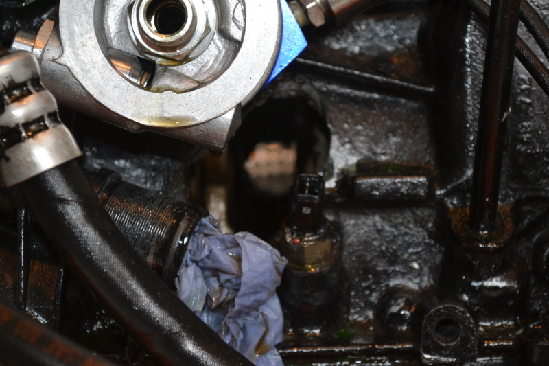

Ooo a big hole in the block, that's not supposed to be there!

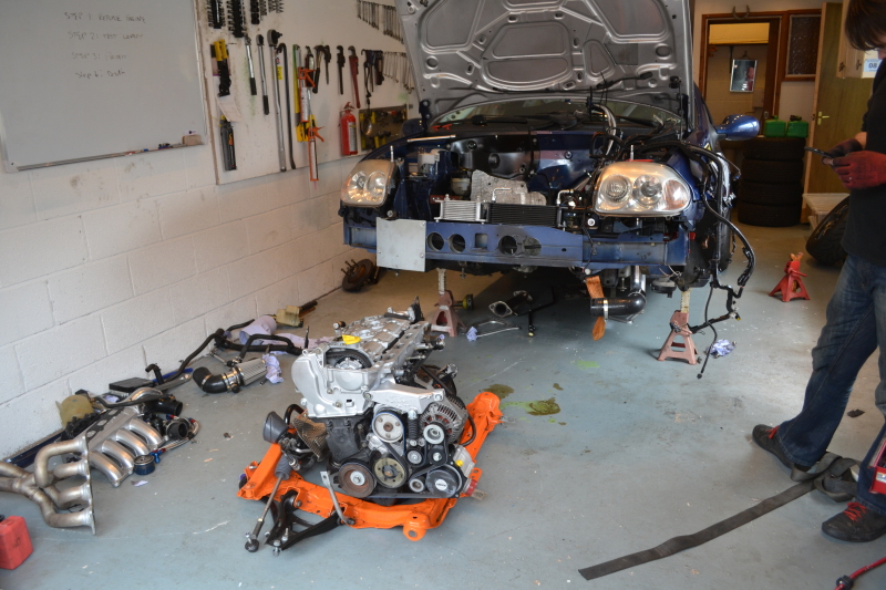

Sunday morning inspection

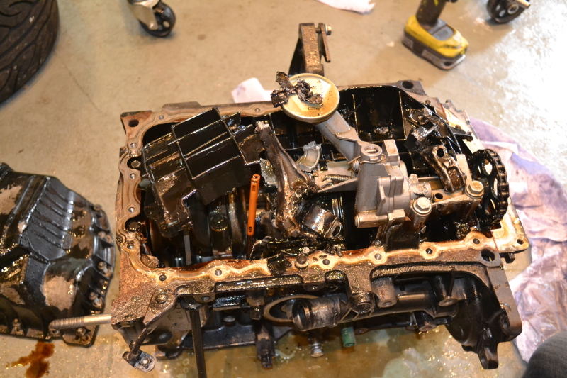

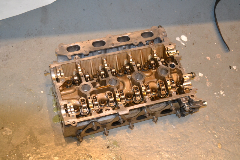

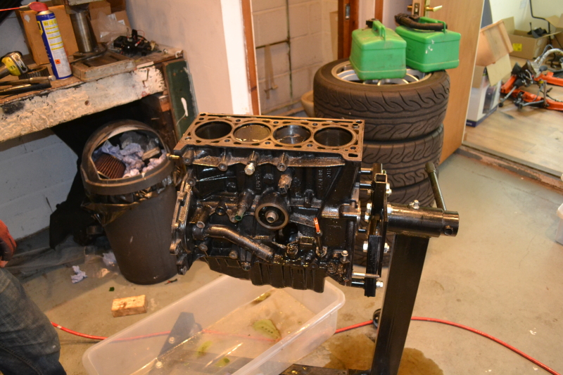

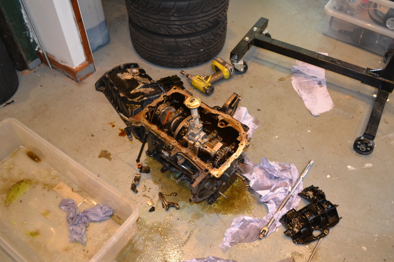

So this morning at about 10am we started to take the engine out.
All out by lunch time.

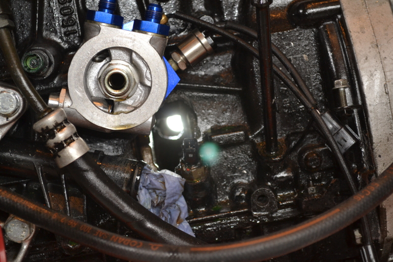

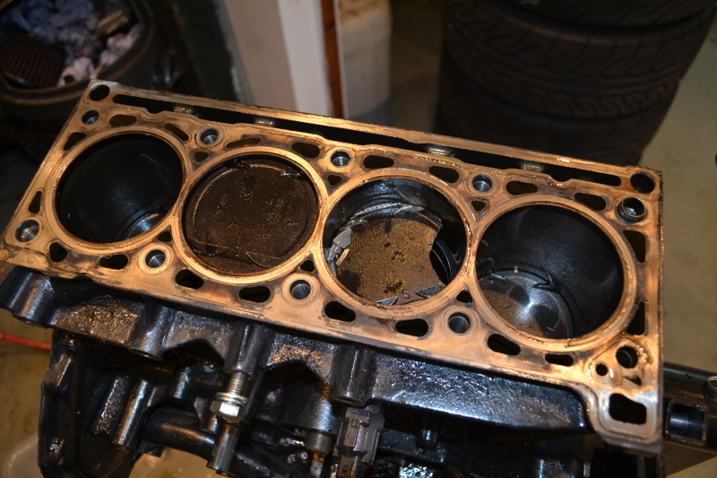

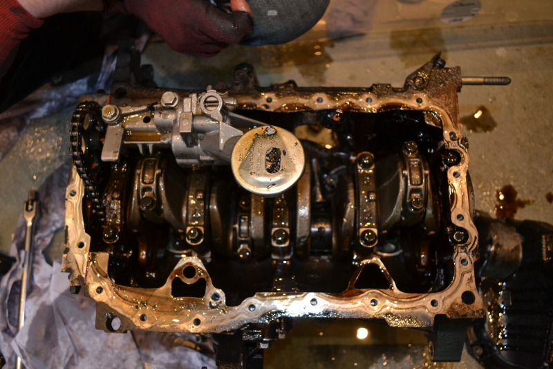

The hole went straight through the block.

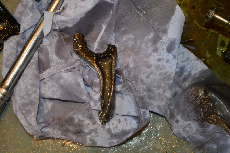

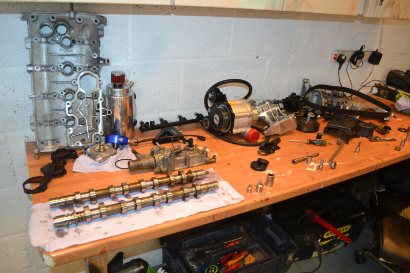

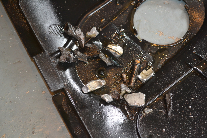

Then we set about stripping it down to inspect the damage. I'll let the pics do the talking.
And a lonely looking engine bay
Pretty sure the culprit was the standard rod bolts. My own fault really, I couldn't get hold of a set of arp bolts when I needed them so just carried on without them.

Proper job. Jeez.
Rod bolt 😧

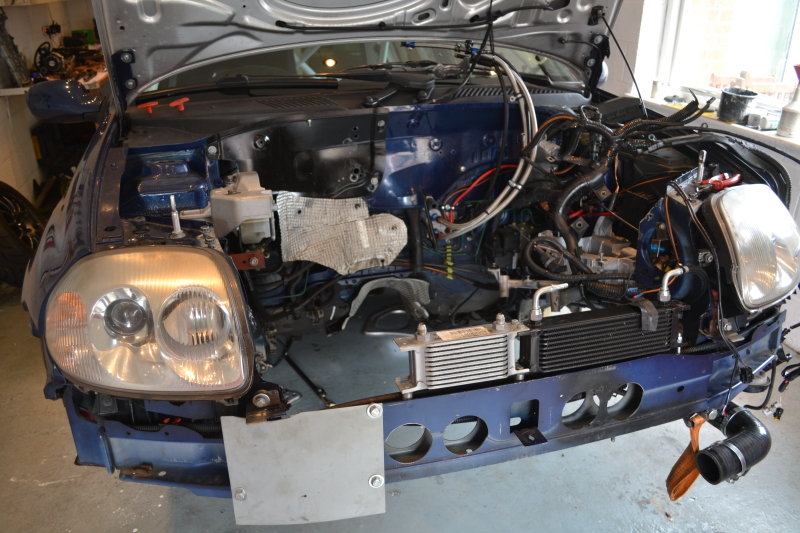

Did it show good pressure before the blow up with the oil thermostat open? Oil cooler pipes look abit thin?
Didn't really notice what pressure it was running before it went to be honest.
It did have very good pressure before though.
Would the diameter of the cooler pipes make a difference? Whatever didn't flow through them would just re-circulate wouldn't it?
Chambers_RS
  Clio 172 Cup&Leon K1
Such a shame. Was hoping you'd do well with the new engine setup.
If the pipes where to thin they'd restrict the flow of oil causing pressure issues.
Didn't think that was how it worked?
I mean when the stat is closed there is a very reduced flow through the pipes anyway. Any oil that didn't make it around the pipes and through the cooler would just flow through the filter and back off round the engine as per usual wouldn't it?
Sure smaller pipes would limit the flow of oil through the cooler but they shouldn't make any difference to overall oil flow round the engine should they?

Just to back up the comment James made....
When the oil is cold and the thermostat is closed, the oil can bypass the oil cooler and flow straight to the filter and into the engine.. however when the oil gets hot enough that the thermostat opens.. the valve inside closes off the bypass completely... Therefore ALL the oil has to pass through the oil cooler (what u want if the oil is getting too hot), therefore if the lines are to small then yes they can restrict the flow to the engine...
What diameter hose are you running to the cooler?
Hmm as it is a very small cooler the pipes are only 8mm with -6 connections. I didn't think that was how it worked. I had the same concerns on the pipe size but thought that any oil that didn't go around the cooler would just continue to flow through through the filter as it would under normal circumstances. I could have made a bit of a school boy error there. I didn't notice any drop in pressure though.

You need -10 hose and fittings for an oil cooler ideally.
Going to be changing them to 1/2 bsp mate.
Don't think small cooler hoses were to blame for the failure as I didn't notice any pressure drop. Also my oil pressure gauge has an audible alarm for low pressure as well.
Never the less I think I made a mistake with the smaller pipes, bigger pipes and better flow probably isn't a bad idea.

If I were you I'd whip the crank out to see if it's spun any bearings. That'll near enough confirm if it was a pressure issue or not mate.
Already done that mate, and no spun bearings apart from No.2 of course, but there was nothing left of that one at all!
