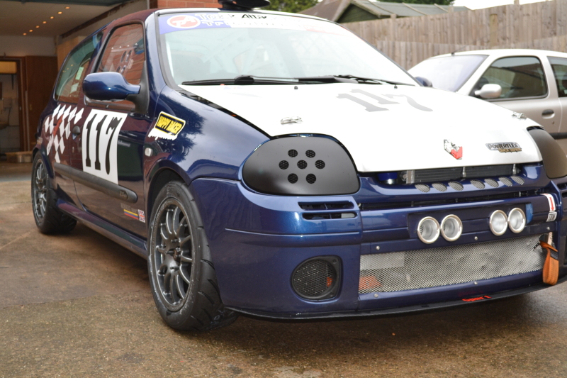

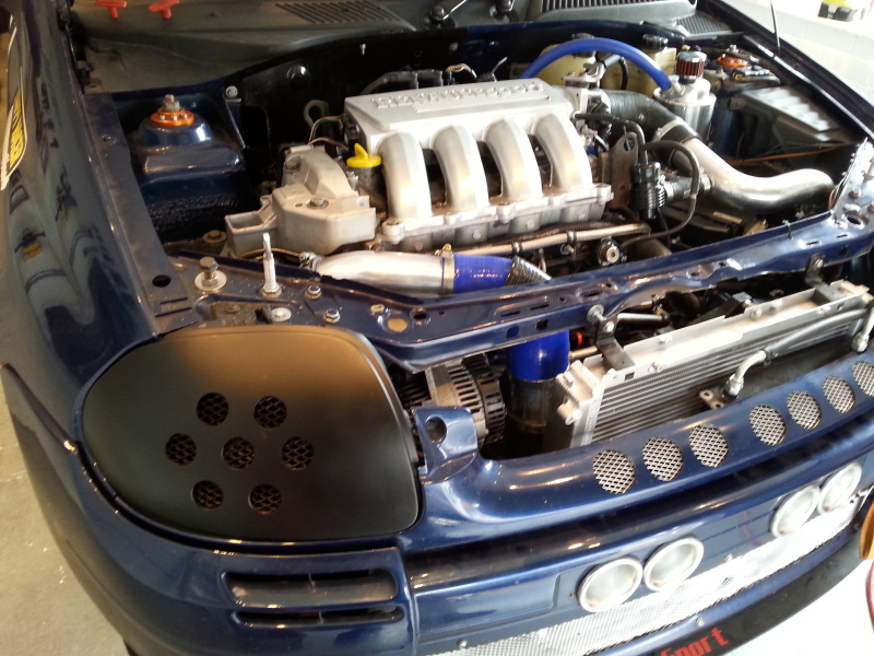

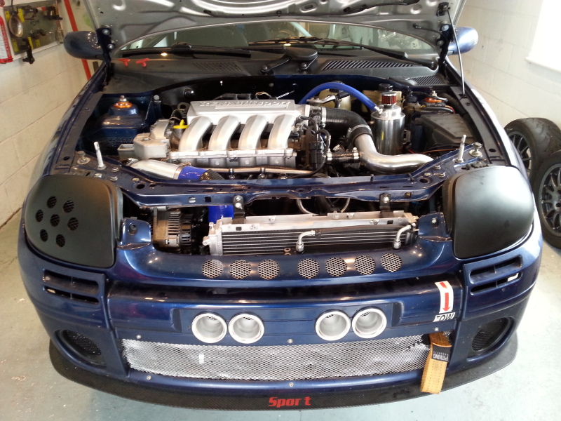

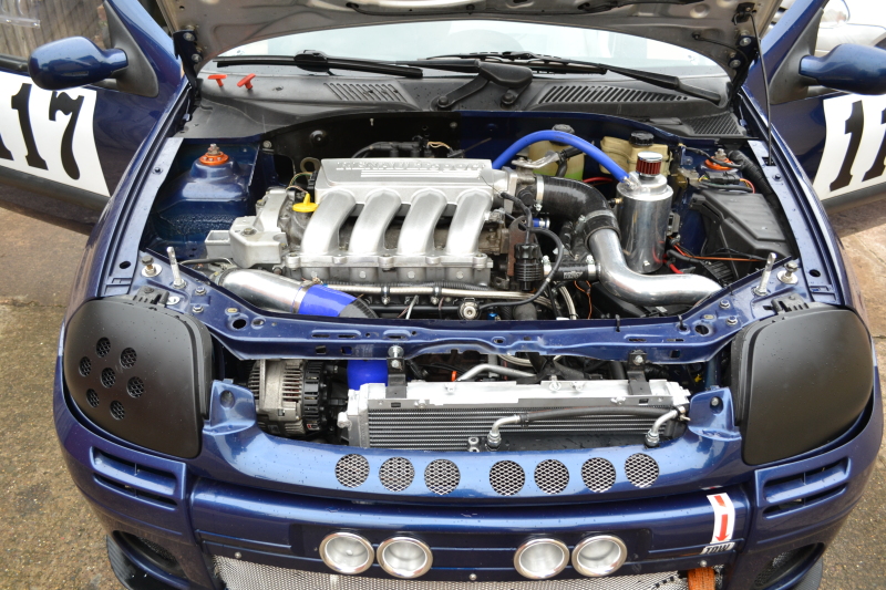

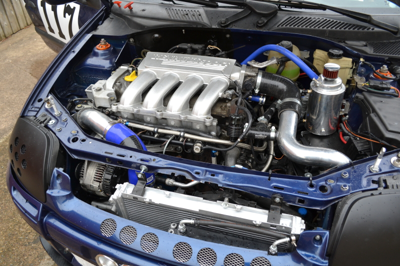

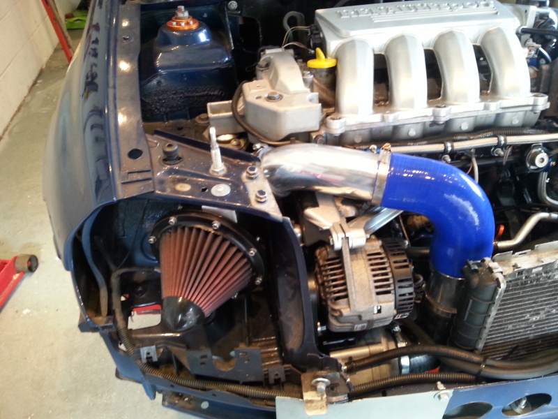

Just a small update, I have relocated the air intake for the charger to behind the headlight.
I was getting power dropping off at Thruxton after a few laps because of rising inlet temps. Not surprising really as the filter was directly behind the rad!
The way the car is mapped it backs off the timing slightly if the inlet temps get to high in order to protect the engine, this makes it loose a few bhp. Hopefully this should help a bit.
New air intake finished with cold air feed through headlight blank, new larger aluminium radiator fitted as well. These 2 together should help with the cooling issue.

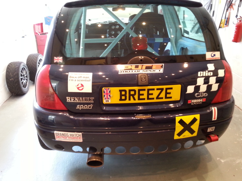

Also new rear plate so now everyone one will know who is in front of them! Or more likely who they just passed :smile:

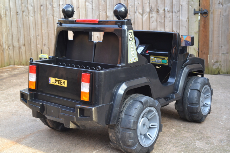

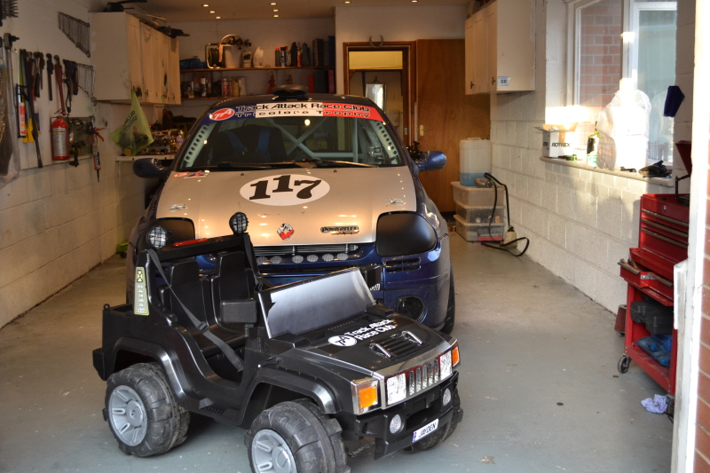

Yesterdays project was a little 12v jeep for my 4 year old nephew. It only cost me a few quid as it wasn't working, I fixed it, gave it a clean and also put some personalised plates and a spare TARC sticker I had on the front for him.

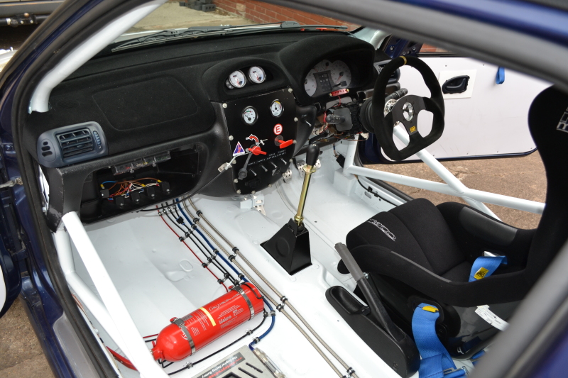

Looks awesome! Inside looks incredicable.

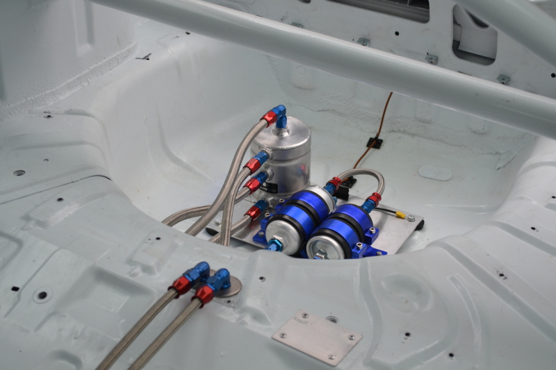

Are you still using the intank pump? I'm looking and buying pieces to add a swirl pot, yours looks a really tidy install.
Cheers mate.

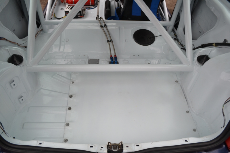

Yes still using the in tank pump that feeds the swirl pot. The swirl pot then feeds to an external bosch 044 pump and filter. It is all enclosed in the spare wheel well to comply with the MSA regs.

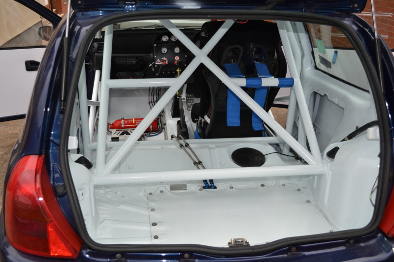

Cheers. It's a custom cage, built to comply with msa blue book regs and a bit beyond. It's tied into the shell at the A and B pillars as well.
Thanks for th reply, looks well fitting hence me asking as I've seen some cages an the fit for the A an B pillars is horrible.

Then I started having problems. The car was just overheating massively; Oil and water temps were off the scale. Because of this the car just kept loosing power the longer the race went on. It’s the same issue I was having at Thruxton but was even worse this time. Very strange considering I have fitted an up rated rad as well now.
My oil gauge goes up to 150 degrees C and it was bottomed out! The factory coolant gauge needle was also buried in the red! I think I was probably down a good 30bhp by the end of the race. If you listen to the video at the end you can hear my oil temp alarm going off. This did not bode well for race 2…..

No idea, I didn't data log the session, I do have a good cold air inlet now though.
It's just that the engine is just producing more heat than the current cooling system can get rid of.
The thing is though that there are Clio turbos used on track which will be hotter on the IAT side of things and therefore put more heat into the engine but have no issues.
That's why I'm asking about the IAT, because then you will at least know how much heat is going in. If they aren't that high then it's another issue.
NorthloopCup
Have you checked the thermostat? Sounds stupid but it's sometimes easy to overlook the simple things. Also I'd consider putting a shroud around the rad to duct the air through the rad. Otherwise it'll just spill around it as it takes the path of least resistance.
Bigash had similar cooling issues with his, but at the time he wasn't running a stat so the engine was just one big kettle effectively. He fitted a stat and shrouded the rad on my recommendation and he didn't have issues again.
