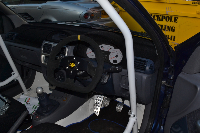

Ok, thought I better get a project thread up as I have had my car for a while now and never posted about it.
The current spec is;-

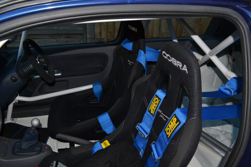

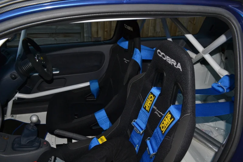

  • Ph1 Clio 172
  • Low mileage of 50k miles
  • Safety devices roll cage with harness bar
  • Cobra monaco seats on x-low subframes
  • OMP steering wheel
  • Yanoo stiff shift
  • OMP harness 5 point for driver 4 point for passenger
  • Team dynamics pro race wheels with yokohama A048 tyres
  • Odyssey lightweight battery relocated to rear
  • Cut off switch
  • Flocked dash
  • Interior painted white
And my 2 favourite mods are;-
  • AST Sportline II suspension with track spec springs rates and AST top mounts
  • Gripper plated differential
There is probably lots I have missed but just doing this from memory

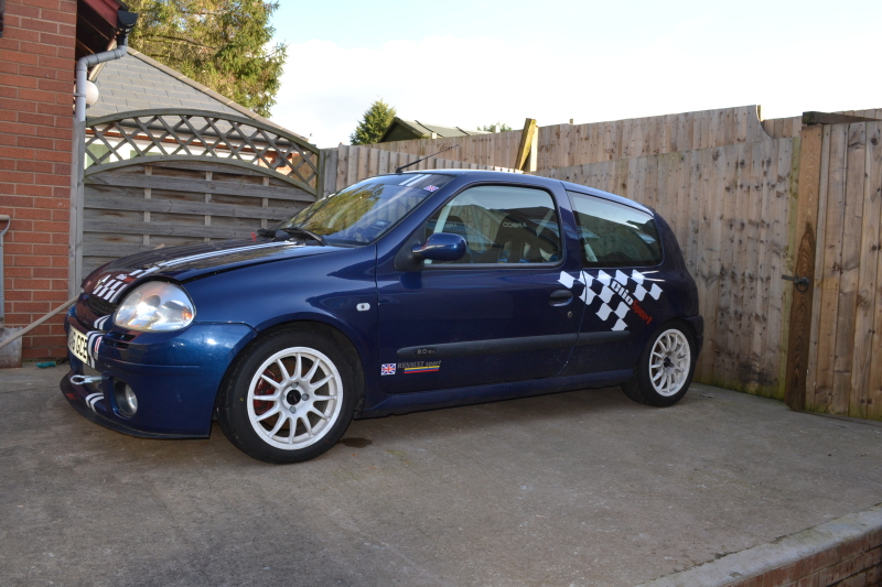

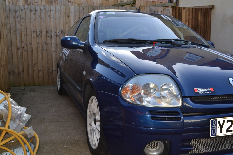

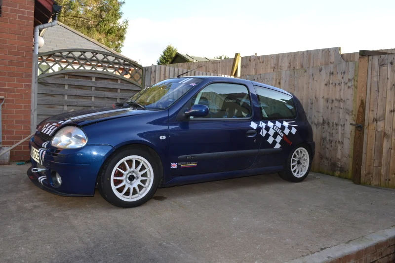

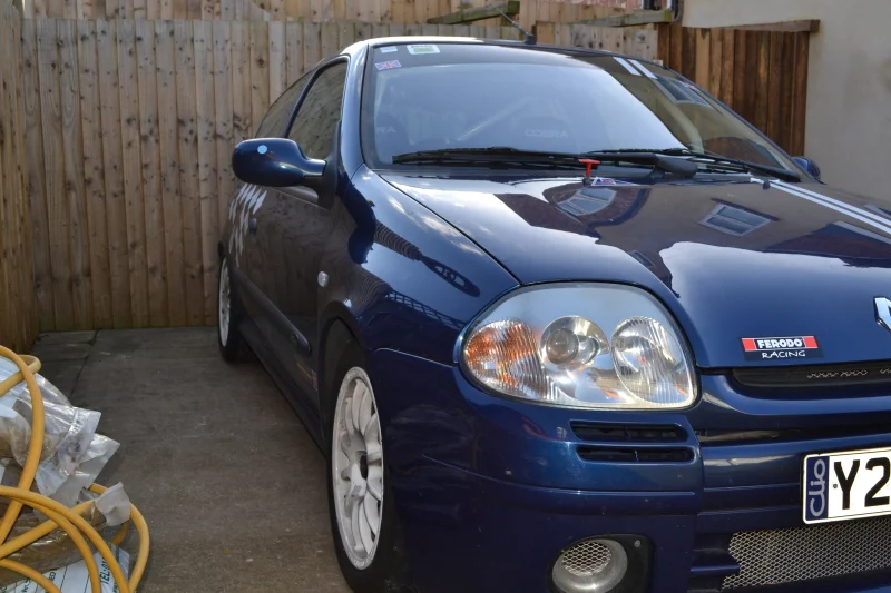

Here are a few pics of the car as I recently got it out of the garage. It hasn't been used or cleaned for 6 months so please excuse the state of the car.

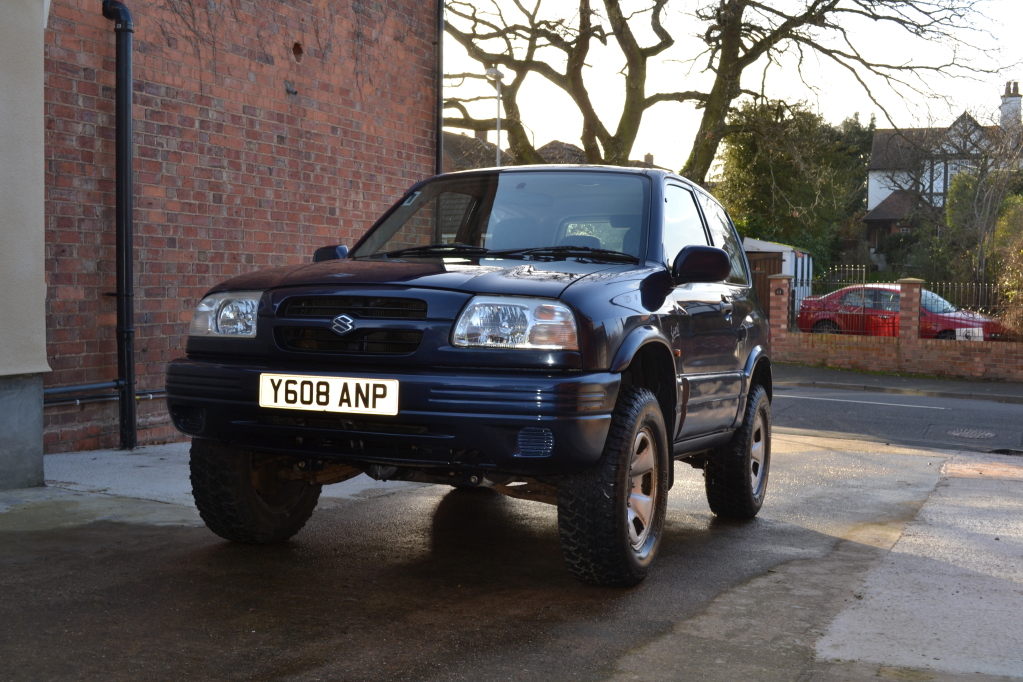

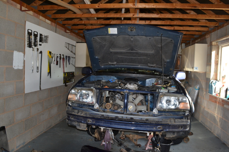

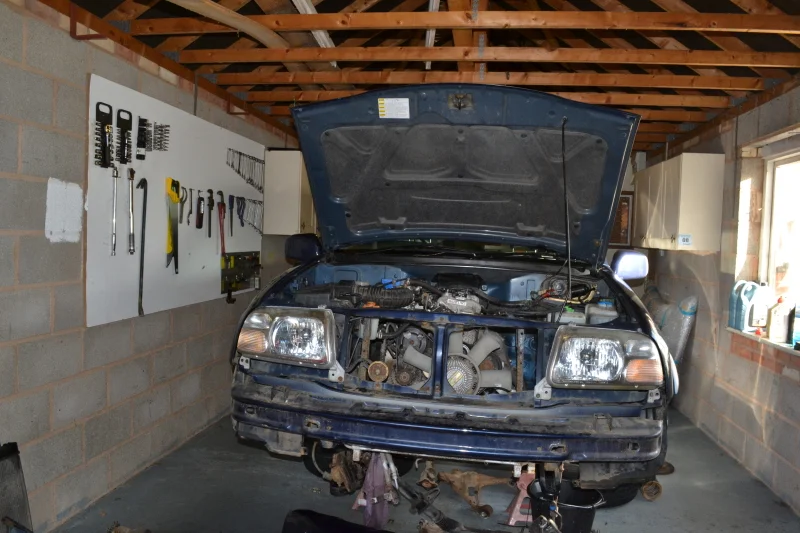

The Clio normally lives in the garage but I have an off road project in there at the moment. A Suzuki vitara that I am fitting a 2 " suspension lift and a 2" body lift to, along with a few other off road goodies.
The Clio will be going back in the garage next week will be getting a bit of an overhaul for the coming trackday season, along with a few more upgrades like a clio 182 manifold and an EPAS conversion to name a couple.
I have been doing trackdays for years now but I would like to eventually get into some proper motorsport. I will probably just stick with trackdays this year and develop the car more, hopefully go racing next year.
I am going to try and document everything I do to the car from now on, and hopefully get it race ready for next year.
I know there a lot of very knowledgeable people on here that already have clio race cars so I will be hoping for some advise over the next year.
Thanks for reading :)
Thanks guys. Not sure why the pics came out small though?
We have the same car combination! I also have a Vitara that i'm about to do a 3" body lift on and a 1.5" suspension lift! Its the perfect combination - Clio for nice sunny summer blasts and 4WD Vitara for sideways giggles with its wet and snowy!
Yep I will be doing a bit of green laning in it once its lifted, should be good fun!

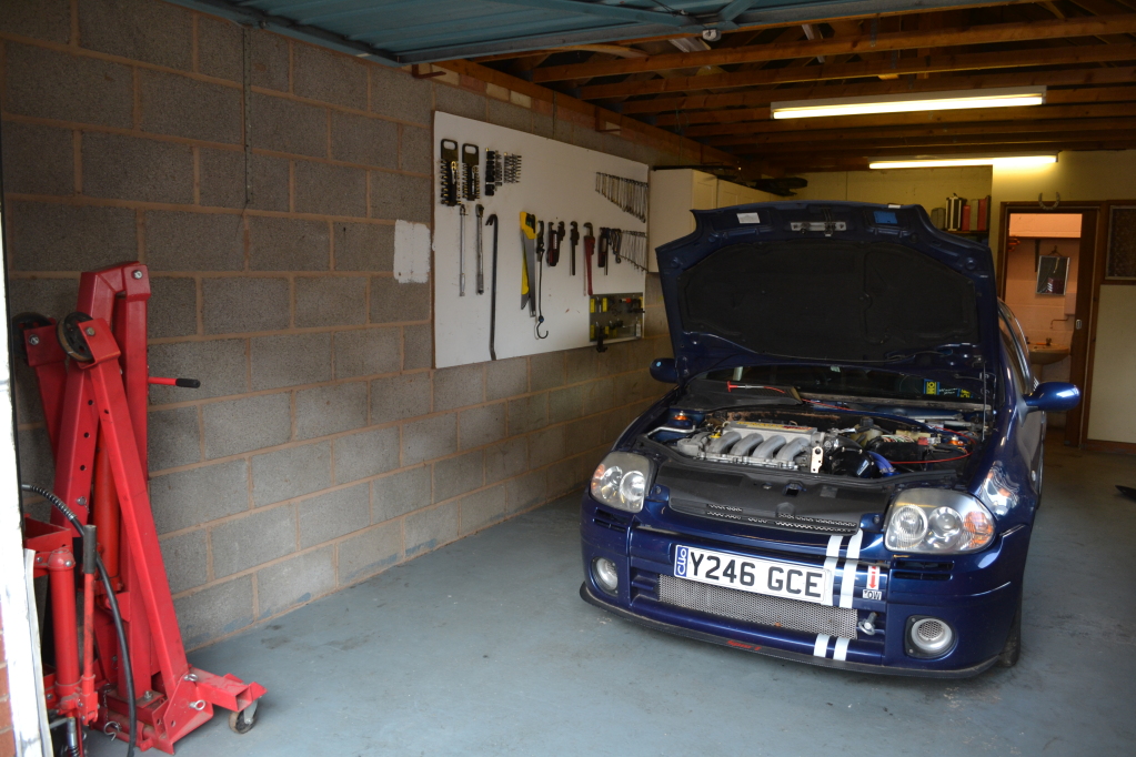

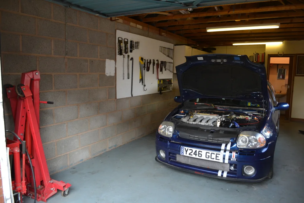

The Vitara is done and has been evicted from the garage.
The Clio is back where she belongs, ready for an overhaul and a few new parts next week.
Got on quite well today, I'll let the pics do the talking.

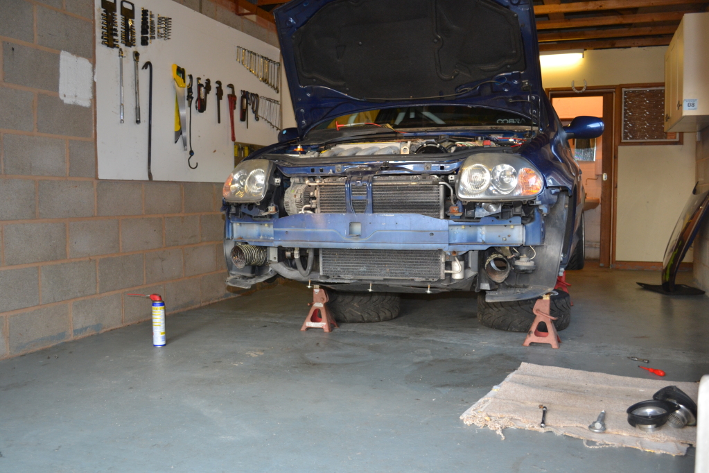

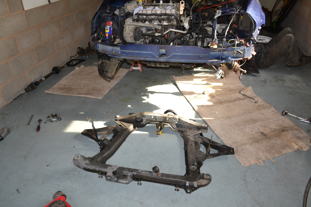

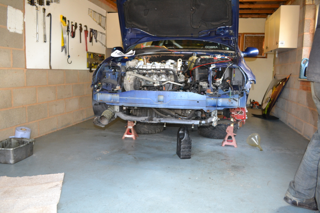

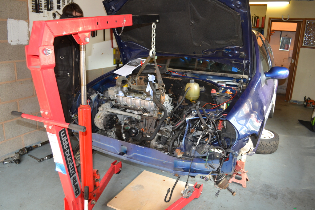

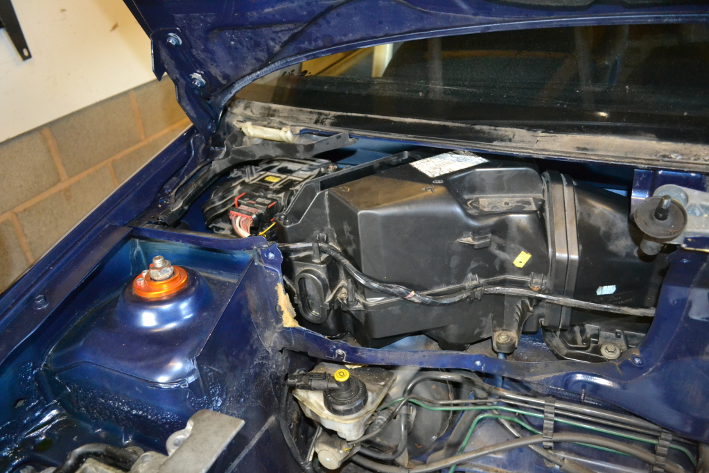

Engine and gearbox are out.
And Out.

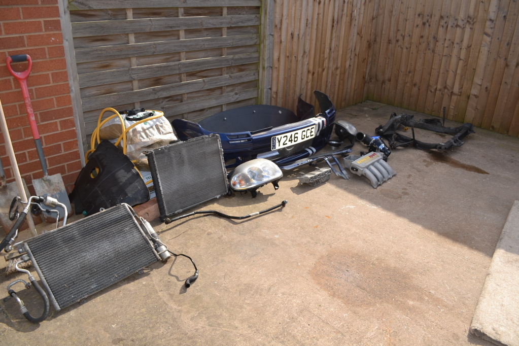

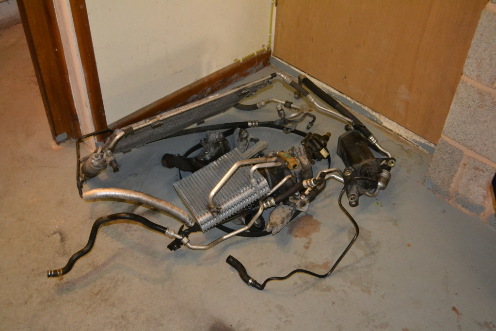

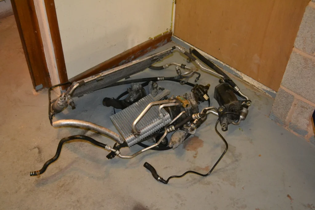

Current Air con and PAS setup is being binned.

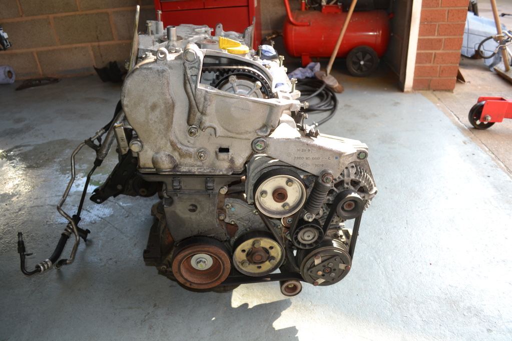

All these parts have been removed.

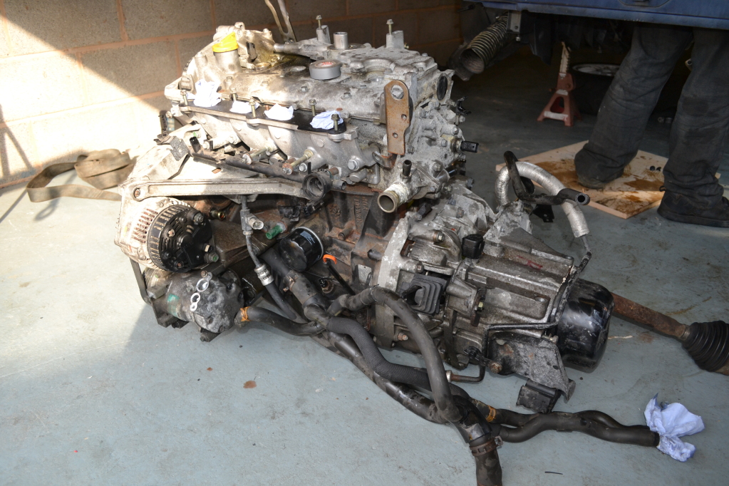

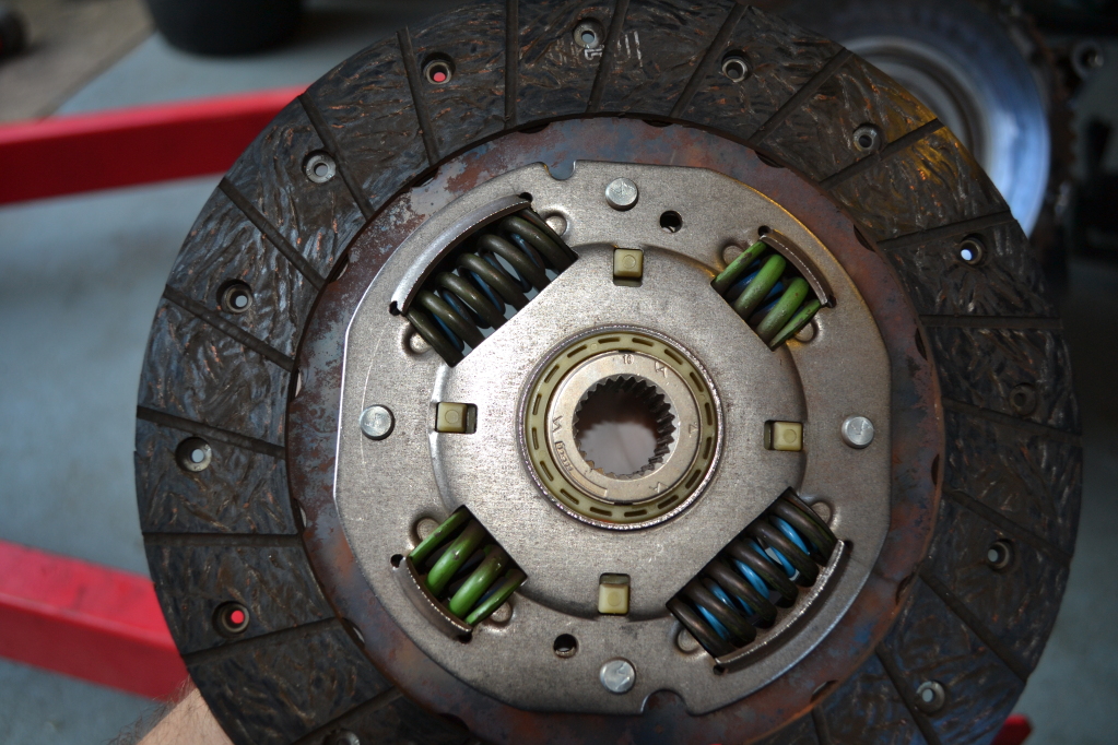

Gearbox split to inspect clutch. I was going to put a new clutch in as a matter of course, but this clutch has seen very little mileage and is in great condition.
You can still even see part of the writing on the pressure plate at the top so I will probably leave it.

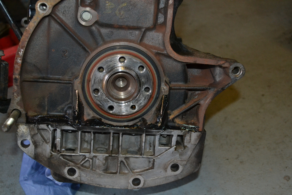

New crank seal
Removed the Air con matrix from the heater box and sealed the hole it left
