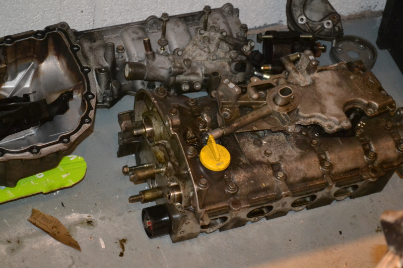

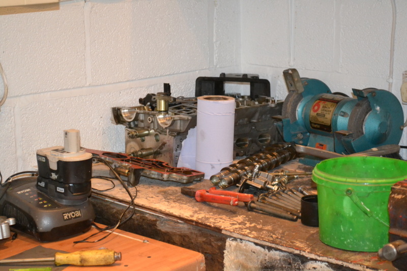

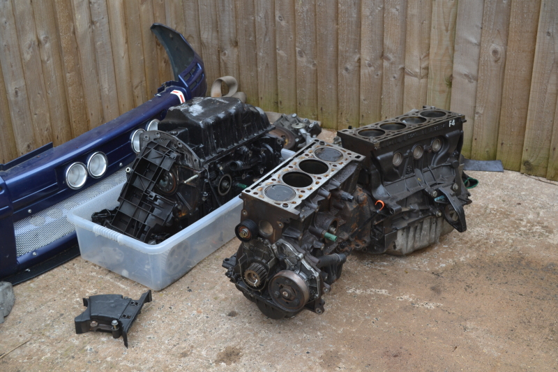

So I have had a bit of trouble sourcing a good second hand engine. I've had 3 in total now and all have had some kind of problems.
However I have managed to put together one good engine!
My place now looks like an engine graveyard!

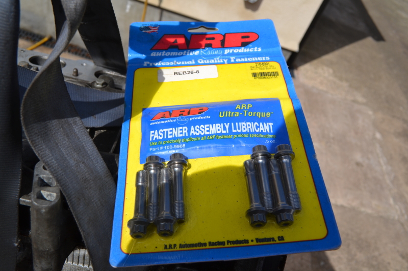

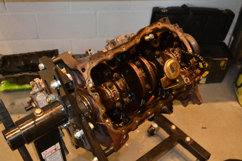

Engine assembled and on the stand, all that's left to do is fit the obligatory ARP rod bolts (won't be making that mistake again).
I haven't bothered trying to make this engine look pretty by painting it or anything, as I will probably be building another one later this year ready for next season. It's just had a bit of a clean and all new gaskets, seals, dephaser and cambelt.

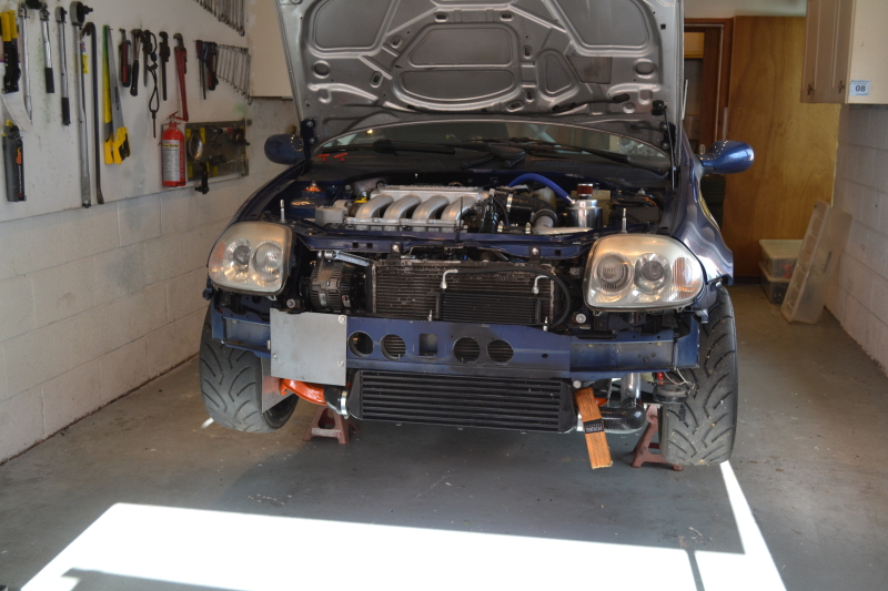

Hopefully I will get it all back in the car at the weekend and ready for Thruxton in a few weeks.
