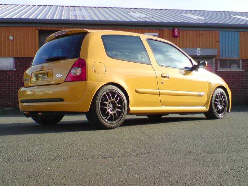

hi phoned my insureance up and did a check for a ph1 172 and its not to bad 1 year driving a 1 year ncb going cost 2100. very tempted but im woundering if i when to a body shop would they be able to fit ph2 frount and back bumper on this would look great has any one ever done this? pics if they have:approve:

Front will be very difficult and fiddly, but the rear will definately fit.

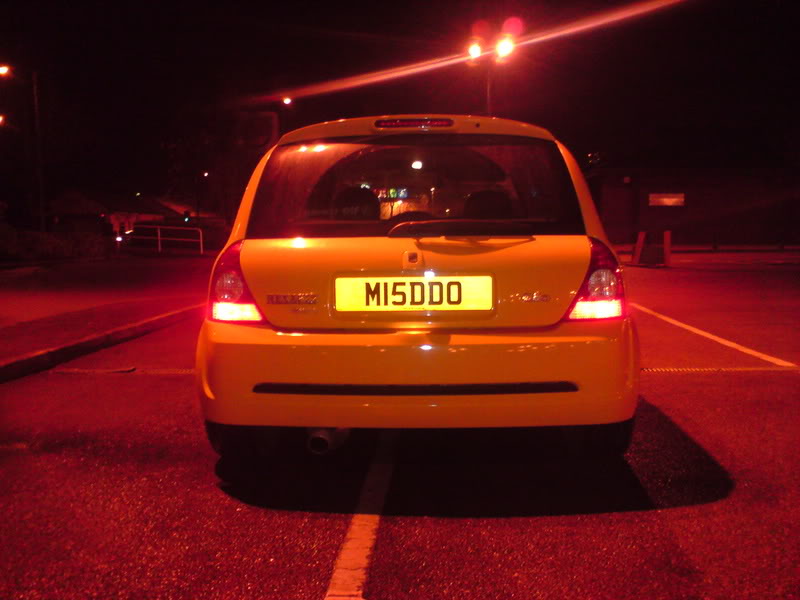

Middo has done the rear to his ph1 172...

If you change the front bumper you need phase 2 front wings, headlights, arch liners, different fog lights, grill and bonnet.

Takes a bit of work but the bumper fits ok, I fitted mine myself

you would probly need to change the front panel too which would mean arsing about with the radiator and stuff too and the amount it would cost you to buy the car and have the work done at a body shop you might as well save it up and get a ph2. there isnt much difference in insurance cost between the two either

to the owner of the yellow 172...when you say it takes a bit of work, do you mean it needs any modification to the bumper or car to fit the ph2 bumper...or does it just bolt straight on, and take a while to do?
p.s. do you possibly have your ph1 bumper for sale?

Please dont ruin the front end of a PH1 they are rare enough as it is without somebody changing it into a PH2.
