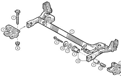

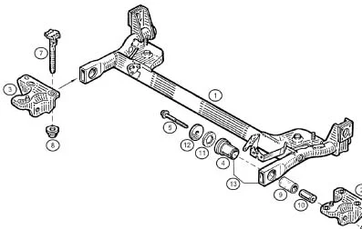

can anyone confirm the rear axle width of the ph1 172 and 172 cup ?
im transplanting the subframe arms struts etc from my cup to my ph1 but as far as i can gather the ph1 rear axle is slightly wider or atleast its stub axles are thinner
did the ph1 and ph2 main axle differ at all ?

172 cup stub axle mount is 5mm thinner to account for the rim offset.
Rear beams are the same bar the 182 which has the extra plating underneath the stub axle pickups.

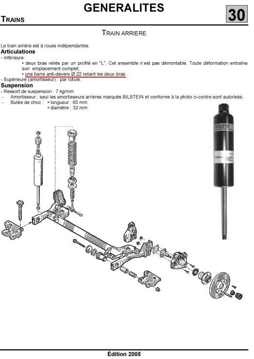

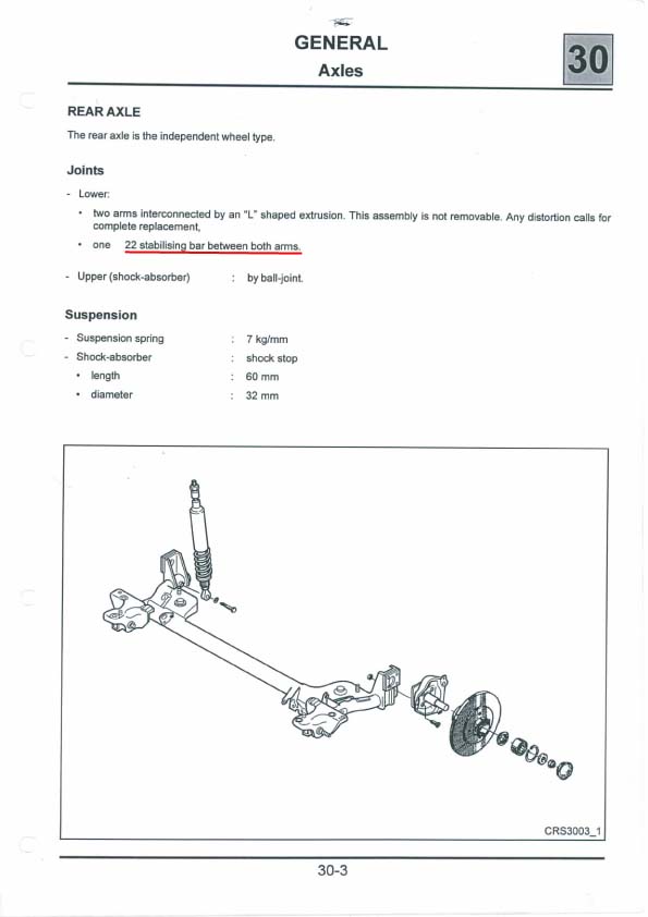

This intrigued me, So I checked the two beams I have here, off cars, 02 172 and a 04 182, I can't see any differance, Bar maybe the ARB being thicker on the 182, However that could just be its covered in more dirt and crud.
Would love to be prooved wrong though!!

Early:
Later:
evo 2000 manual:
evo 2004 manual:
  Many.
The latter there, looks exactly the same?

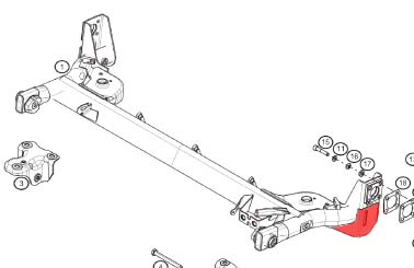

And the former, that red bit? Nothing like my 182 beam.
That was my point - there was no difference in the bar thickness. It was 22mm throughout.
The later beam is as per the picture and has additional plating on it -'the red bit'. If yours doesn't have that, it's obviously the earlier variant.

I missed the ARB bit, not paying attention! lol
Interesting though, Will have to keep an eye out as I don't remember seeing a "later" one.
