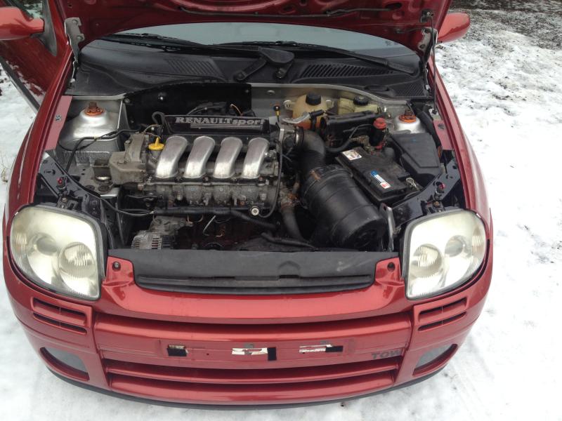

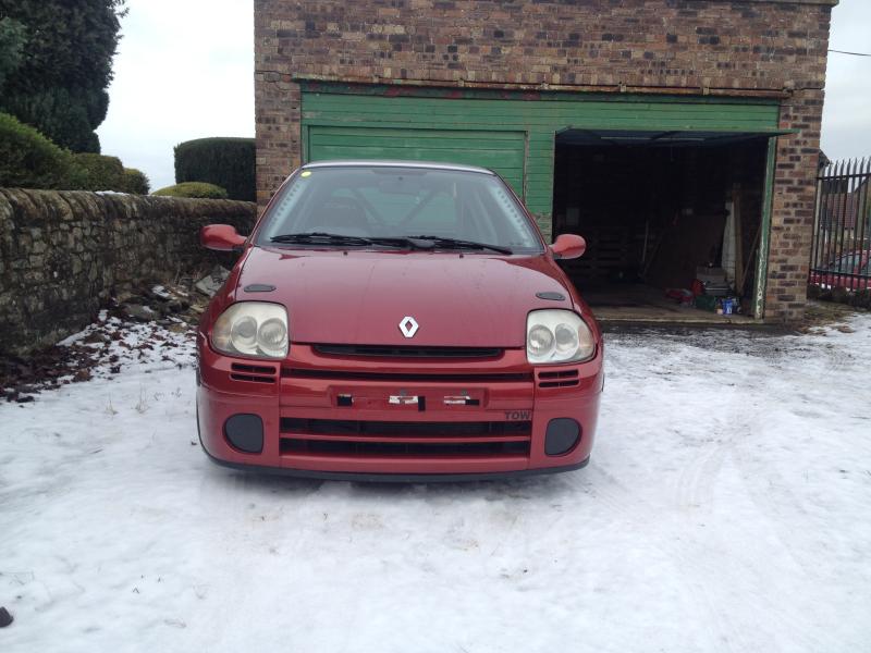

Defo possible, fair bit of cutting and faffing but this is mine and @Djw Dave track 182 shell.
Credit has to go to Dave for it, he's got a way better eye for it than me and more patience!
