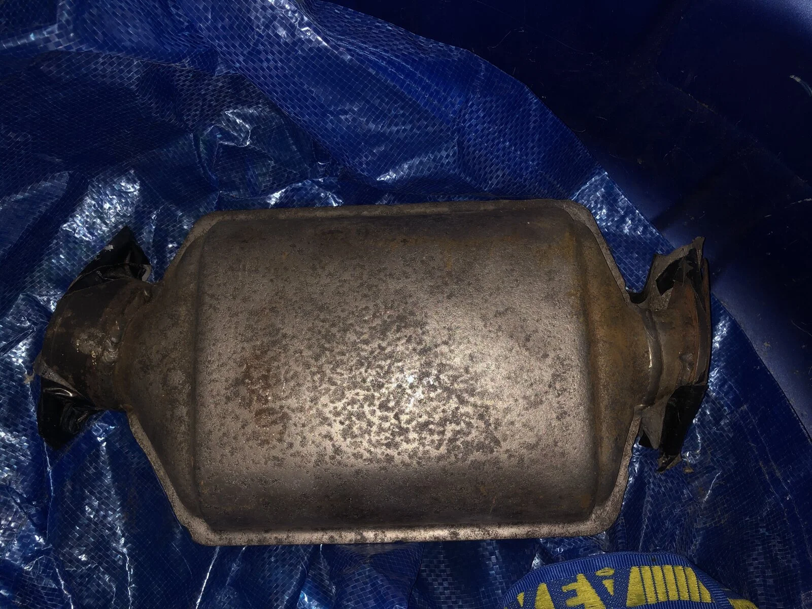

So I have a 172 Cup track car that i have purchased from one of the guys at work. First post so go easy!
Slowly sorting the issues out and i wanted to get CAT put on it for MOT time. Its currently de-catted.

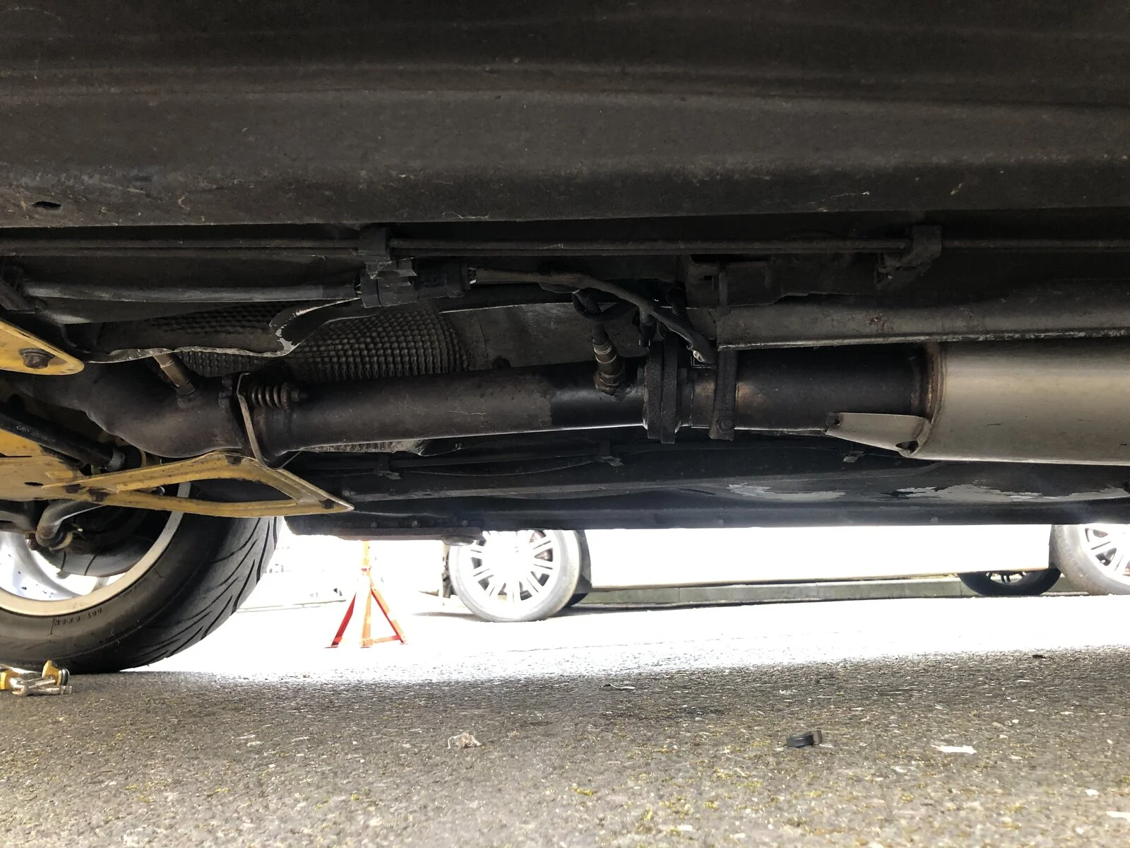

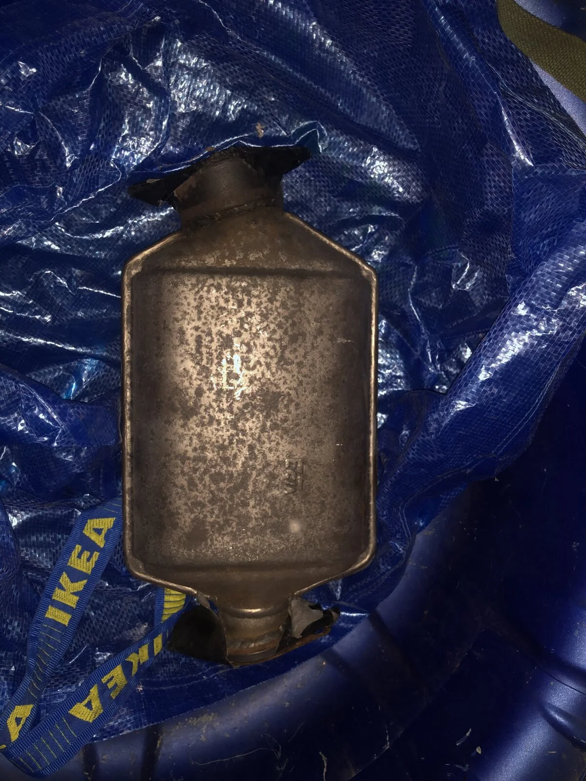

It was supplied with a catalytic converter but it doesnt look like the right one
It currently has a straight De-CAT pipe but the CAT i have been supplied (when the car was sold to me) has a kink on one of the ends.
Im thinking that at some point in its life it may have had a 182 Manifold. Anyone shed any light on this?
Can i get the below CAT back on the car or do i have to get something like this.

Hi. That is fitted with a 182 Manifold and decat pipe looking at the picture.
Someone has modified the standard 172 cat by chopping the ends off and welding 182 joins on.
With a 182 manifold on a 172 you need to use either a sports car(I have a ktec one) or decat pipe as the standard 182 cat is too long to join to the 172 system.

Thanks @Mbeau that makes loads of sense. I will have a bash at putting the one i have on and getting a ticket on it. Does the Ktec one you have fitted make any apreciable difference?
I have the same set up as you. Decat and the cat for mot. I have been too lazy to swap the cat back out since the last mot so it's still fitted. It is well made, but from what I have read they don't seem to meet emissions standards for very long. A good exhaust place should be able to make up a good 200 cell cat to fit. If that is an original Clio 172 cat they are worth a small fortune in scrap!!!
