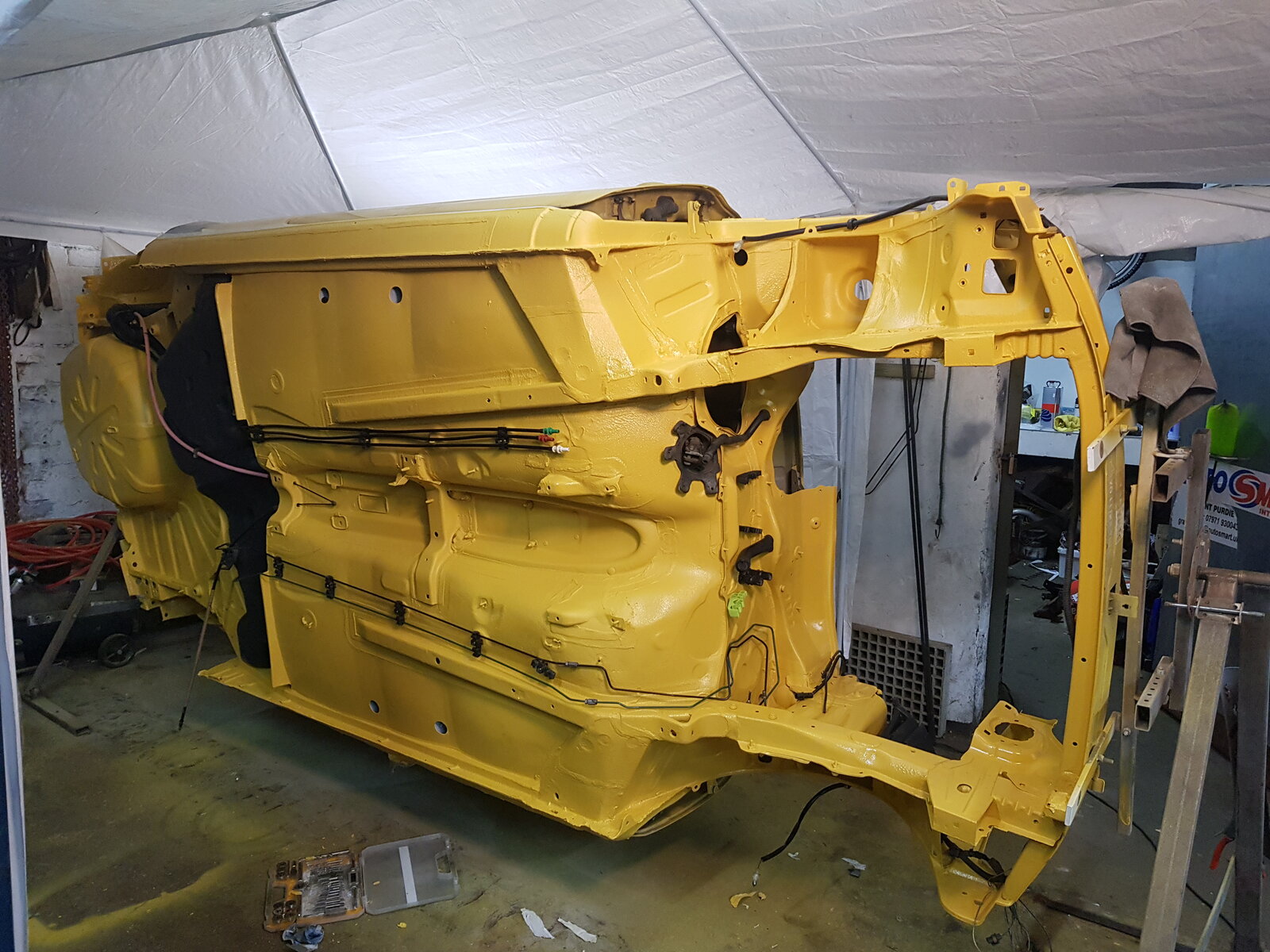

Just started to do a resto on the underside of the 172, basicaslly just want to make it as nice on the underside as the outside
Going to work from the back to the front and have already got the rear beam off and all the suspension etc
Already purchased new oem brake lines, standard exhaust, brand new oem suspension all around (car is standard except for cooksport springs)
Going to paint the arches and floor and try to properly go to town on it and make it as clean as physically possible without it costing an arm and a leg!

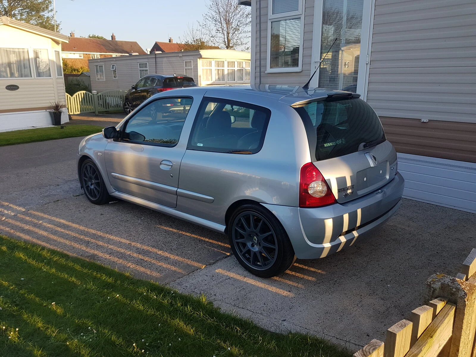

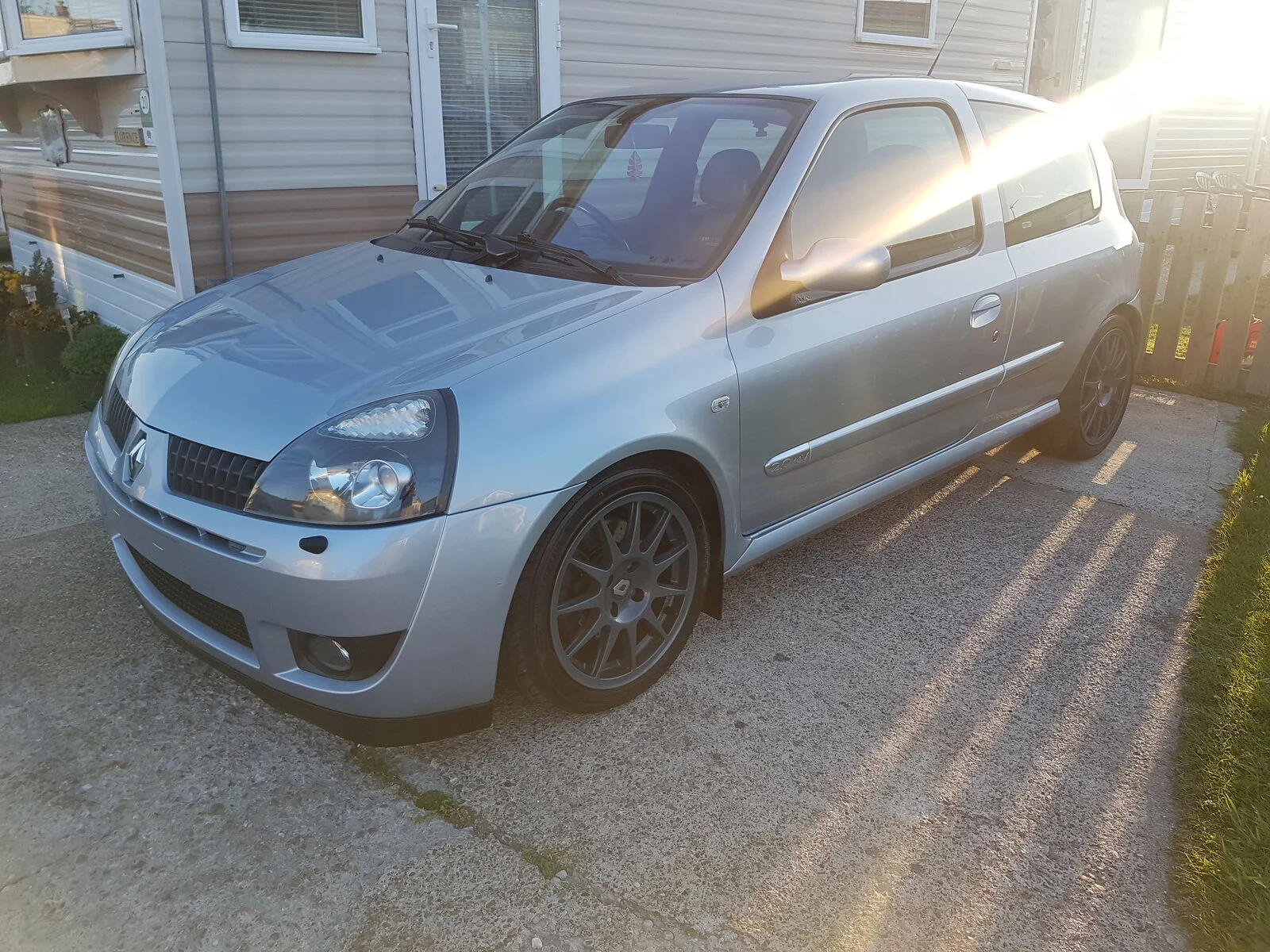

Few pics of my car from the summer (splitter changed now) and ill get some other pics up from when i started stripping it and where i am currently, tomorrow or sunday

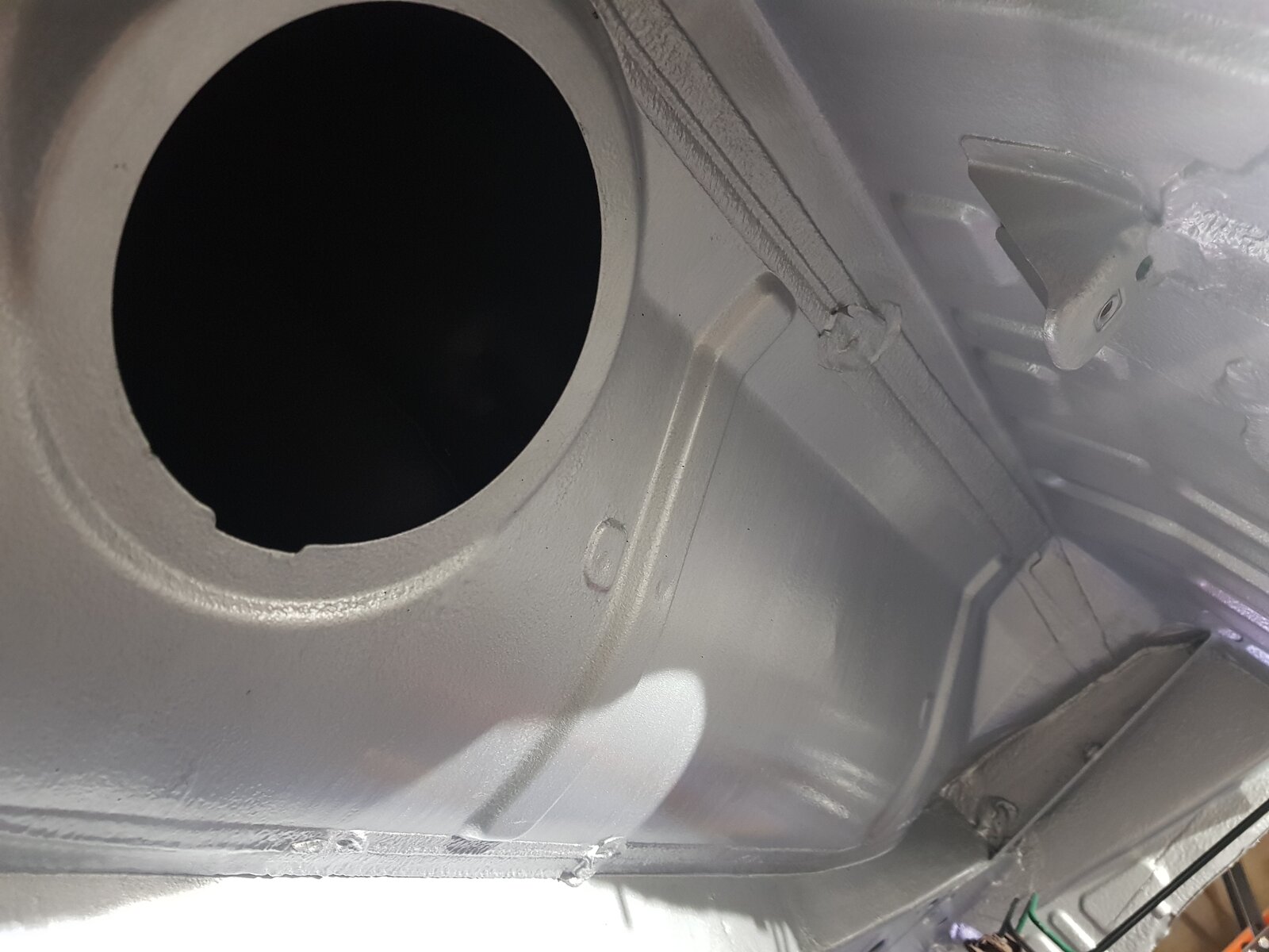

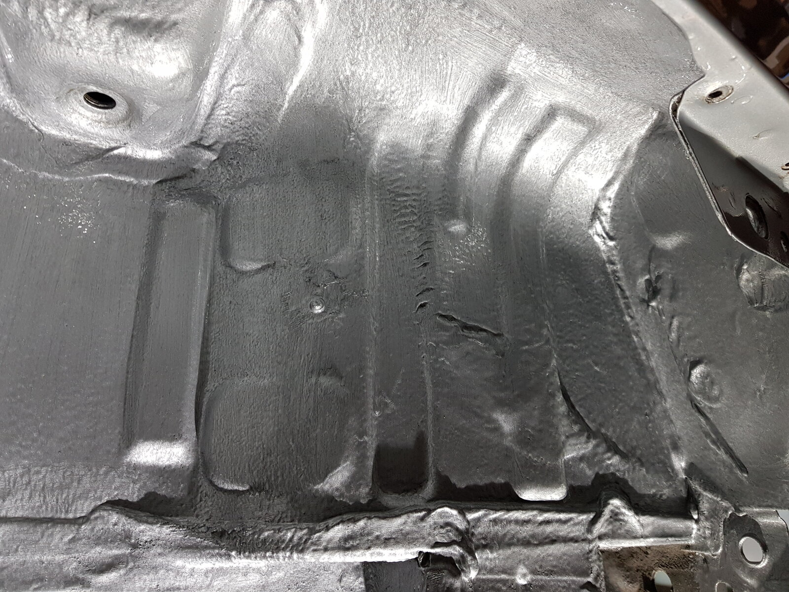

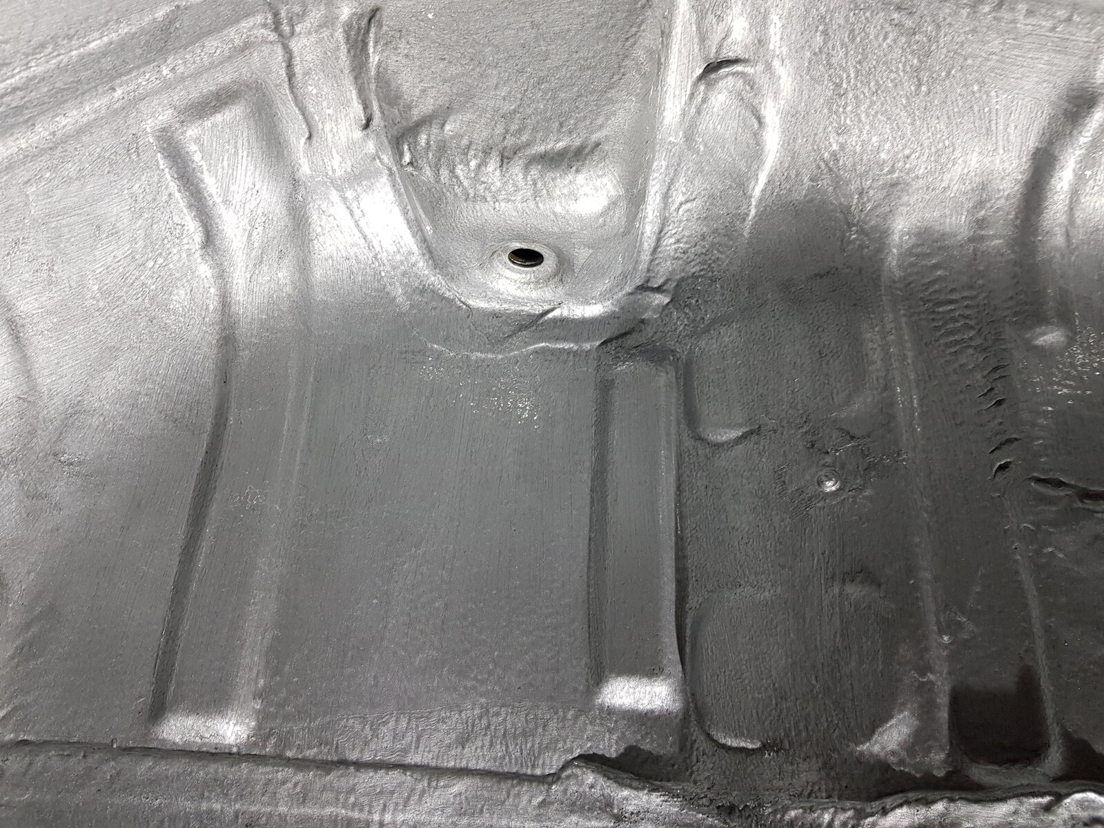

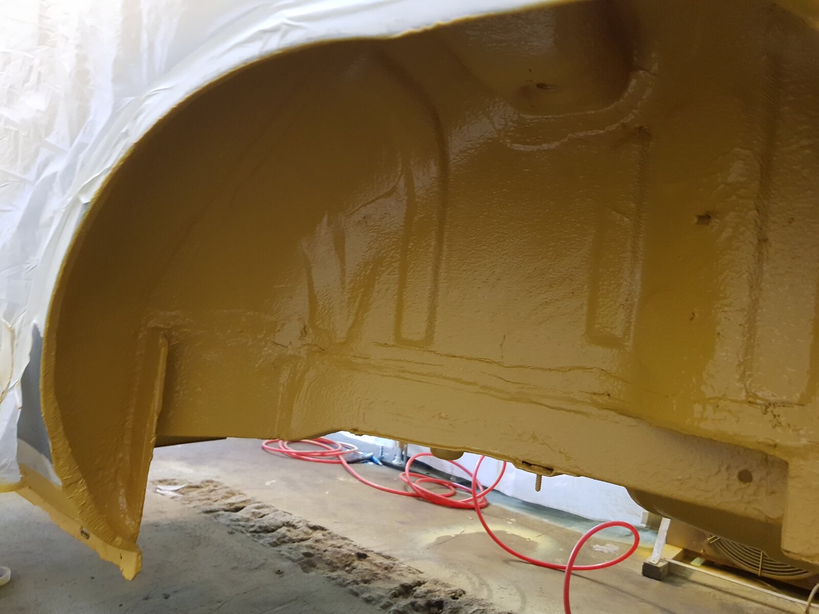

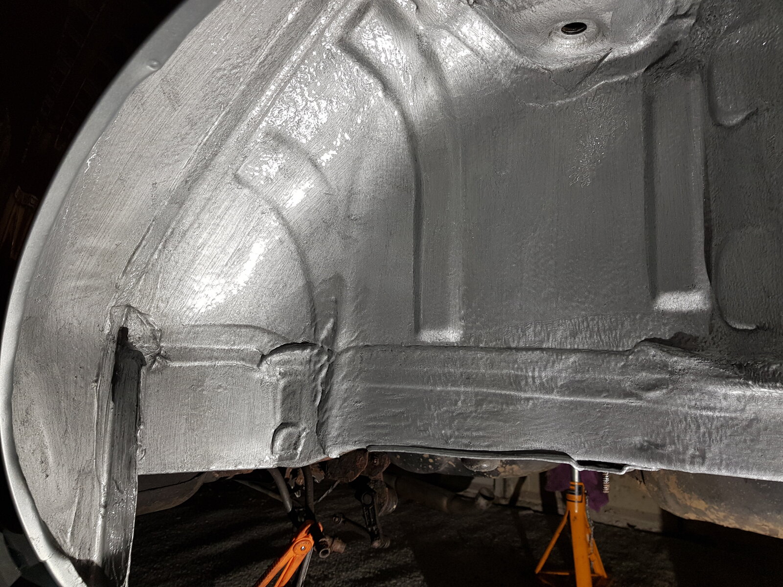

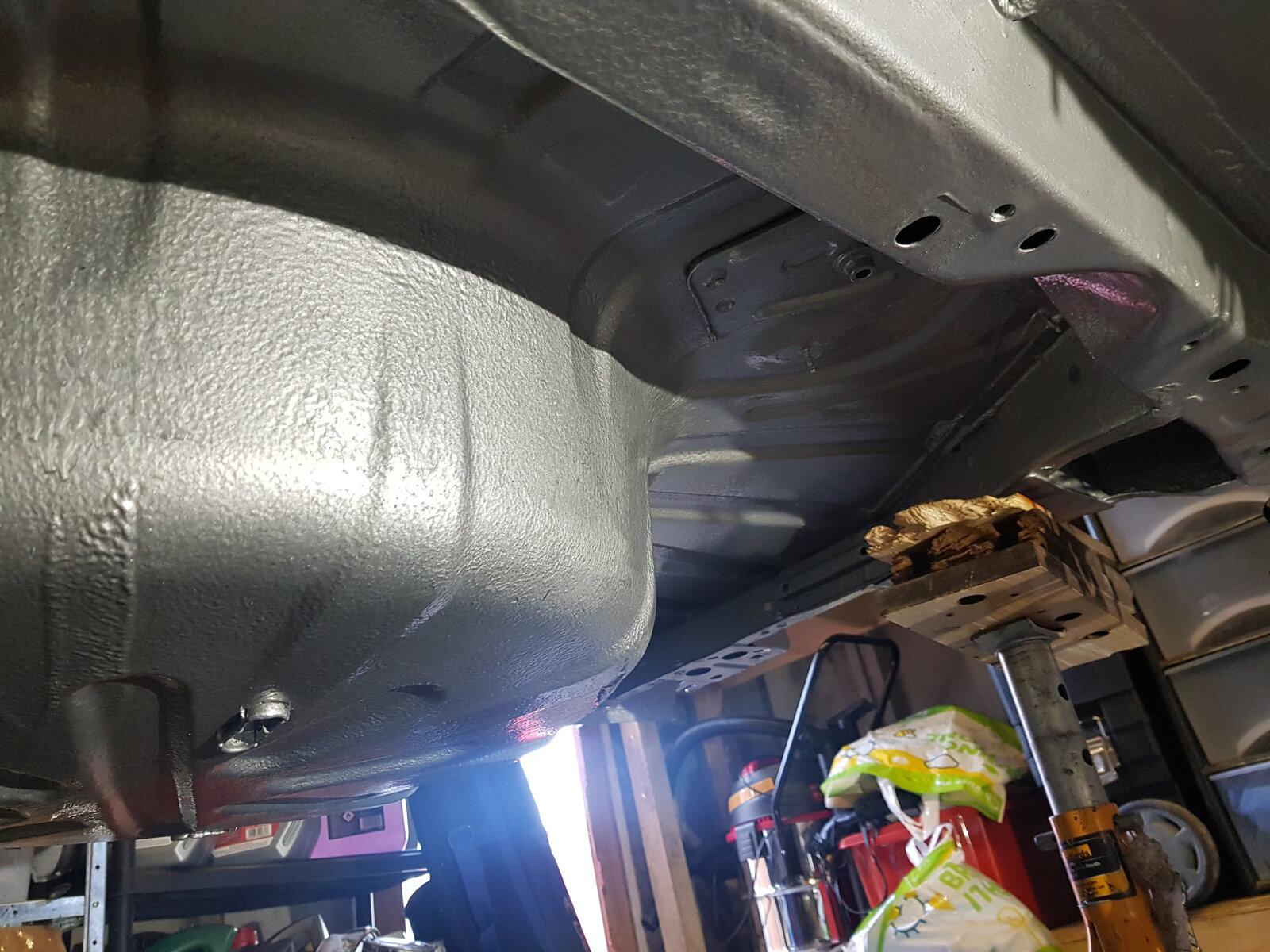

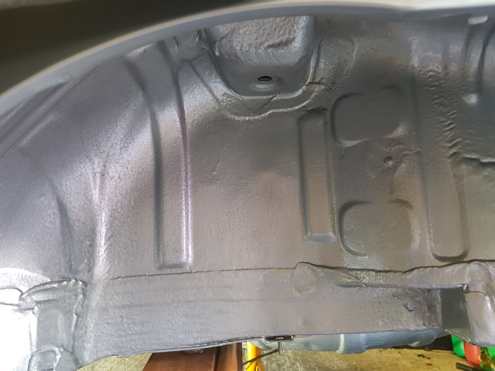

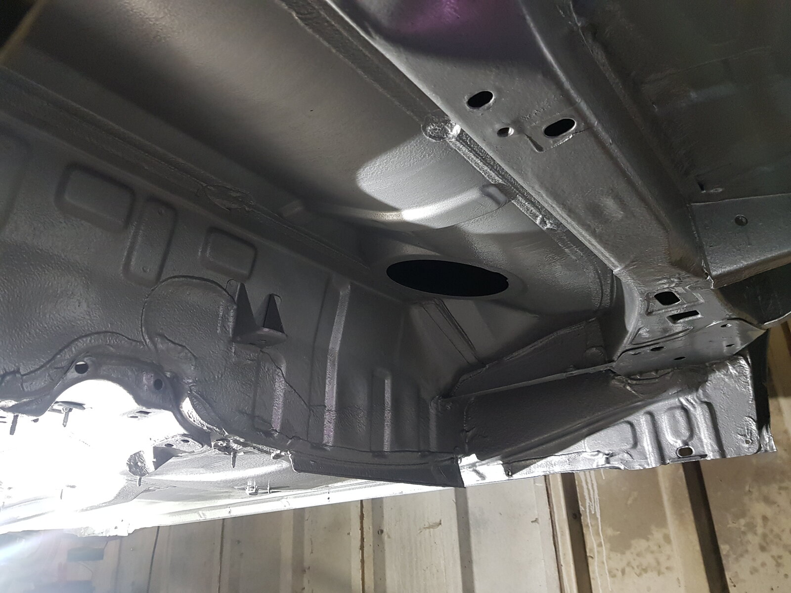

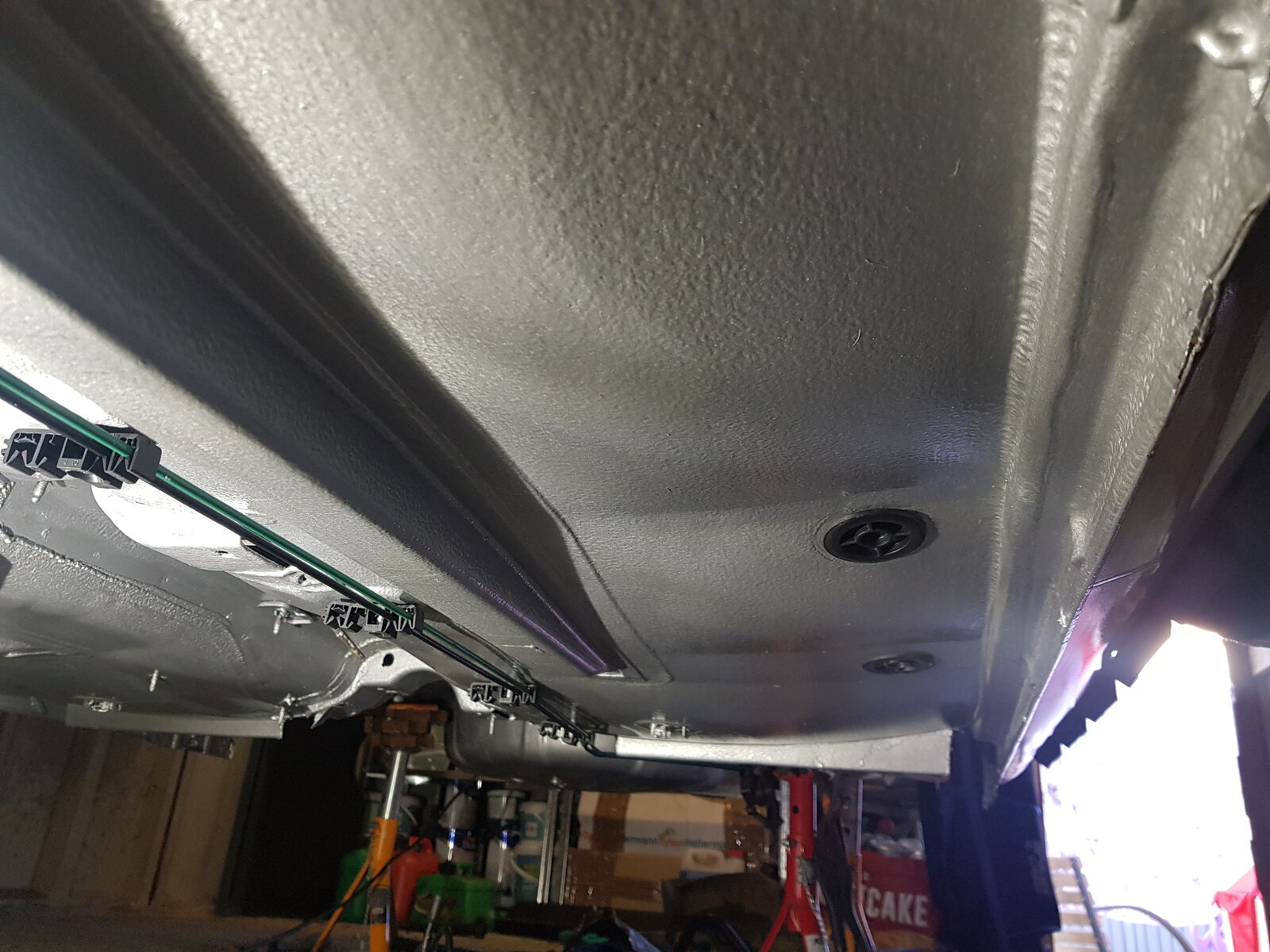

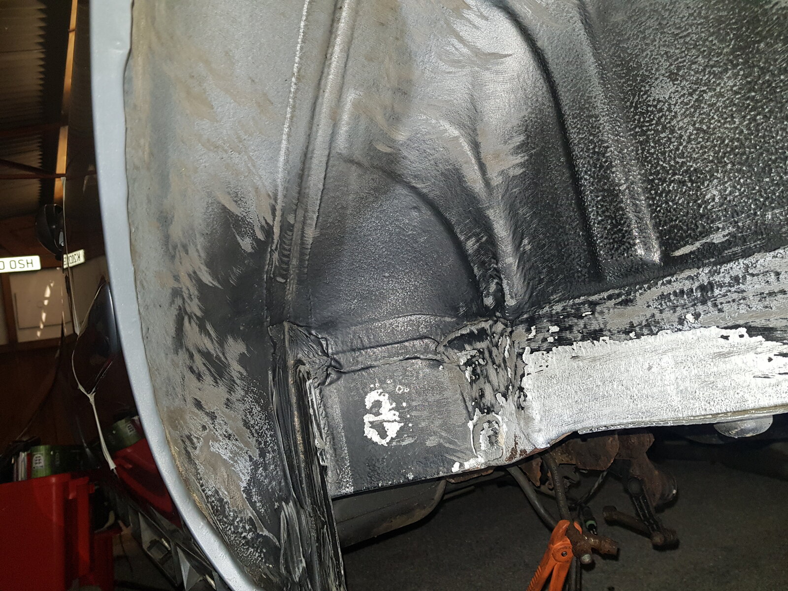

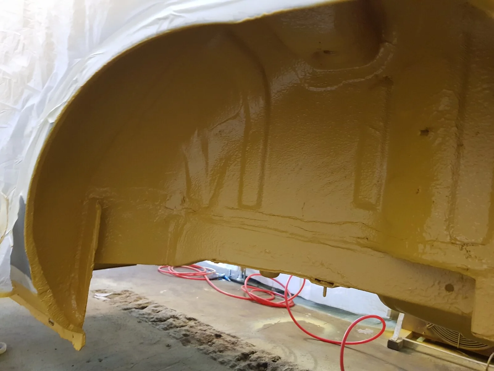

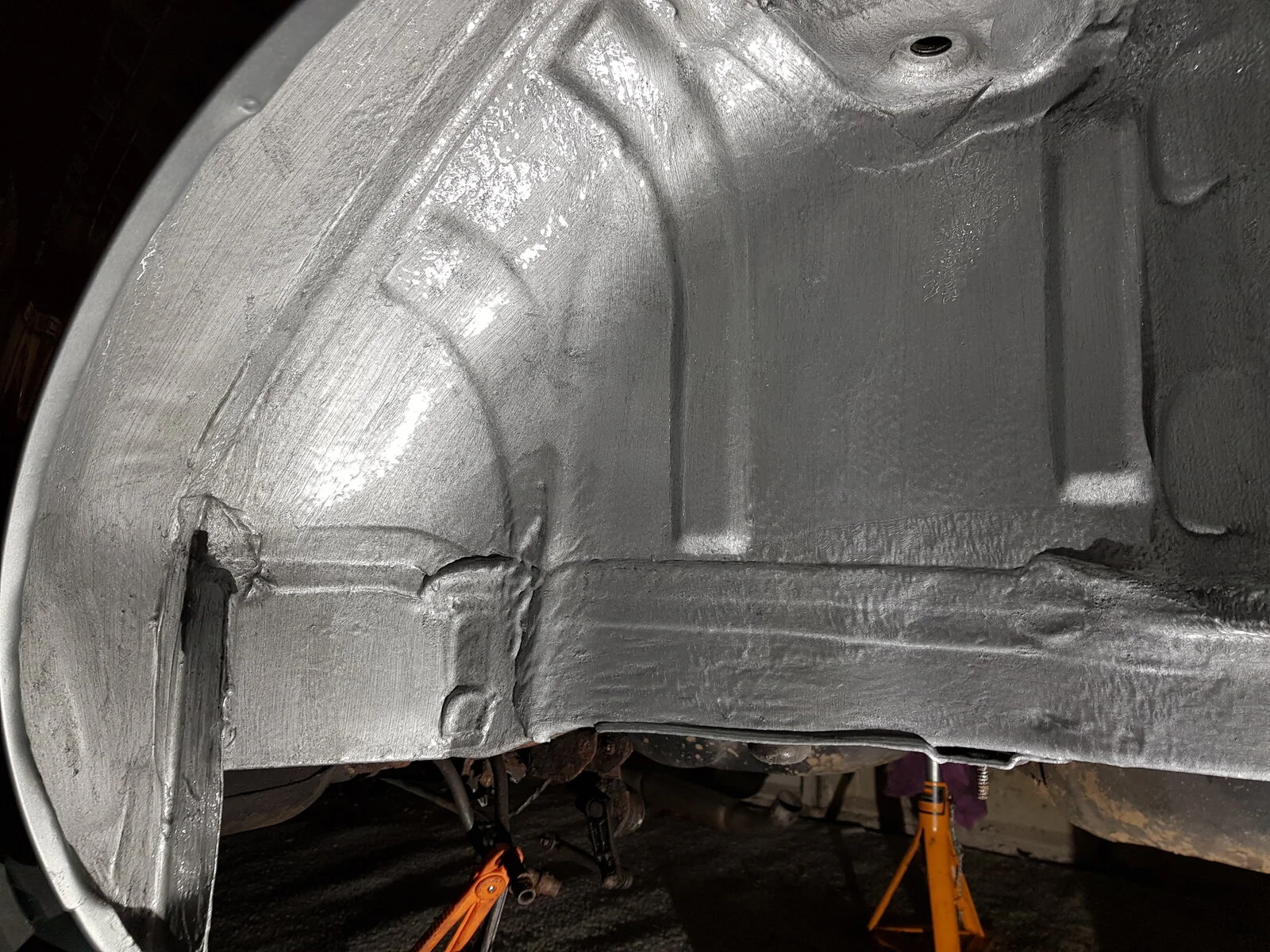

Done one of the rear arches this week as I'm working from back to front

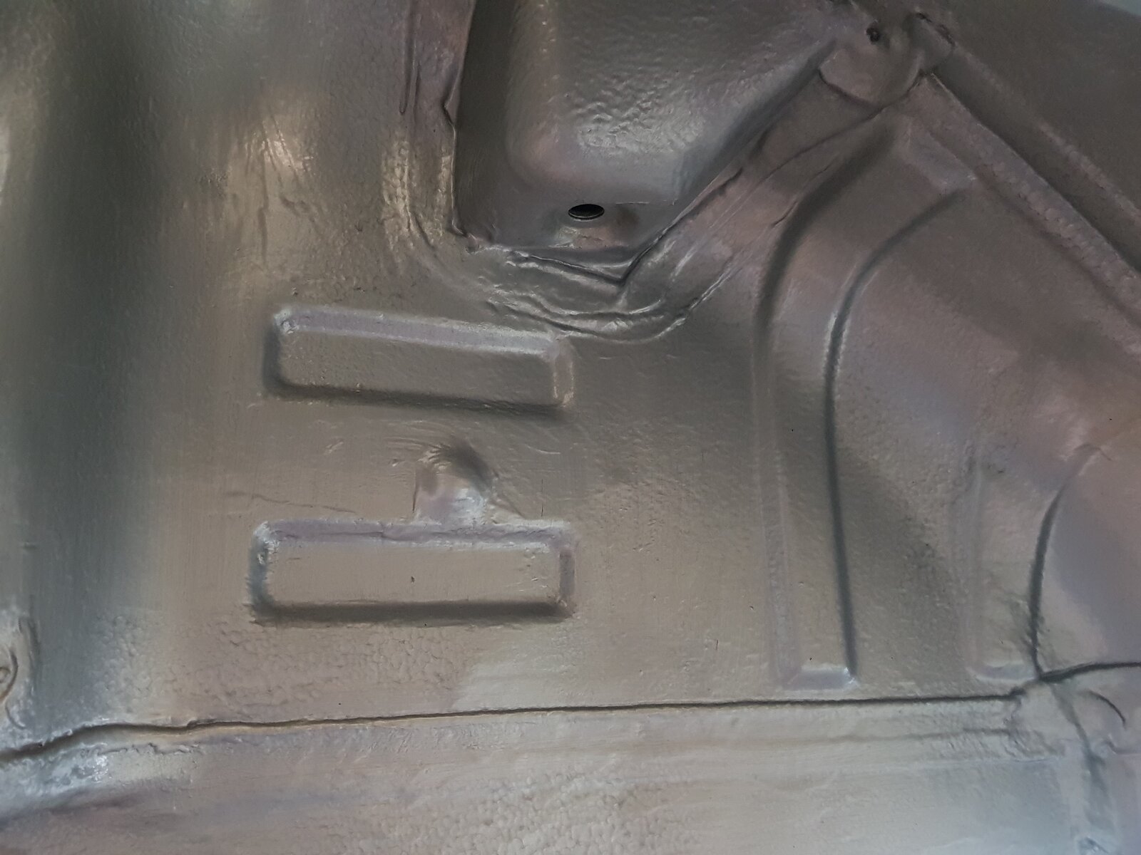

Rubbed the arch down etc (forgot to take proper pics of it all rubbed down but u get the idea) and 2 coats of Hammerite hammered Silver
Boot floor and other arch next

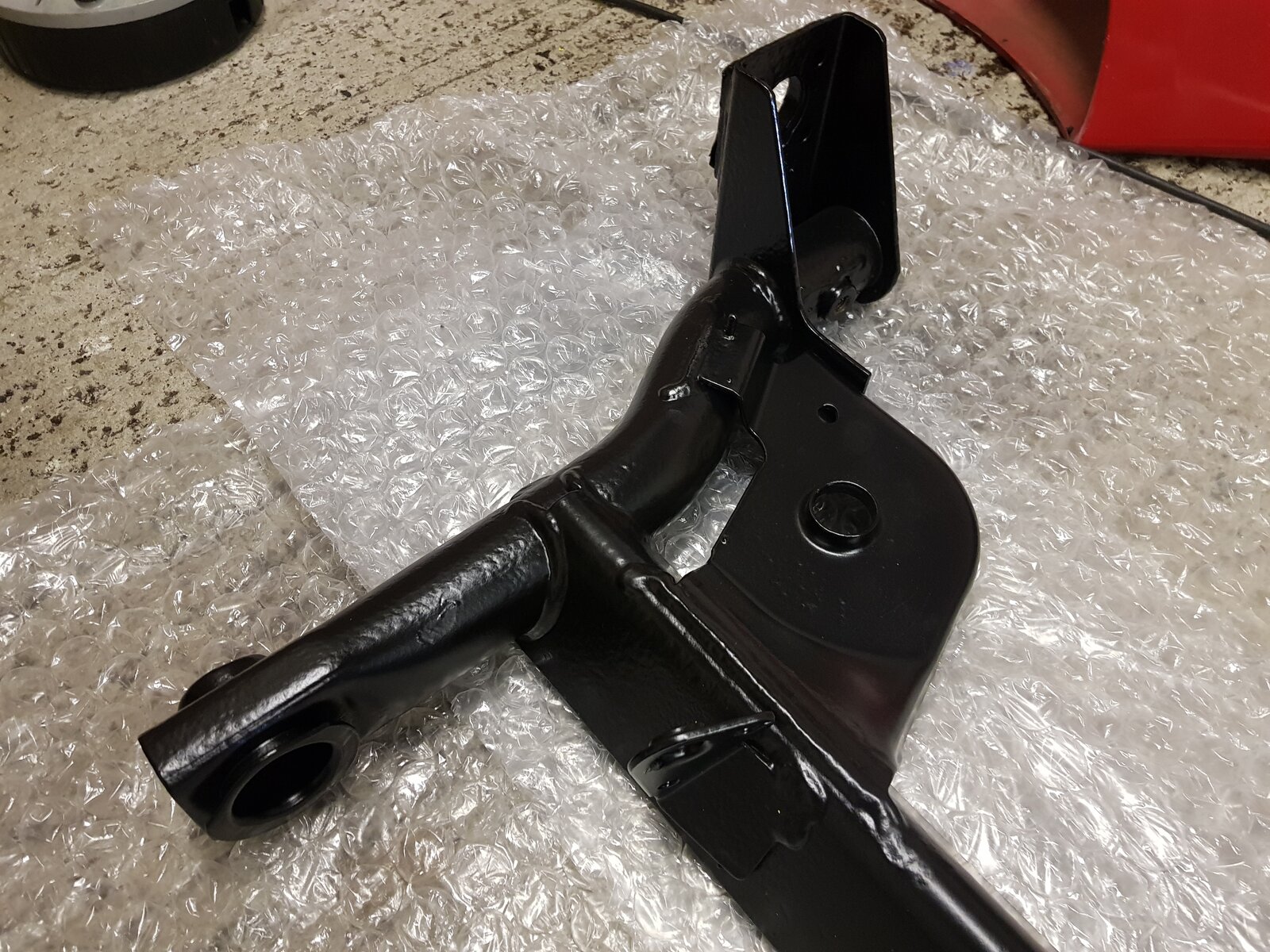

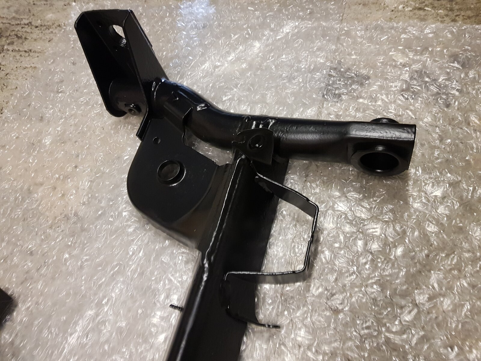

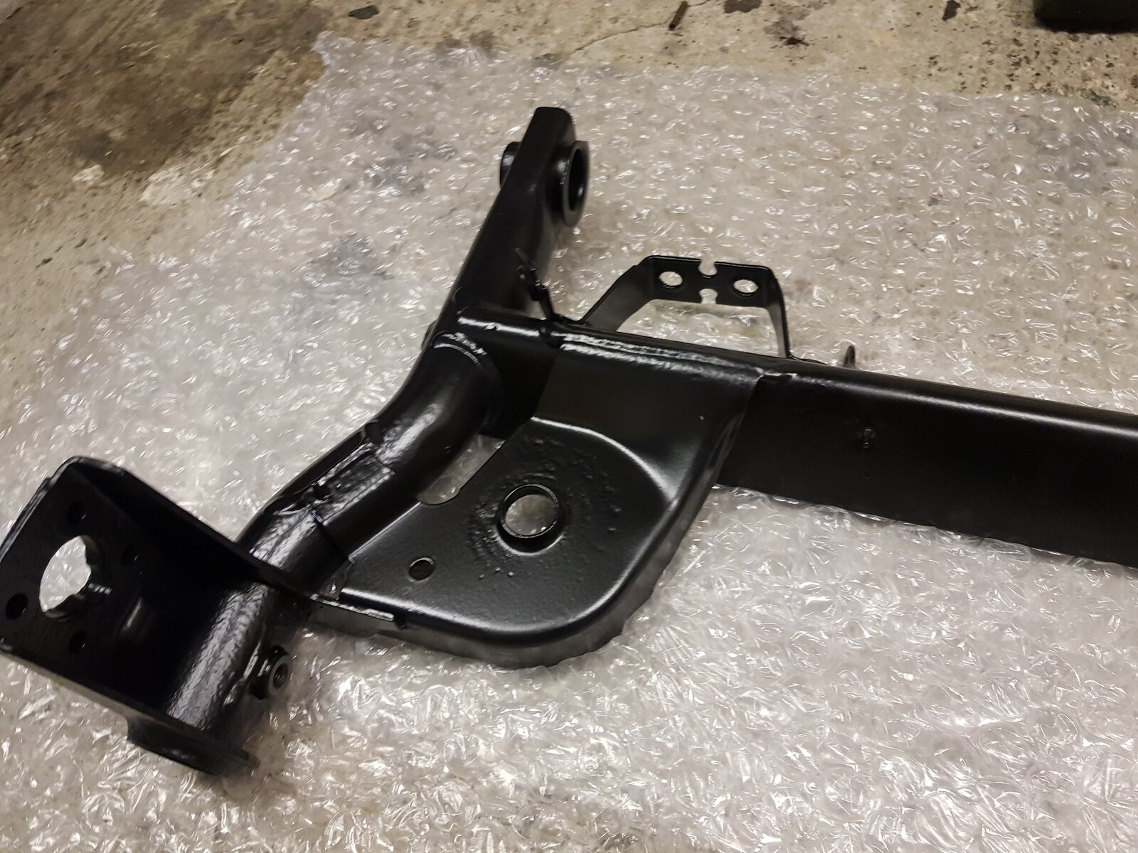

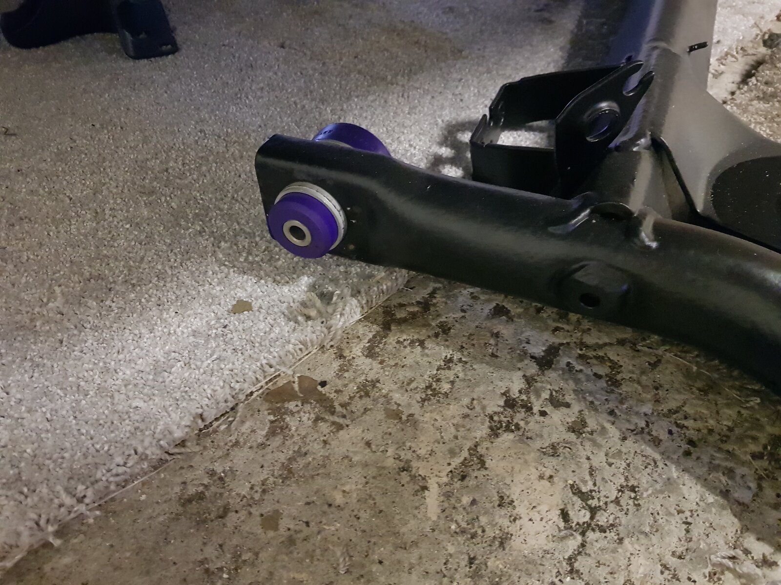

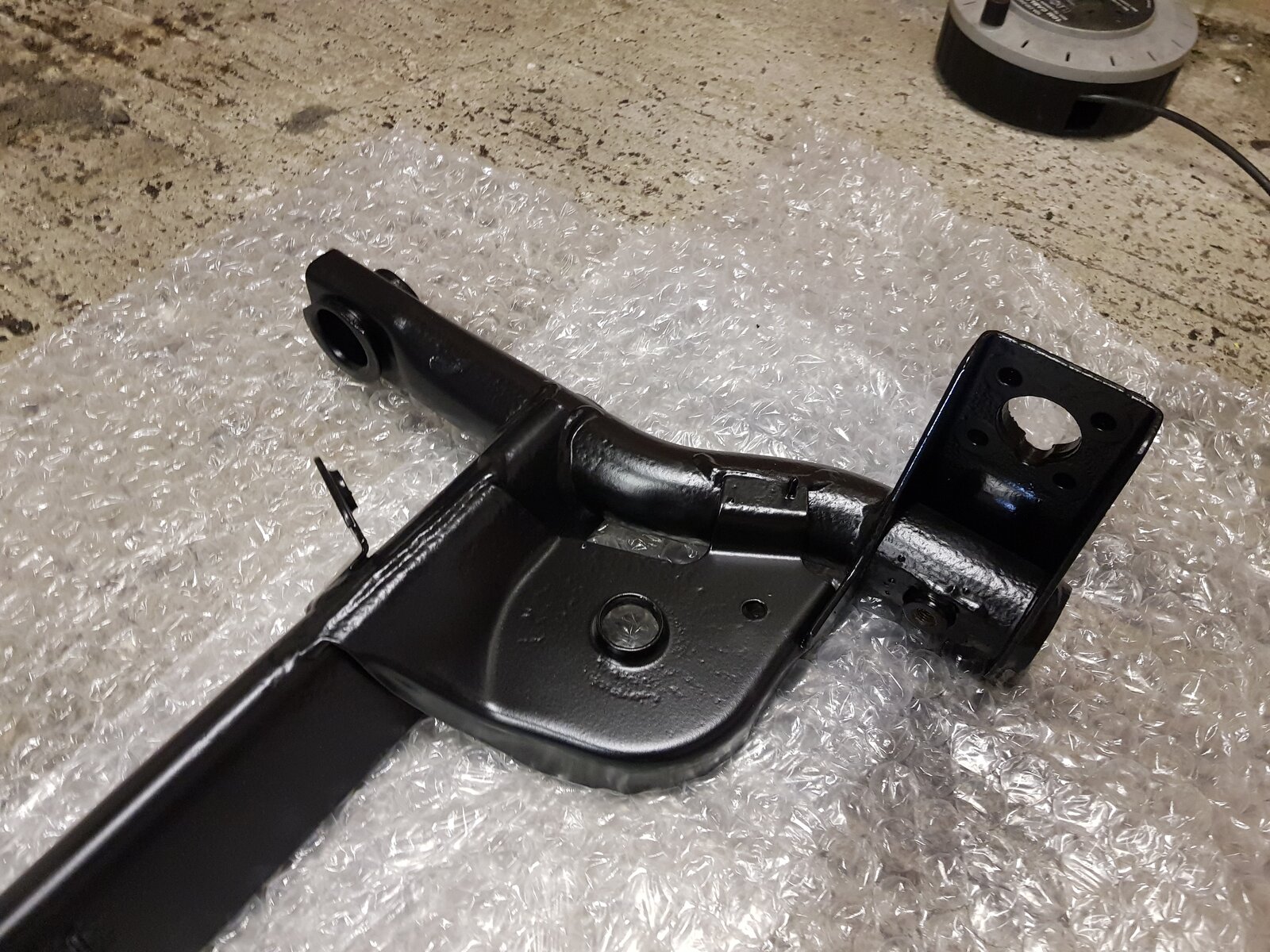

Need to go collect the rear beam etc from the powder coaters as that's ready too :)
Wish I had the proper space and money to do what you've done there! Looks awesome! Hopefully mine will look almost as good :D
After taking everything back ive used 2 coats of Hammerite Hammered (didn't want a smooth silver finish)
Had the same done with the rear axel which I need to collect, gone for a flat black which should match the new standard rear shocks and cooksport springs etc

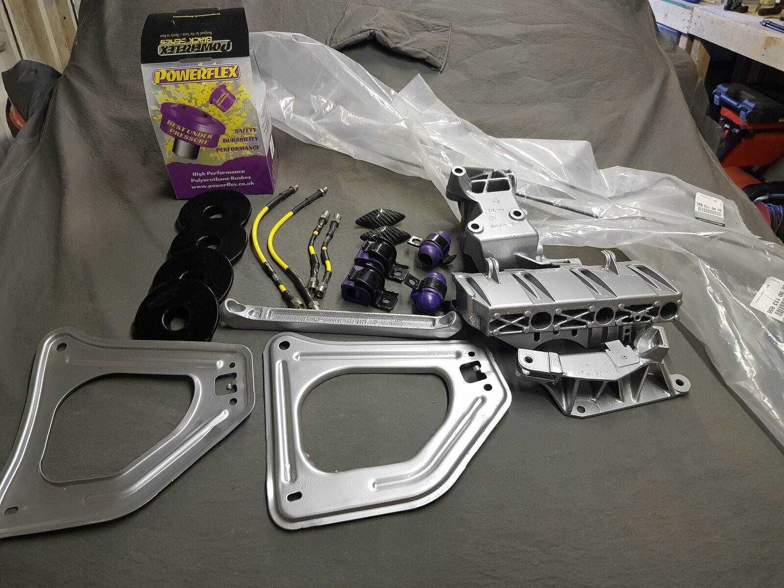

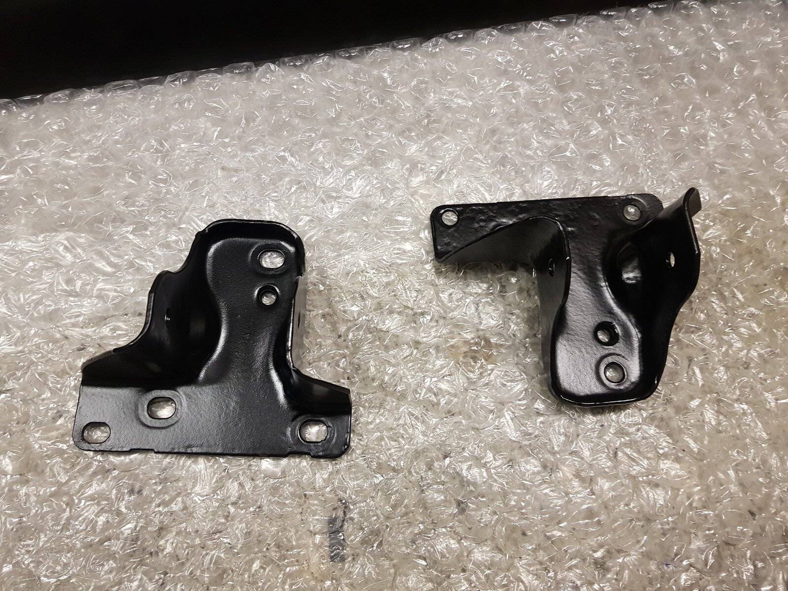

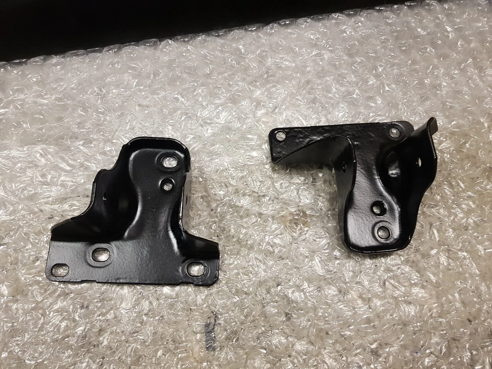

I have some bits you may be interested in. I can get some photos and send them to you. Saves you a job with some bits :). I have the 2 sub-frame braces powder coated Silver, ARB powdercoated Black (with PF bushes), couple of brackets etc.
Yes please, send me some pics and details if you would?
2nd dibs on ARB bushes please ☺

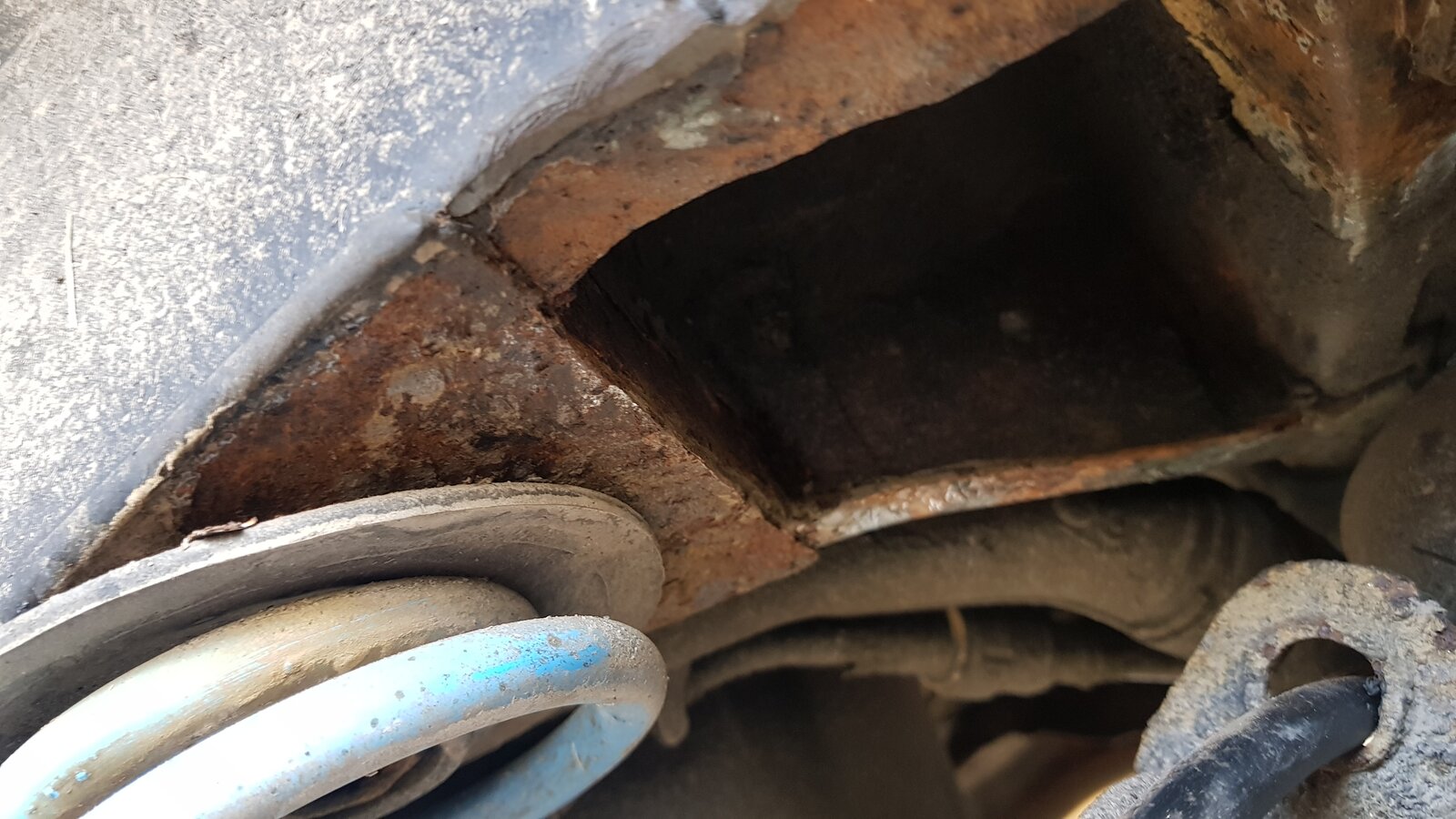

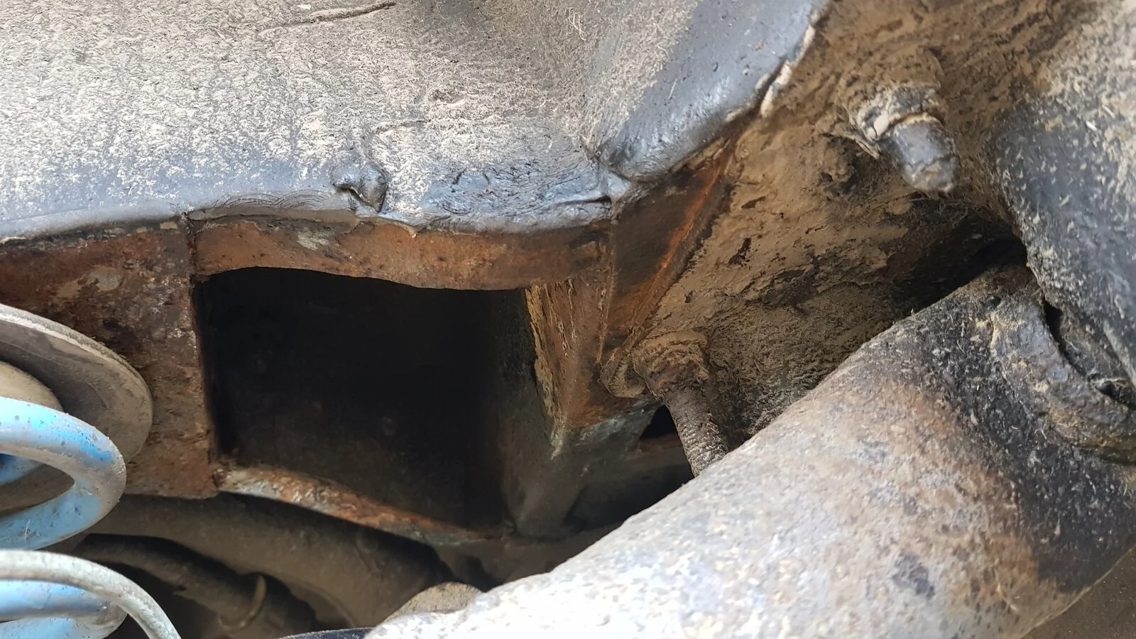

Great progress with these, I must pull my finger out and get the beam off. I replaced the OS handbrake cable which i found had corroded while replacing the caliper seals.
The shell rust where the beam mounts looks a little bit worse than I had hoped for, that and the few bits of dodgy bodywork are making me wonder what the hell I'm doing continuing with this car. If I'd been thinking straight a year ago I should have broken it and found a better one
Keep at it mate it will be worth it in the end! Aslong as the mounting for the rear axel is solid and you can treat it before refitting then keep on with it?

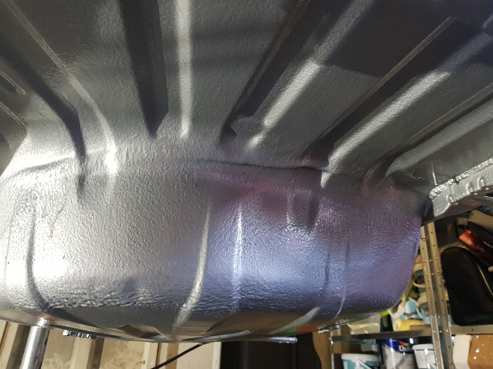

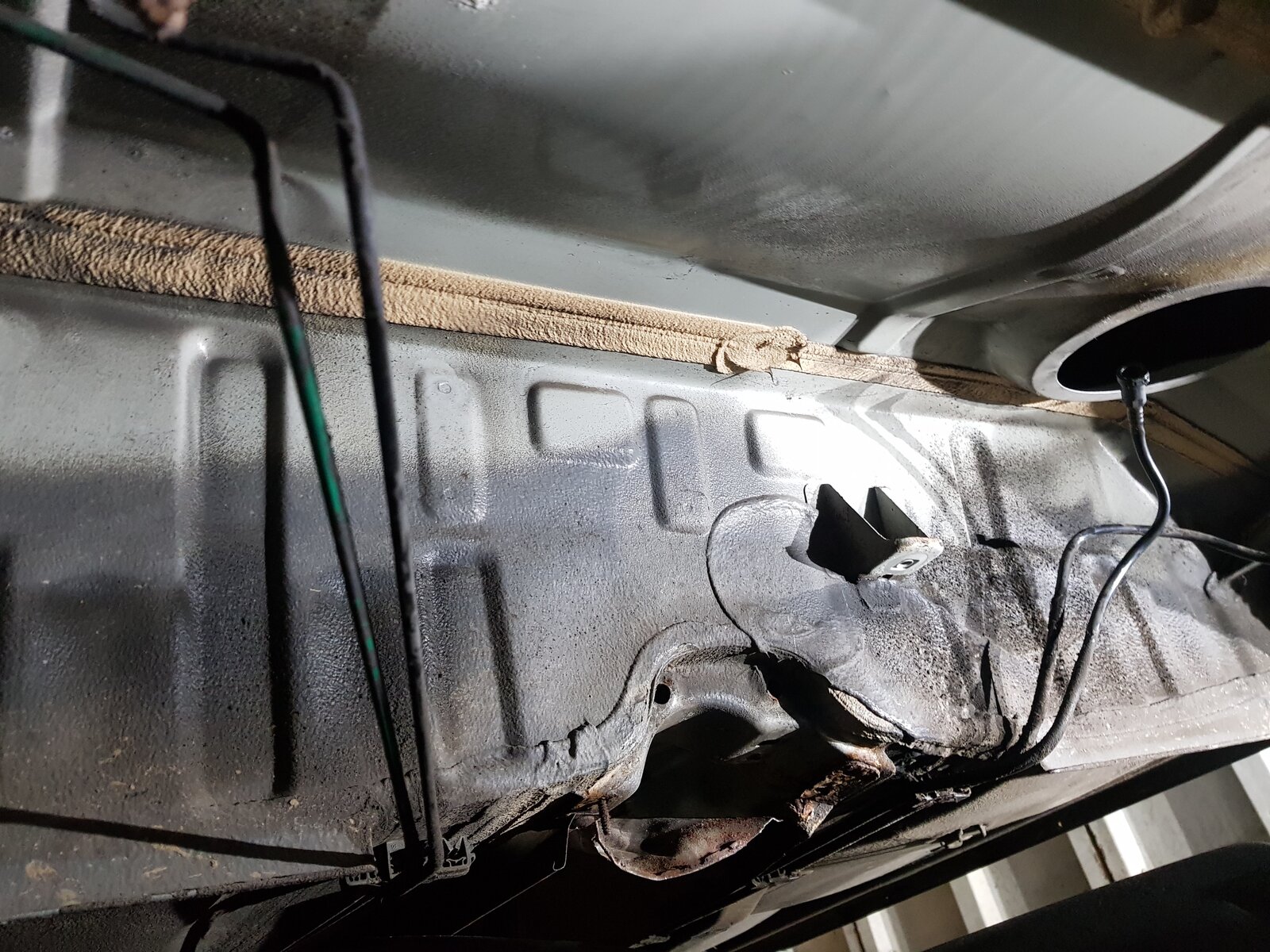

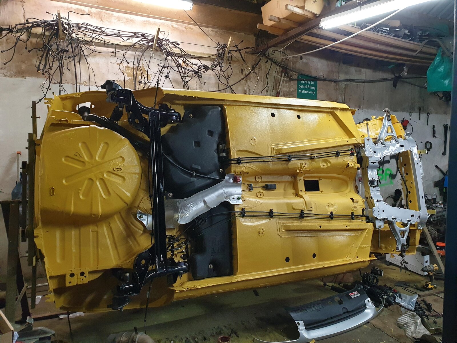

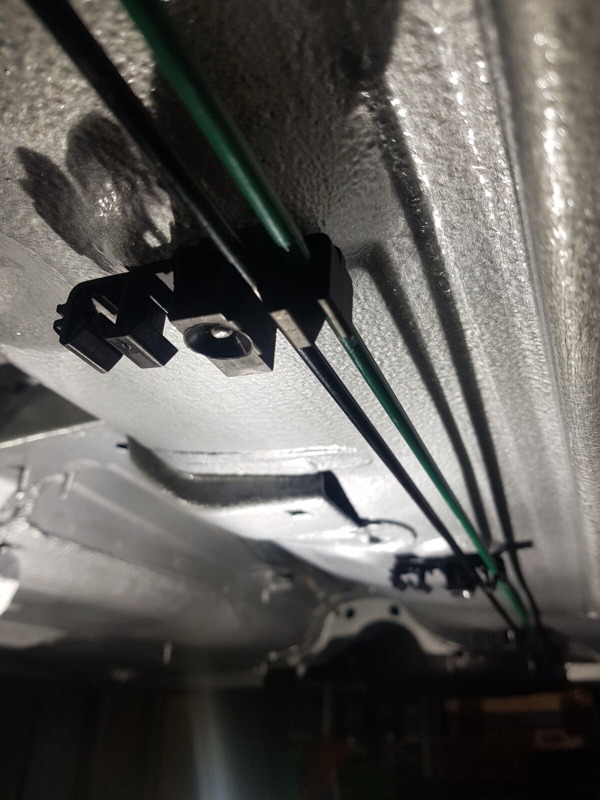

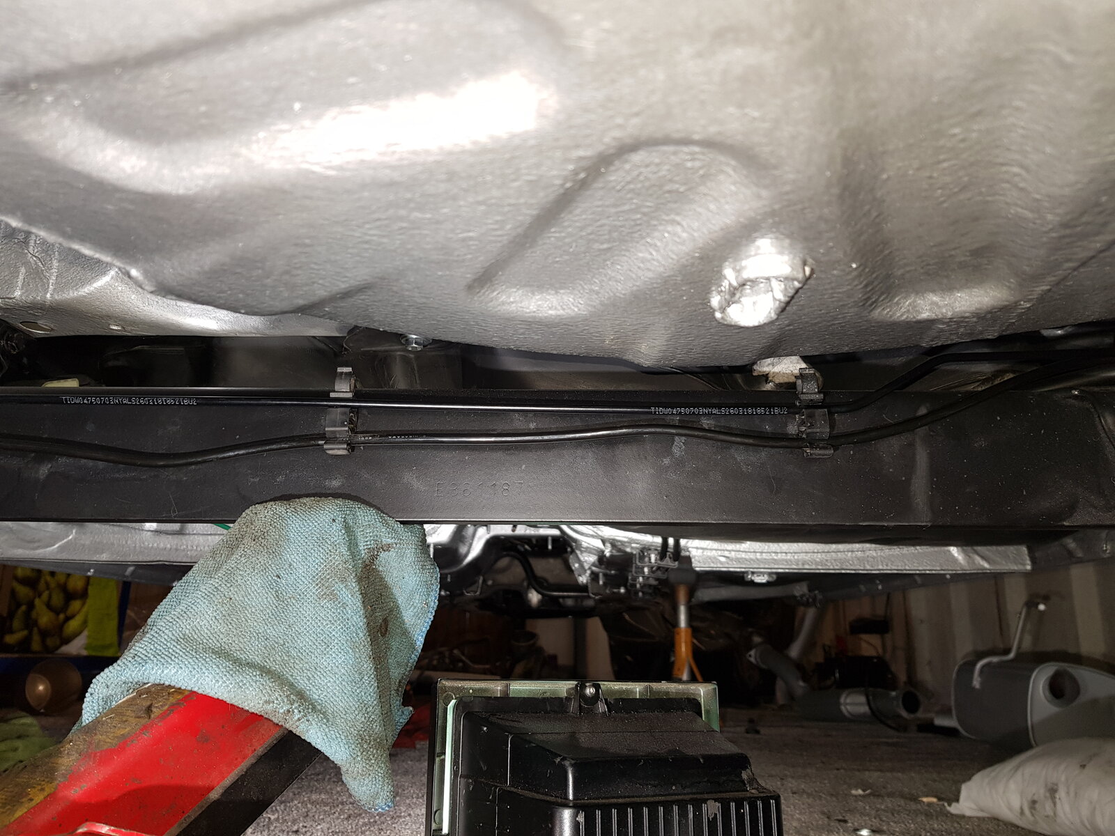

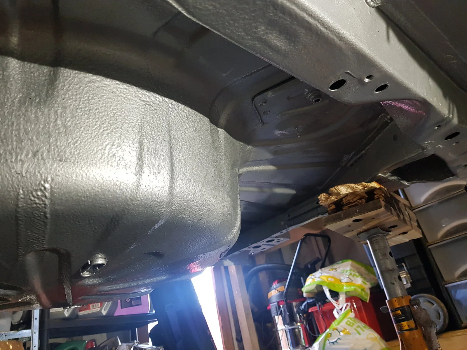

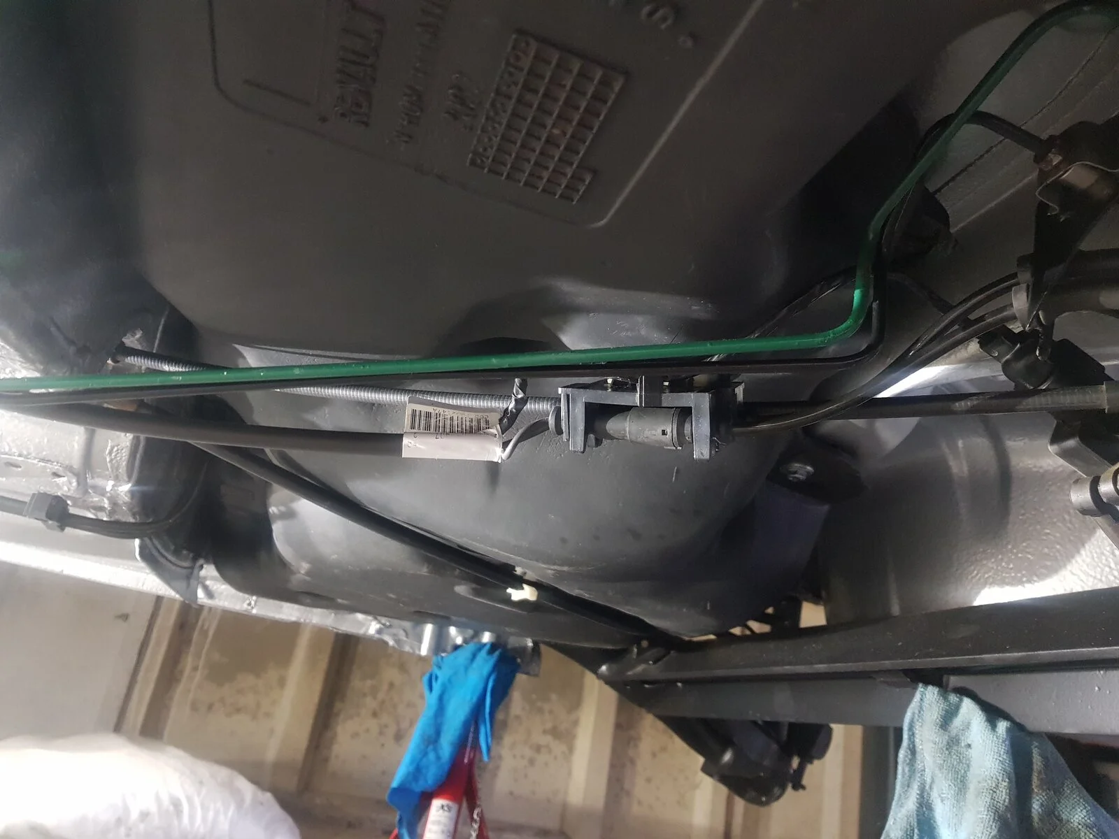

Bit more tonight...
Tank off, easy job to do and all the bolts came off relatively easy too.
Nice and tidy behind and luckily the only rust to really speak of is just surface rust behind the rear axel hinges/brackets which is easily sorted
Speaking of which collected the rear axel today and absolutely suited with it and only £50
Taking the front subframe too when it comes off
Next is to paint the boot floor and behind the tank so it all matches and the rear arches are done now
Bit more tonight...

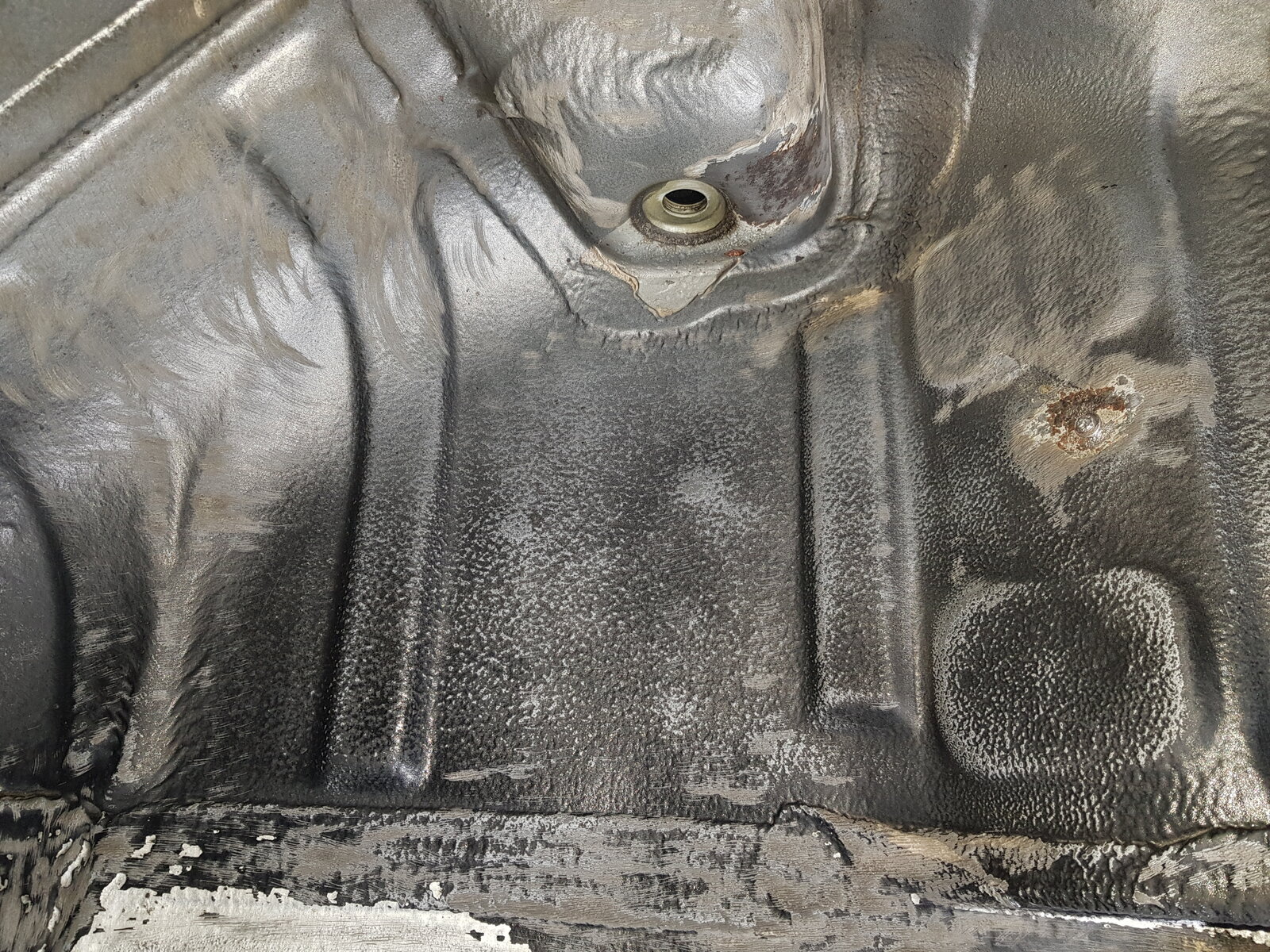

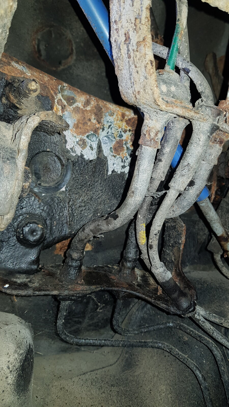

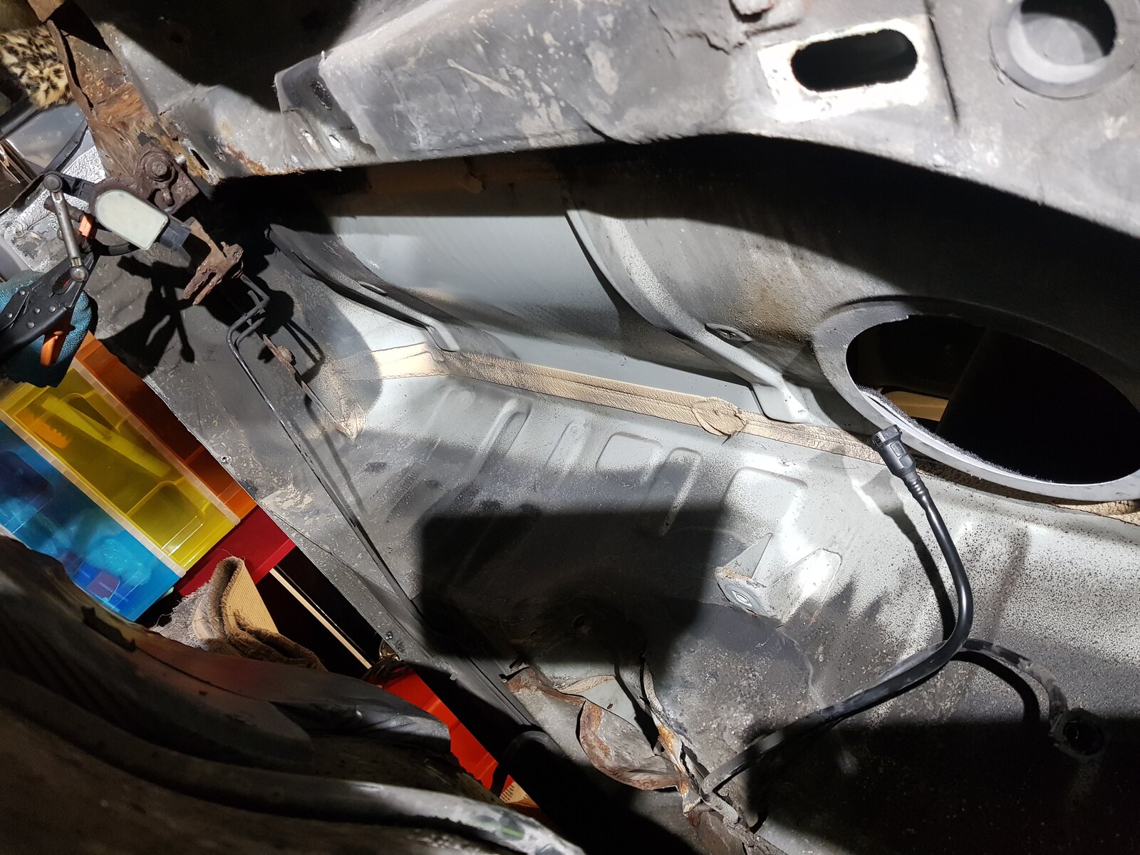

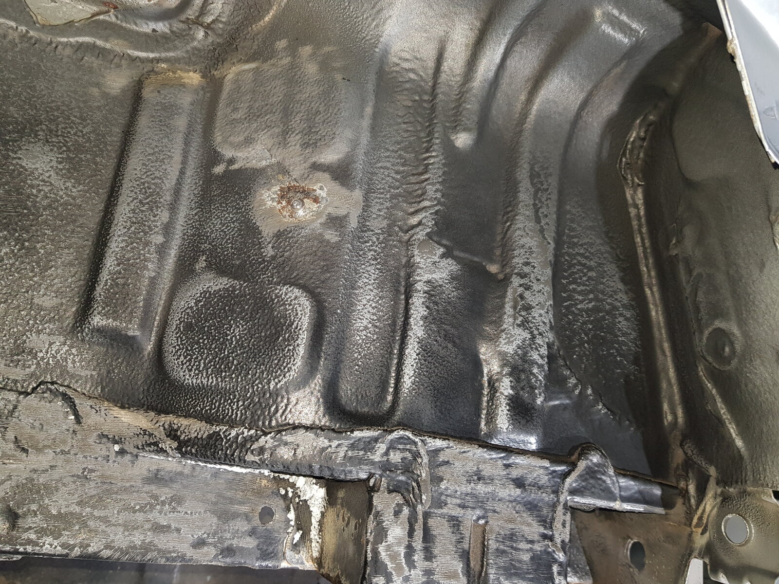

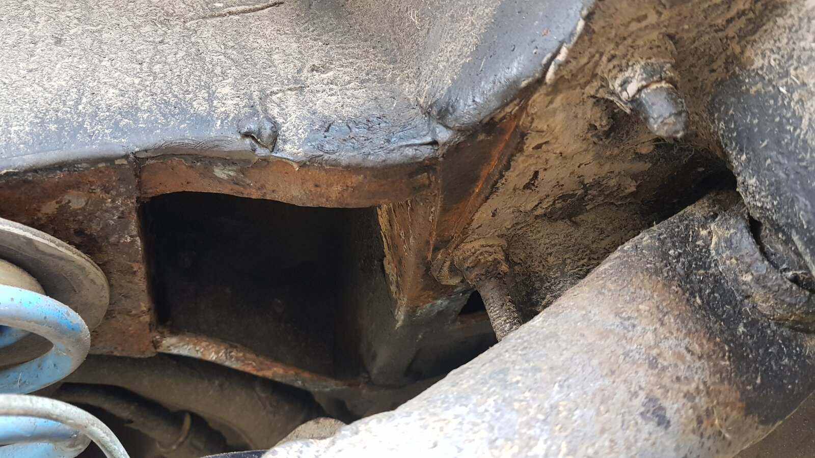

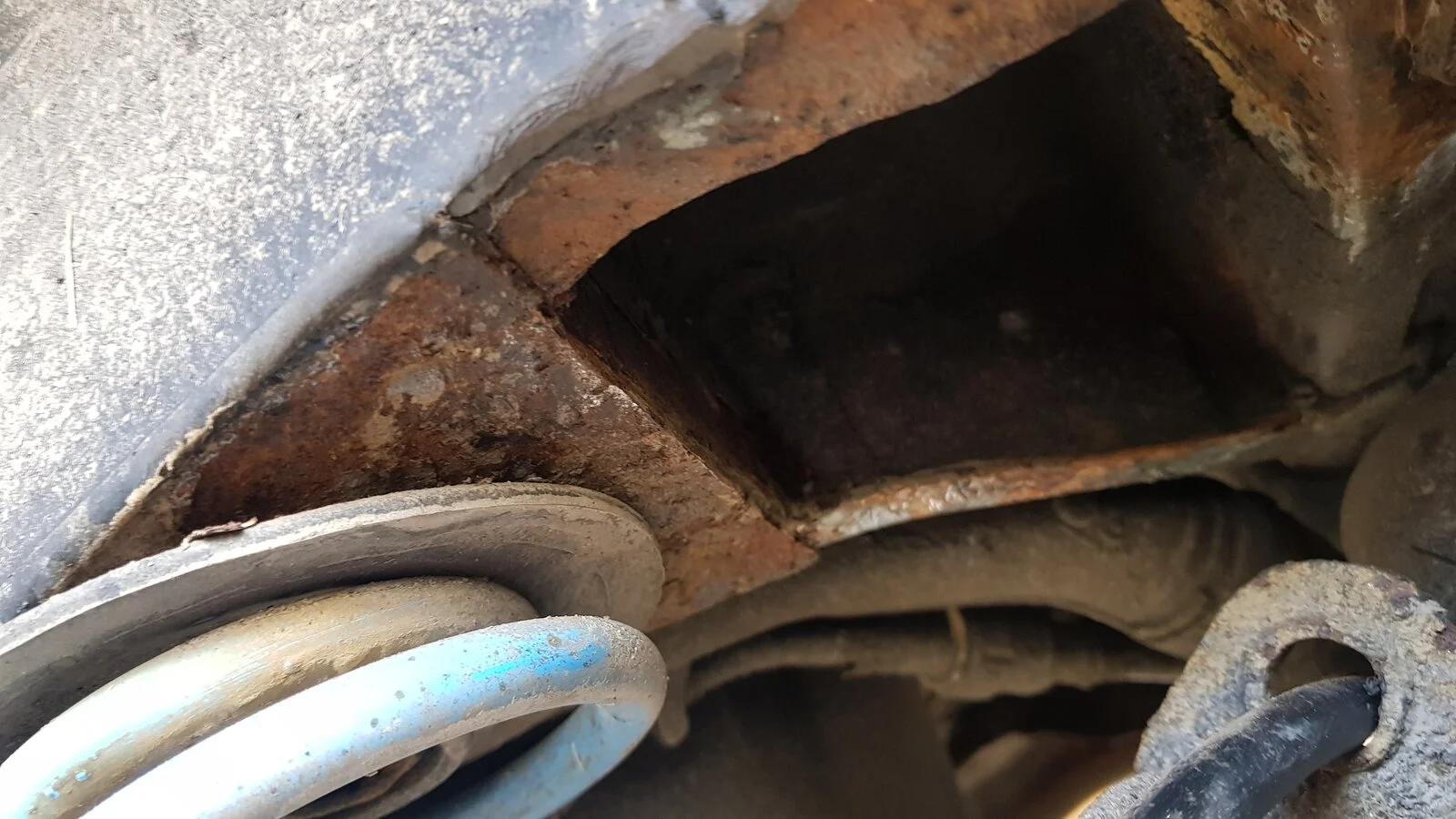

That's a lot you've got done there, how does my corrosion compare to yours?

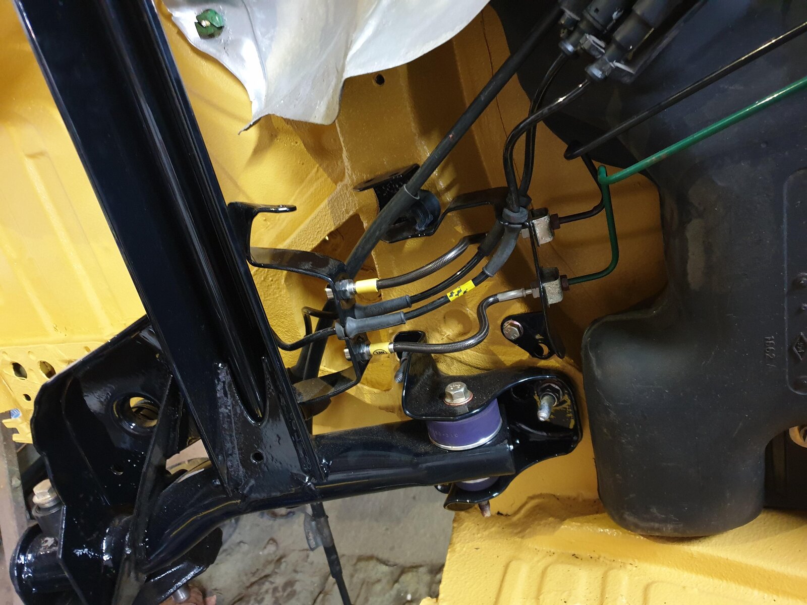

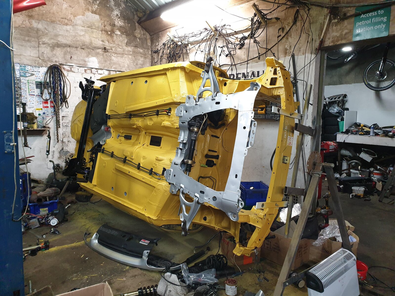

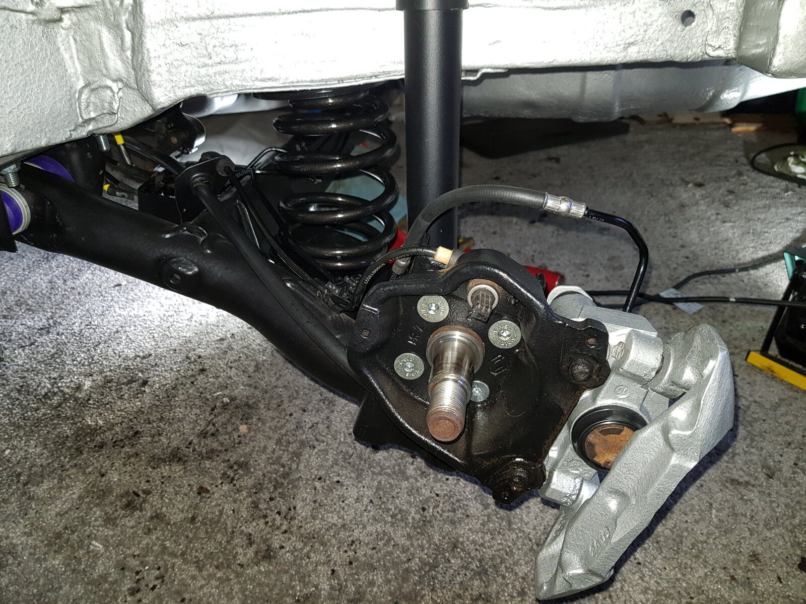

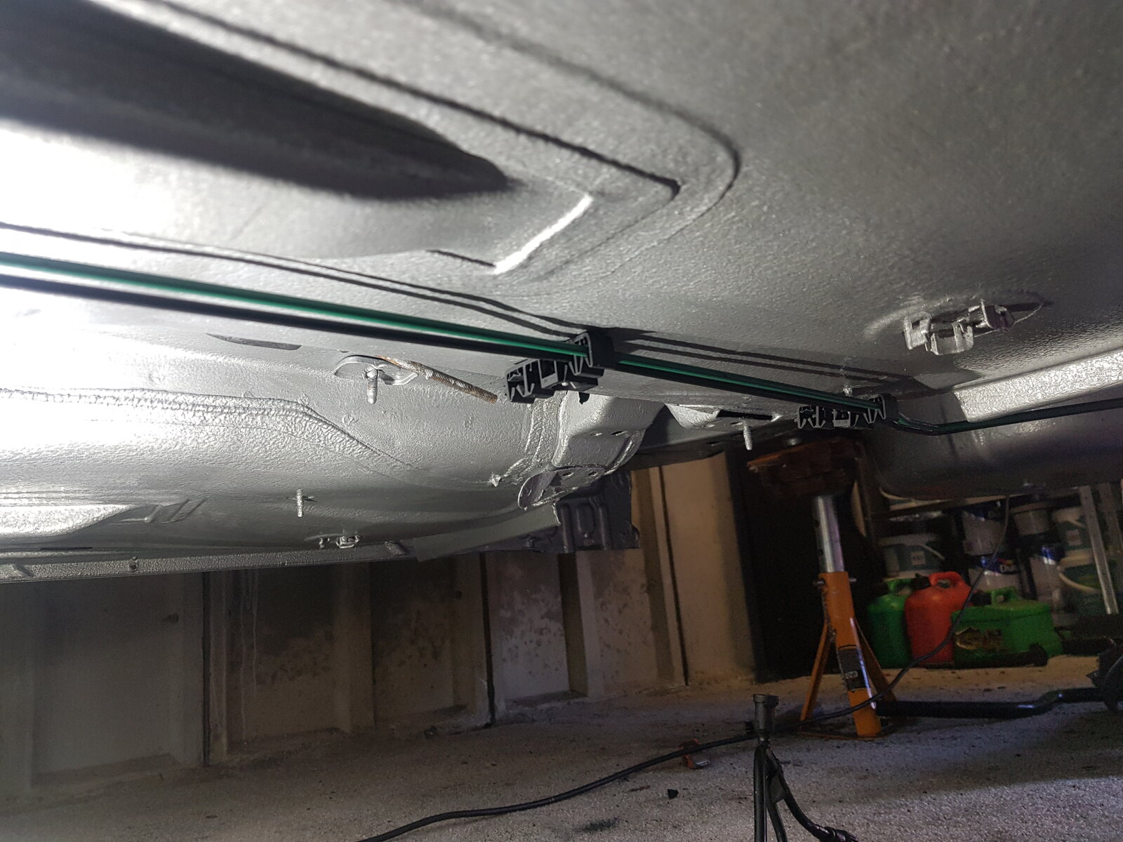

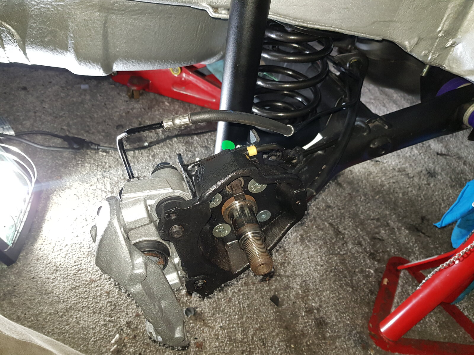

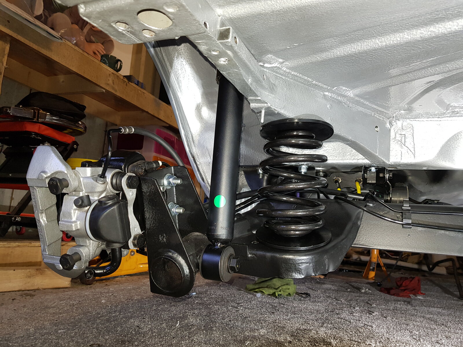

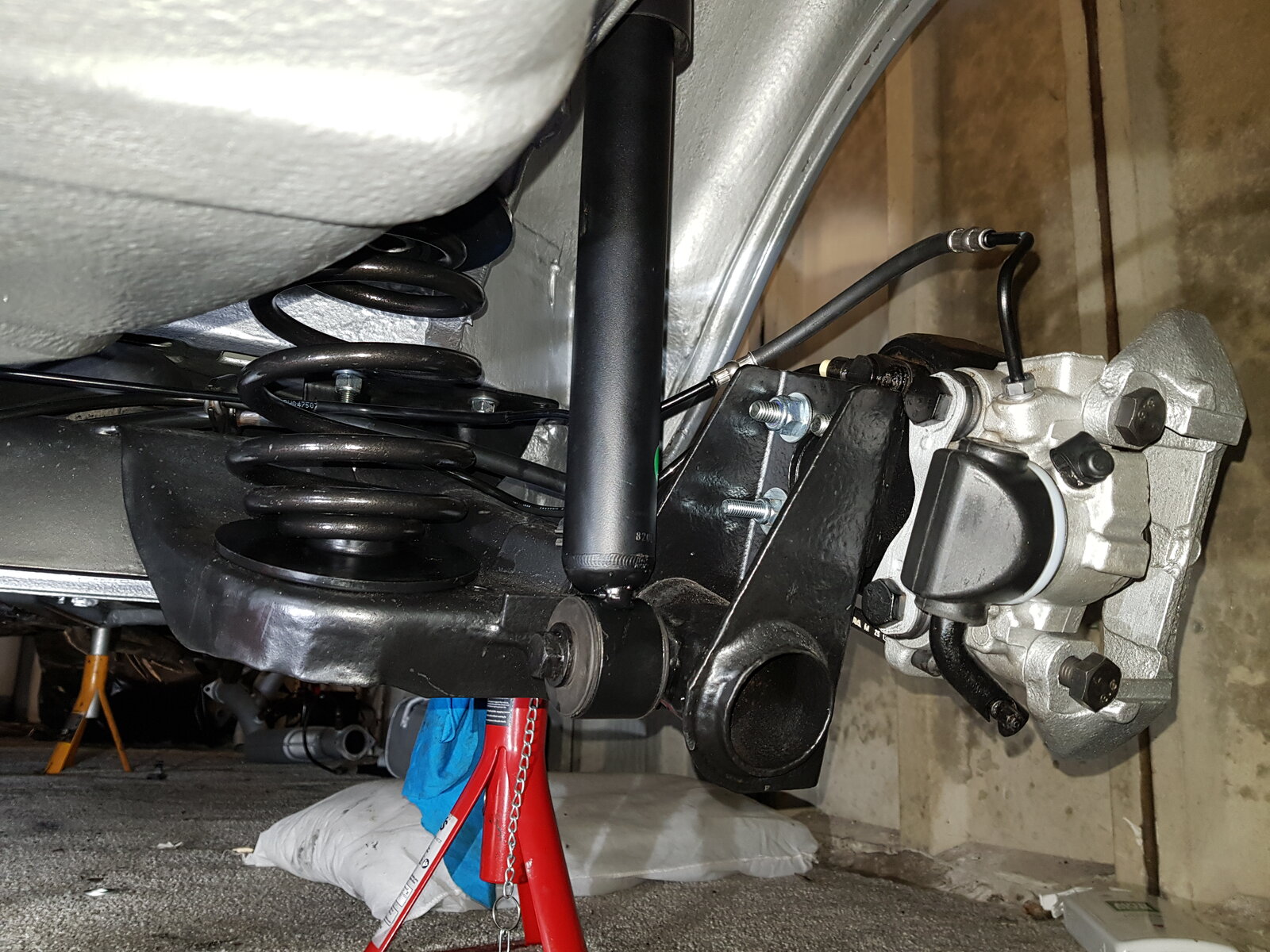

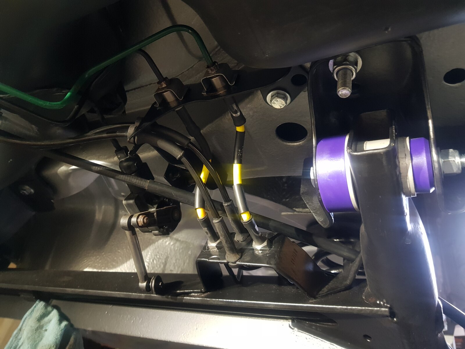

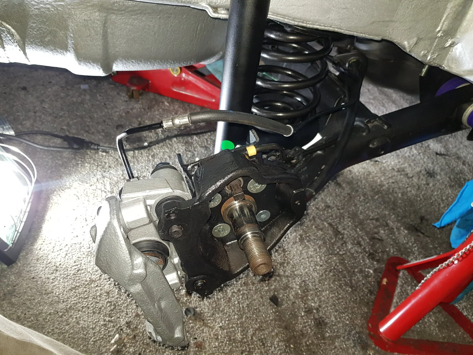

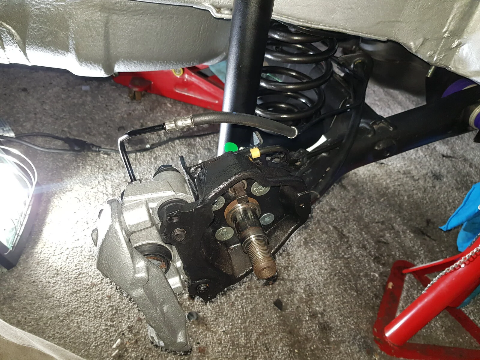

Thought I'd post a bit of an update

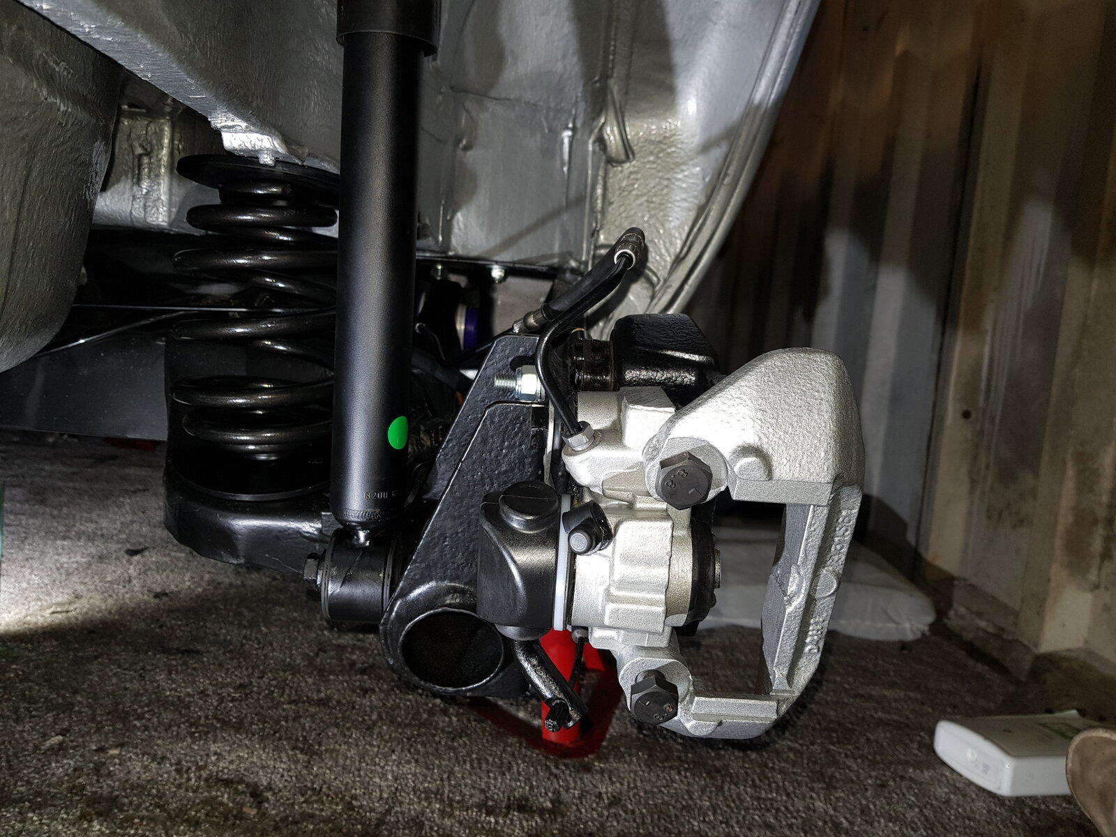

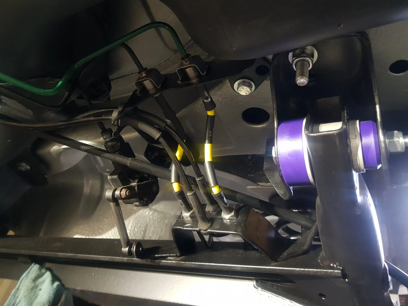

Rear end all back together barring the discs and pads. All new brake lines, new shocks , sensors and handbrake cables re-attached aswel plus some purple bushes for good measure on the axel and upper shock mounts
Just need to fit the discs and pads and final clean and then its onto the front end!
Saw this on Facebook, it’s giving me a poke to make more of an effort on my car! But like I said on faceache, I need some brake hoses!

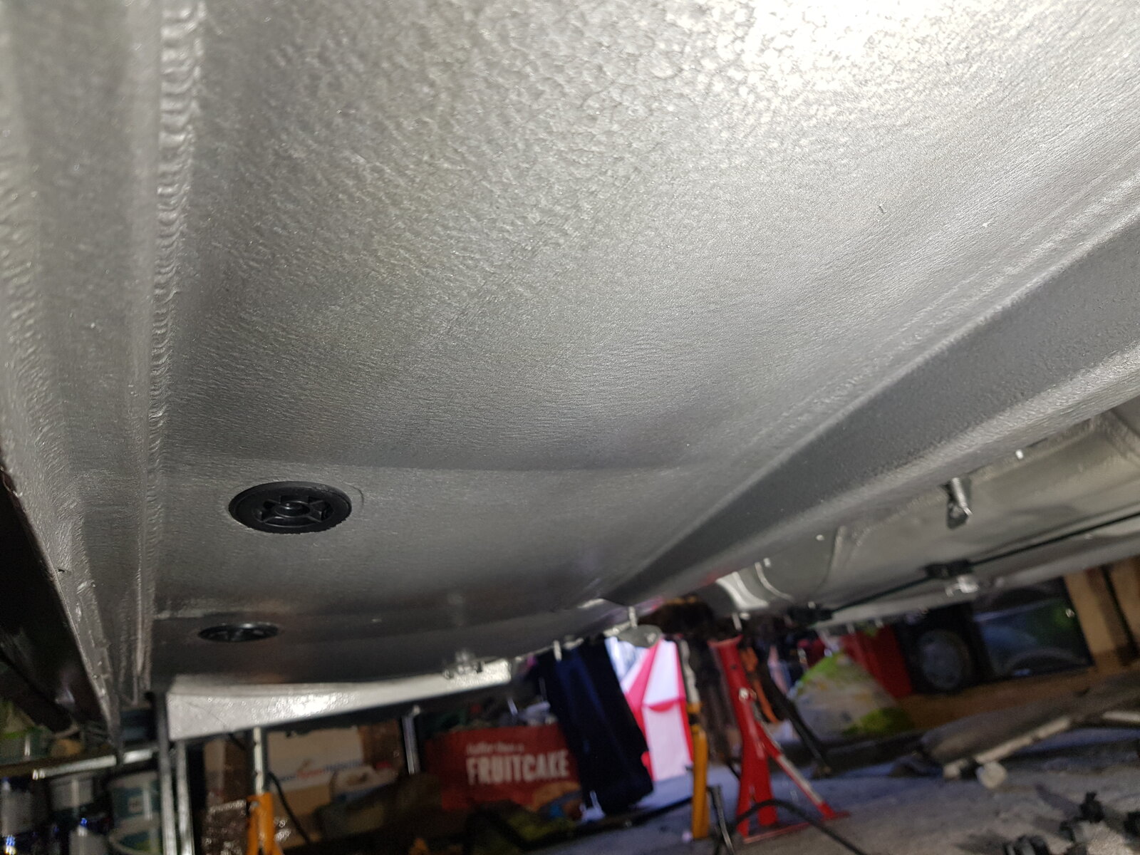

Is the underneath of the car all silver hammered hammerite? The underneath of my Mk2 XR2 has been done in black hammerite with all the bolt on components powder coated black with new bushes, brake lines etc. The arches have been painted in black hammerite for the last 20yrs and still look pretty much the same now!! Great stuff and seems very good at preventing corrosion.

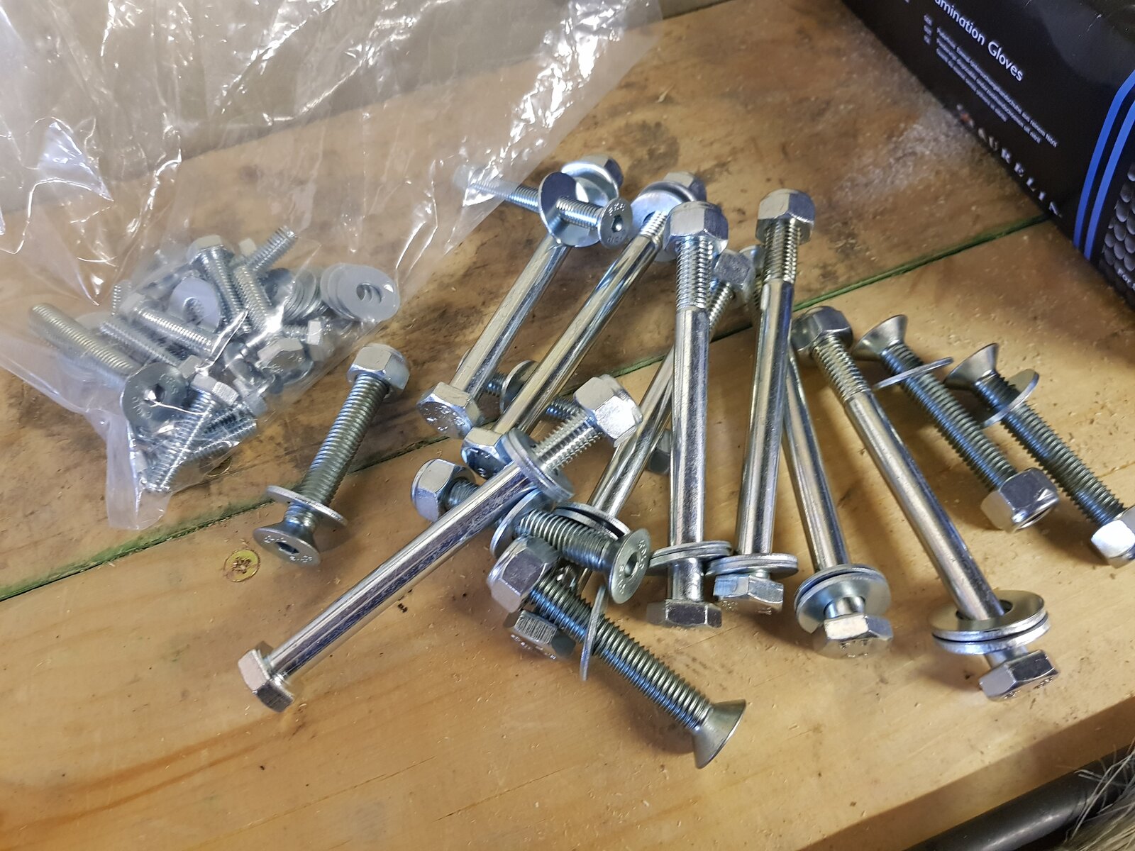

The underneath of your car looks fantastic. Bet it is really satisfying putting it all back together. Where did you get all the new bolts from? Keep the updates coming 👍
That's it, the floor has all been done in Hammerite Hammered Silver and the 95% of the rest is either powder coated or brand new! The other 5% is the odd bolt that's had a lick of black and sensors that have been cleaned and reused
Was really satisfying to out back together and looking forward to doing the front end now, subframe off etc and fitting the new suspension too
