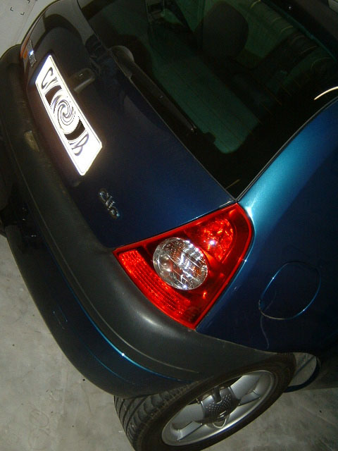

How easy is it to fit mk2 ph2 lights on a ph1? I am correct in saying you need to slightly re-wire the lights???
Thanks :cool:
we are talking rear lights...
yes you do, i think you can pull the wires out of the connector and swap them around. Did it a while ago on a v6 so i cant really remember. Multimeter and half an hour and you should be sorted

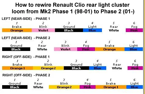

yeah rear lights sorry! I knw there is a wiring diagram floating about, does anybody have the link to it?
^^ great guide - here is the wiring diagram that I have:
Flat blade screwdriver and your hands.
It's really easy to do mate :D
Some of the wires *might* be different colours to that in the guide but common sense should see you through!
Its easy, just be careful not to snap the clips off the end of the wires when removing them from the connectors.
lol ^^ ive gotta try this soon, i went to the breakers to get the right kit but came away with the 2 bulb holders and one offside lense lol what a moron :D
