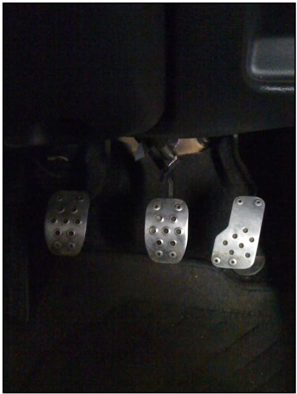

Only a quick one, acc. pedal has been moved closer to aid my heal-to-toe, Its around 10/15mm closer and has had 3mm of spacers to lift it up, gotta say i should have done this along time ago!

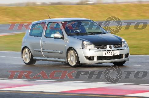

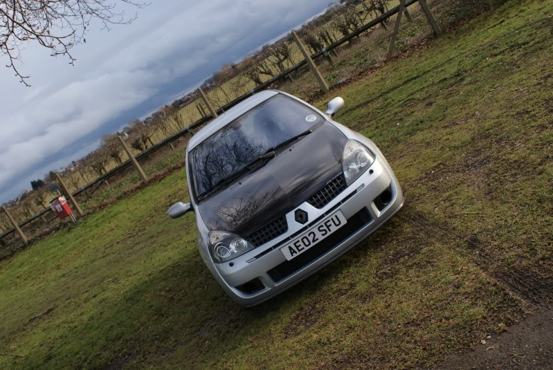

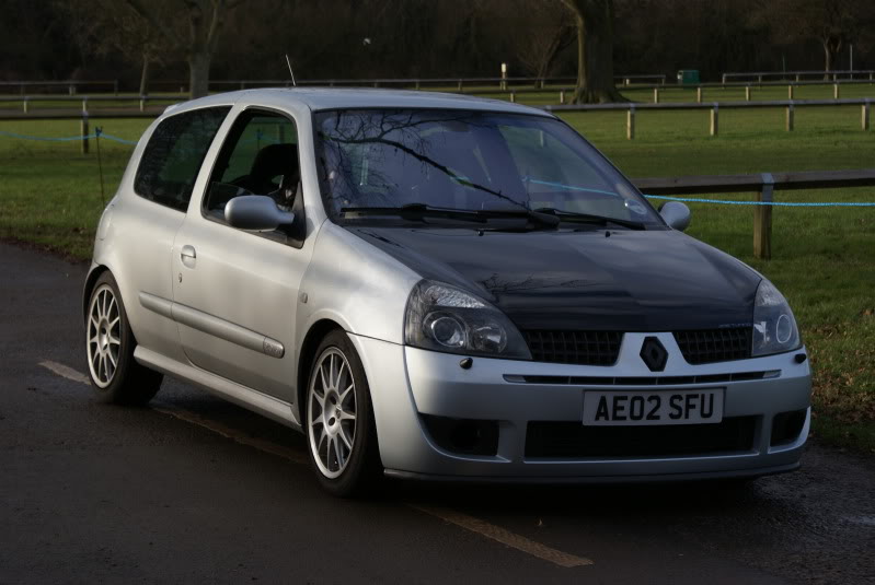

As a few know i've gone through a few bonnets the past few weeks, had aero catches on one for a while but with the amount of time on the rollers & tweaking with the car i missed the simple Renault catch ( although yes it has been known to fail epic style lol ) so wanted back to the old ways but not the old weight so Matt at Stealthsport got me one of his latest versions to try out, So trial fitting started in turn to get it ready for paint but as i did i began to like the black on silver effect, so for the time being i've decided to run it just in the gel coat finish, firstly as it saves weight not painting it & i now drive round looking rude boy :rasp:
Think some black speedline 2118's would set it off.... we shall see ;)

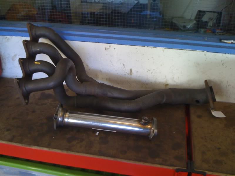

4-2-1 Manifold & adaptor pipe
Map needs work to suit, hopefully have that side of things under way in the coming weeks!

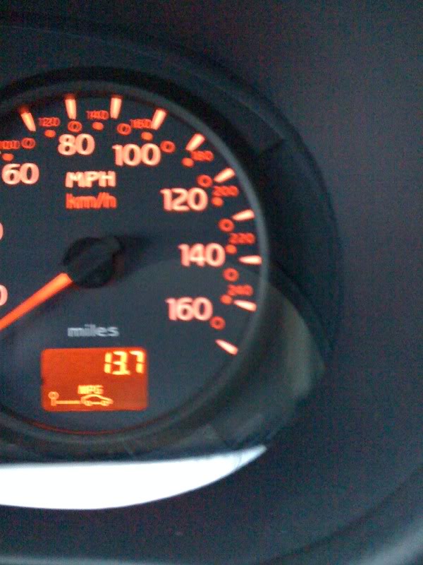

Reset the trip computer on the first lap, And the result at the end of the day.................
Ouch!
The car will be having alot of changes this year & hopefully alot more track time!

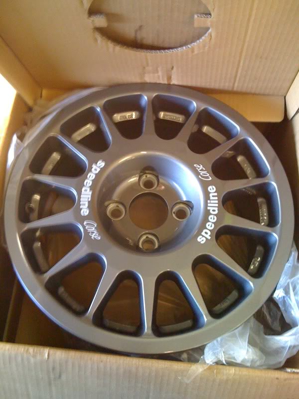

Lost 4 hours of my life & used a c**ktail of lethal cleaners trying to bring them back to glory! may send them away to be re-stored as there still not perfect but they now serve me as daily driver wheels, Speedline 2118's have been ordered so i now have the option to wrap them up in some thing special, shame R888's are so dear now :dapprove:

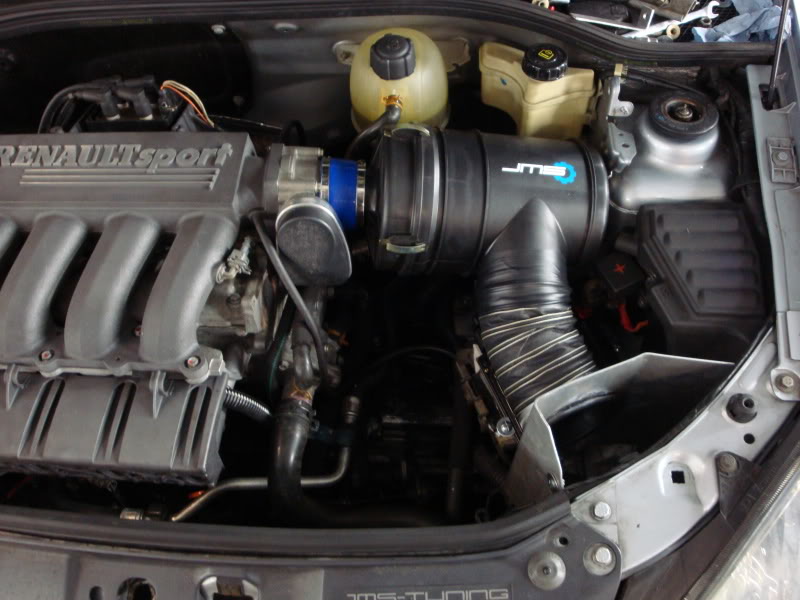

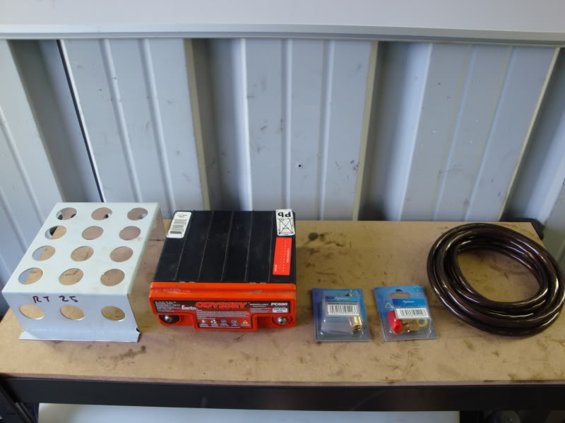

Ever since my old PH1 track car ( http://www.cliosport.net/forum/showthread.php?t=365856 ) i've wanted to get the batterey out of the engine bay & get a nice run for induction side of things....
So a race cell, cage & fixings were bought
So with some ali sheet, CAF, screws, ducting tape, trumpet & a few other random bits i moved the airbox straight onto the TB & mounted the ecu under the airbox & moved the batterey to under the seat, the result -
Still needs some finishing touches but the basic idea works for RR testing now to see if the gains are worth the work, Car certainly feels better but it could all be in the mind so wont say any more till its on the rollers ;)
The noise is un-real!

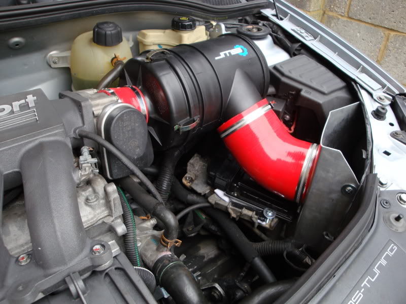

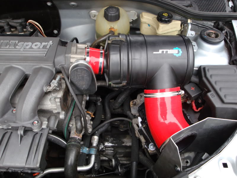

So the new set-up has over 150 miles of road testing and i must say it does feel so keen to go, So moving on with the finishing touches!
I dropped into SFS this morning to get some pipe work made up as the ebay ducting was far from a tidy finish but it served well as the test part
The new joiner & cold air feed
The noise is just insane, so different to the previous set-up, can only put it down to the 102mm cold air feed working the induction noise like an echo, either way, really happy with the out come, just gotta finish the ECU mounting bracket & i'm done & ready for the rollers

Has been on the cards since I tried it on my old PH1 172, Don't think there's any better way you could run the set-up, moving the battery under the seat was the big factor stopping me originally
what sorta cost were the hoses for that setup? was thinking of doing something like that meself/QUOTE]
Depends where you get them from, If we get the results on the rollers i'll be putting a kit together through JMS which would include all the heat shield, pipes & airbox etc, Heat shield is being sent away to be done by a fabrication shop as my version is a little messy to be the finished item ;)
