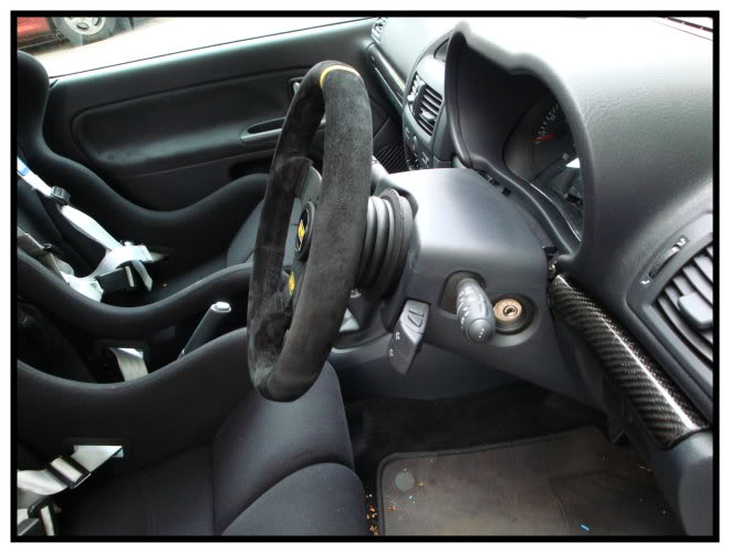

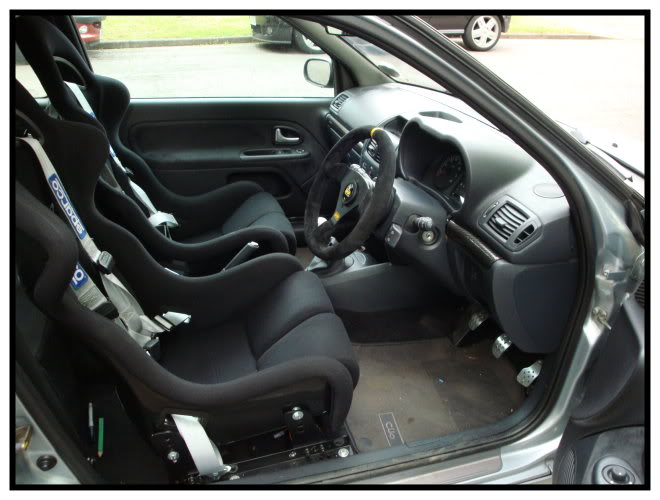

New toy arrived in the post for the money pit this morning :D now ever since installing buckets i knew i needed a better steering wheel, I was set on the Cup racer one but after seeing an omp one on Adamio's project thread i decided the OMP was the way forward so walla!
Very happy with it & i think thats a rap for the interior, next on the list -fiberglass pannels :cool:

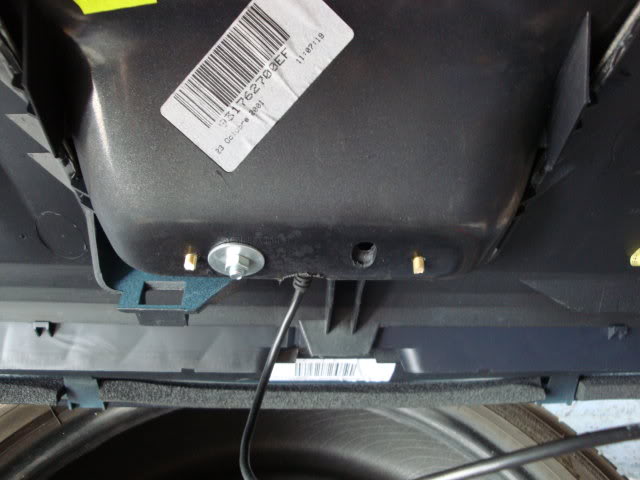

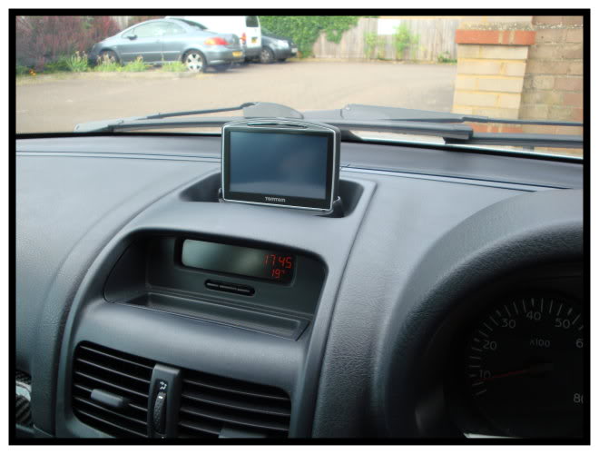

This weeks new toy, Tomtom 730, old satnav gave up on life while driving round London, not impressed..

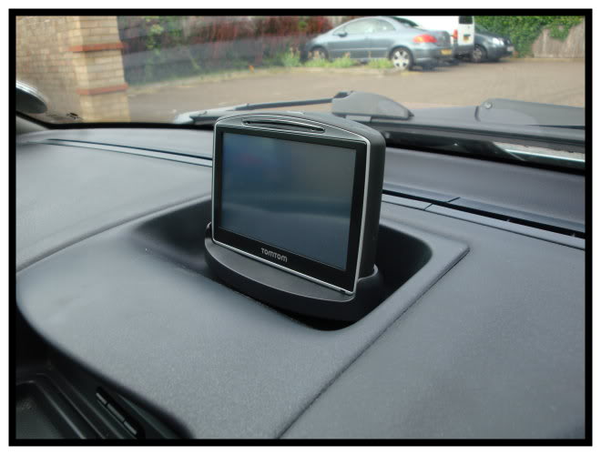

Ever since my first satnav i have hated mounting them on the window for that mini-cab look so a new smarter method was needed, better than my previous method which proved a nightmare when in 5th gear

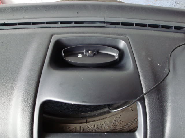

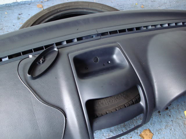

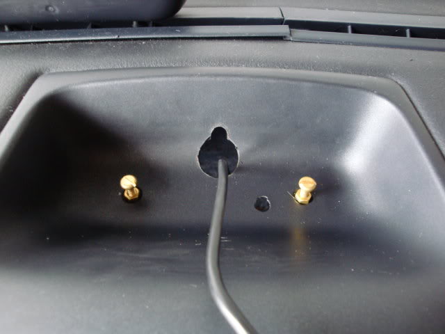

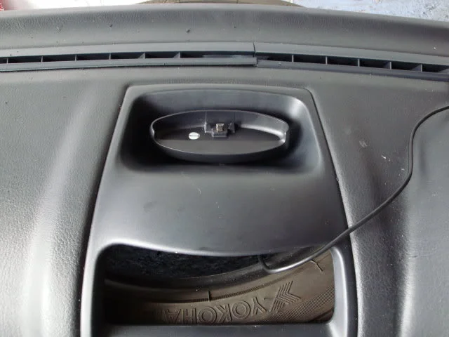

So my brother came up with a smart idea - Mount it on the desk stand in one of the dash board pockets, so with the plan in mind i sat around for half an hour trying to work out the best method of instal that would involve no long term damage if i ever need to remove it all... with it all thought up, work began
First off, remove the upper part of the dash, pull the rubber pocket liner out and send a 20mm holesaw through the back of the dash, low enough that if the rubber lining went back in it would cover the hole

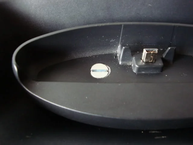

Next, clean it all up and make a hole for the cable to sit in, also added a pair of M4 screws and bolts so the height could be adjustable

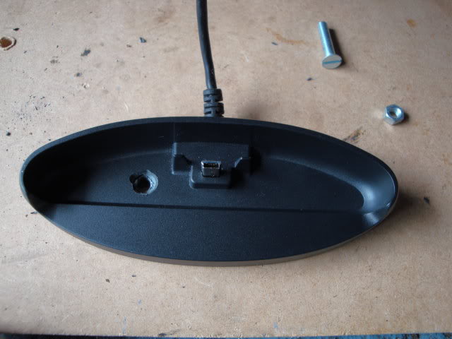

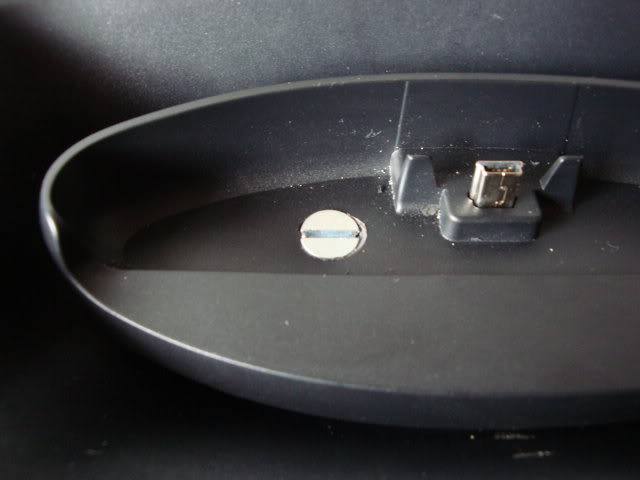

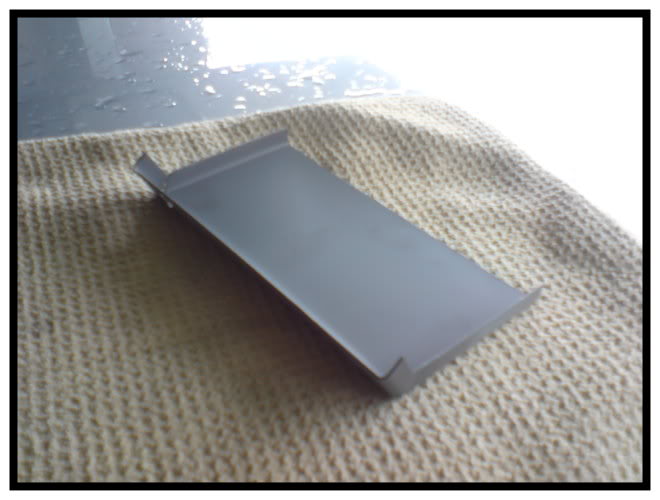

Now for the 1 day old desk mount to recieve some love, 6mm hole, countersunk
added a counter sunk 6mm screw, bolt & few washers to clamp it all down with
Shot of the underside
All ready to go back in the car
With that all complete i managed to find a good route for the power cable straight down to a 12v source, so bolted all the dash back in & did a quick trial fit, the result
No cables, no sucker, no mess ;)

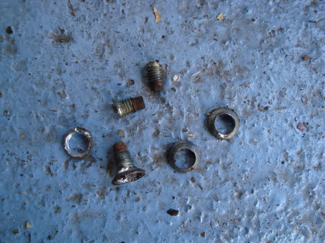

Next job, Remove the old warped brembo discs and instal some new discs, this didnt go to plan, disc bolts were all siezed, not even the impact gun would budge them so out came the HSS drill bits
No damge to the threads, Just needed x4 new disc screws, Glad to have all the vibration gone when braking from anything above 50mph

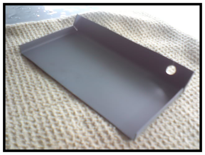

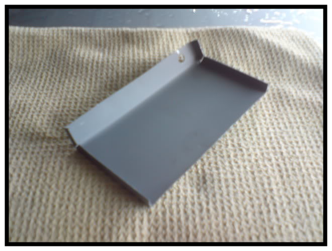

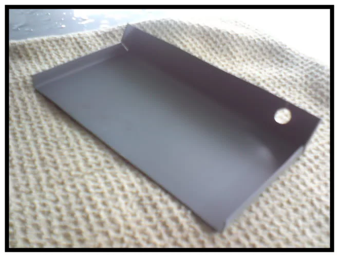

Also finished up Version 2 of the brake cooling scoops, much smarter, hopefully have them available in our JMS products section soon, along with a complete brake cooling kit :)

Thanks for the comments, always good to see what the rest of the public think, overall i'm very happy with the sat-nav mount, Came together really well & still retains a smart out the factory look, well as close as you can get with out cutting & moulding something in place
The brake cooling scoops should hopefully be all finished up very soon, they served all x3 of the JMS cars very well at Snetterton, with not one of us getting brake fade using normal castrol dot4 brake fluid, Going to be using them for a few more weeks just to make sure there are no draw backs for daily road use

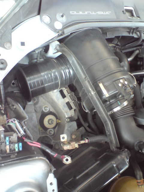

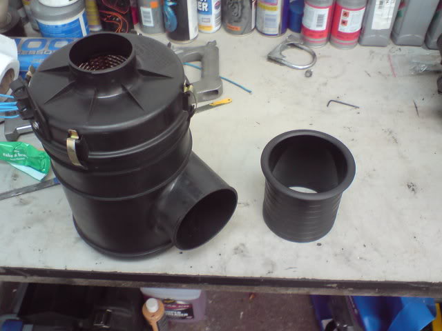

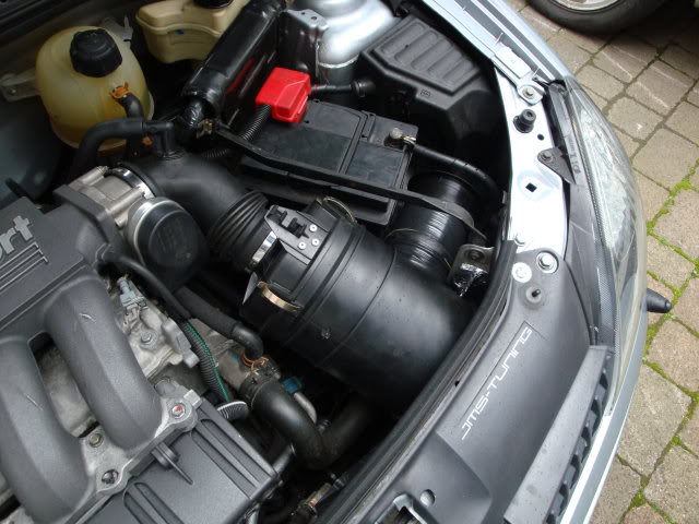

I have been meaning to finish of the Induction side of things since playing with the standard PH2 172 box and gaining very minimal power so Nick has kindly let me borrow his old V6 airbox ( thanks again mate ;) ) to carry out some trial testing
So the plan, Take the V6 airbox and an sub box funnel and join them together ( getting it as close to the ITG maxogen as possible design wise for £300 less )
So here's what i had to work with
Attached the two together with PVC tape so can all be removed easily if needed
At this point i didnt have the camera to hand and didnt log alot of the info but it was a tight litte b**ch in there but got it all in place
All back together
The results will be confirmed this week once i got the car in some good driving roads and see how it performs compared to the PH2 airbox

Looking good mate, glad it fits aswell as it looked really tight on Thursday! Does the samco bend fit or would you need to cut it down because I reckon there would be less restriction with a samco also... Get some tests done to see how it fairs!

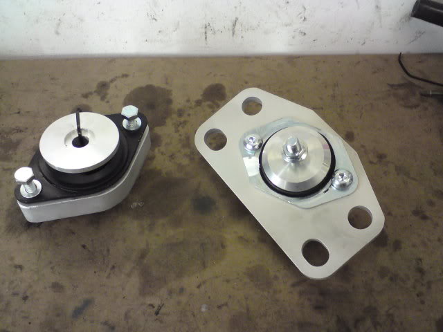

So my fav up-grade of the winter - Engine mounts!
Vibra up-rated of course, What a diffrence to gear change & engine feedback, If installed correctly there is very little extra vibration

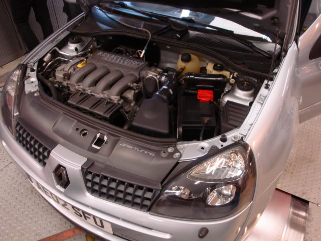

Then, As few know, we have started playing with cams

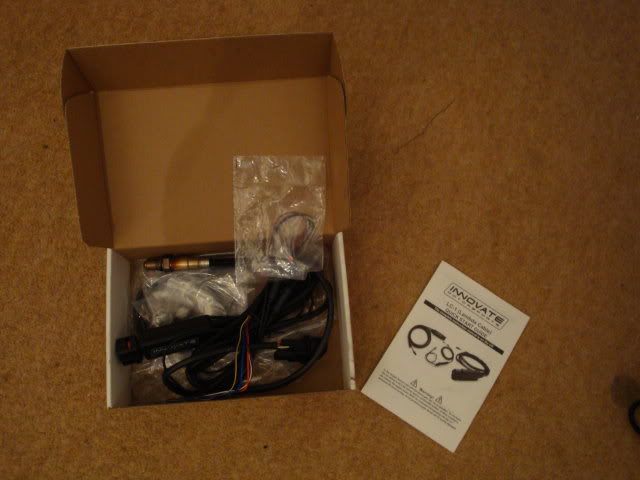

First up for this was an LC-1 kit to keep an eye on the AFR along with Henks Pro VCI
So after hearing nothing but good things about the Catcam 428's we thought we would give them a go
Sadly these cost me alot of low down torque losses for daily use, Which for us offering as a road package we decided against. We were advised to try the C&B cams by Henk, which we are currently adding the finishing touches too

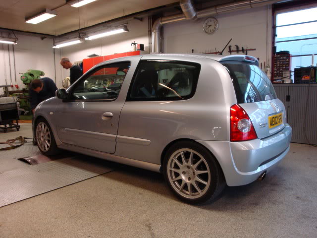

So far the gains look very good, Still working on the mapping, which we have driven over to Henk to get the best from them... even spent a night sleeping in the back of the clio!
6km's long at near 3am left me smiling like a 16 year old from the exhaust note
On the rollers
Car sadly started to get through coolant just as fast as petrol which has caused delays getting the mapping finished, So we headed back to the UK ready for a top end rebuild but glad to see it was only the lower hose that had a small slit in it, so a new hose was installed and christmas came round which involved me spending 24 hours in the bucket seats driving to France, See the problem was i was going snowboarding for christmas but sadly the same day i planned to leave the euro tunnel shut down due to the weather, when we did finally cross the border the snow was un-real, i was reduced to 30 mph on the motorway - wide tyres + no weight on ice/snow..... not fun... plus the car built up so much ice it ended up with body work as wide as the Vee's ( almost ;) )

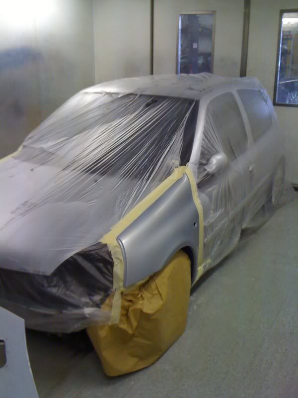

So with that all behind me ( thankfully ) next up was a general body work clean up
Off next door for some TLC + paint
