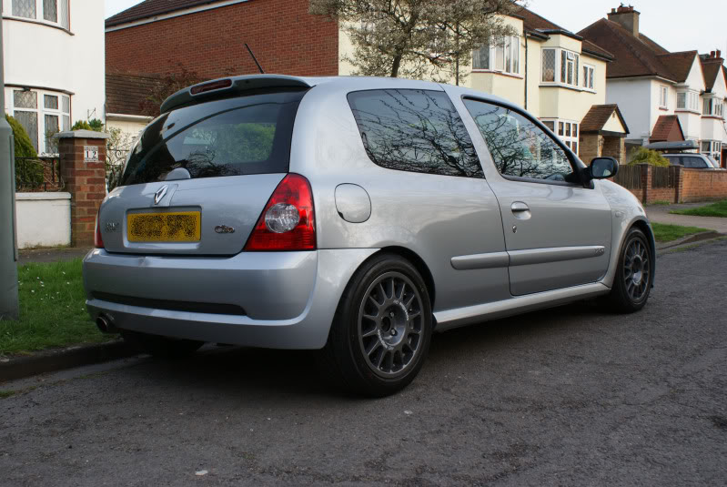

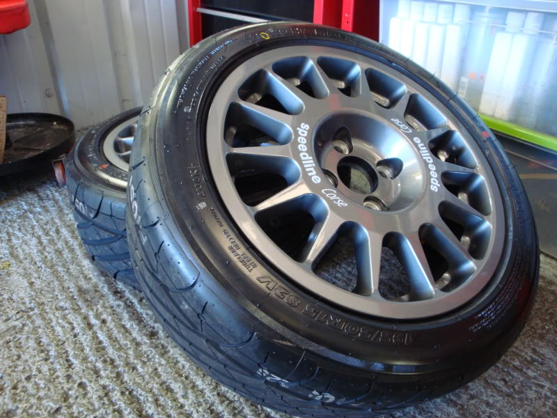

Tyres on

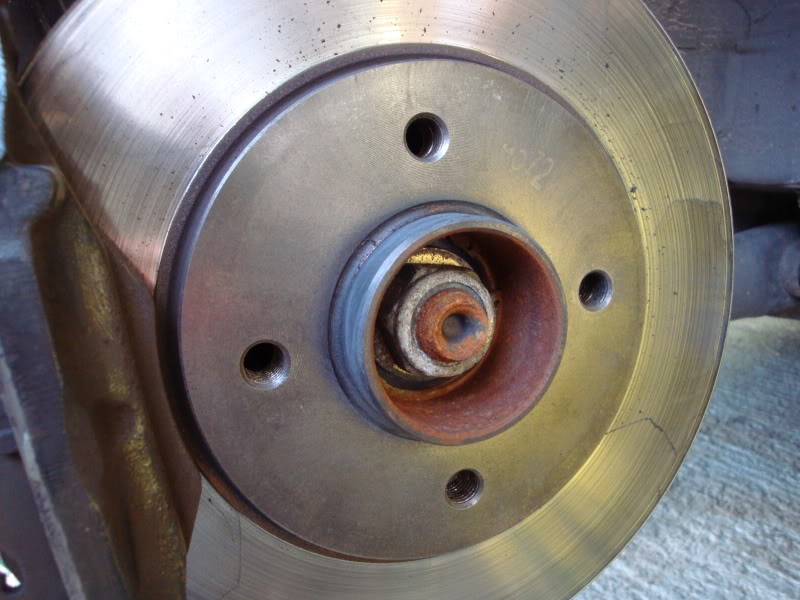

So with me not using centre caps i needed to clean the hubs up as there now going to be on display
Before :
After :
Fitted

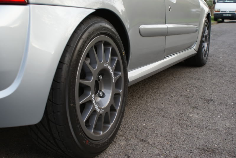

Gone from ET45 > ET37, Sadly the weather didn't allow me to test the tyres but from the drive home they do hold really well in the wet even with them covered in mould releasing fun, Hopefully get them worn in over the weekend and see what they can really do
maynard
  ph2 172 track car
look even better now they're on!
what did you do to clean up the hubs?
  e92 + E46 M3 + Cup
Yea they look ace on, So good i've decided to run them daily & on track so the Turini's are off to a better home rather then my garage for many months lol
Hopefully get some good pictures over the weekend if i get a chance!
Sorting the hubs is fairly straight forward, Various wire brushes, get your self an air drill / drill & you'll save your self some time, clean it all up with break cleaner & gave a light coat of grey high temp paint to keep them hopefully looking good for a few months :cool:

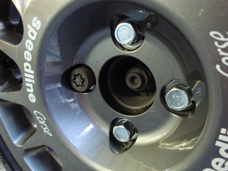

2118's dont have centre caps well mine never did! cars looking great good work!
edit- were did you get your fresh looking wheel bolts from? im in desperate need of some
  Golf GTD Mk7
True, but surely ph1 centre caps would fit?
Bolts would have come with the wheels I suspect. Got some exactly the same with my ultraleggeras

Hateful heavy wheels. But lovely car./QUOTE]
Less weight than the Turini's, even if it is only half a kilo a corner but they look so smart + tyre prices on 15's was just the way forward :eek:
edit- were did you get your fresh looking wheel bolts from? im in desperate need of some/QUOTE]
New bolts came with the wheels, Renault & speedline centre caps didnt fit, prefer them without to be honest, track **** look :evil: lol

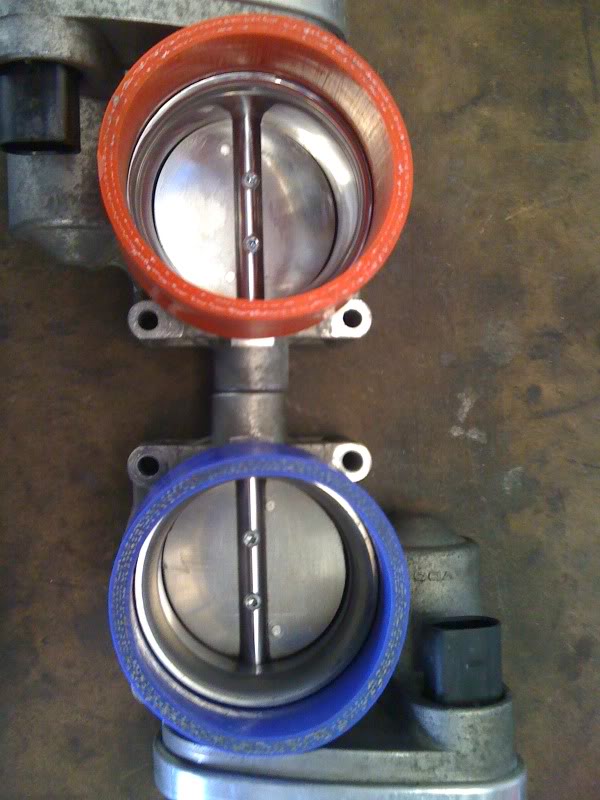

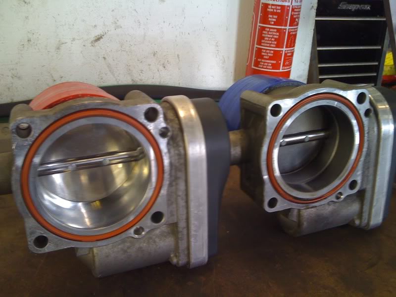

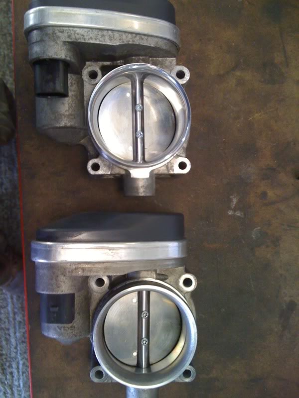

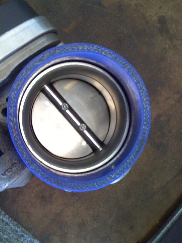

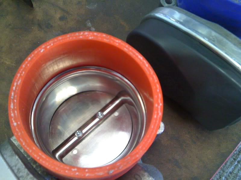

After seeing a post on here a couple of days ago I decided to have a play with a spare standard TB.. I went a little further with this one & re-worked the entire opening to give a smoother run from the airbox.
So heres the modified one next too a standard one
As you can see i've removed the step & i've reworked the mouth to more of a trumpet shape to "hopefully" allow improved flow
Standard TB on coupler -
Ported TB on coupler -
Side by side with the couplers on
Other side -
Will hopefully have both at the next RR session so can check them back to back to see if there are any benefits, I would imagine there going to only be small gains if any but every little helps ;)
