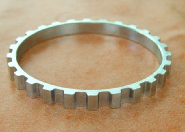

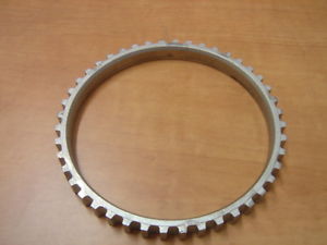

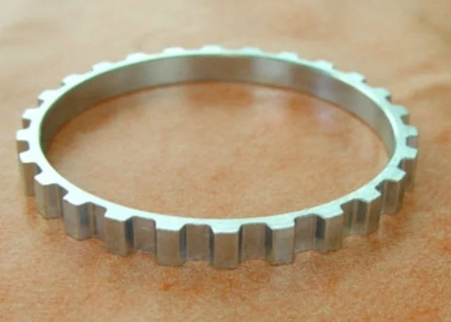

You dont have to take the driveshaft off to know what is yours, just look at it...22 vs 44 is a massive difference. Just get under the car or get one wheel down (front) and count...it is enought to count on a quarter of the wheel 5-6 is 22ring, 10-11 is 44ring.
22ring
44ring
