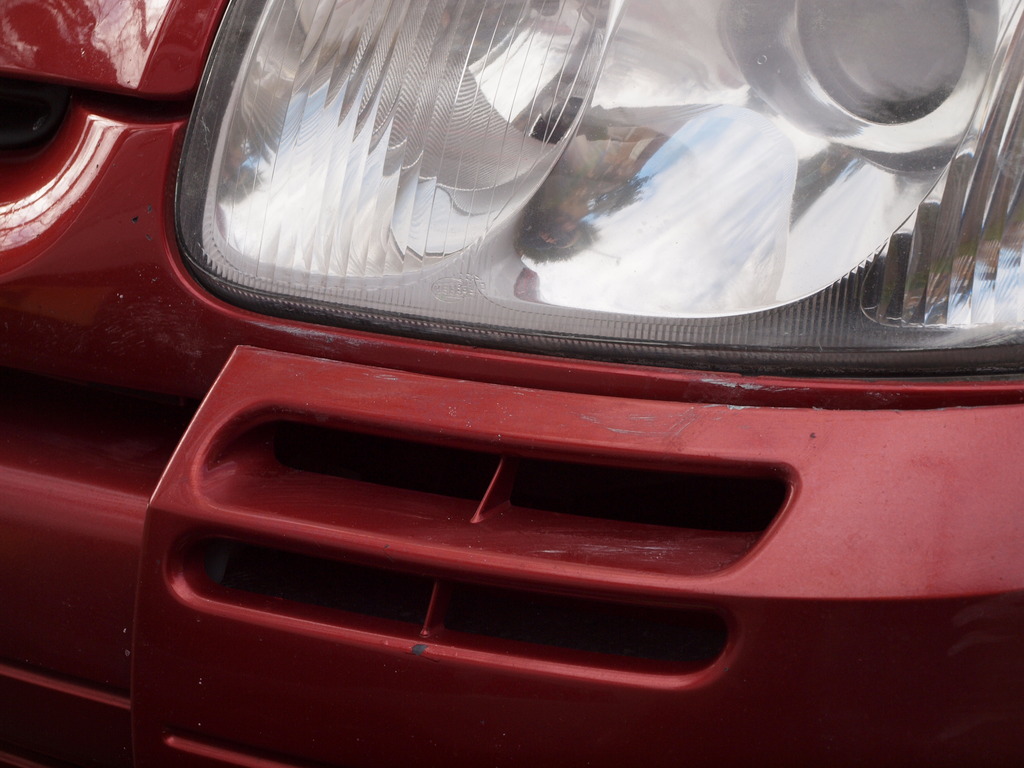

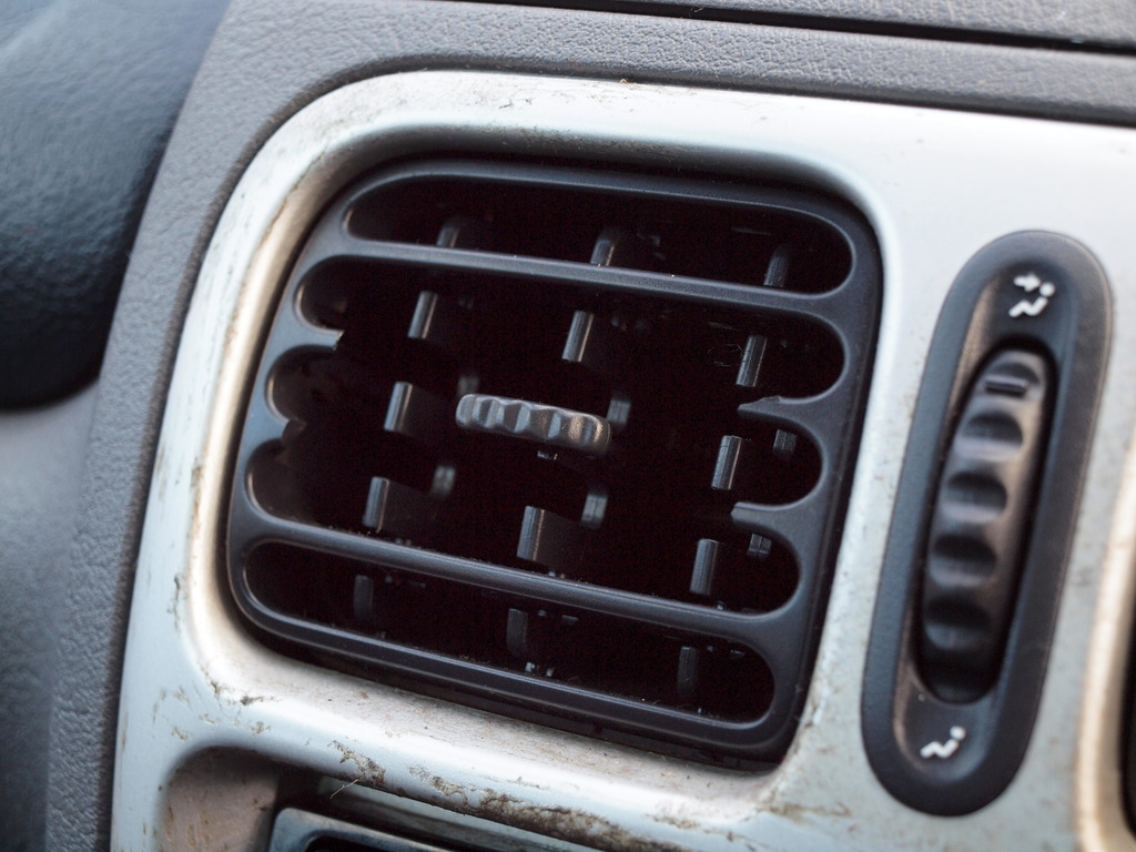

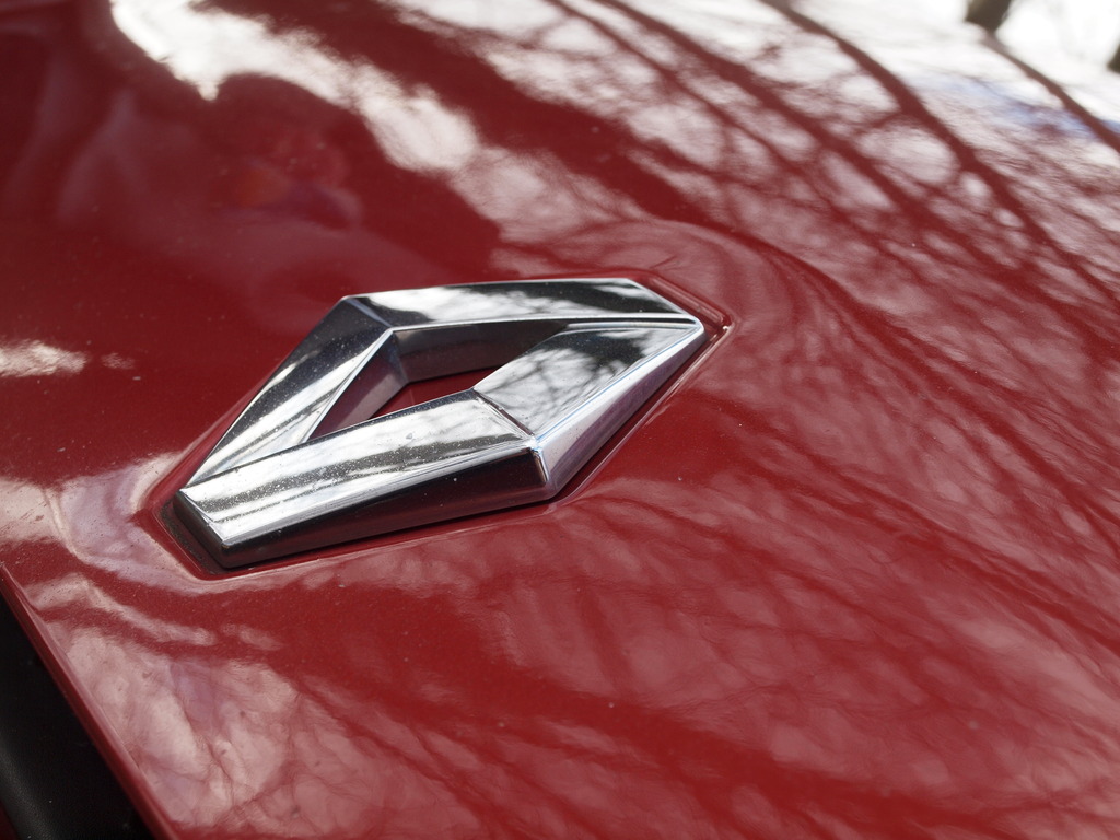

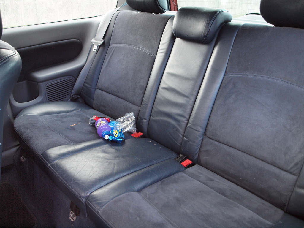

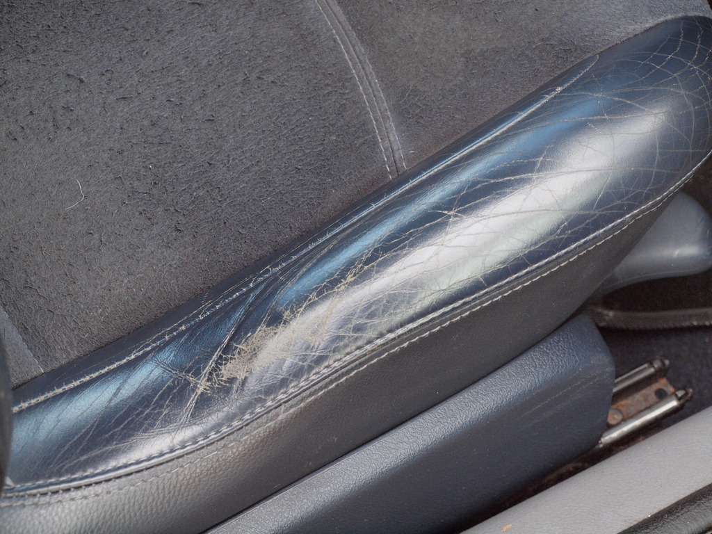

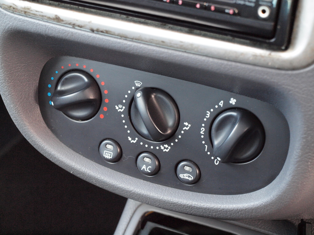

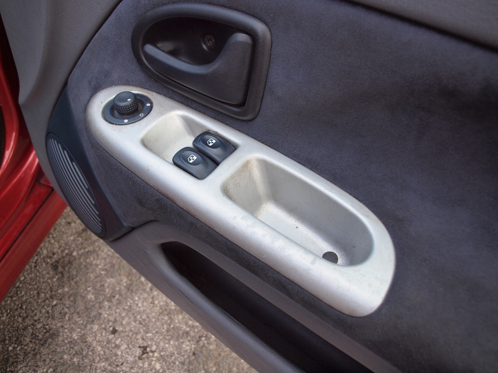

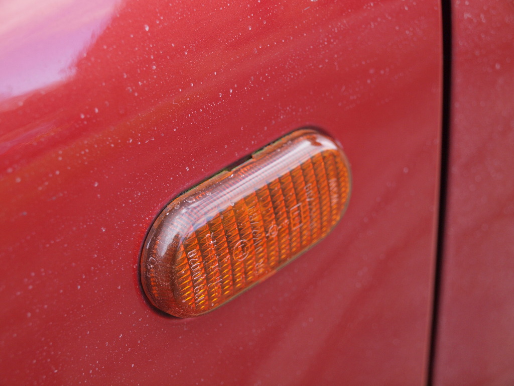

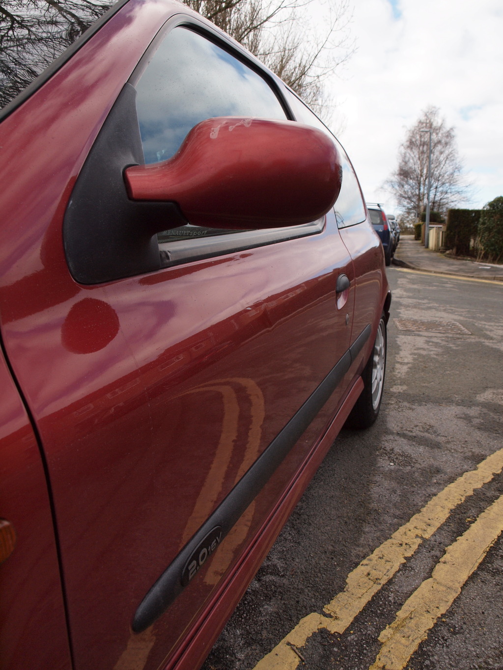

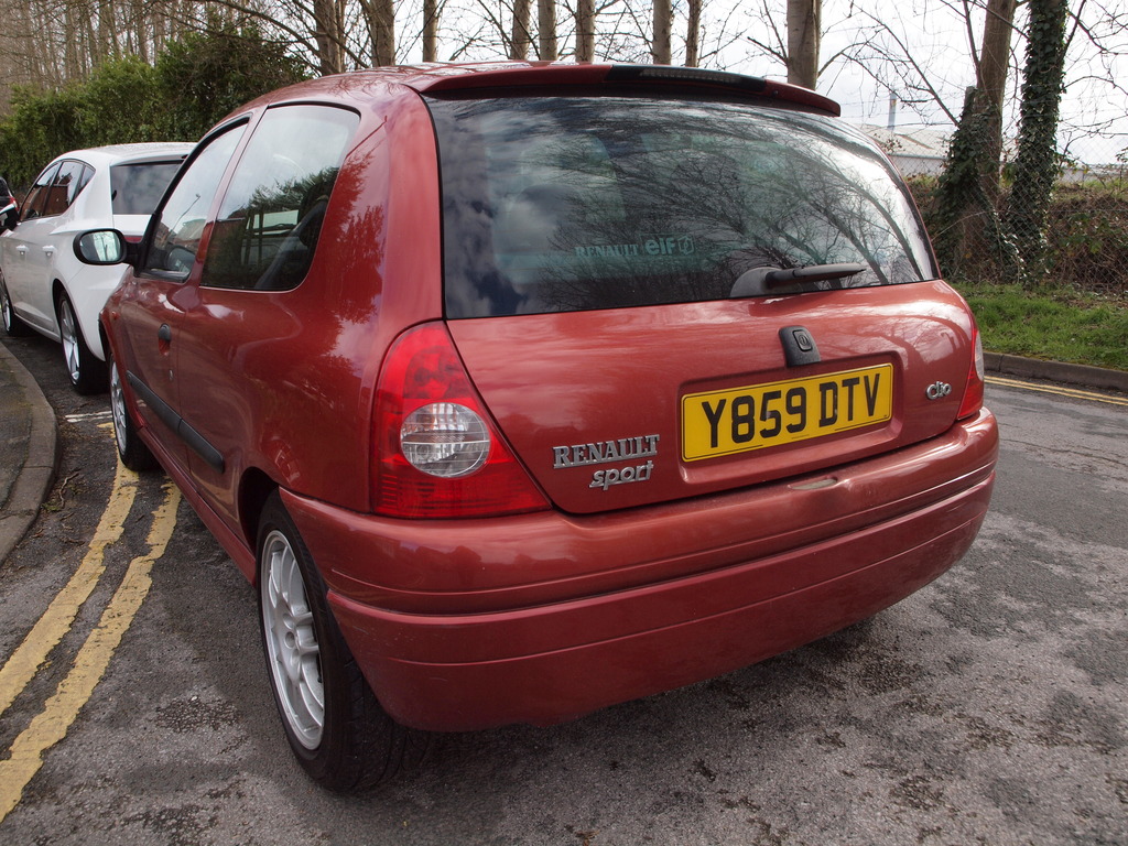

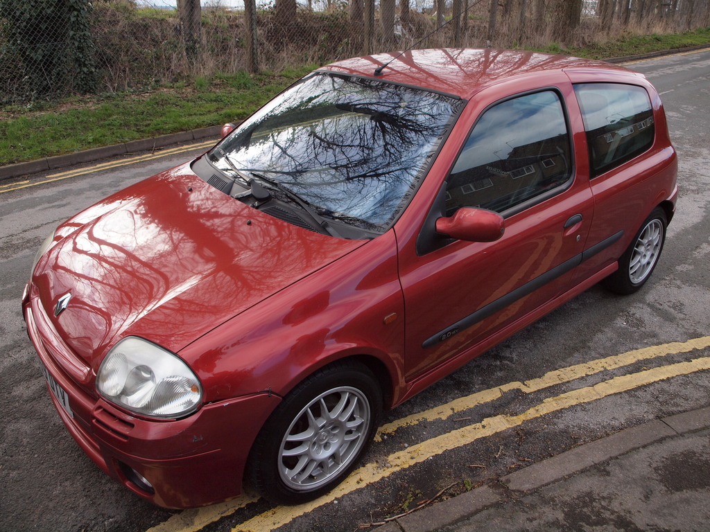

Wasnt sure what to do with the car and thought about a track/fast road project but after some research and some advice from people in the know ive decided to go down the restoration route, car has come with a huge bistory file including every mot, tax disc, receipt, service history/books etc.
ive got a lot of pics to follow for people to have a look at.

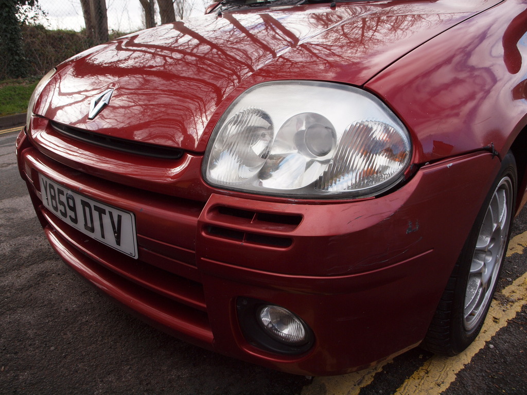

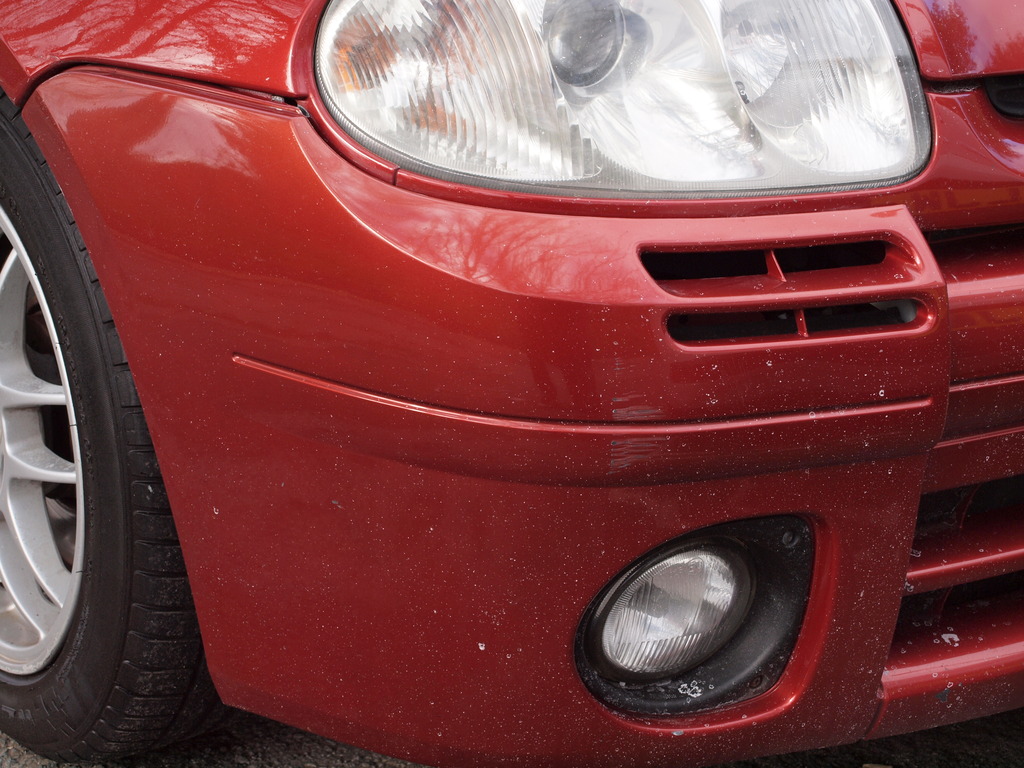

Didnt really get a good look round it as it was dark, so been out with the camera this morning and taken pics of all over the car.
Enjoy :wave:

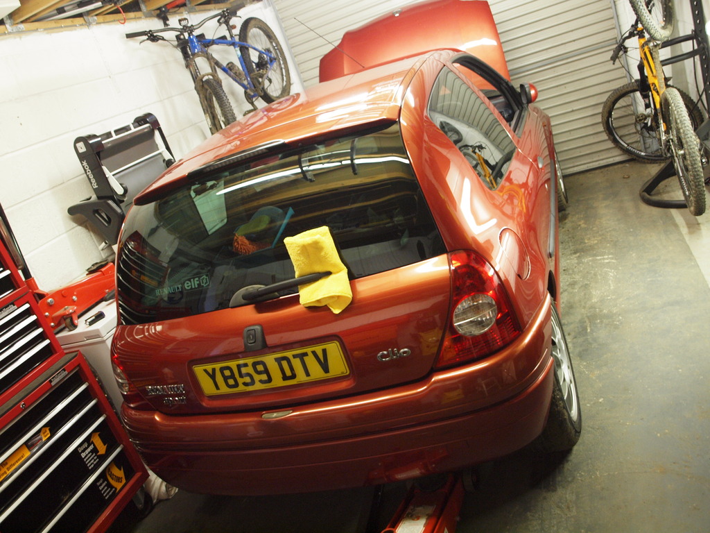

Had a good tidy in the workshop today and made room for the clio, cant believe how different the colour looks under these lights.

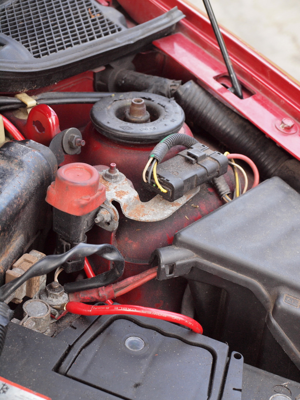

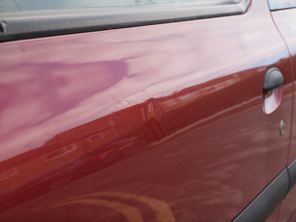

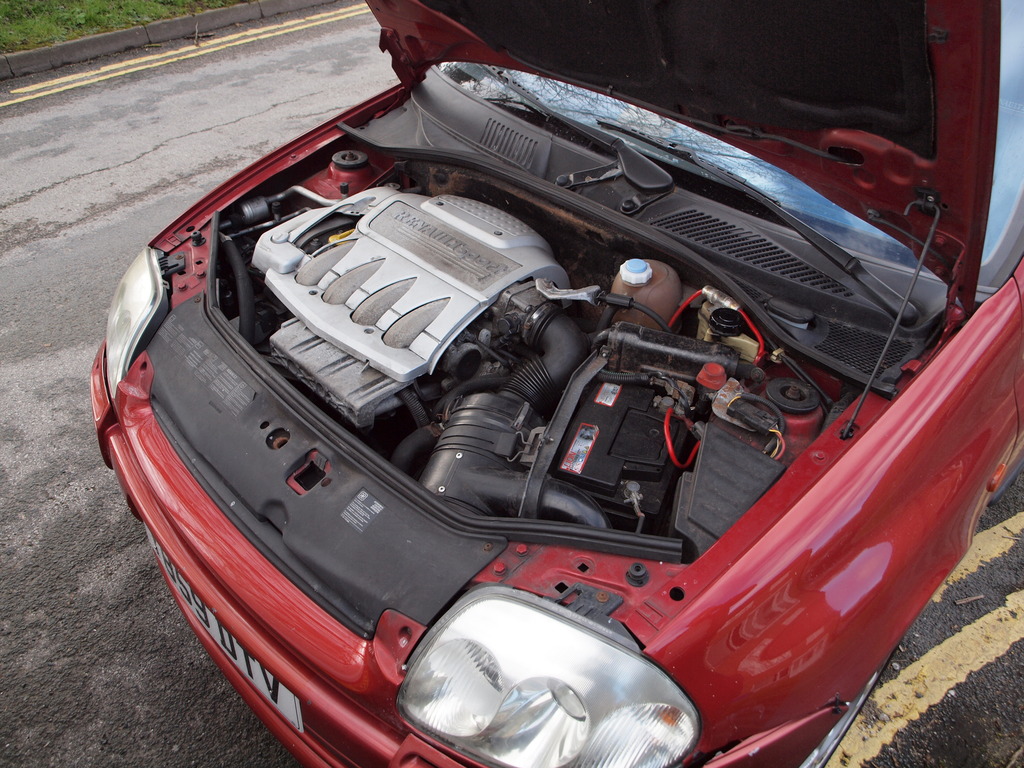

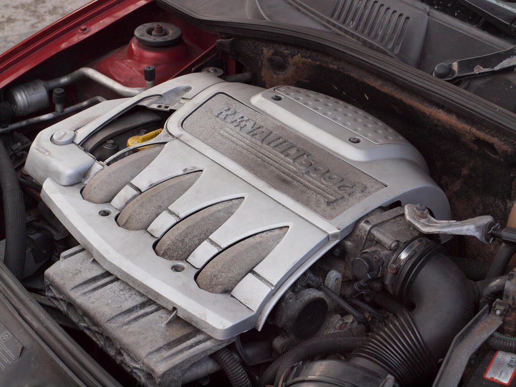

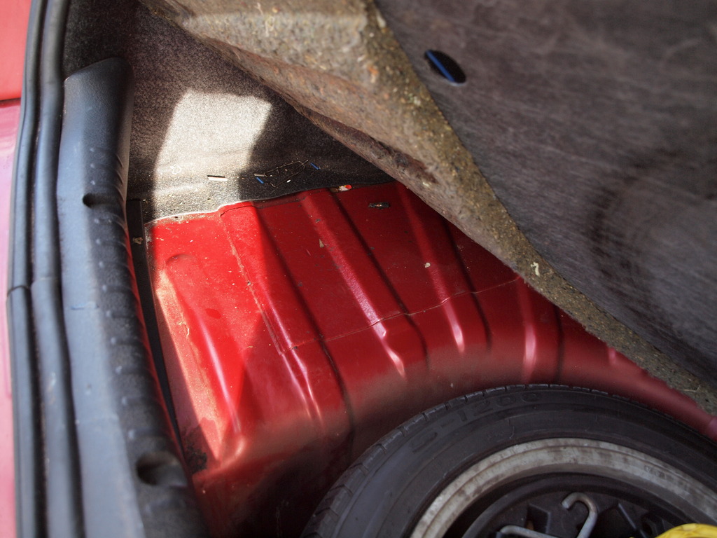

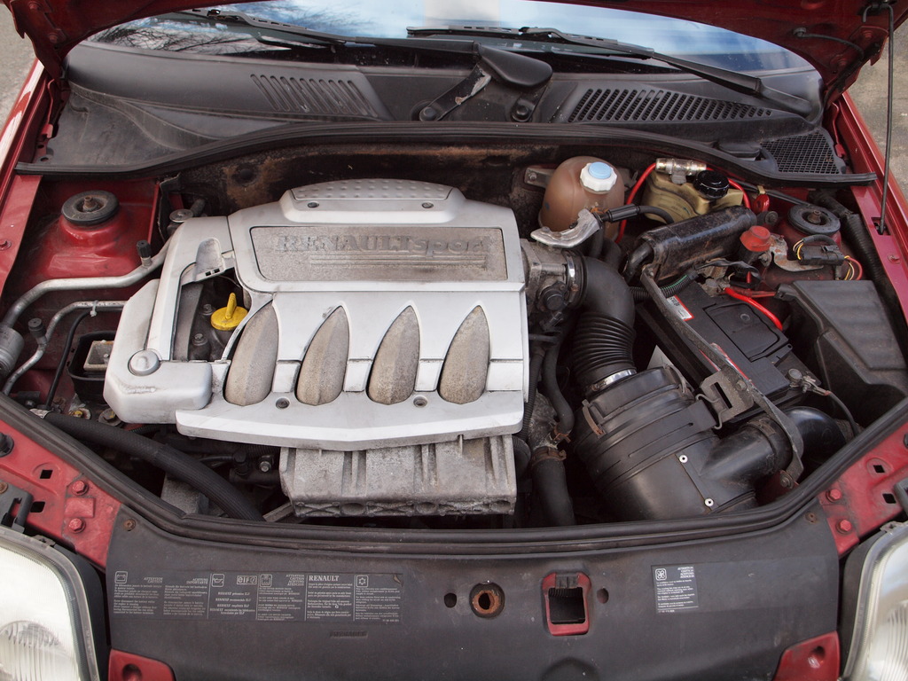

The car appears to have quite a decent oil leak by the looks of it which is a bit annoying but i might even have the engine out to clean/refurb the bay.

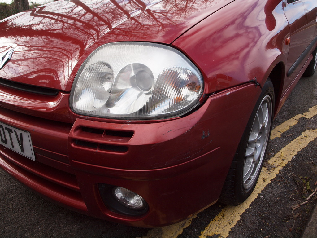

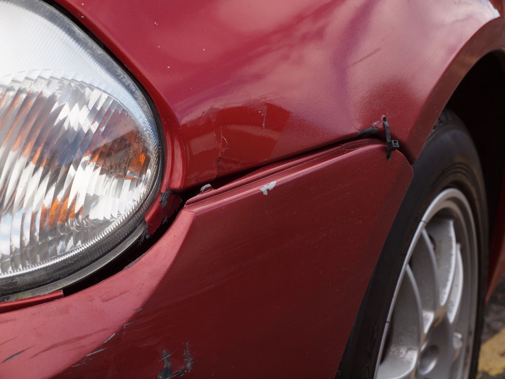

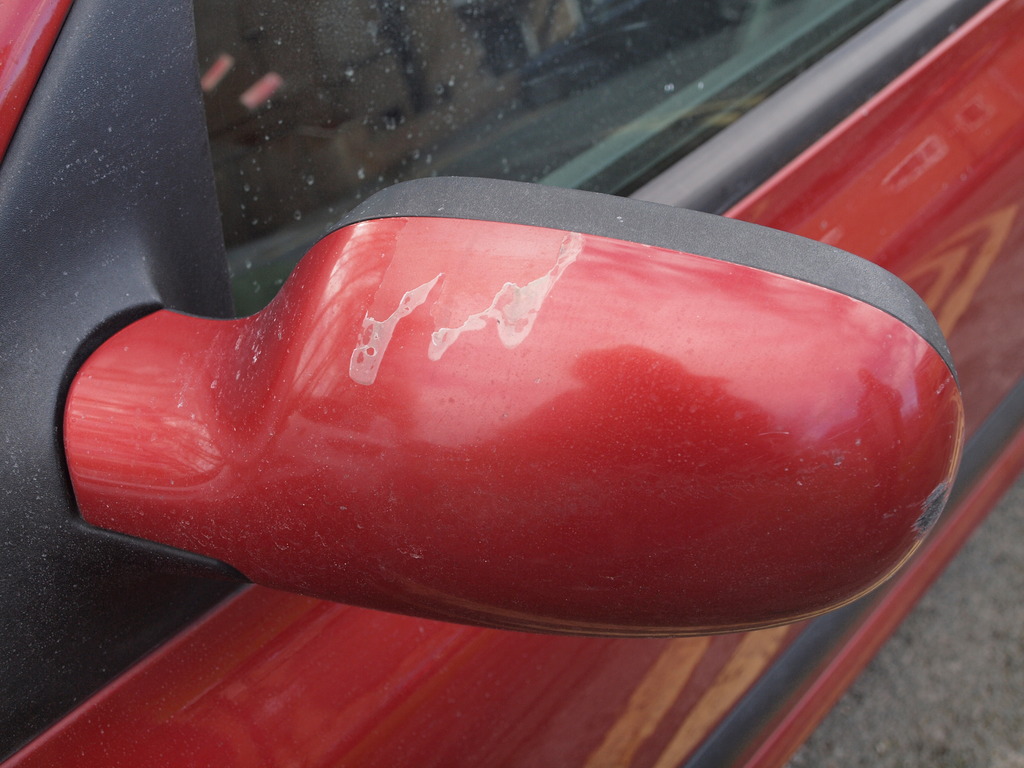

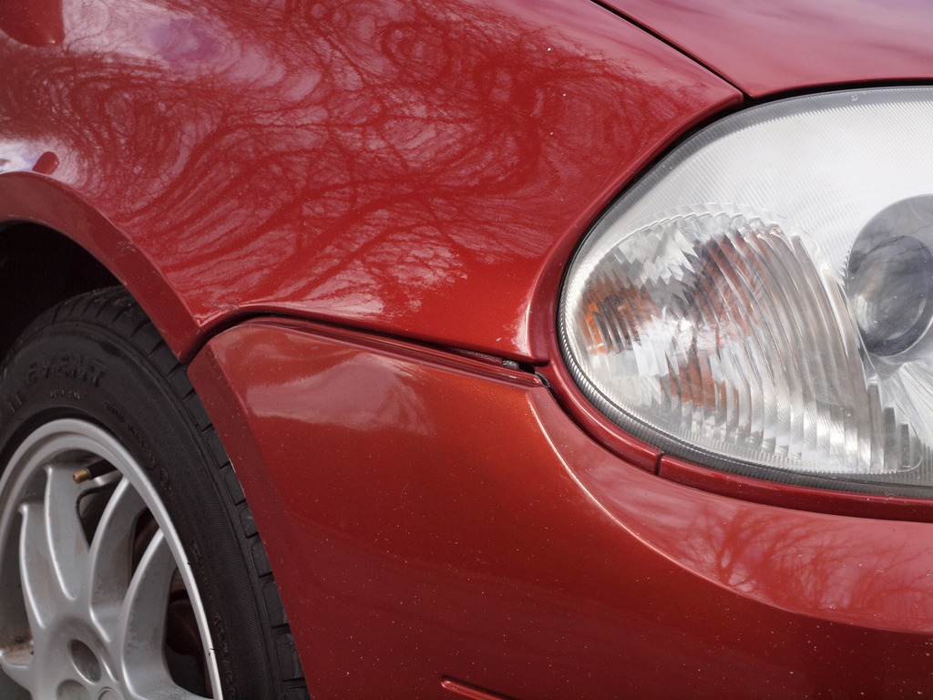

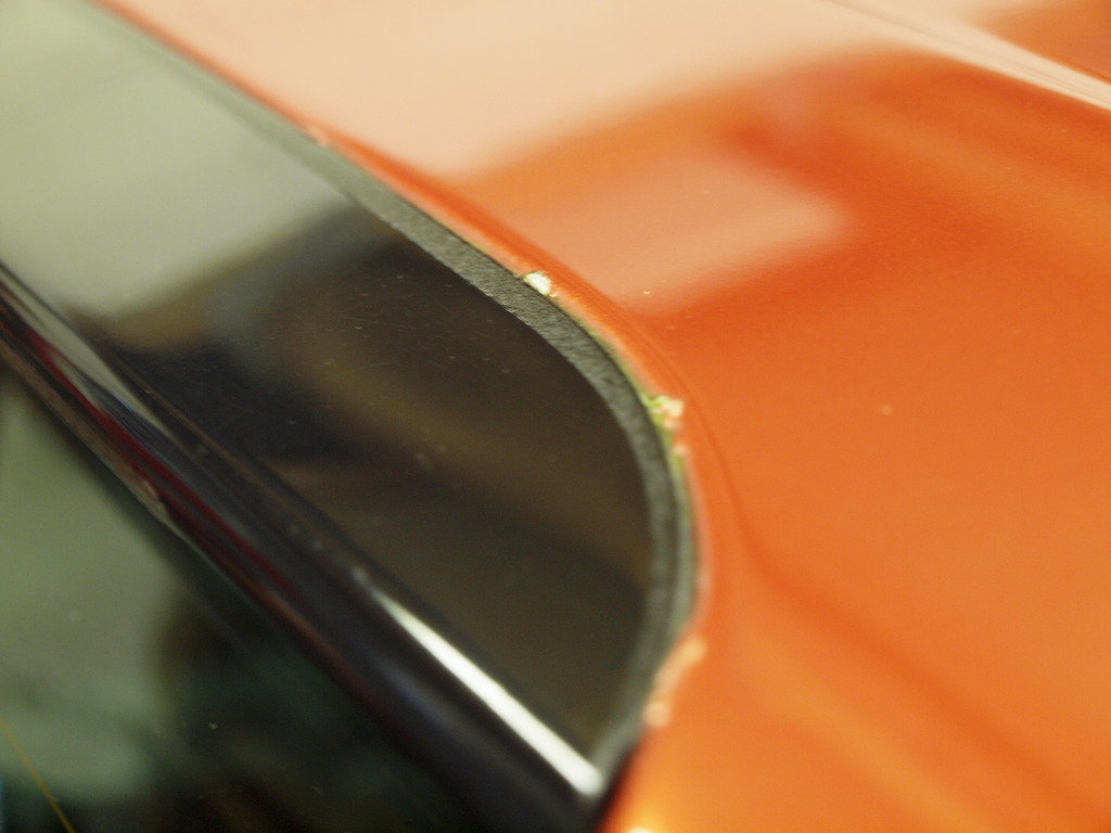

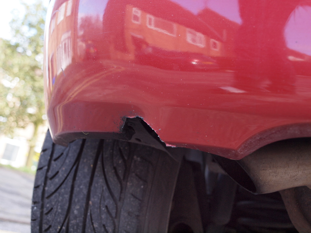

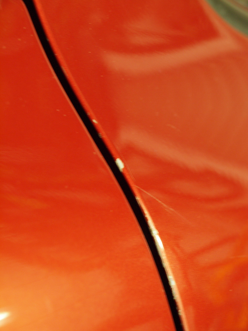

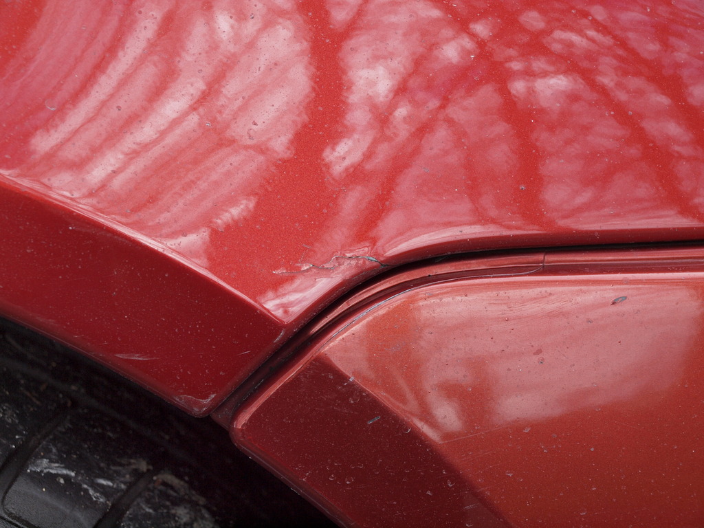

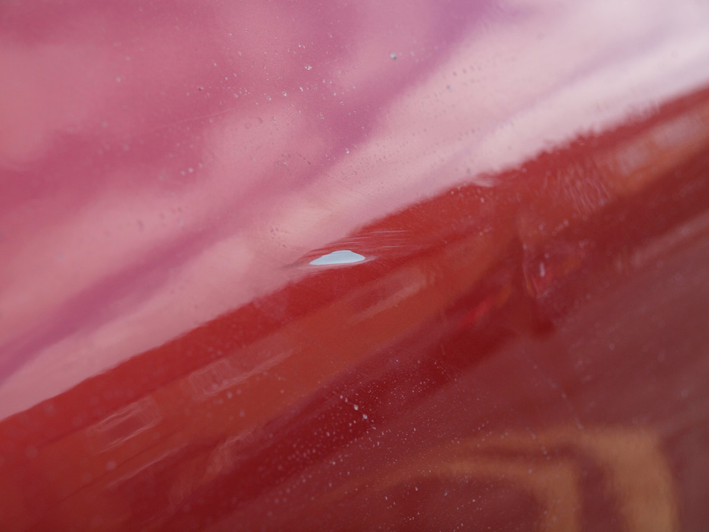

Noticed a few more blemishes while i was in there

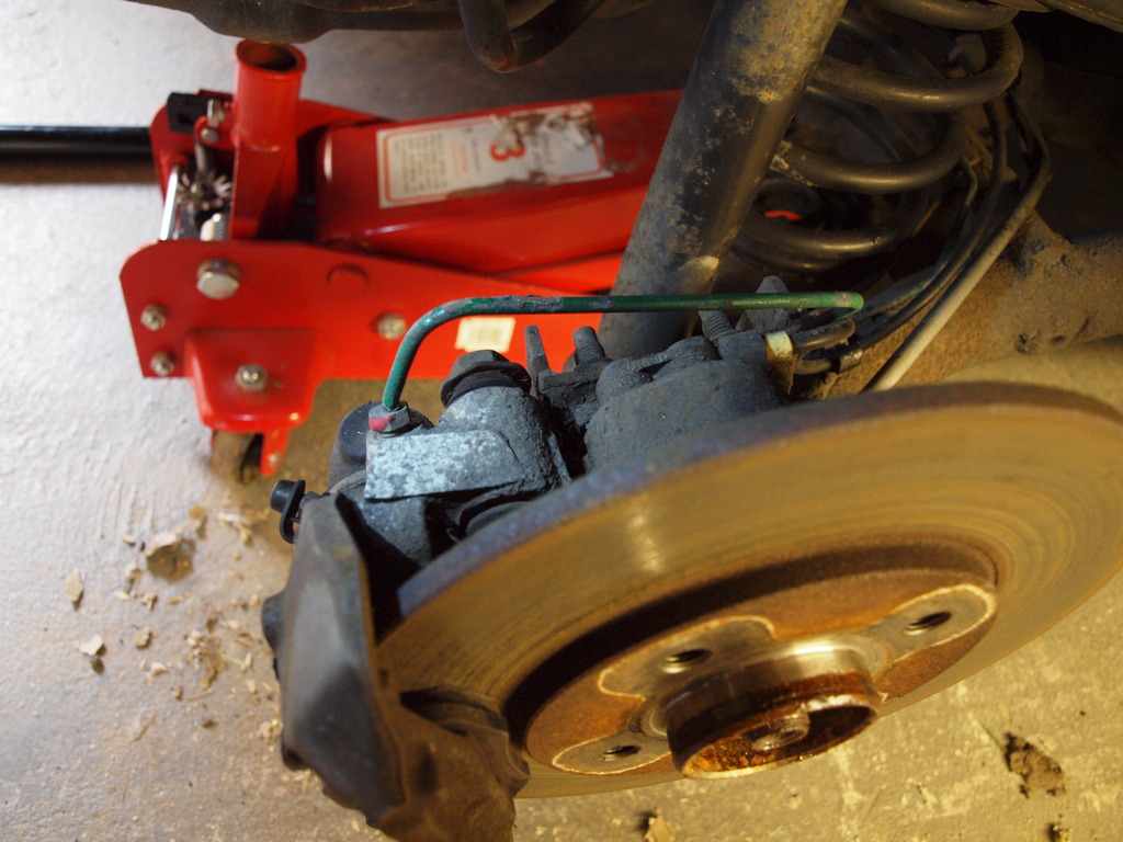

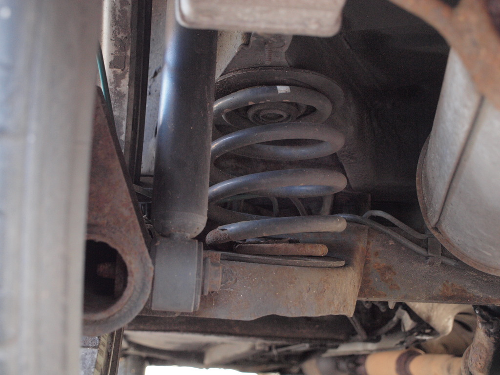

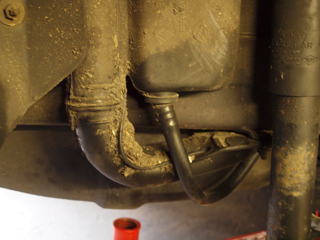

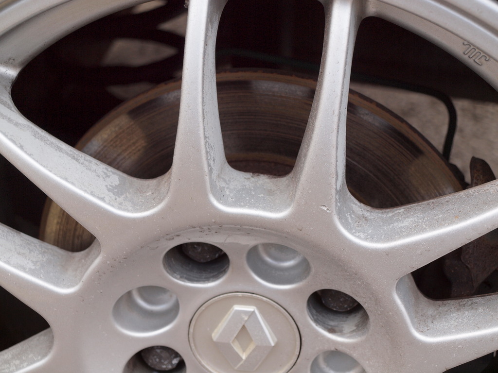

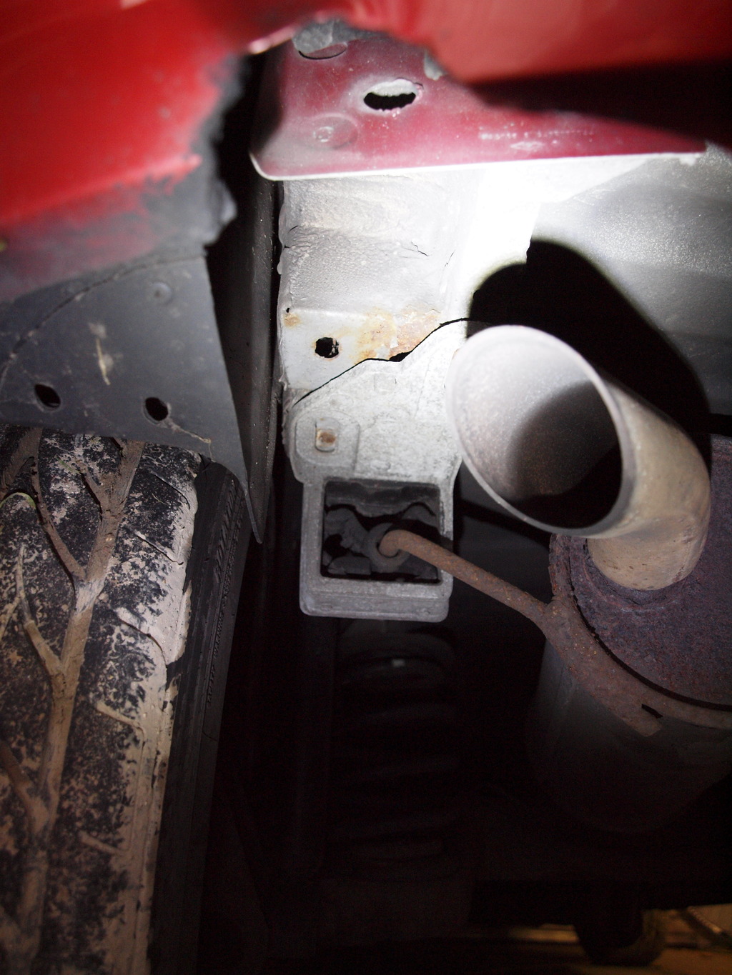

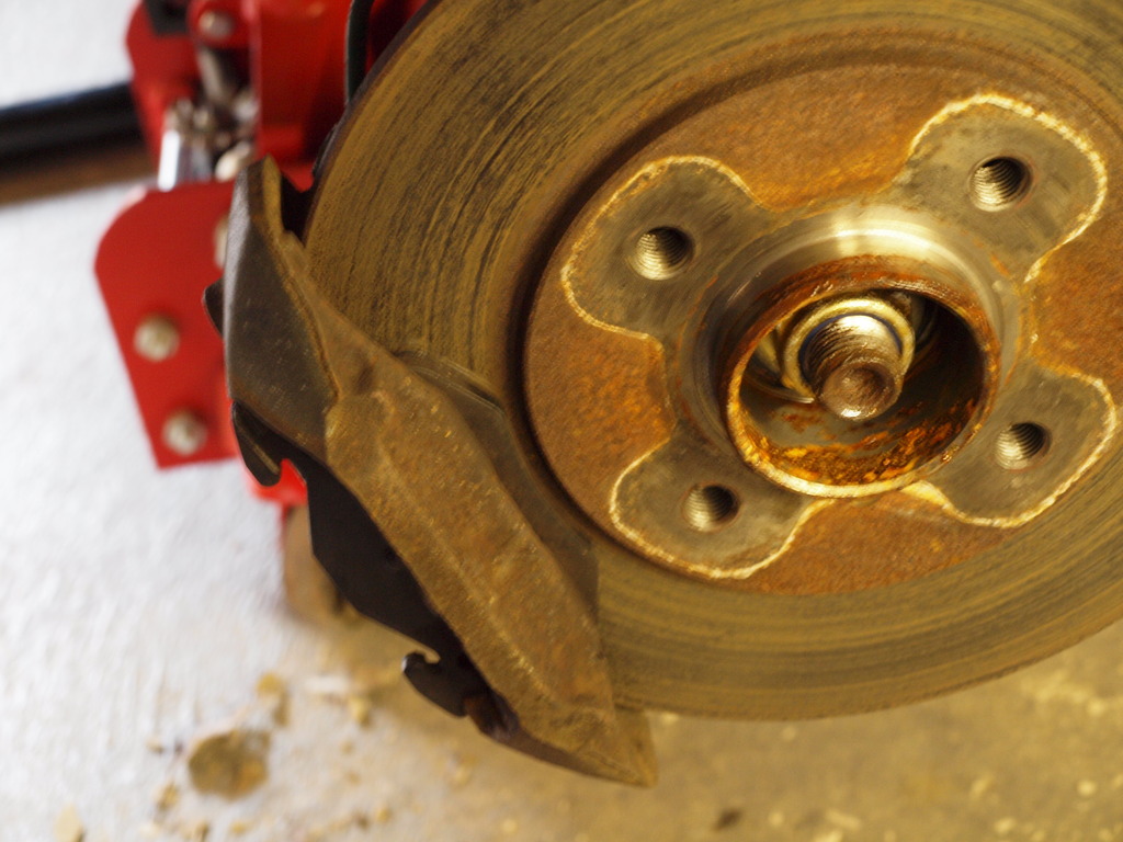

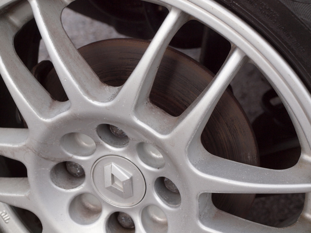

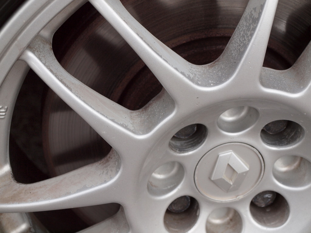

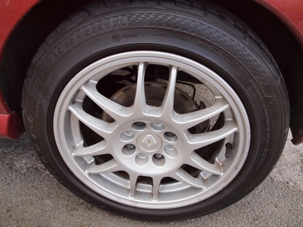

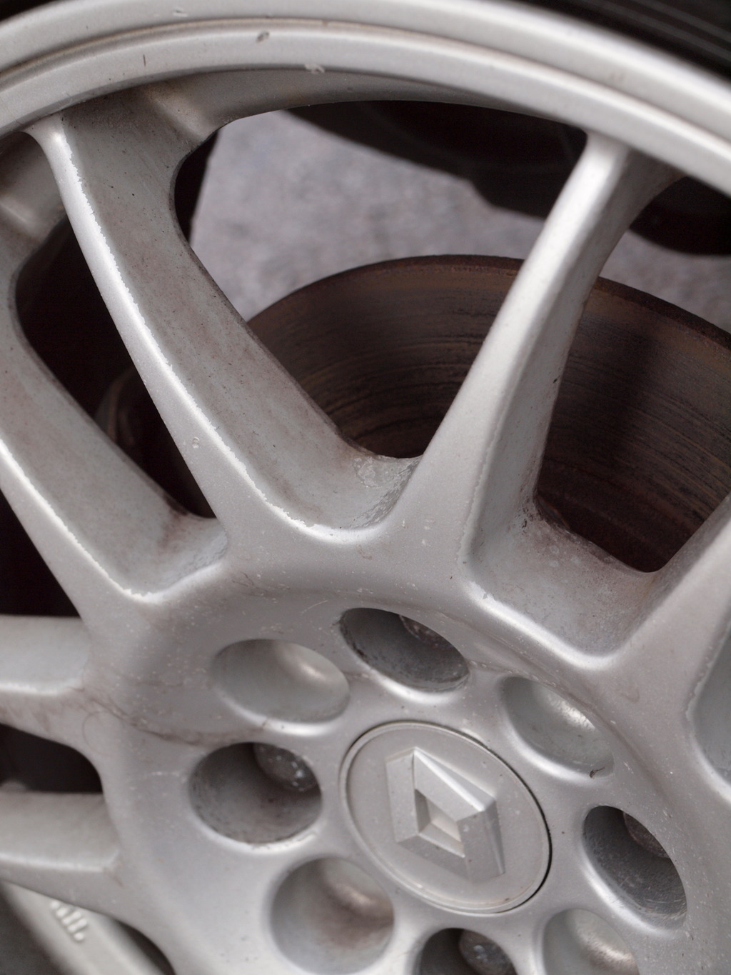

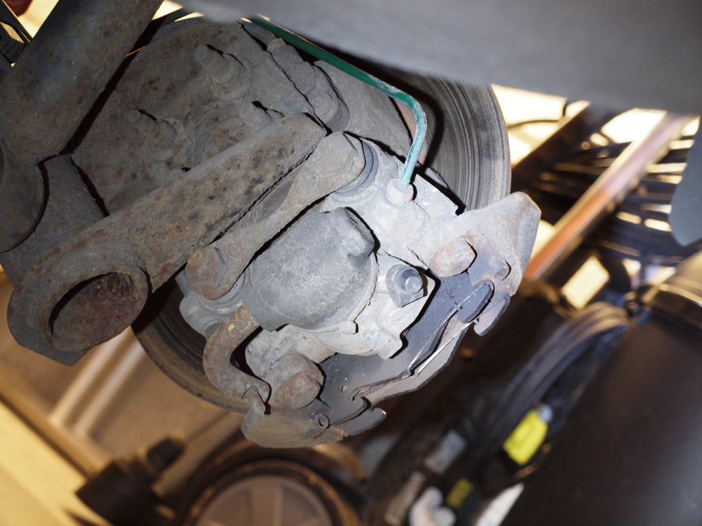

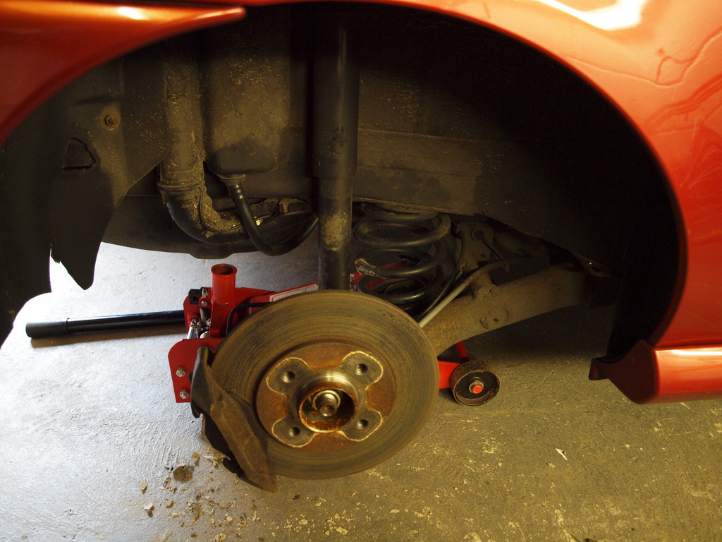

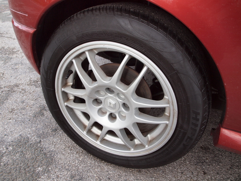

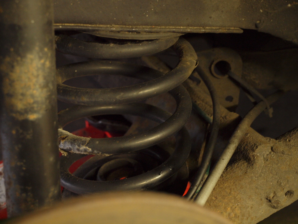

Whipped a wheel off the rear and had a look around the bakes/suspension etc to see what lies ahead. To be honest I am quite pleased at the condition of everything, especially being 15 years old! :thumb:
The calipers and discs appear to be in good condition as well as the brake lines, these will be coming off and just getting a rub down and satin black paint. (unless seals and rubbers are perished then they will get a rebuild)

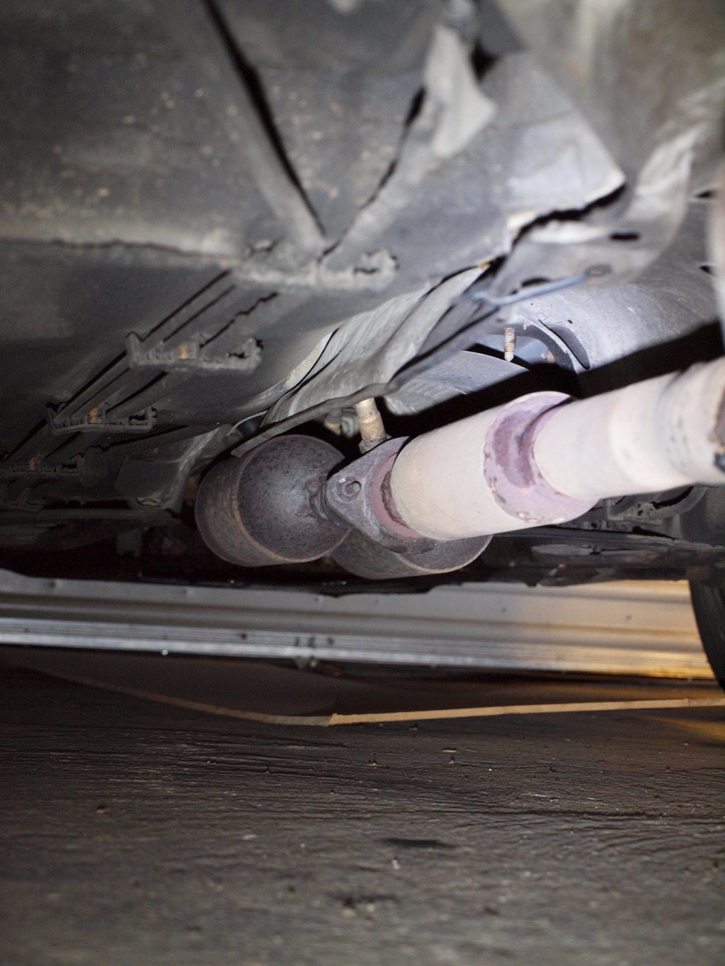

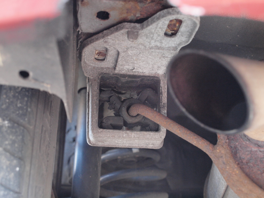

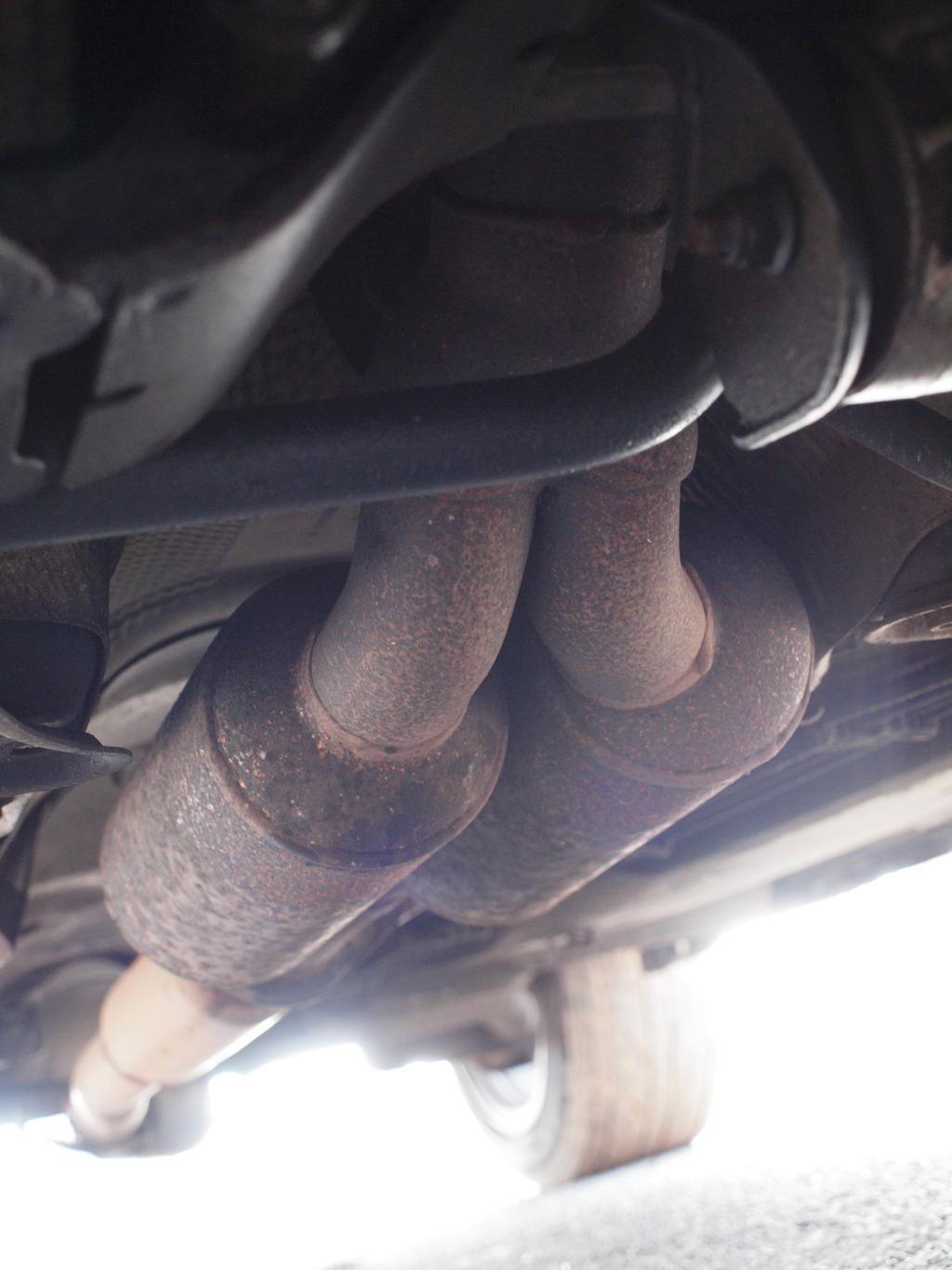

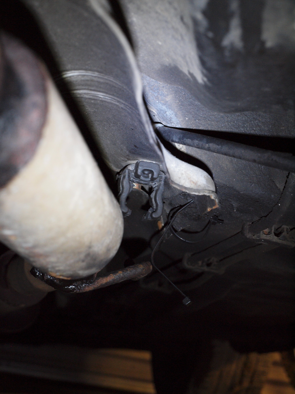

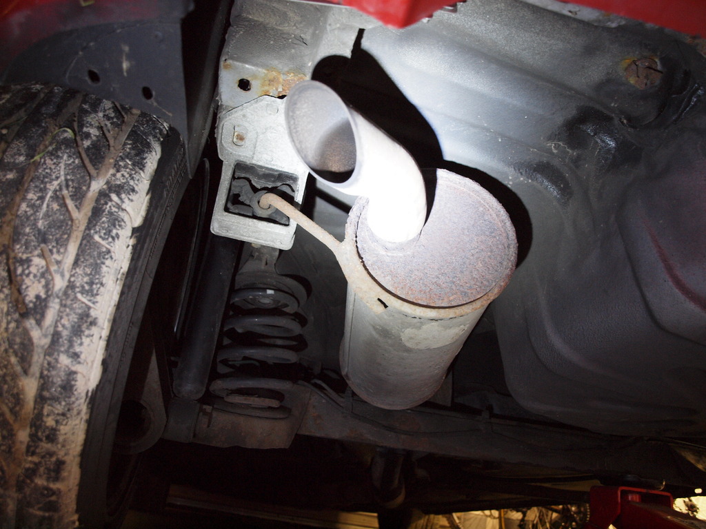

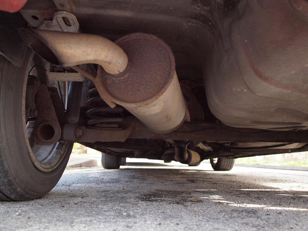

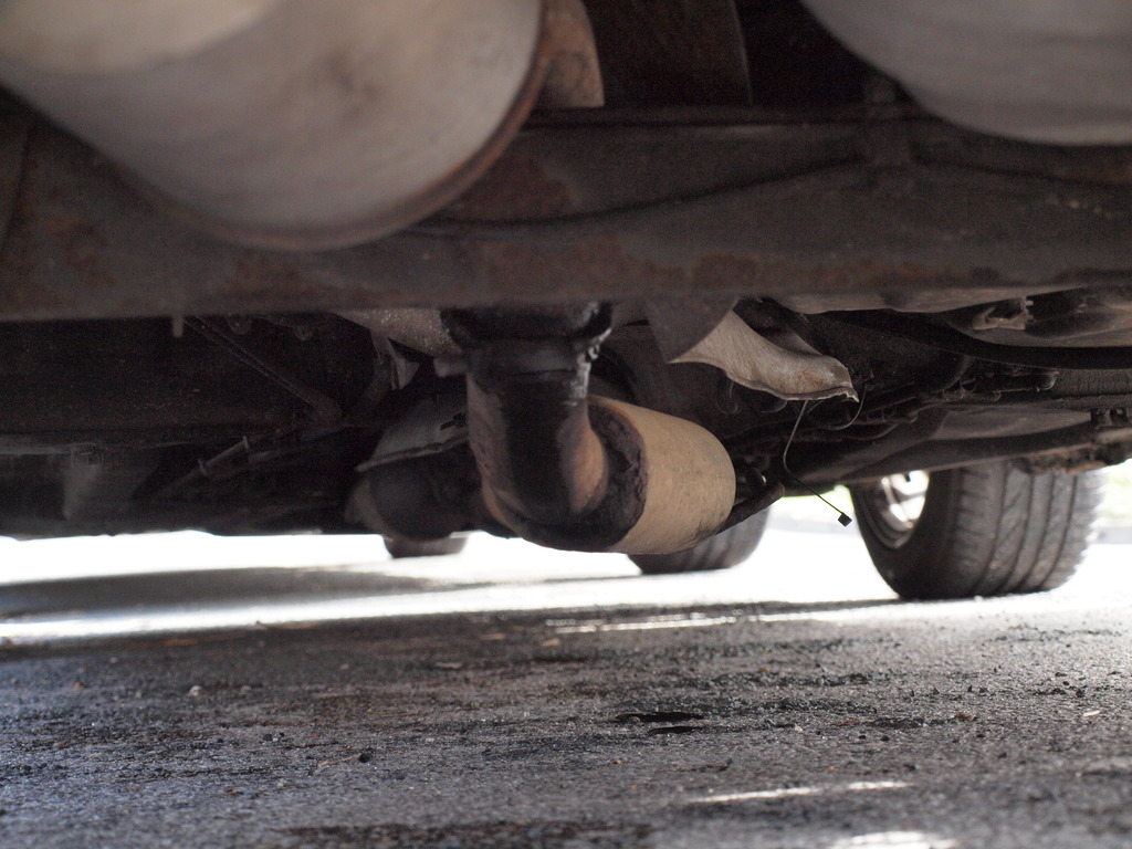

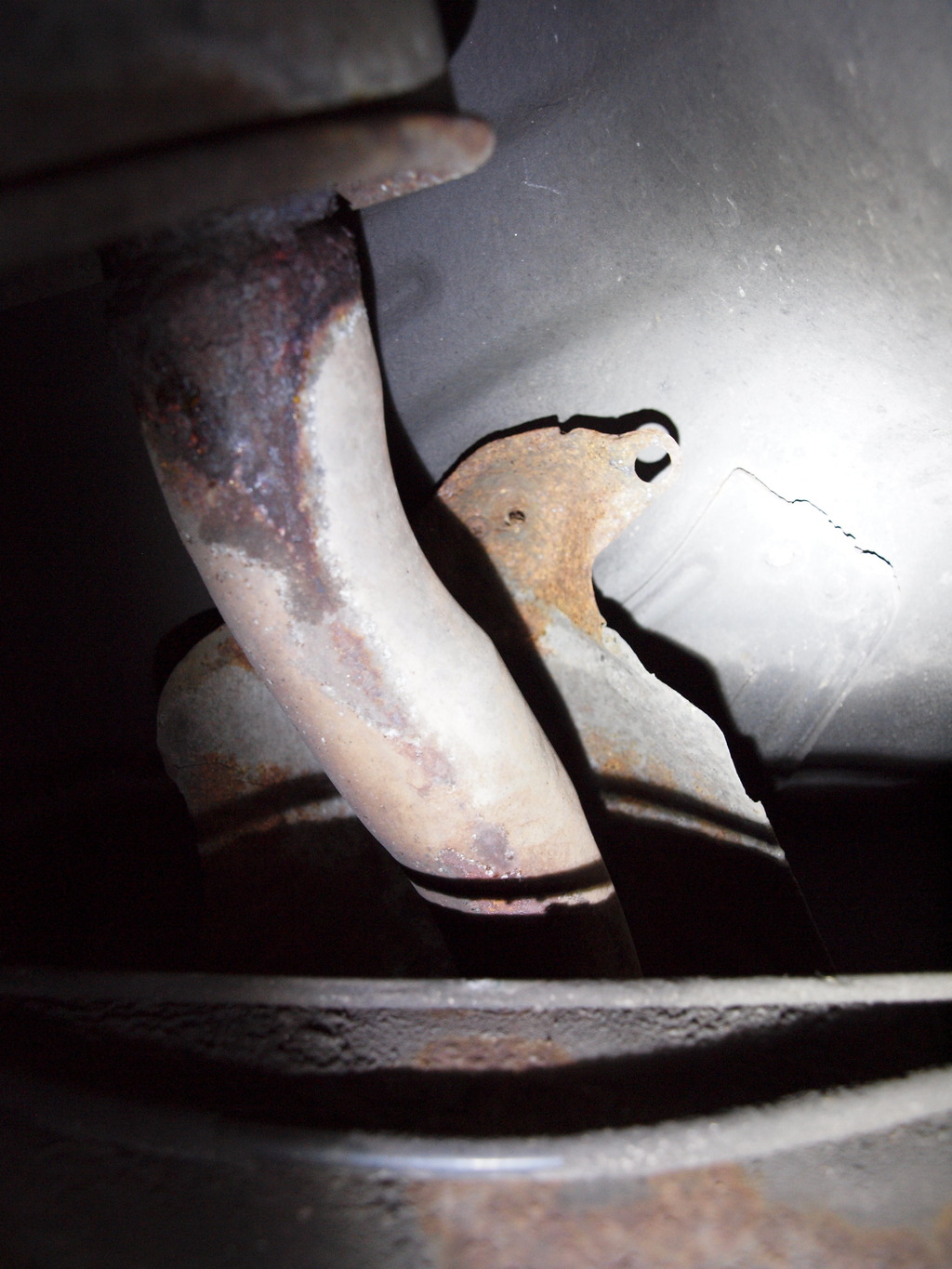

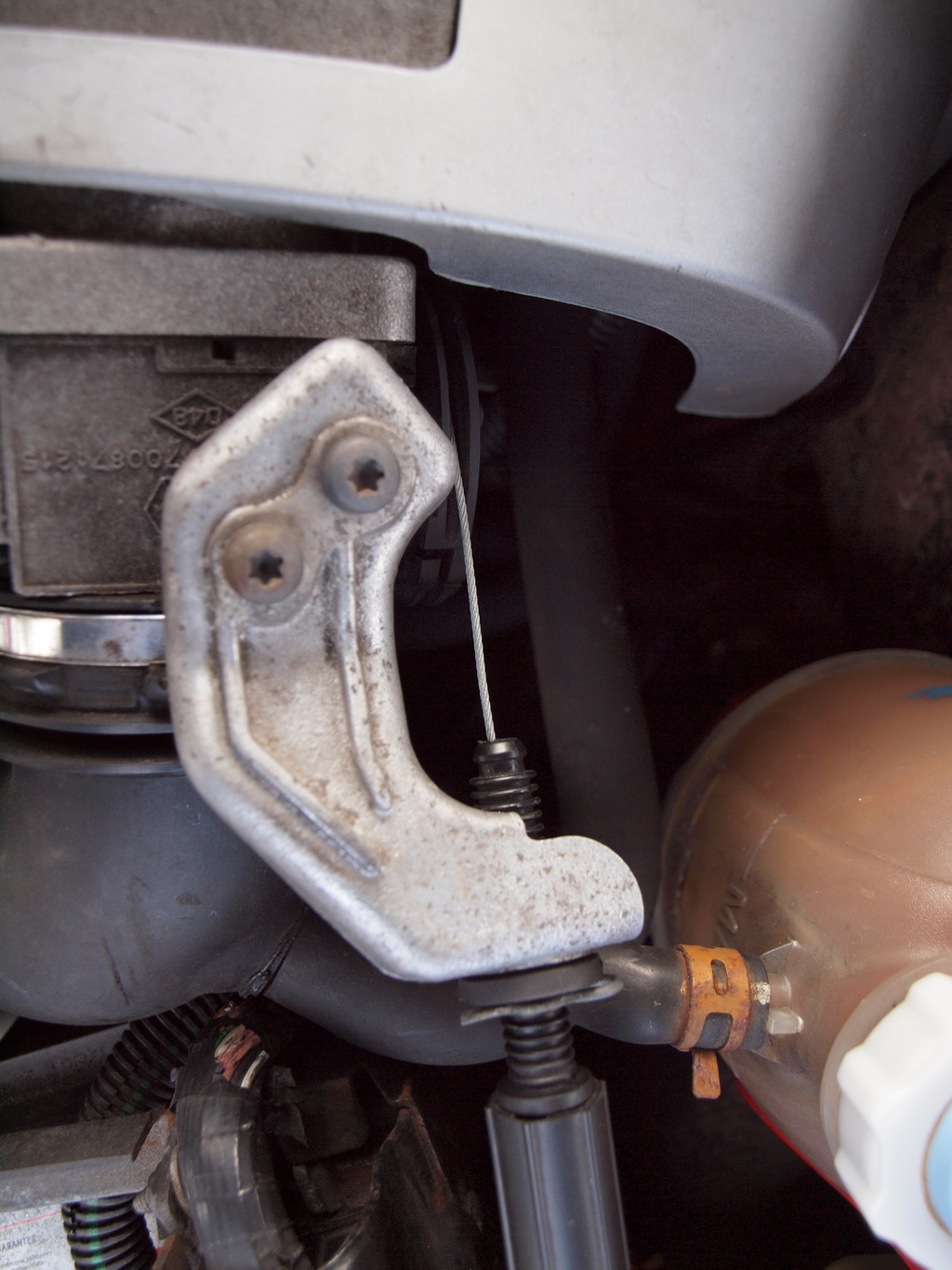

The exhaust is looking like its going to need sorting out for definite, i reckon someones had a diy bodge fix a few times looking at the cable ties and knackered mounts
Also the heatshields are fairly tatty

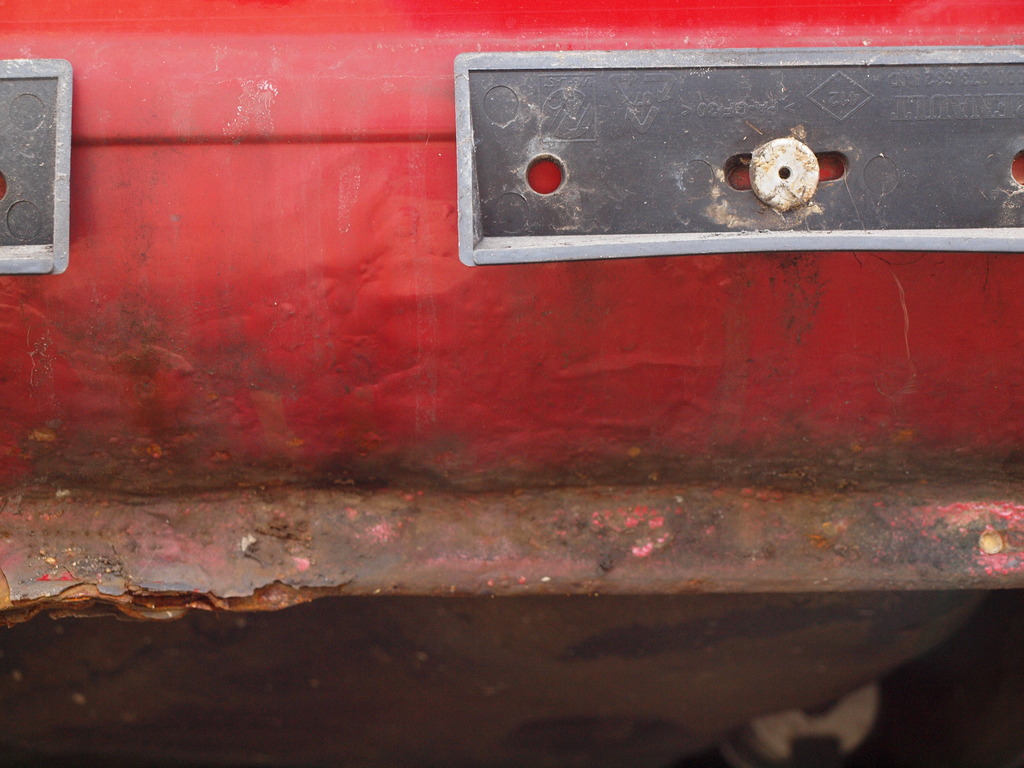

The rear beam is rusty and i think i will pull it out when the time comes and get it blasted and coated

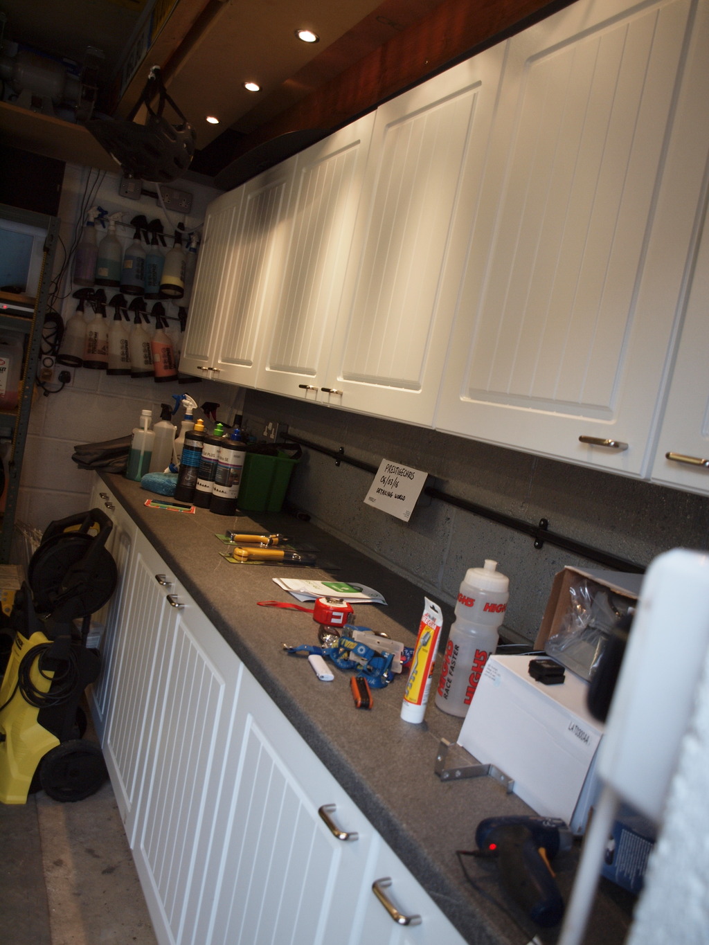

While i had the camera i thought id take a picture of my new cabinets :thumb:

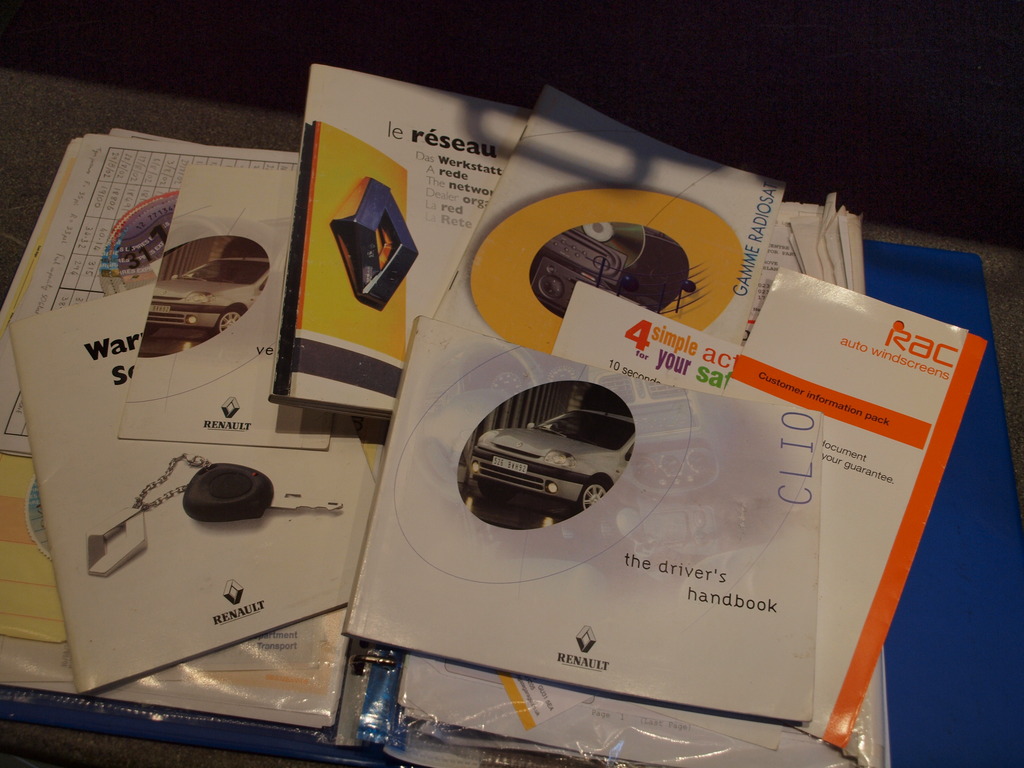

This is one of the parts that made me buy the car, its full history and all receipts etc
A previous owner has even added to the service book with his own sections where he has serviced it himself :doublesho
It has every MOT certificate as well as every tax disc its had :thumb:
This is a good part of the history though, the second owner had kept a full log of his fueling and MPG, 26 pages of it!! fairly keen i would say

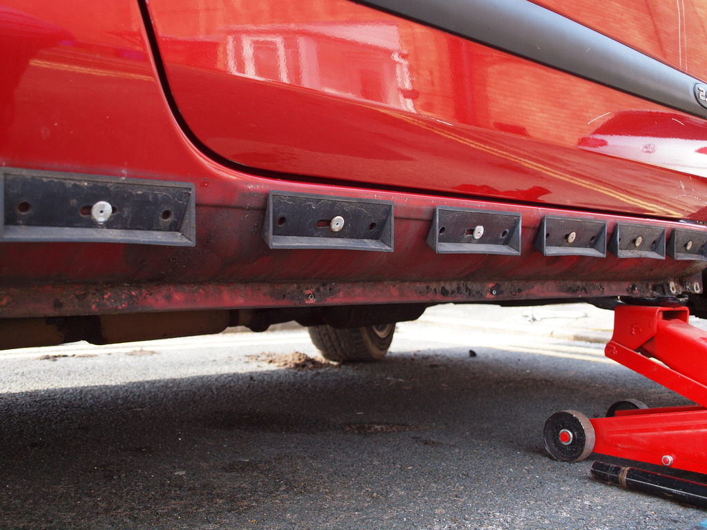

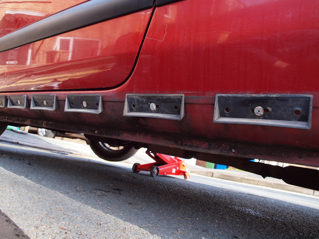

Looks nice,may be worth drilling out the rivets on the side skirts and removing and checking that the sills are in good condition.

As someone mentioned, check the sills under the skirts or via the inner rear door cards. If these are shot it might not be worth the grief

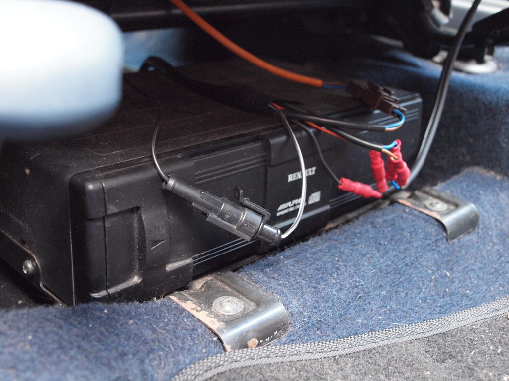

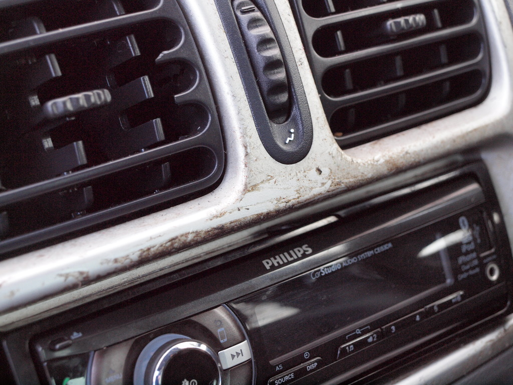

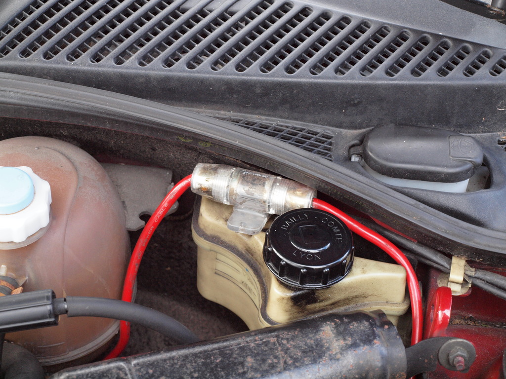

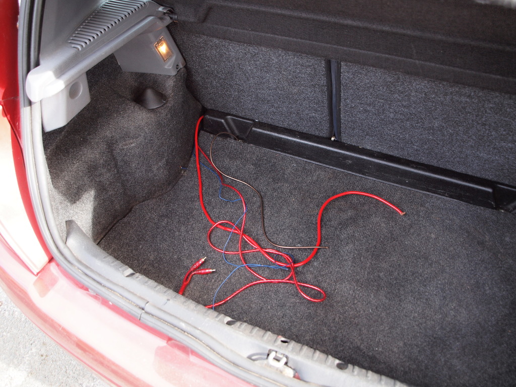

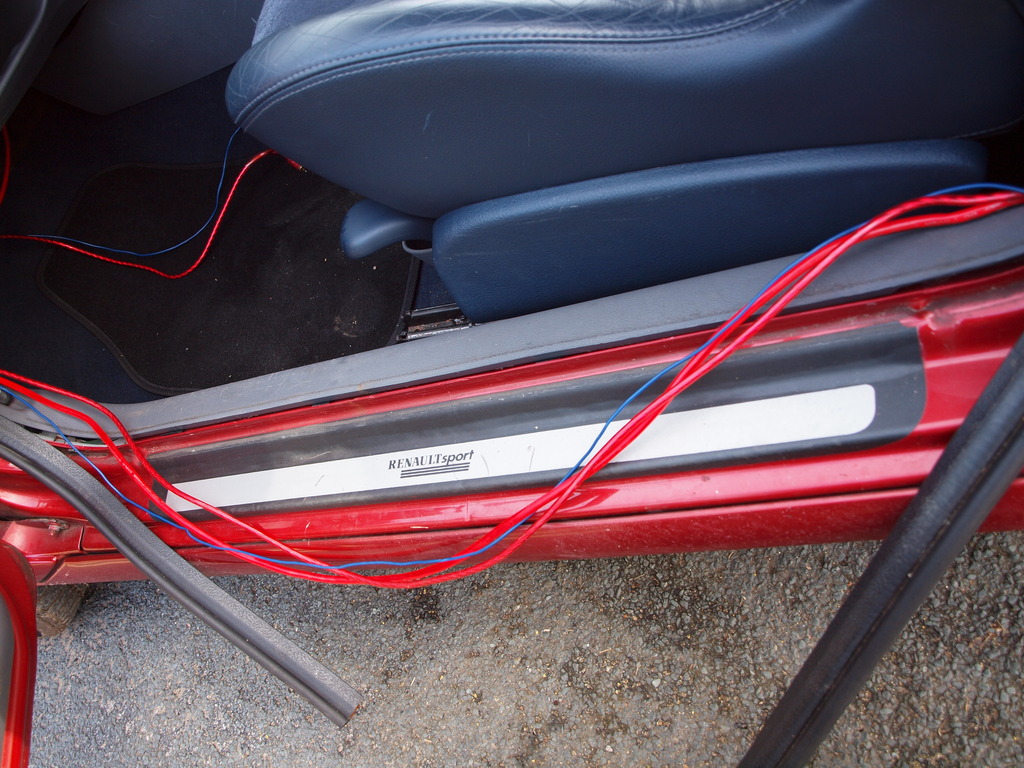

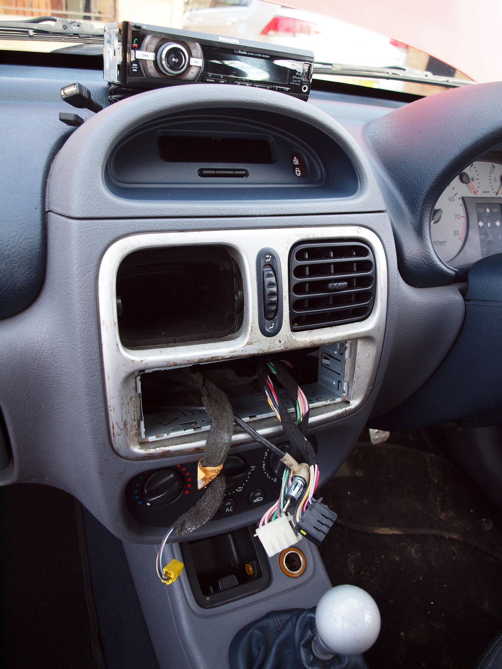

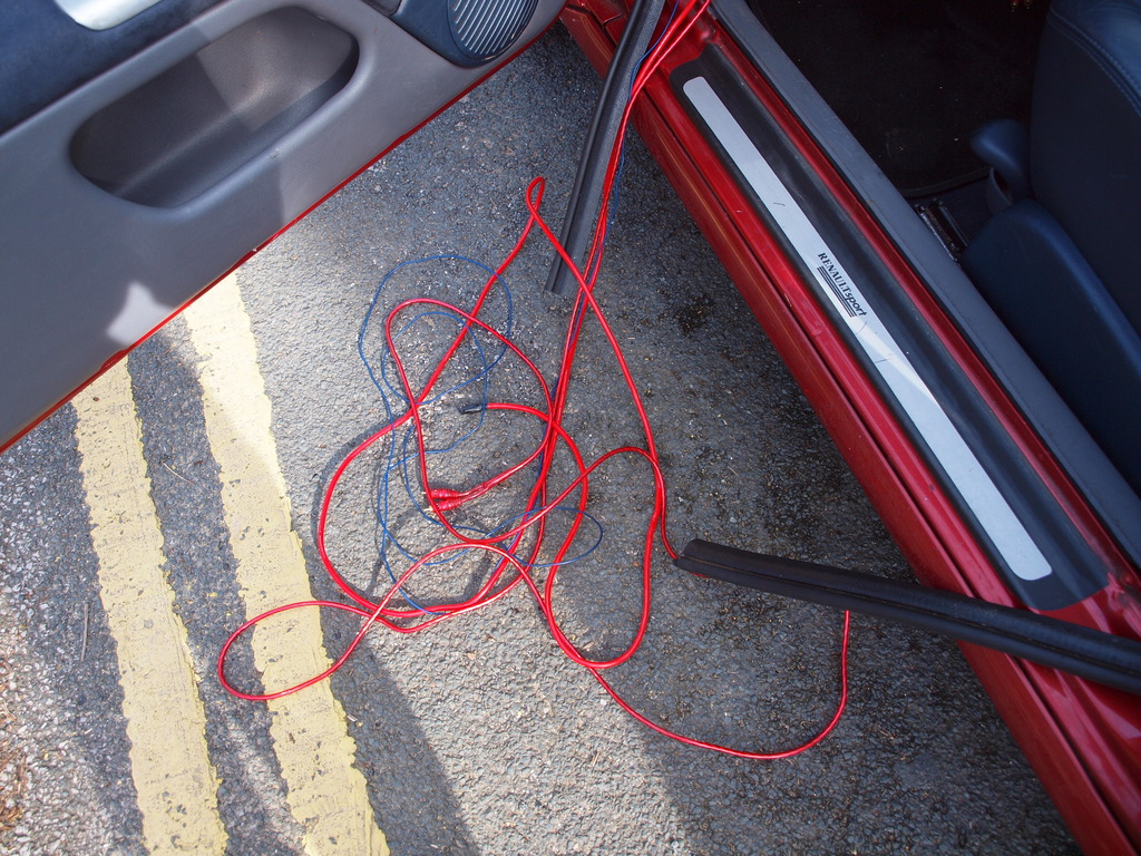

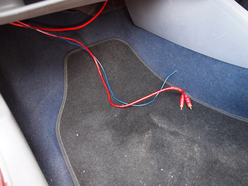

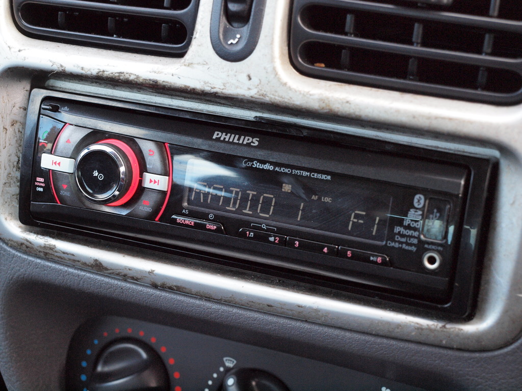

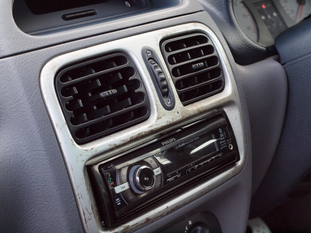

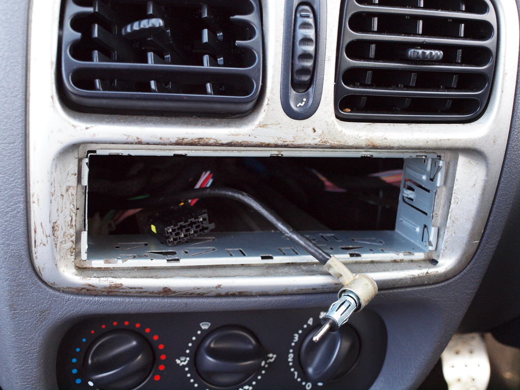

Started with removing the wiring from the sub and amp
Pulled the head unit out and removed the wiring

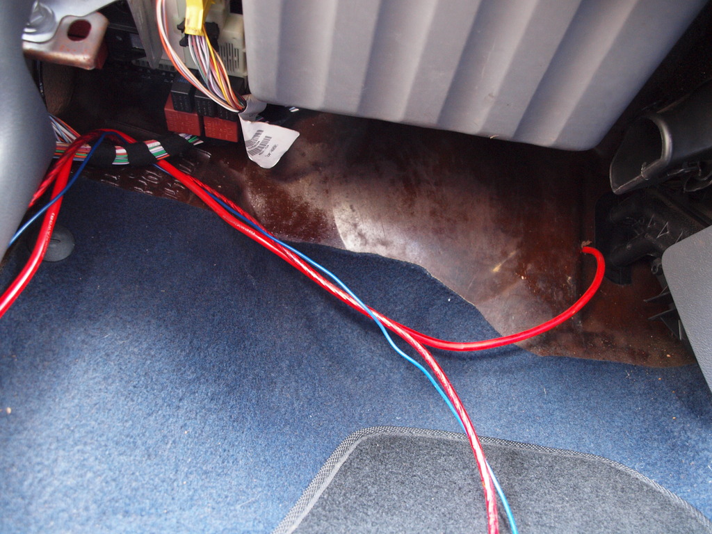

Pulled the wiring through from the head unit to the footwell
Pulled it all through to the footwell and removed it from the battery
Glad to get rid of that :thumb:

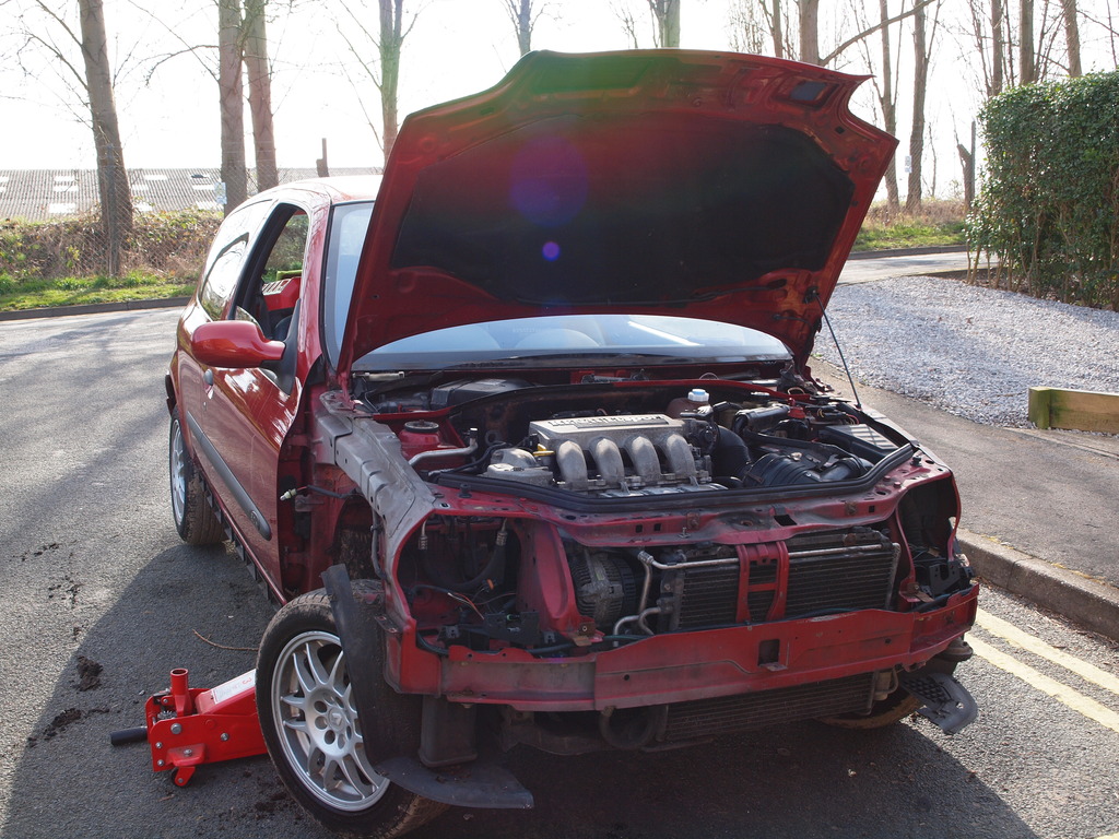

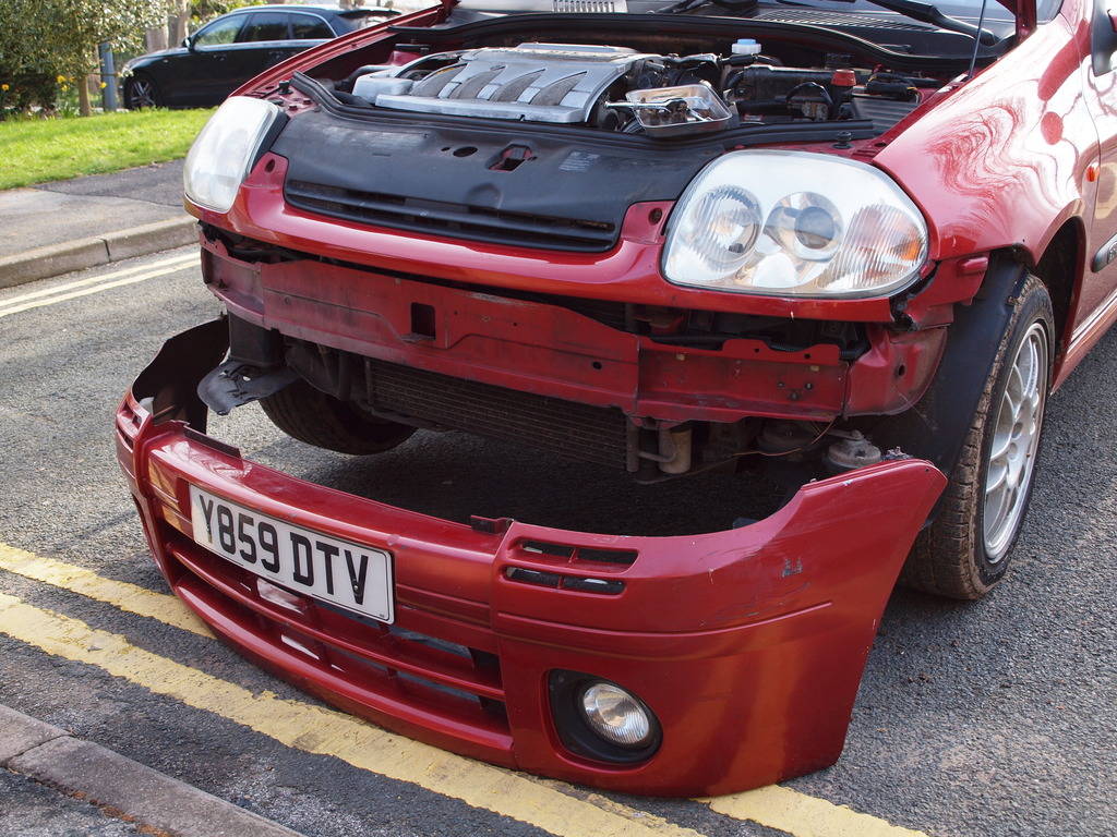

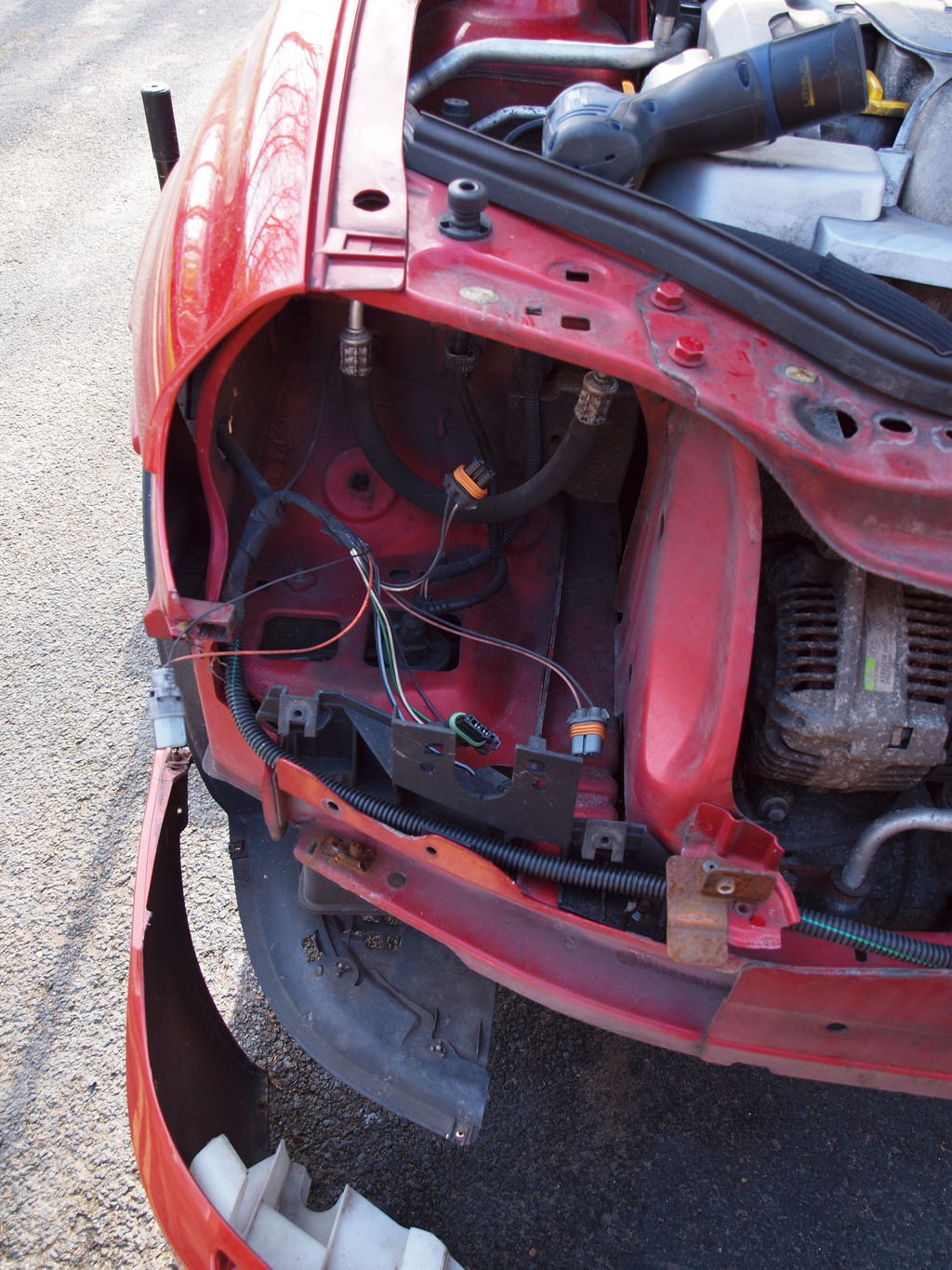

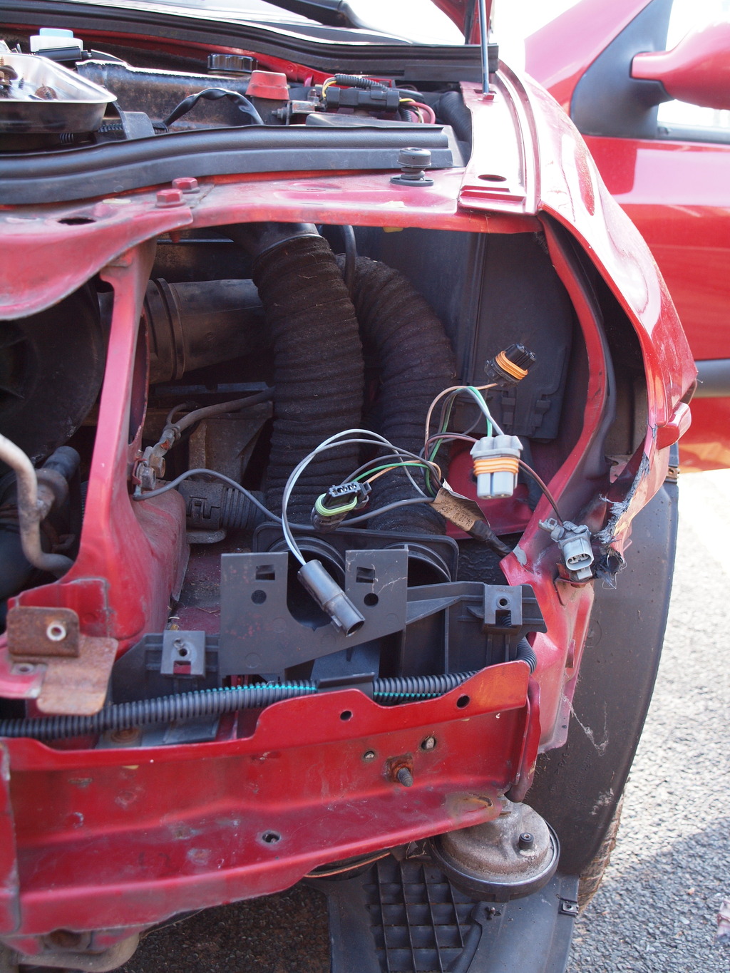

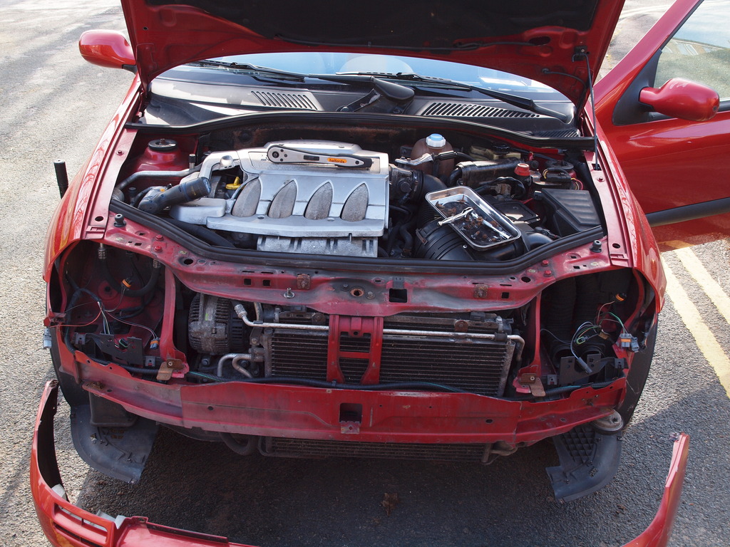

Next was start pulling the damaged parts off, also start to see what condition everything is in

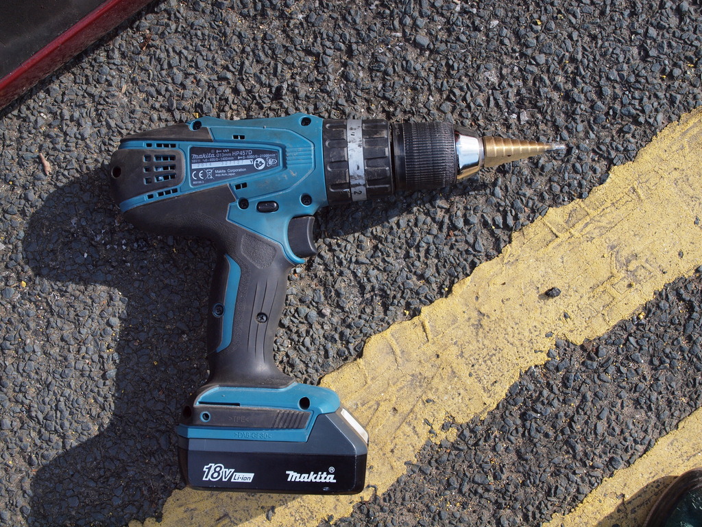

jacked the car up to get the mass of bolts and torque heads
Quite a few were rusted unfortunately so these had to be drilled out
Cant beat a step drill to remove the heads and also rivets

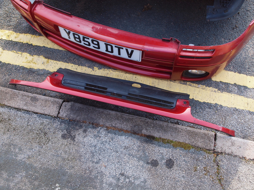

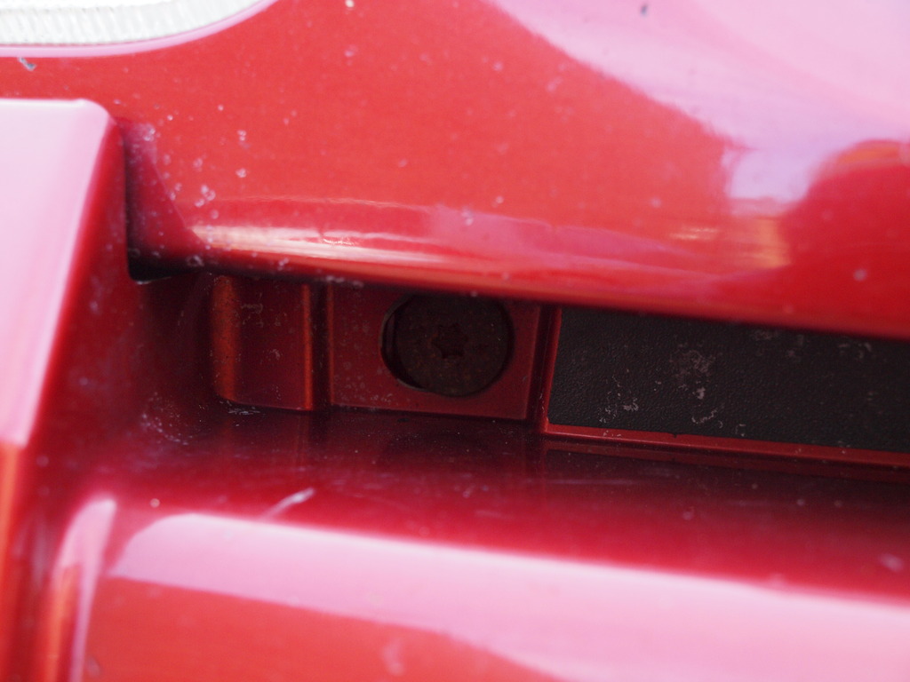

Bumper was the first part off, plenty of hidden torx head screws

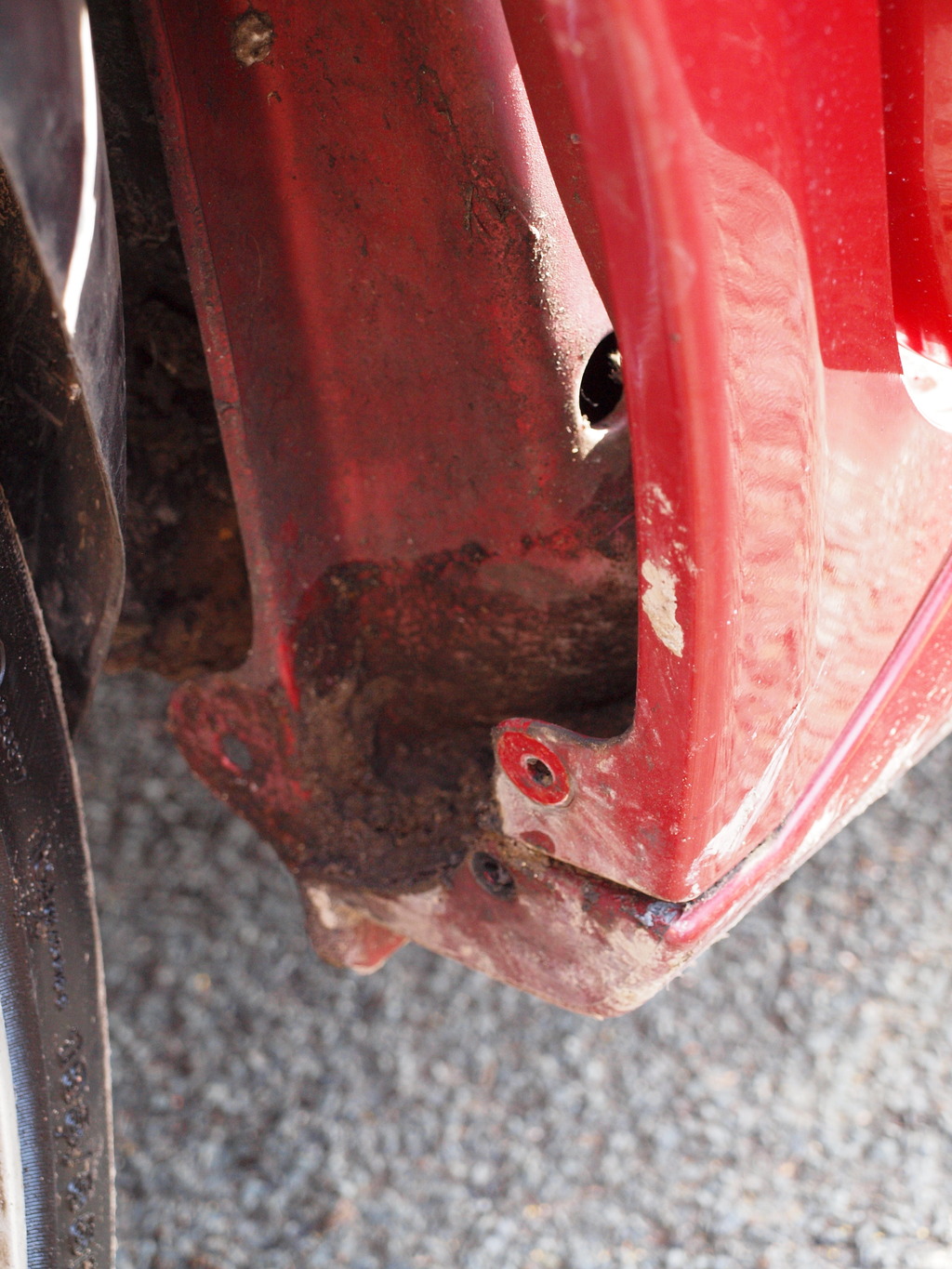

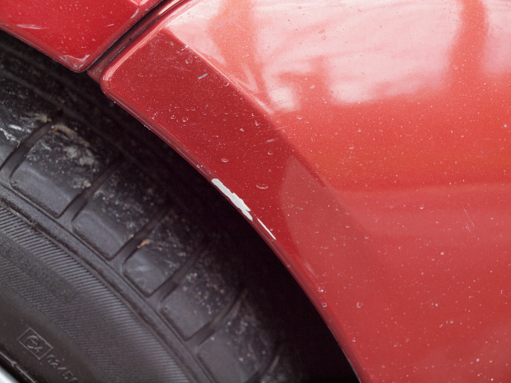

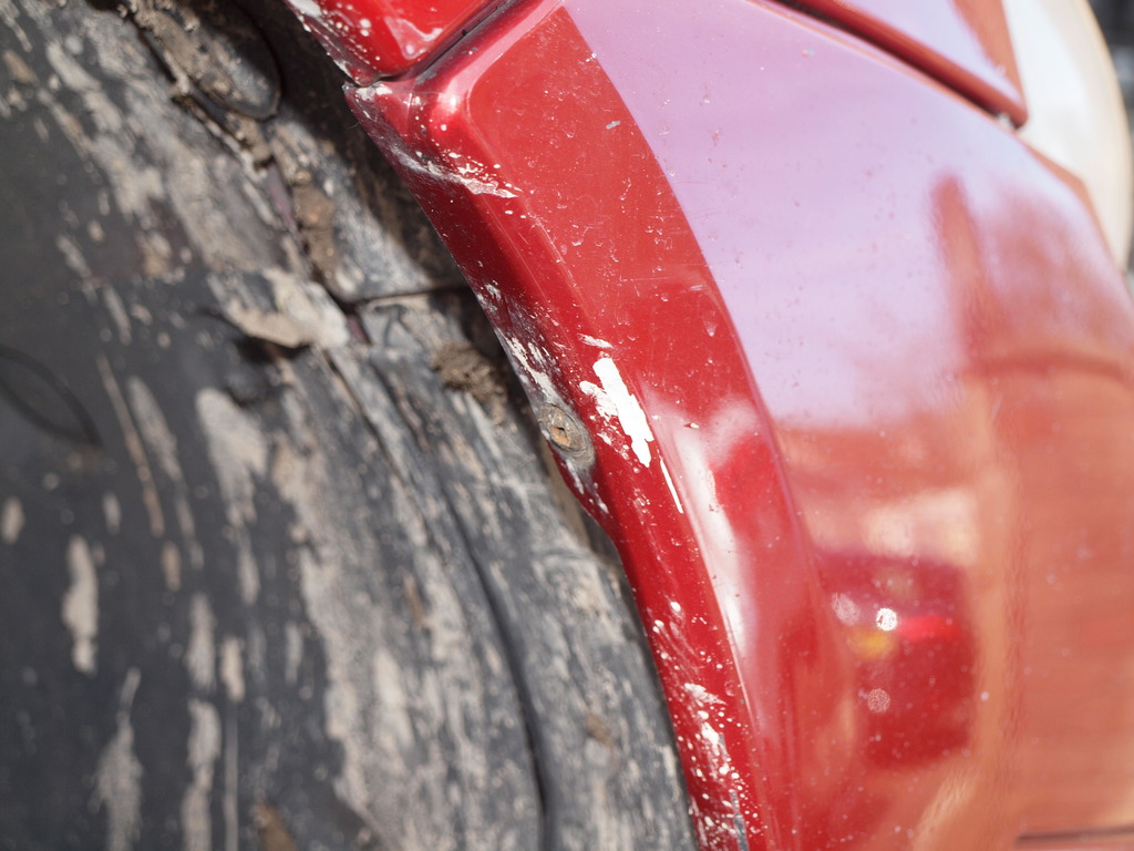

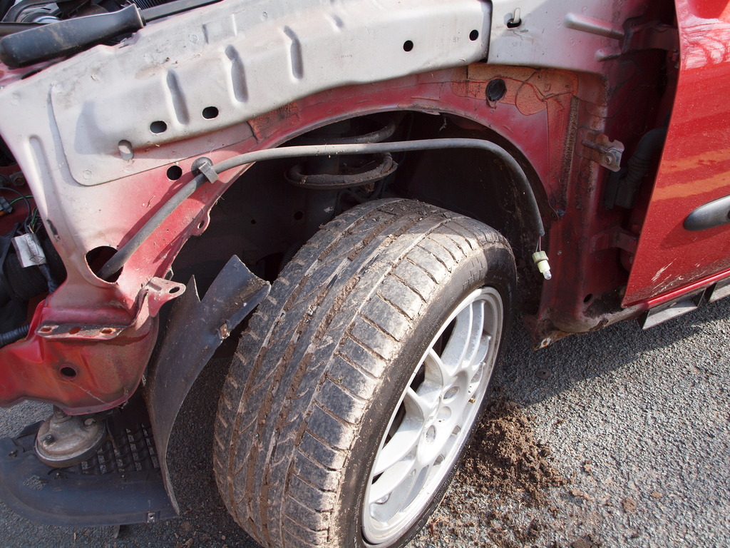

Next up the wings, looking at these im definitely going to need a pair :mad:
always amazed how much crap is underneath all the hidden parts
to get them off there are two hidden bolt heads behind sills and also one underneath the scuttle panel under the wipers.
That meant the skirts and wipers/panel needed to come off

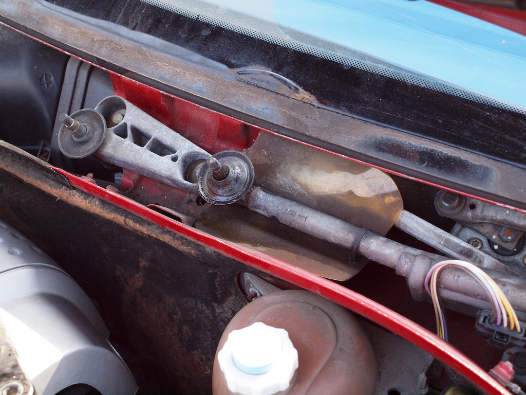

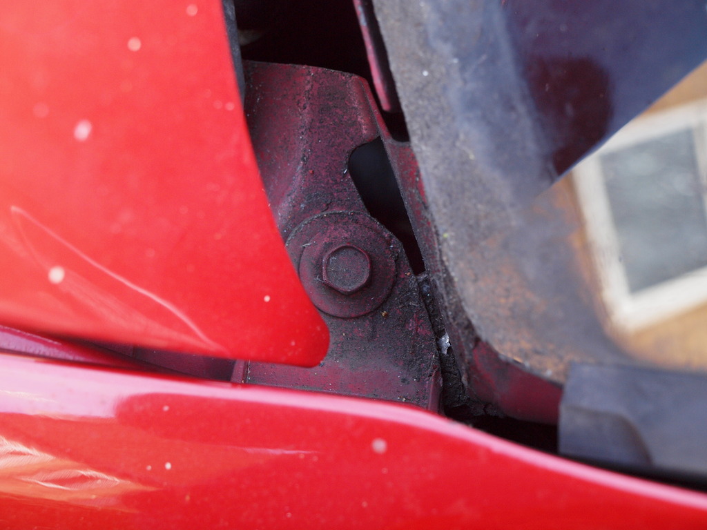

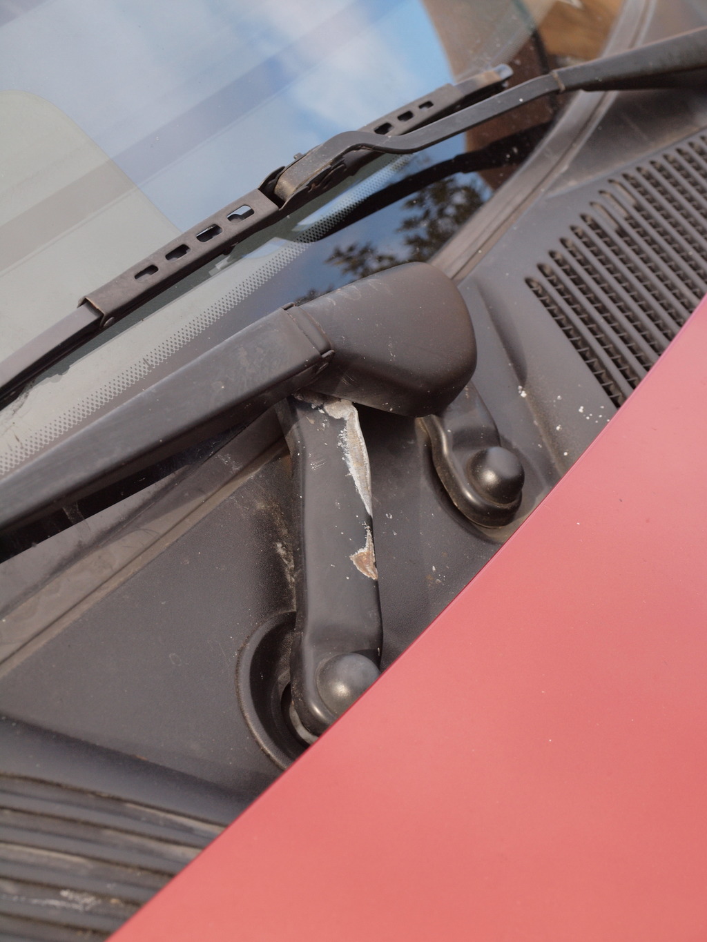

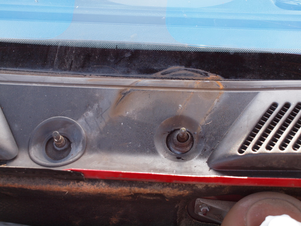

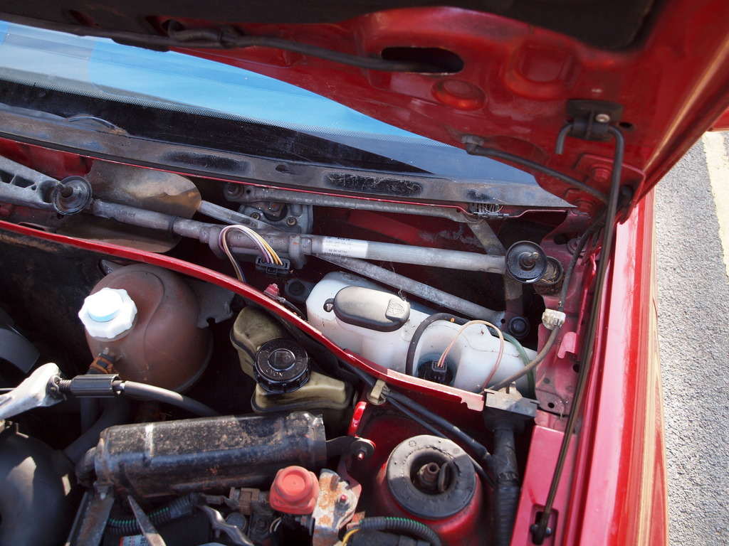

First off the wipers, one was bloody stuck on so out with the bearing puller.
Also noticed that the bush has gone on the N/S wiper arm so its been rubbing the mechanism
with these off you can access the bolt heads underneath

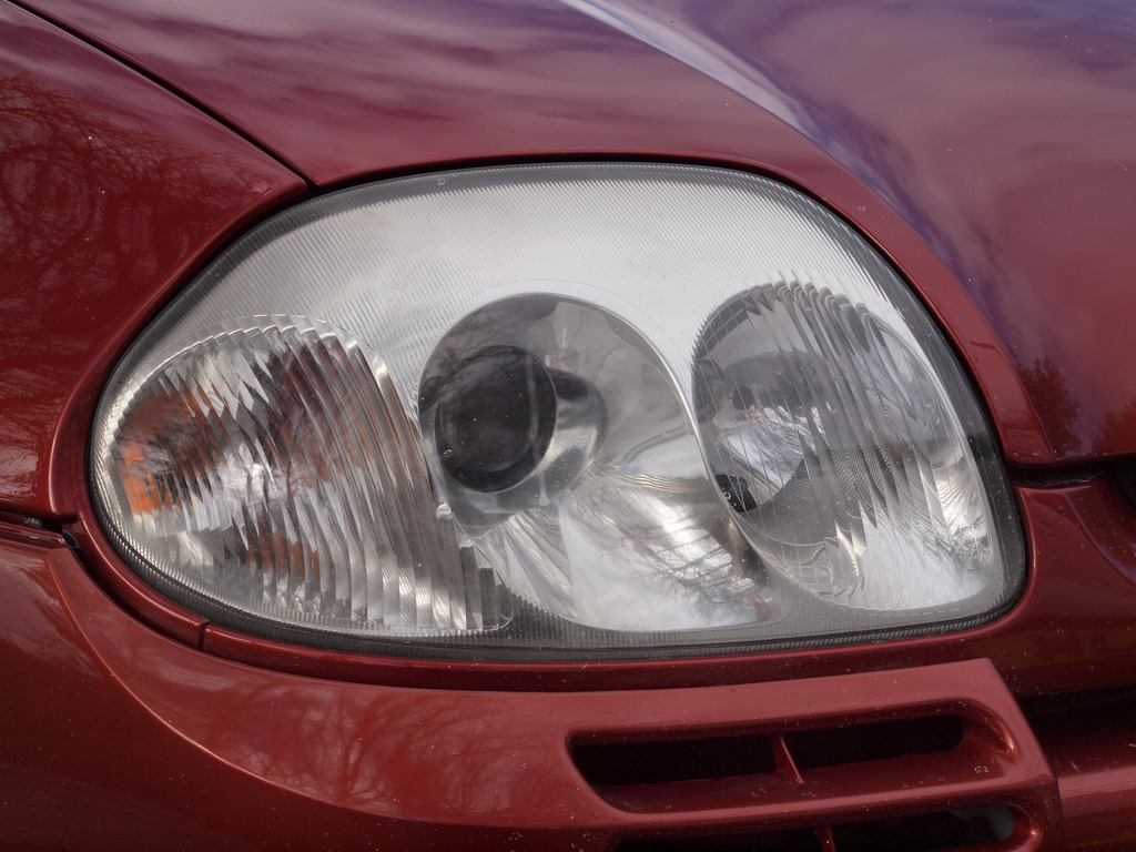

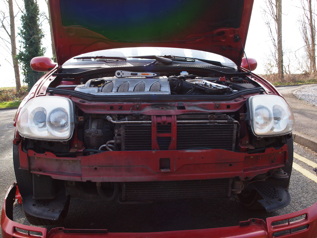

Whipped the headlights out while i was on the front end
Started to build a decent parts pile as well
Everything off, the car is starting to look a bit sorry for itself!

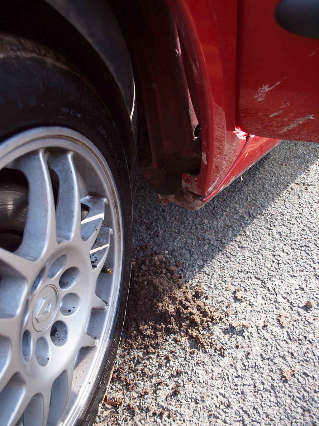

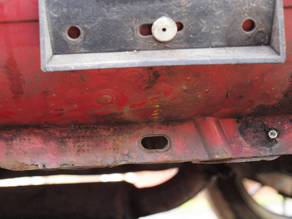

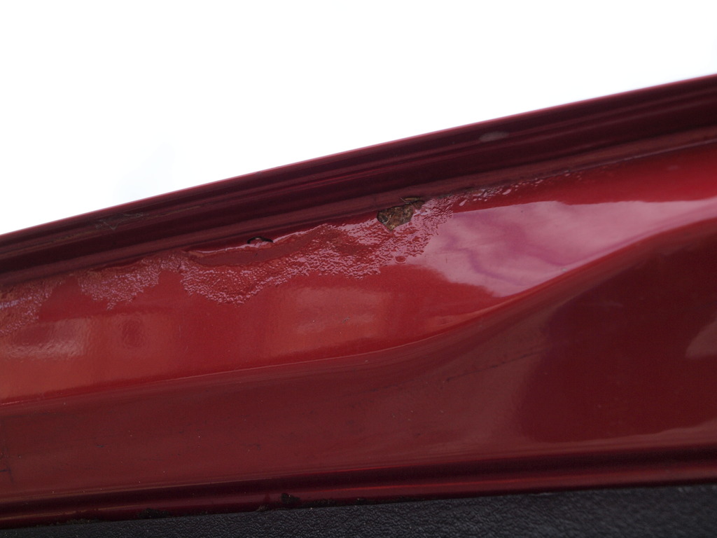

A few people have told me to check under the skirts before i go too far money wise in case its too far gone rust wise.
Looking at it theres some surface rust thats going to need attention but doesnt look like its rotting

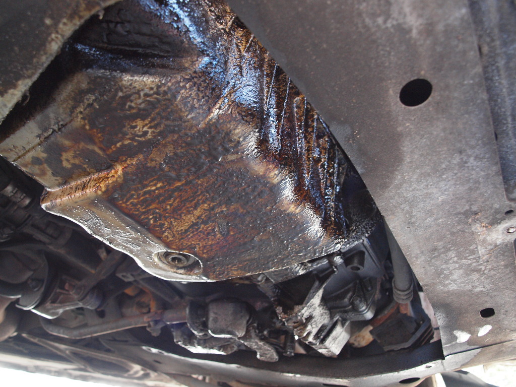

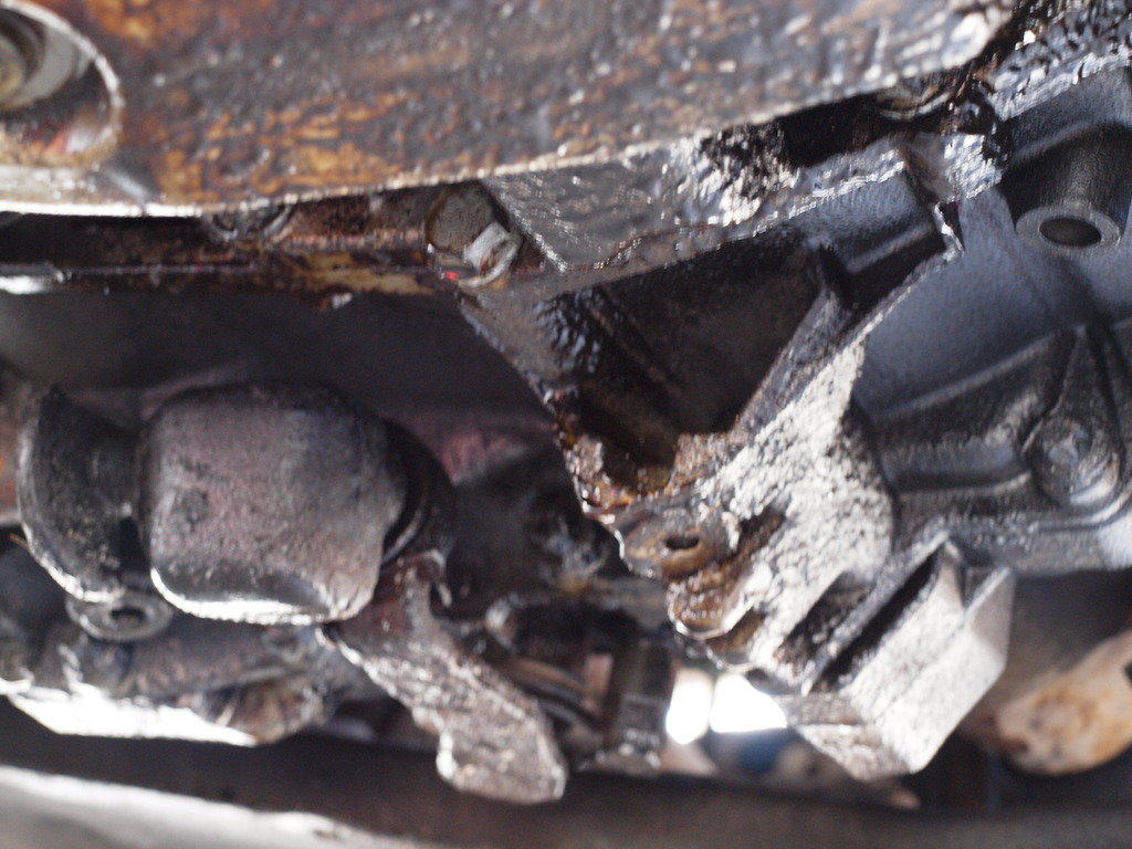

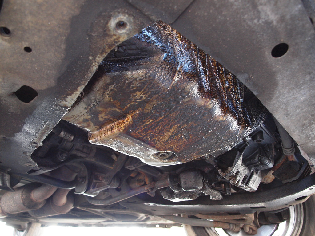

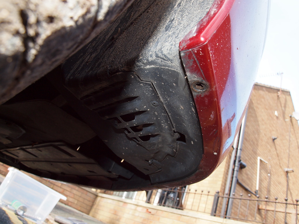

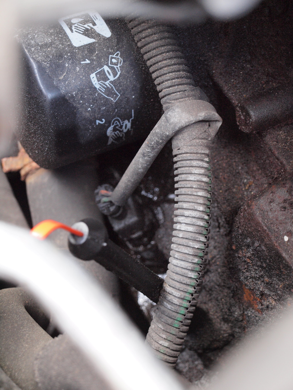

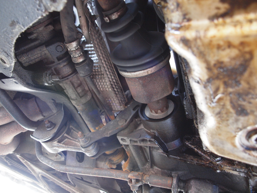

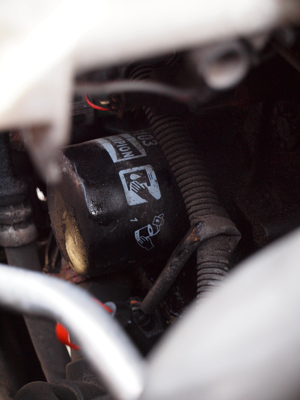

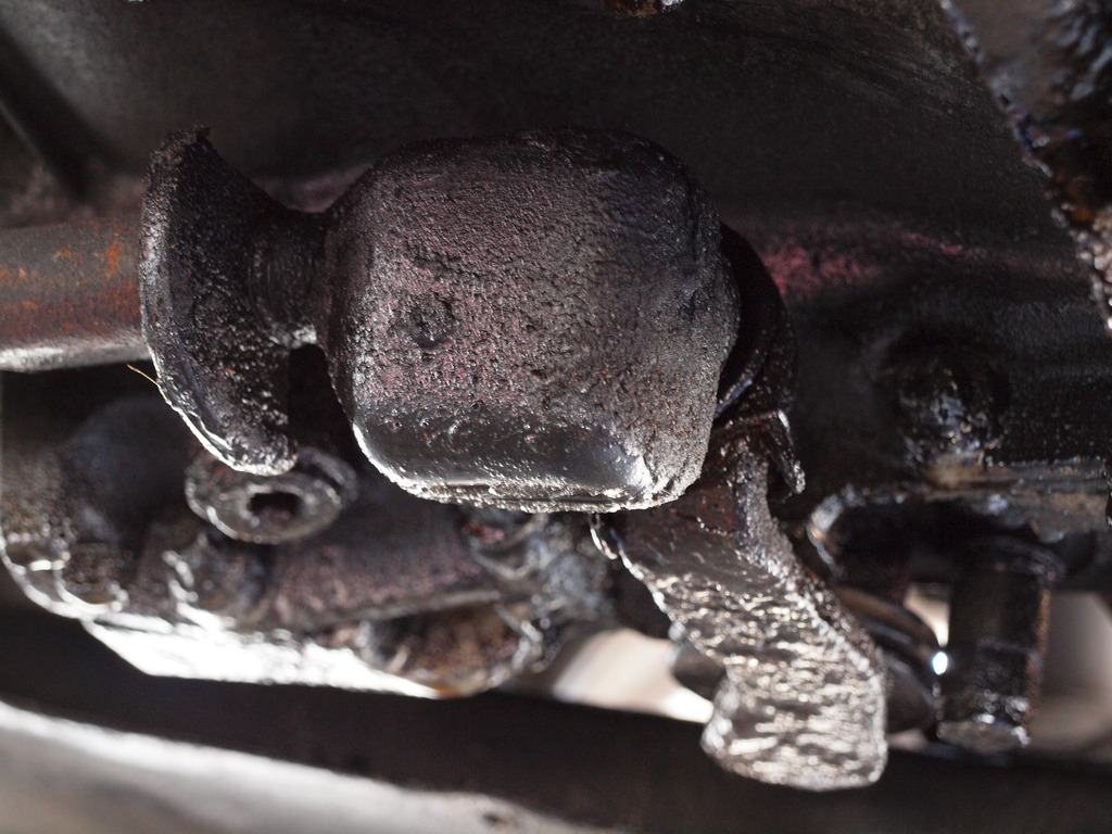

Next up was a look at the oil leak, its fairly bad looking at the engine from above, so off with the plastic guard underneath and the revealed this!!! :doublesho:doublesho:doublesho
Needless to say i thought bad thoughts :censored::censored:
Anyway looking further into it and following the oil i think i found the issue (possibly) it looked like it was coming down from above the engine from the filter housing
reached down past the inlet manifold and checked filter and it was loose, like free spinning loose! Tightened and hopefully this is the issue. Will have to degrease and clean the sump etc so i can check when running
the rest of underneath is fairly clean which is a bonus! No knackered bushes or seals

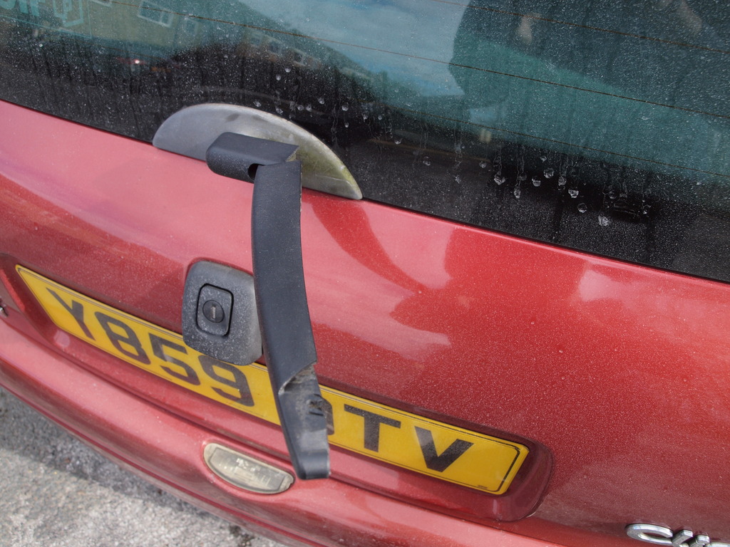

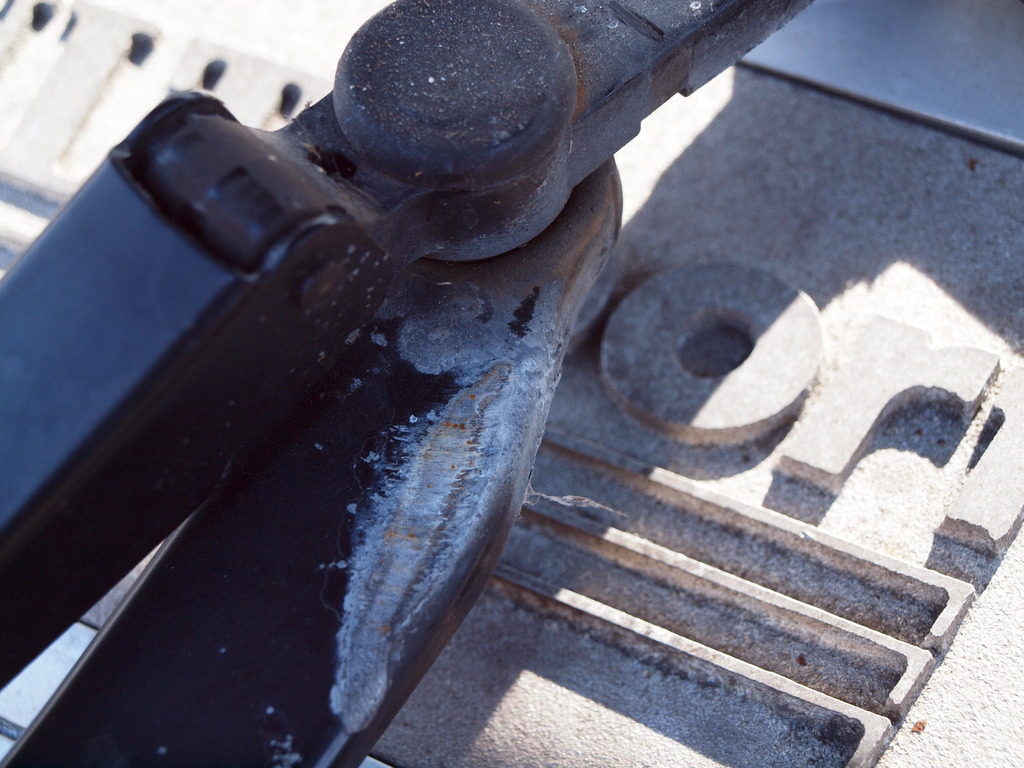

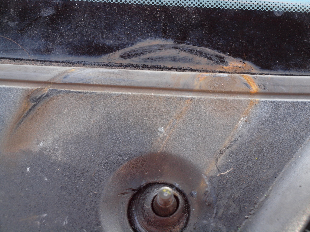

OP - just out of curiosity if you ever get your wipers back to this state that you had them....
The bolts on that wiper arm - should have several metal washers between the bolt itself and the arm. There's also a third bolt that's off to the right of the picture - but I can't recall if that has any metal washers.
Could you let me know how many washers are on each bolt? I 'think' when I reassembled mine, I put the correct number back - but I'd like to make sure!
