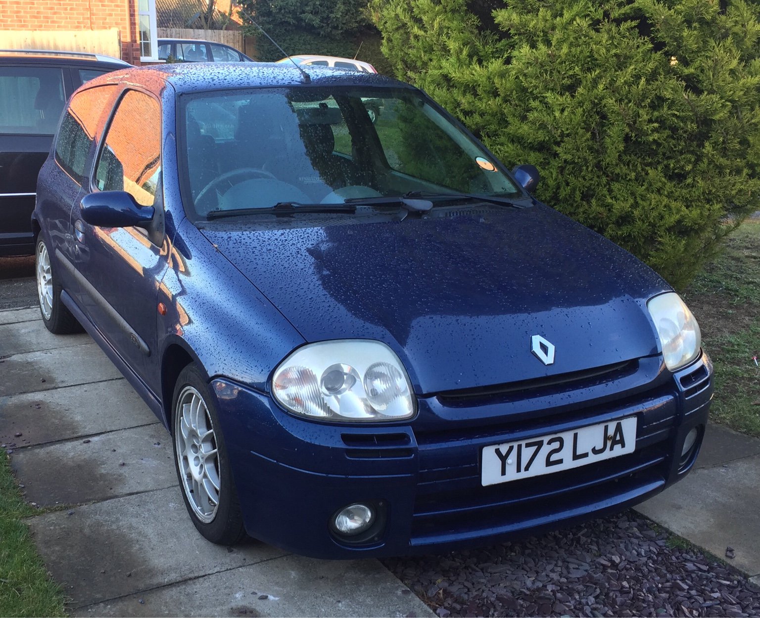

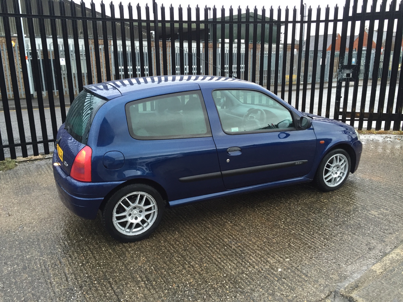

So I've got the 172 bug again and I found myself the owner of a genuinely great little car. It's a one owner car, low miles, and heaps of history and it's just had 12 months mot put on it! And it was an absolute bargain!
This is the car when I got it home yesterday....
It's not without its problems...
Front bumper isn't fitting correctly.
Front fogs don't work.
Fuse box isn't fastened up.
Paint work has been let go a little but nothing I can't sort!
And a few other bits and bobs.

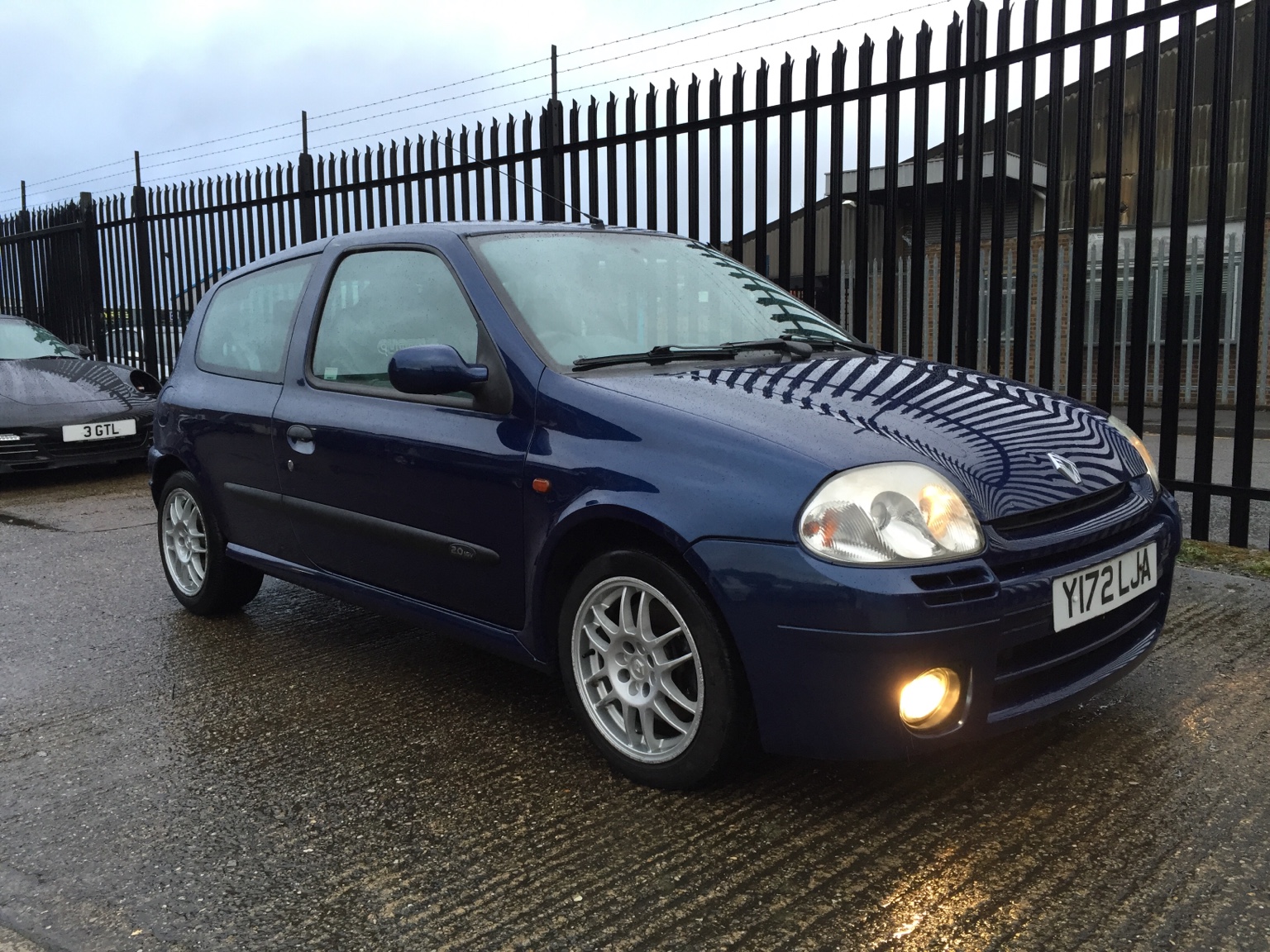

So today I decided to spend some time with the car and fix a few niggles.
I took the bumper off to find the problem with the fogs anyway, the bumper was being held out by a torx 27 socket that had perhaps been dropped at some point during a repair etc, the front fog light issue was a corroded plug where the car loom joins the fog light loom!
Managed to get the fuse box fastened up properly without removing the dash which was a result! Somebody had decided cable ties were the way forward instead of putting it back the screws!
Put a battery in the key, re synced it with the car and joy I've got remote central locking again!
Gave a small part of the bonnet a quick mop as in pretty sure the cars hasn't been washed in many years!
It does need some bringing back to life and I'm going to take my time doing it!
On the upside turns out it's got a cat back stainless steel system on it!! Not sure of the brand at the minute but time will tell when it hits the ramp!!

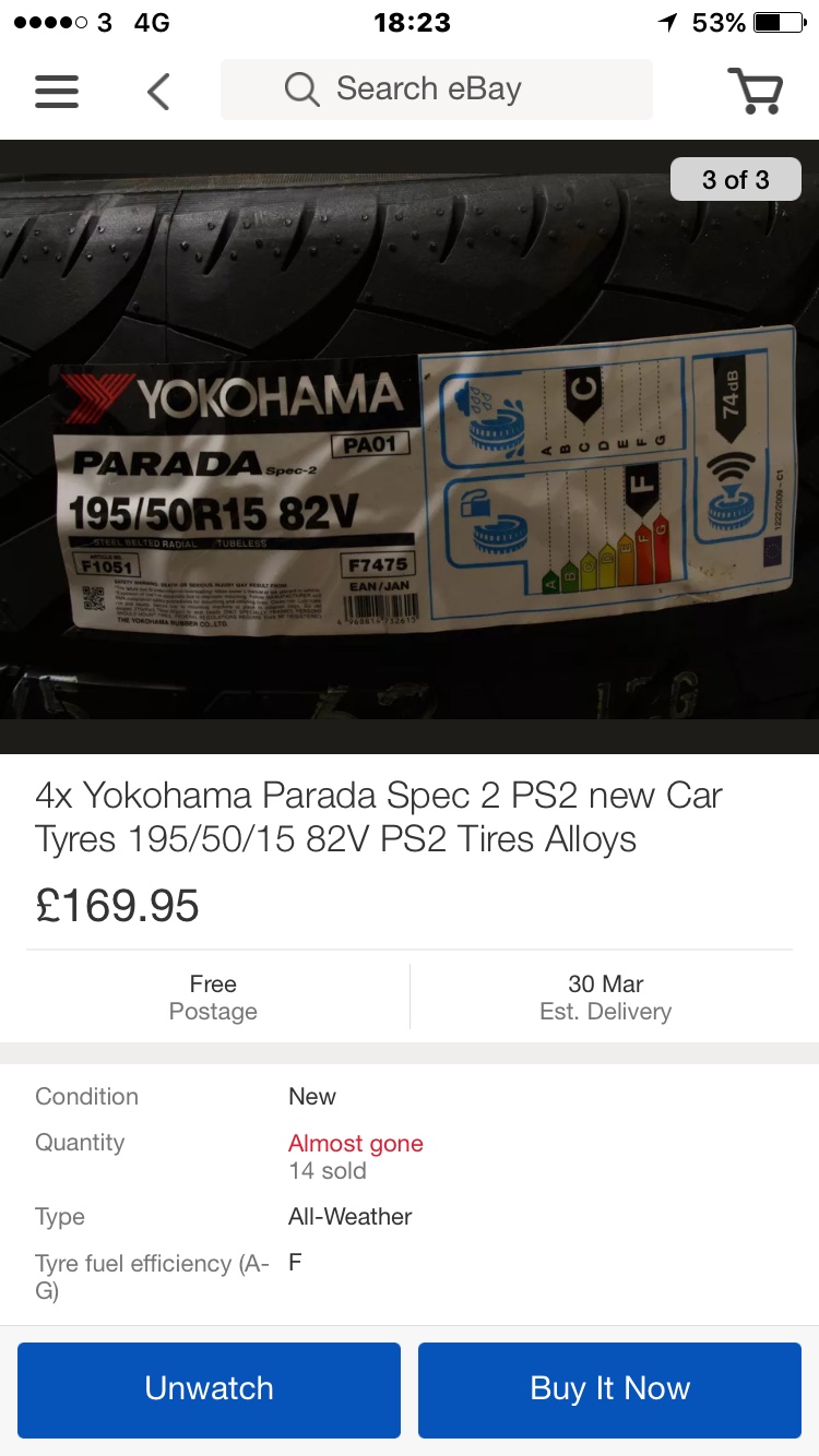

Been looking at tyres and I'm thinking about these, anyone have any experience with these?

With regards the tyres search on here. They haven't the best of reps unless bone dry.

Thanks mate, I'm pleased with the colour and the car as a rule. When I got home I jumped straight into the phase 2 as a comparison and I couldn't believe the difference in the two cars!
I'll have a good search on the forum, I know I had Pirelli p zero's on my last one and they were really good!

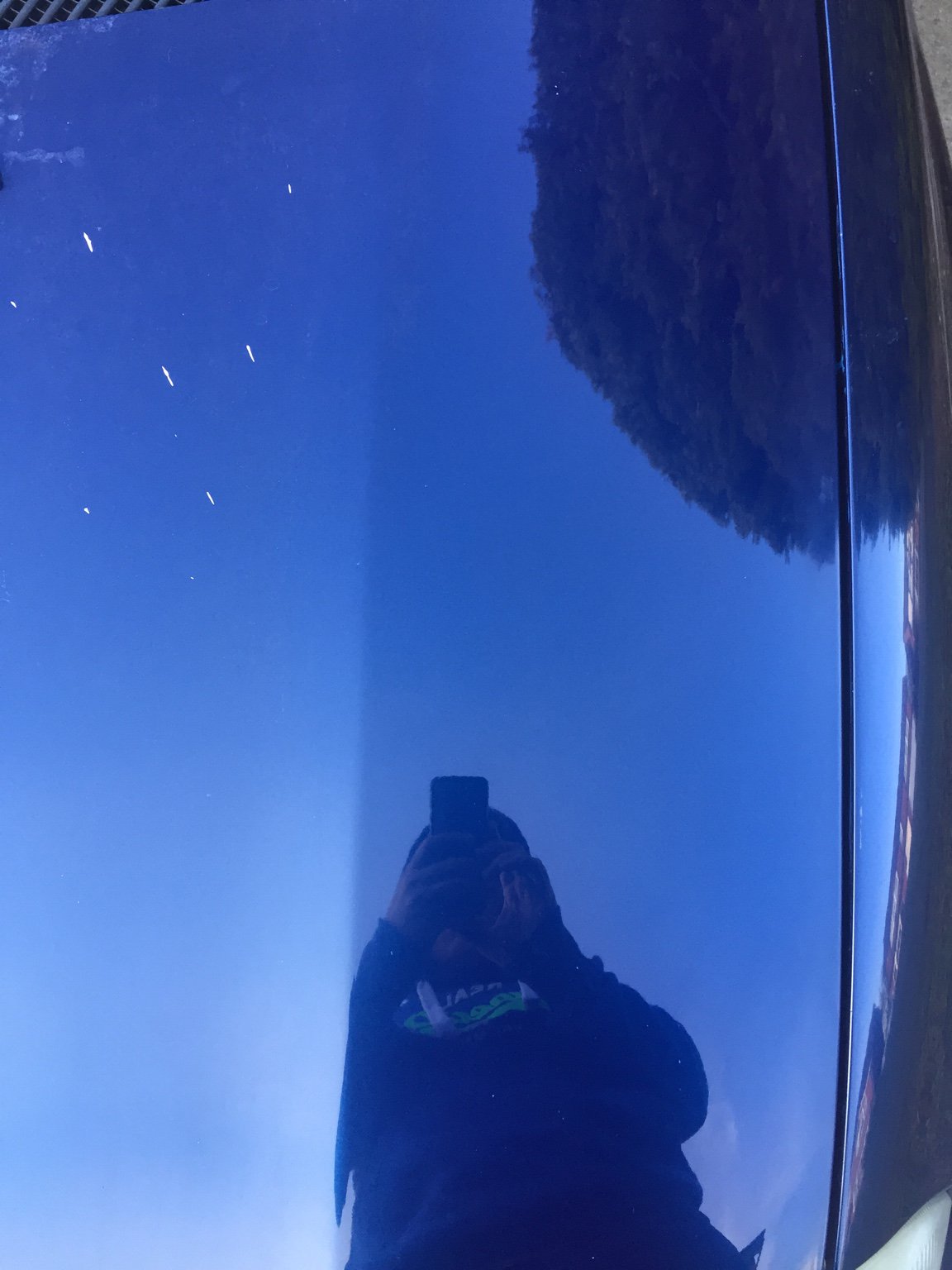

To be fair the paint on the roof and bonnet isn't great, bird poo left to bake on in the sun hasn't done it any favours!

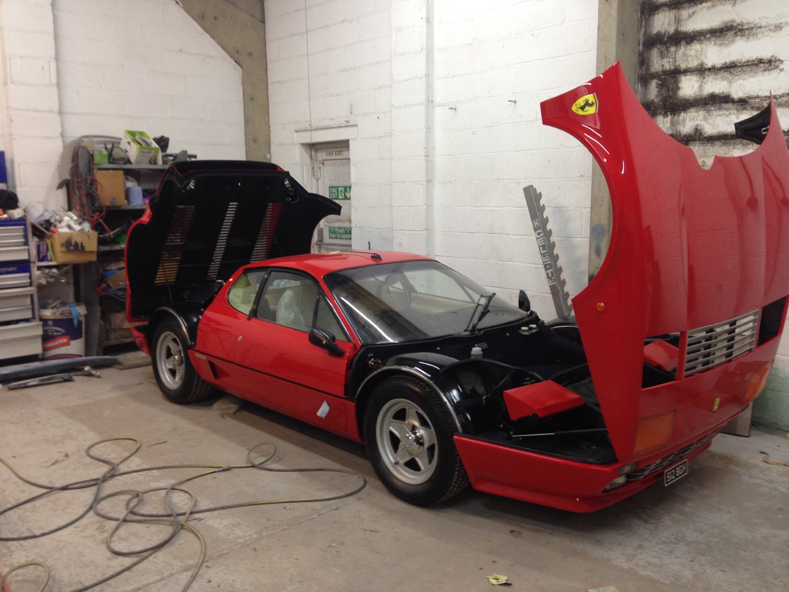

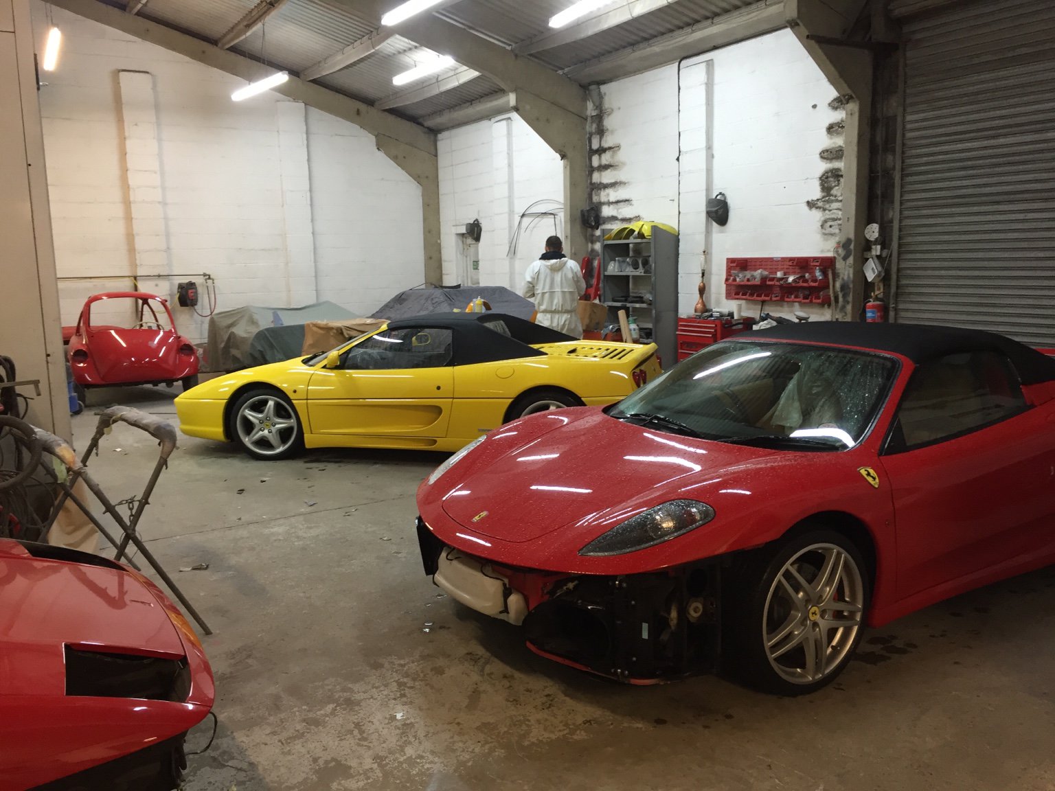

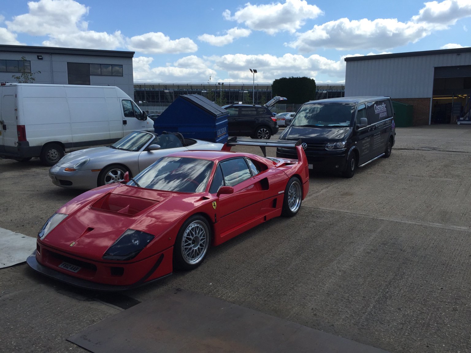

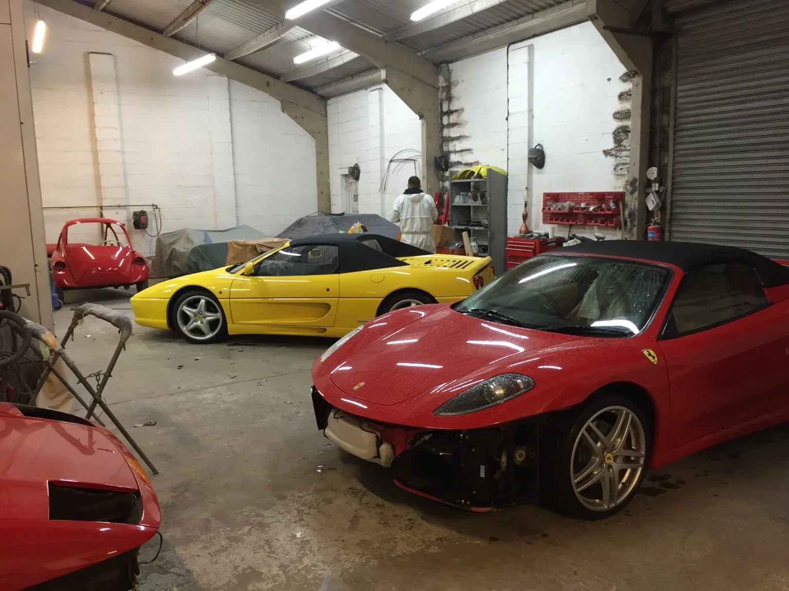

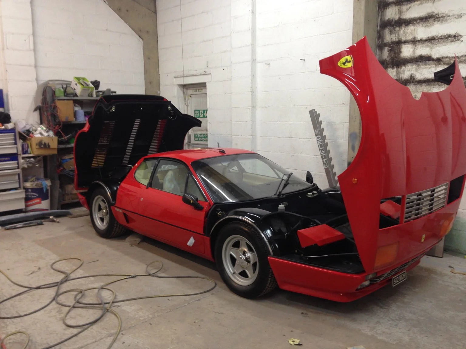

WOW!! if i had your job i wouldn't get any work done, id just sit there in the cars all day! (or take them out!!)
172 looks lovely, and once you've finished with your plans it will be perfect!! love a ph1!!
  Clio 172
The novelty wears off mate!
  RB 182 FF

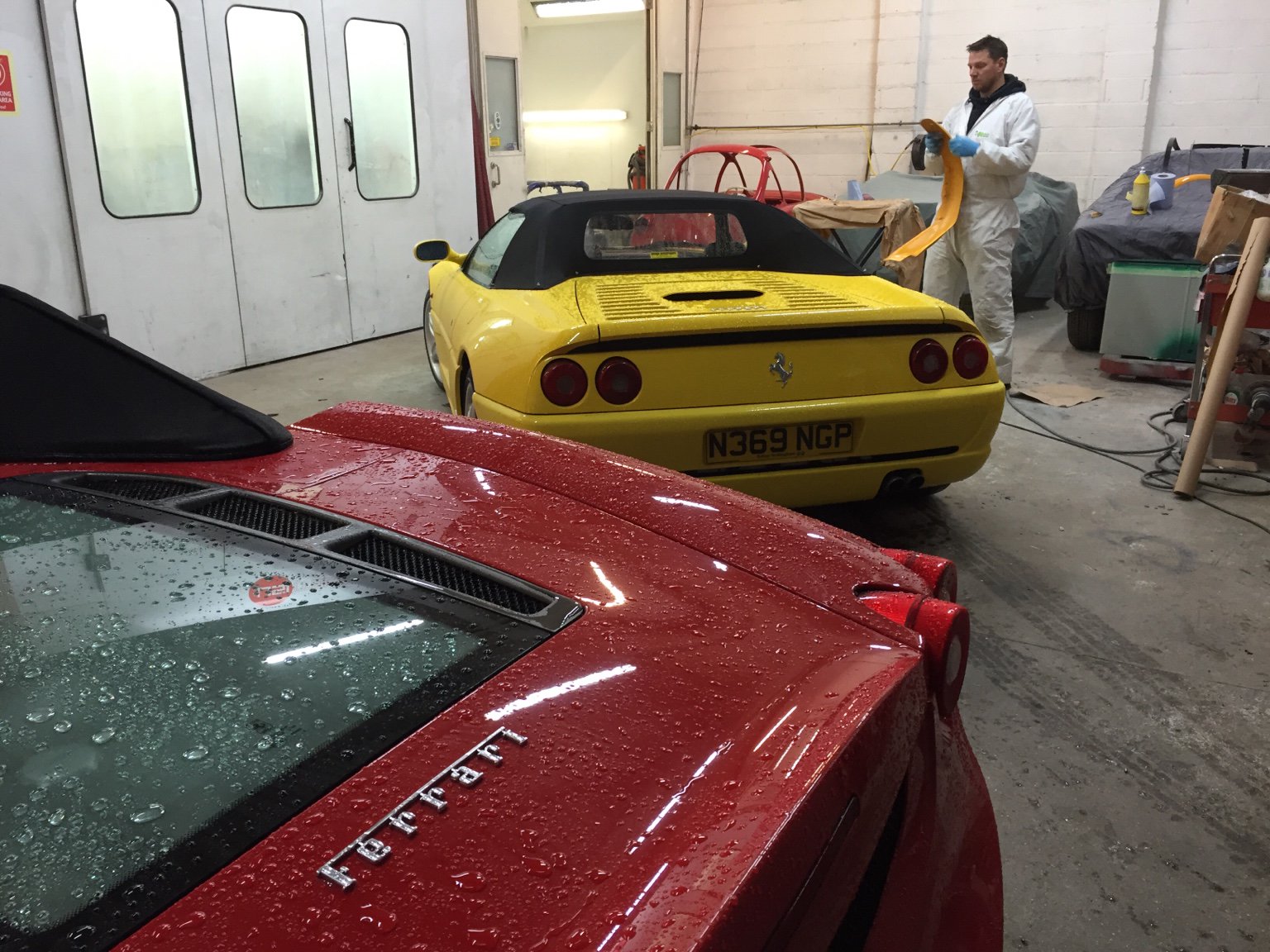

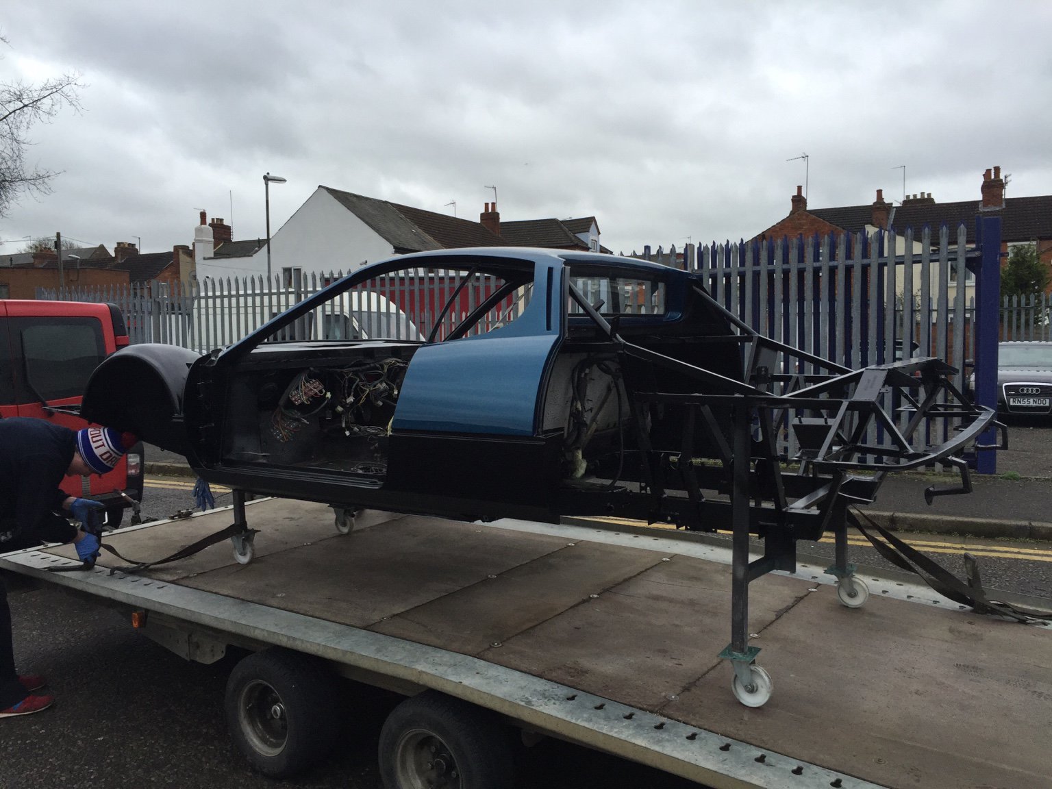

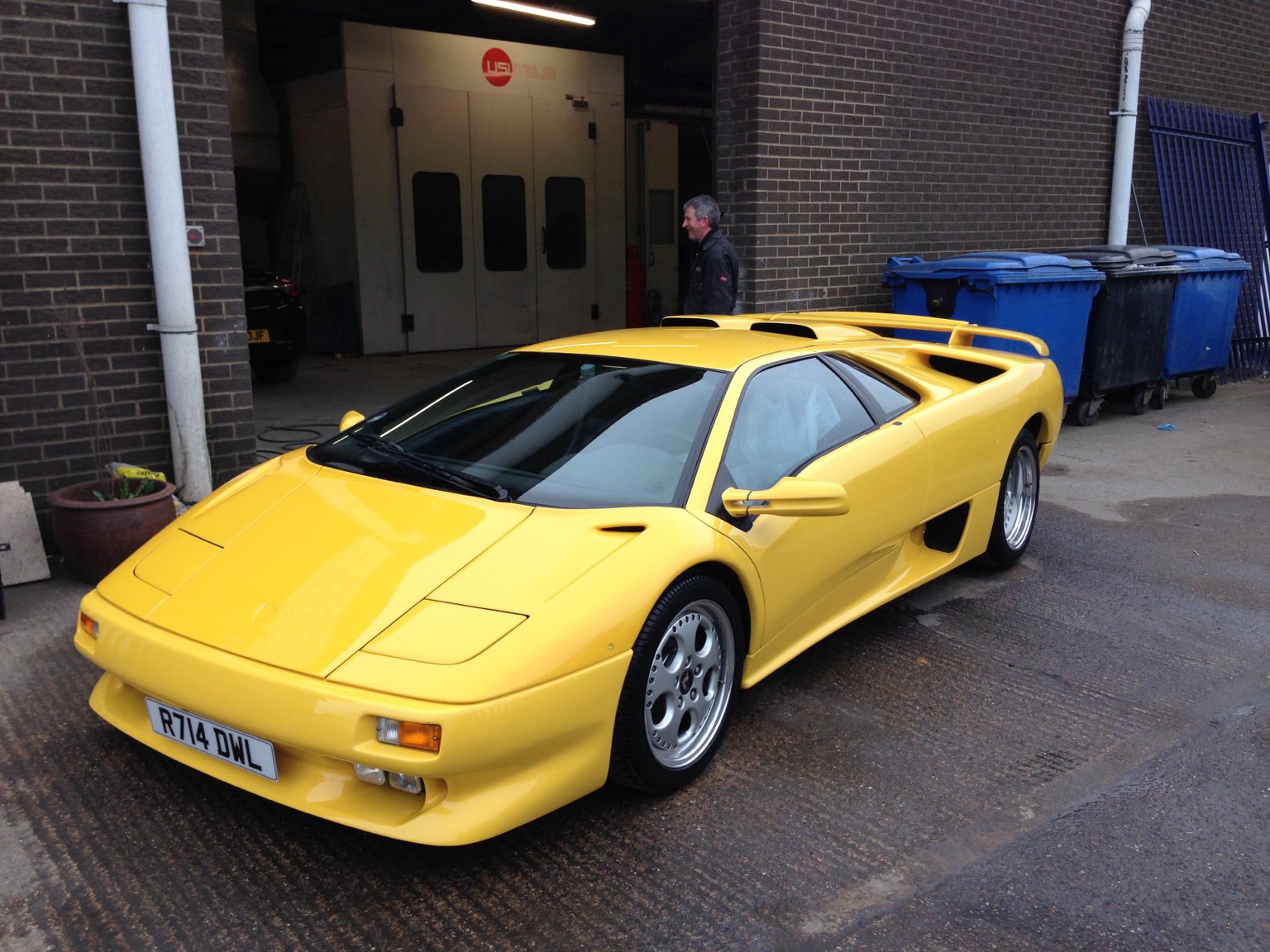

That's an impressive selection of cars you've worked on, I'm guessing the quality of your work is pretty damned good!:smile: Although I love originality I'd have to spray those door strips and handles, the black strips and handles just don't shout out sport at all, more like 1.2... Also I'd need a cup spoiler and it would be epic, I know you want to keep it original however...:up:
