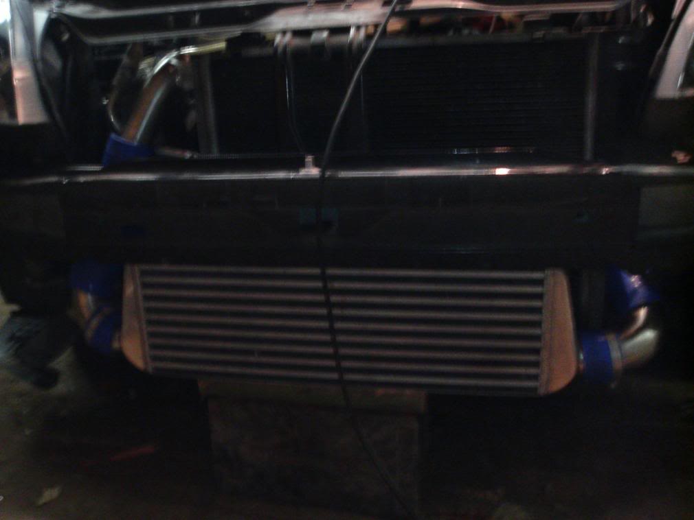

here's mine :D
during installation, tight sqeeze:rasp:

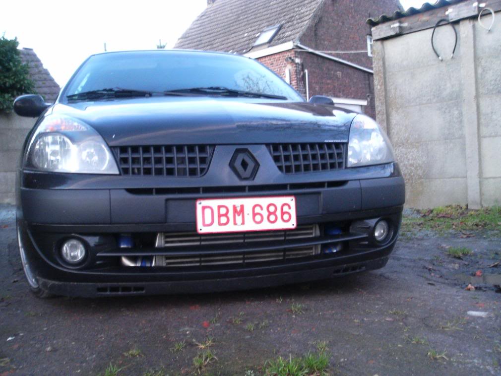

finished product

with this setup (IC, dci80 injectors, turbo&diesel pressure up, k&n with caf, decat and remap) i have 126bhp at the flywheel which is 101.6bhp atw and 276Nm of torque
I suggest you go with the dci100 ic, it's the simplest to fit, the dci80 is a real bugger to fit and isn't even that effective, and it even looks wrong too;).
If you want i'll search for the part number of the dci100 intercooler, got it lying here somewhere, with the pipes i cant help cuz mine are dci80 ones with ss custom pieces.
