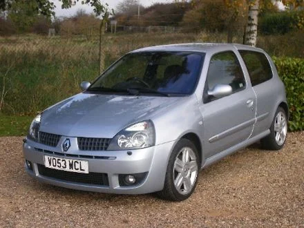

This is the only pic I have so far, taken from the garage website....
