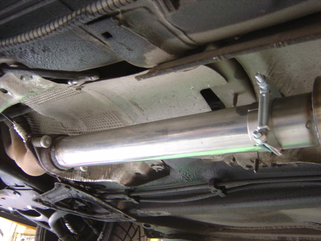

One I made a while back
That must be horribly loud I want one now, what do you do with the lambda on the cat pipe though? Surely a light comes on.
Can weld a boss in if you like, easy enough to sort. leaving the 2nd lambda outside the exhaust stops the light comning on though
Oh right, and this was £60-70? Need mot done within 2 weeks will get it passes and call you about sorting this out, unless you do mots as well?
Depends if you have a cat I can cut the front flange off or if you need me to get one.
don't do MOT's on site. Can organise it for a fee obviously if you leave it with me for a service etc, but decat isn't possible with my guy since they shut the loopholes on cats
