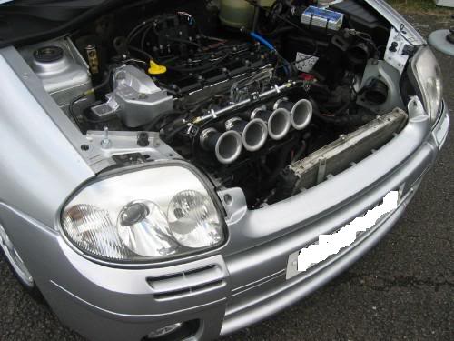

I have been looking at the ktec turbo conversion after my ITB install got put back a year. Its very temting to buy the kit for around 3k and fit it myself. 260bhp and 260lb/ft makes your cammed ITB install of 225bhp and 175lb/ft look weak.

nah, spend £6k and nothing but the top end Evo's will be able to see which way you went. Mine's realistically only 220-230bhp and quicker than 320bhp Evo's. Even from standstill I'd reckon by 100mph I'd be starting to reel them in and pass with some momentum
ITB? Im not planning going totally mental with the car and striping it down to bare shell kindo thing! I still want to be able to use it. Is 225bhp 175lb/ft what you got outs yours after the mods that i have listed? I dont have the required knowledge to even think about doing a turbo conversion myself altho i do have a mate that works at Juno racing that might manage it!!

Mine is around 195bhp and 170lb/ft.
What is a cammed ITB install??
When you have cams and throttle bodies, It will include an aftermarket management such as Omex too.
camshafts and individual throttle bodies
