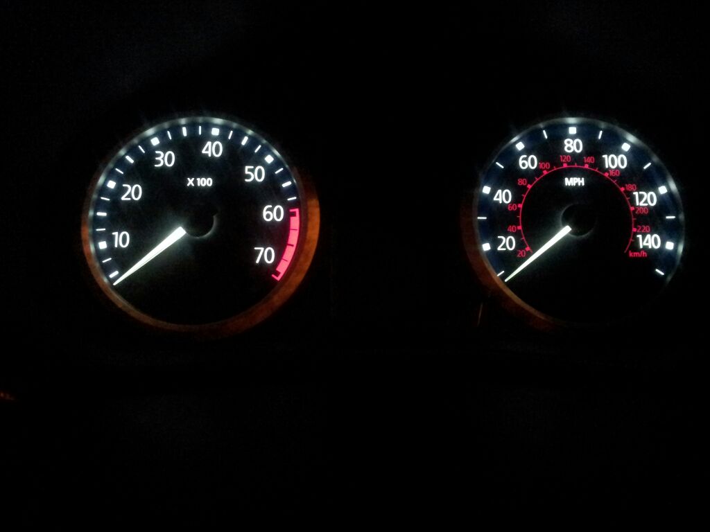

Probably yep! they look ok when installed fully but I would choose swapping the individual SMD leds one by one to a colour of your choice if you really want to change the colour over the plasma dials.
I have a spare set of dials on 75K i could change the colour of the SMD's for you.
I have done this on mine I changed them to white including the LCD
Let me know if your interested, as then you'll keep the OEM look of the dials but with a different colour.
By changing all the SMD's on the board each one is 3mm x 5mm i think but they are small 8 of them are needed to change them.
PLCC-4 for the LCD ( x 4 )
PLCC-2 for the needles ( x 4 ) as 2 SMD's per needle
Plus you'll need patience and a fine tip soldering iron.
