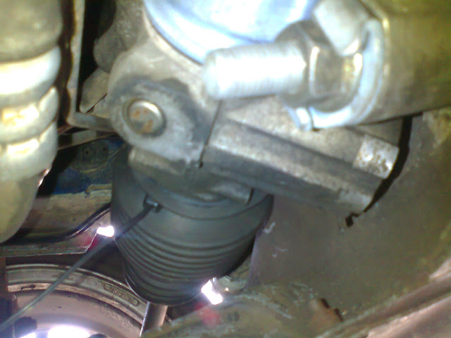

is this the item i'm looking for? doesn't look accessible without removing the rack. due to lack of sight i can't see how to remove the stake unless it's the big plastic ring around the hex hole.

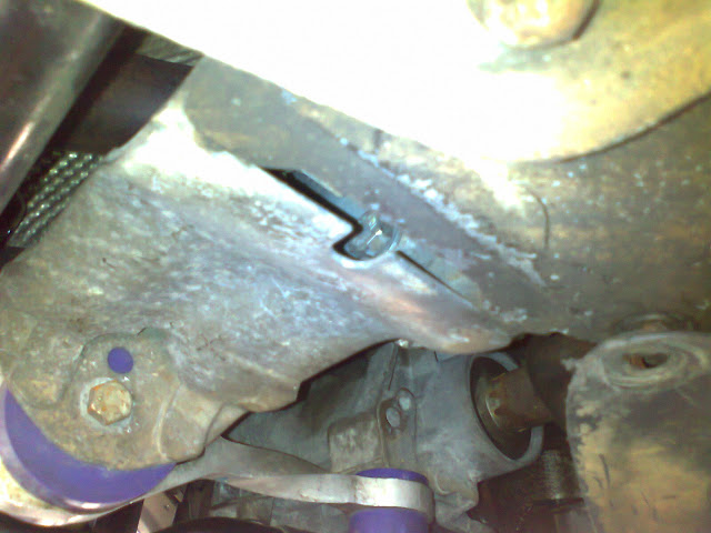

here you can see the gap in the subframe

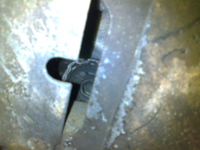

this is it from the other side
well, i had some success. i dropped the rack off it's mounts and tightened it 180 degrees. steering was alot tighter which was great, and it got rid of the play i could feel in the system, but it was so tight the car wouldn't straighten itself up! with the wheel at a 45 degree angle it would stay on that course if i took my hands off the wheel! rather than drop the rack again i widened the hole a little so i could get a hex in there with the rack in situ. i backed it off 90 degrees and it was a little better. it wouldn't straighten itself up from say a 15 degree angle, but it was easier to steer and the play wasn't apparent. so i backed it off another 45 degrees and this time it almost straightened itself up. i still couldn't feel the play which was good, but it felt horrible to drive, didn't inspire confidence at all, felt like it had a mind of it's own.

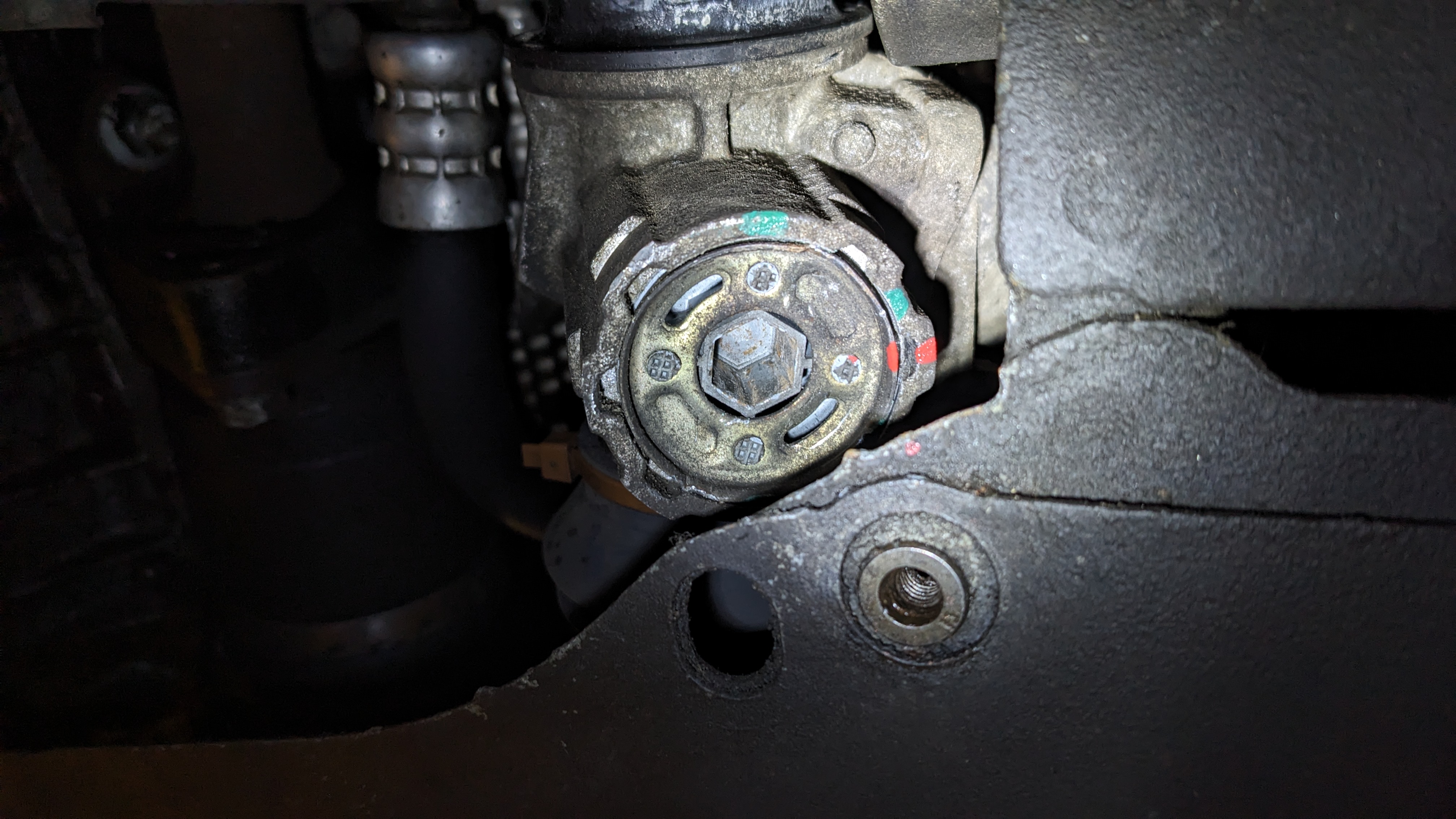

Thread resurrection.... But does anyone have any tips for accessing the adjuster without completely removing the rack?
So I did the far more annoying, long-winded thing and took the rack off it's mounts, disconnected the lower UJ and moved and rotated the rack forward to get to the adjuster.
I lucked into an adjustment that seemed to work.
I was able to tighten the adjuster clockwise by about 120 degrees. I then backed it off by 60 degrees.
Much better steering - no clicking whilst dry steering. Less noise (feel). The car also seemed to be less affected by ruts and broken surfaces, holding a steered line much better.
I paint marked the final position in red. I didn't stake the nut again but I can observe any torque relaxation from underneath with the undertray off.
