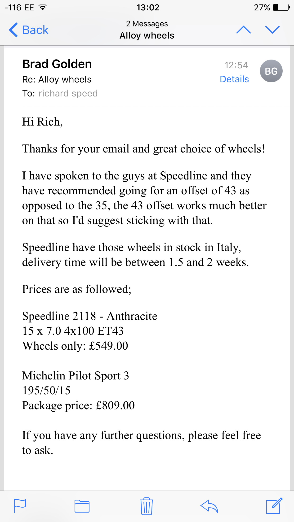

Well I've been emailing revolution my local place to order some speedline 2118 for the Clio and after doing a little research you's lot say go for ET35 but this guy is advising me to go for ET 43 what should I do?? Wheels are 4x100 15inch 7j

ET 35 will mean you don't need to fit those 10mm spacers, after finding et 43 sit too far in even if its what they came with.
Changing offset can change handling characteristics to a greater or lesser degree, AIUI, and it might put slightly more strain on suspension components (unless running something like a zero offset for stance, innit, which will probably kill both the car and you lol) but a 43 to a 35 should be fine.

Thank you everyone so much for the help. Well after a long discussion with somebody from speedline I find that there only sell anthracite 2118's in ET43 and white in ET38

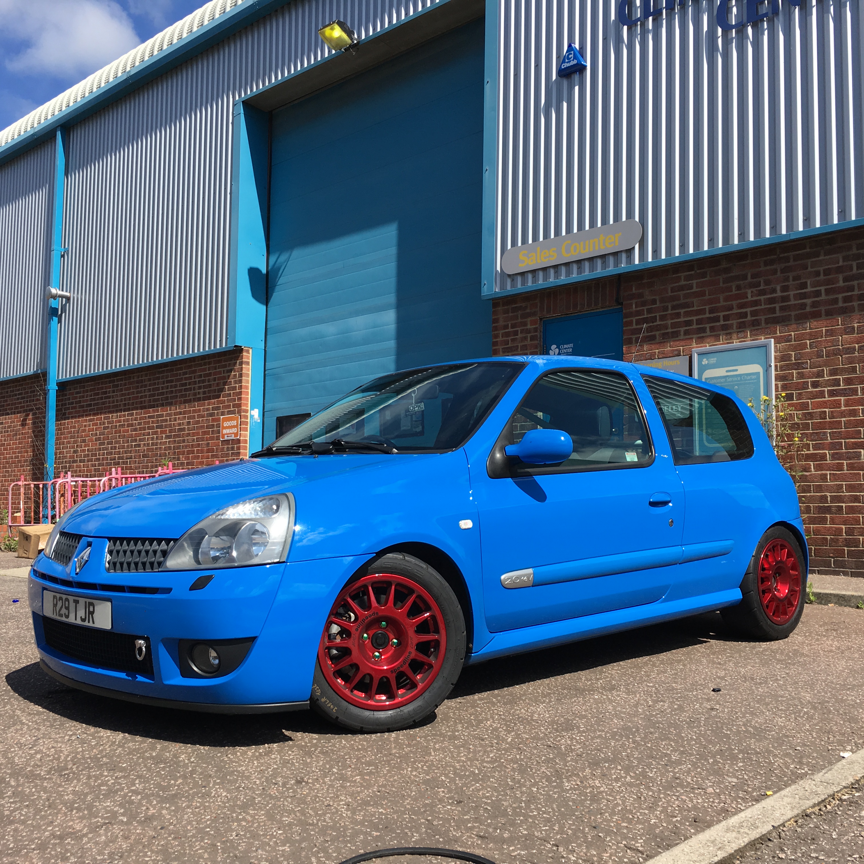

I'm running 2118's in ET38.
I had to run spacers on the front as the tyres where so close to my GAZ coilovers, I would have preferred not to have run spacers:
Pic with 20mm H&R DRA spacers on front (nothing on rear).
Pic with no spacers:
