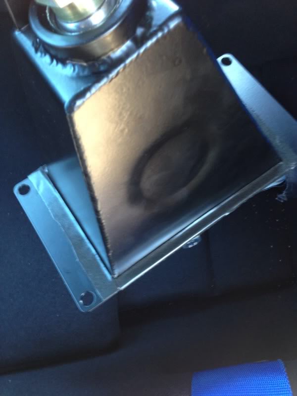

Instead of using silicone like Pure recomend I used sticky back foam as mine will be coming out from time to time.
Snipped and bent back heat shield to avoid contact.

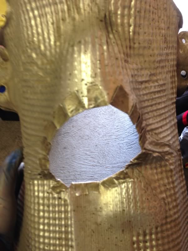

There's no mention of it on Pure's fitting instructions but you actually have to cut standard selector boot to be left with this.

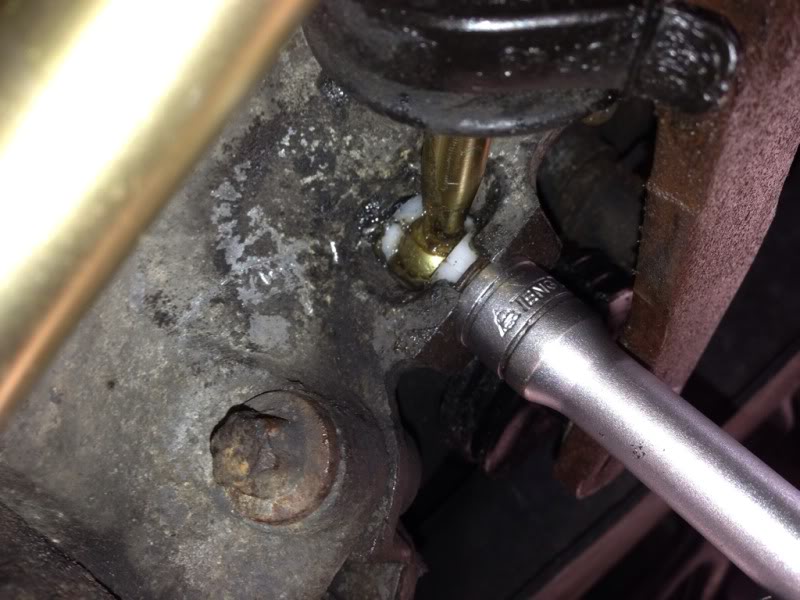

Some had complained of circlip falling out, the end of a 3/8's extension is perfect for seating the circlip (no need for bottle jacks Phil lol)

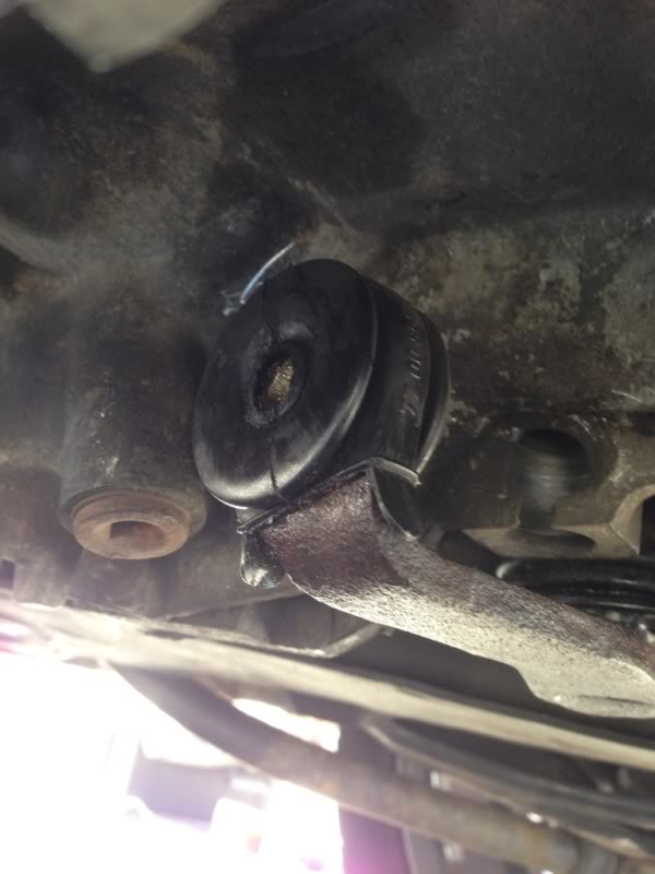

Fitted it all last night, didn't take long at all, seems a really nicely made bit of kit. I spent more time buggering about with the pivot bush then fitting the rest as it wouldn't slot in far enough to allow room for the circlip. In the end I found the old bush and when put side by side the new one was perhaps 0.5 mm longer, so popped the old one back in and all's well. Setting it up is a right pain, still not sure its as good as it will get, just a couple of mm movement either way, or a couple of degrees on the linkage connector and it either doesn't go in a gear or it bangs on the tunnel in reverse or 5th. My selector boot didn't need modifying and the stick appears to self-center already.
I have to say after looking at it again the other day I think the not-self-centering thing is down to how tight that pivot bush is on mine
And agreed it's a little tiny bit longer than the one that came out
I think I might pull it back out this weekend and put the old one back in as it will loosen the movement a little bit and allow it to self-center.

I've just spoken to Nick at PMS and the bushes apparently have a small rubber end to them which is meant to be squashed in. I couldn't squash mine in enough last night laying under the car so as mentioned popped the old one in. As for knocking, mine has lots of room to spare in reserve, its just in 5th that it knocks, Nick suggested putting it all in neutral and then turning the linkage bar a couple of degrees. I don’t think knocking in reverse is too much of a worry so I'd be happy with that rather than 5th....

That rubber end was what I ended up having to use a scissor jack to put pressure on to compress it - it's tight as a nuns chuff
