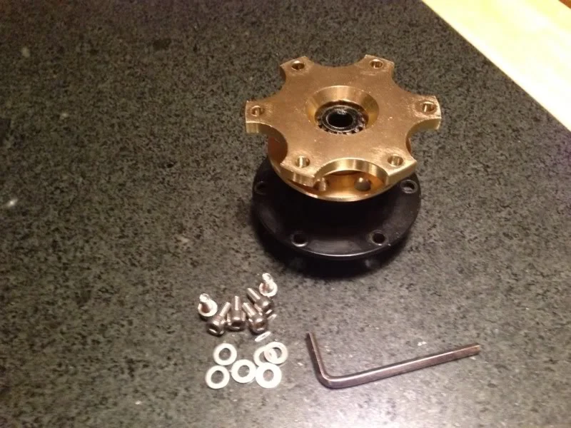

Thats great tar pal i need a removable boss like yours what one is it
  Cup In bits
Its a lifeline one, it has developed some slight play (which is common i'v heard) the same as my old cheap copy one did and that's why I bought an expensive one so I would recommend the cheapo one for that reason.
This is the cheapo one, they come up on eBay sometimes for circa £60 instead of the £190 for the lifeline.
