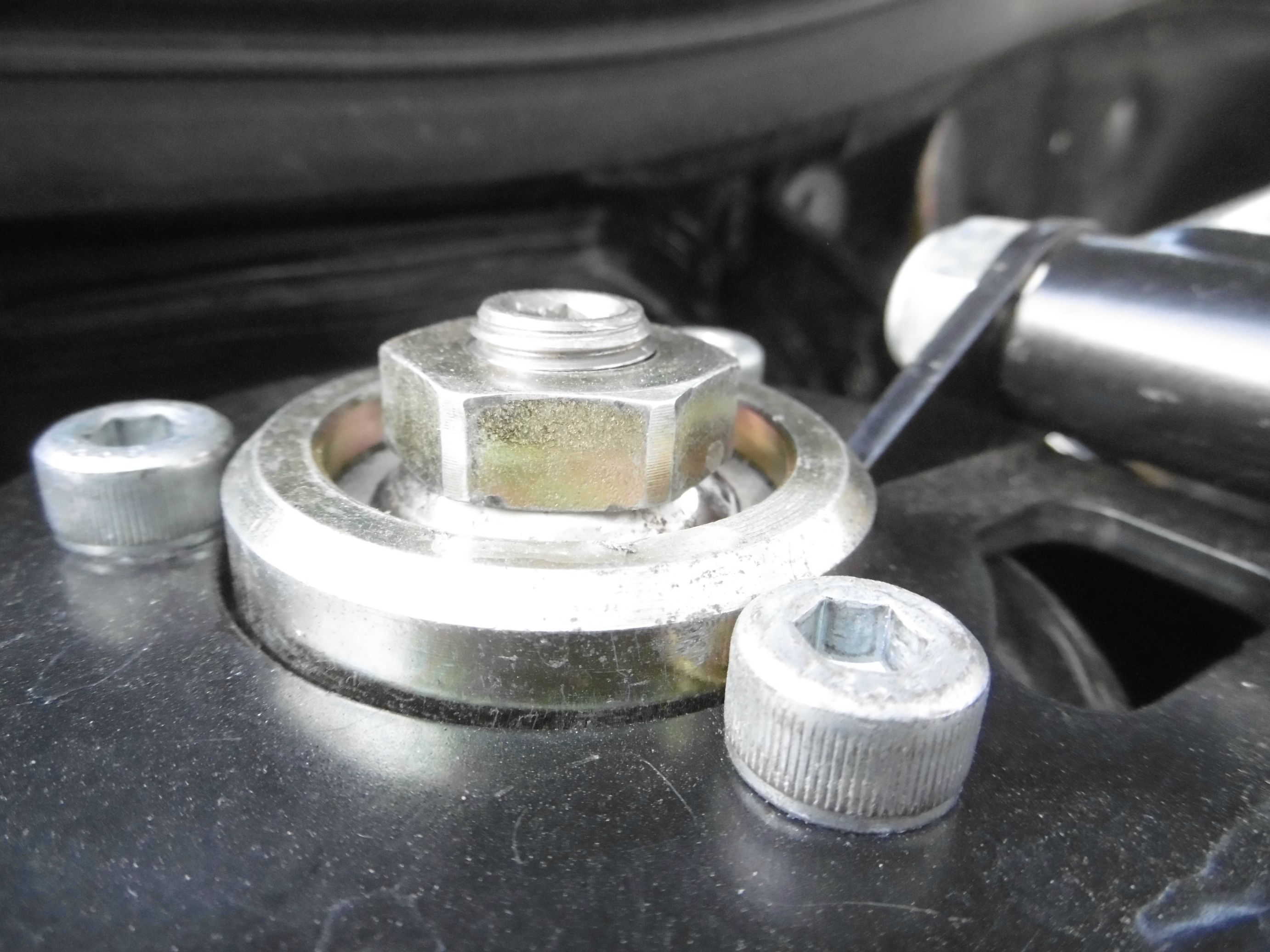

Jacked the car up and tried with the wheel on first and then with the wheel off. I didnt have any movement at all, I grabbed the disc with both hands and moved it up and down while my neighbour watched the top mount. Tried to do a video but the camera didnt focus. Did get a few pics though.
Im using the washer on the top of the bilsteins too - I got it off @debussetti and I think he got the link off you so should be the same. No loctite or extra nut for me, I live dangerously lol.

Thank you for checking that for me Gus :smile:
That's really interesting! I wonder if the bearings have had it 😧 I'd say there is around 0.5mm of play.
I grease them fairly regularly and you can see the liquid bubble out/seep out when I move it up and down. I'll have to see if I can mount my camera to something more sturdy when I do it next time!
I tried tightening them up with an allen key and spanner but they didn't tighten up at all but that was with the wheels in the air perhaps I was fighting against the weight of the car. I should probably try when rthe car is on the ground??
