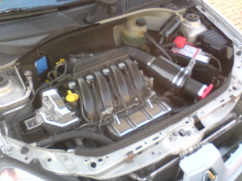

Polished K4J Engine :D
Car  RB 182 Cup
Taken a crap photo just before work! Will take better ones later but you get the idea lol, Fuel rail guard and engine mount are like mirror :D
What do you think?

i bought a polishing set expecting it to be a waste of time but turned out well good. It comes with 2 mops, 1 thats like string and the others cloth and you also get 2 bars of compound that you put on the mops. I used a wire brush on a drill to start with to get rid of all the crap, 1200 wet and dry followed by 1500 wet n dry then just changed over to the mops and compounds that it says to use in order :D well impressed!
