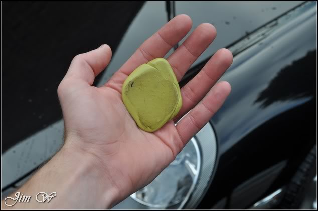

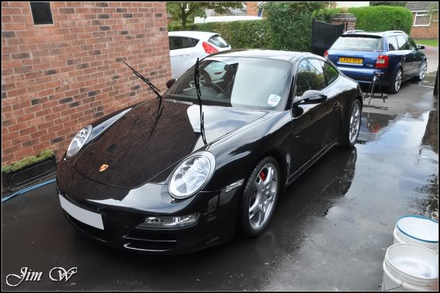

Wash process: Wheels, Arches, Tyres, Sills, Badges & Crevices, Rinse, Snowfoam, Rinse, Snowfoam, Two-Bucket Wash and clay bar…
This was about the worst contamination I could find!

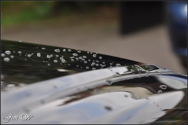

Also noting through the wash stages how well the bodywork was protected..

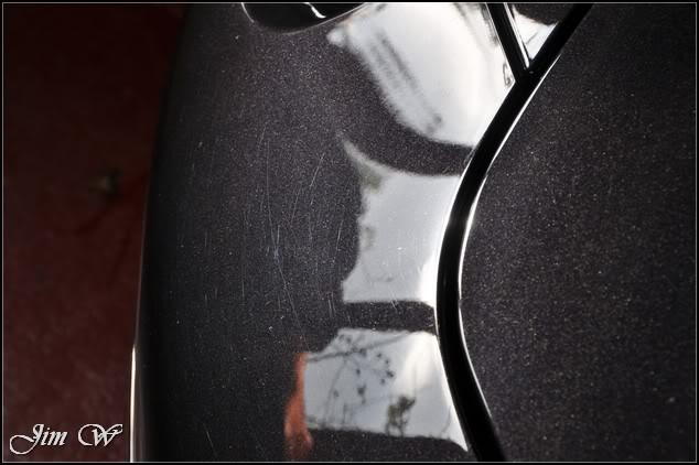

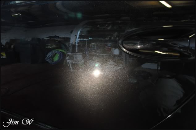

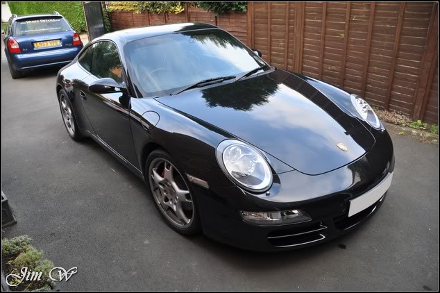

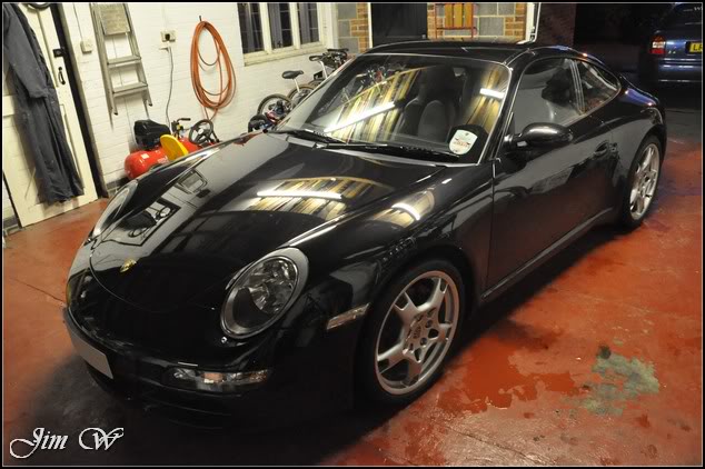

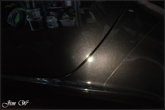

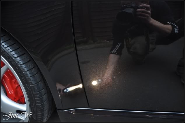

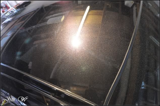

Once dried down and inside , the sun made appearance (typical) and a rough idea of the overall defects were spotted on the O/S front corner:

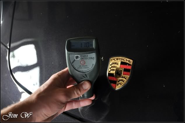

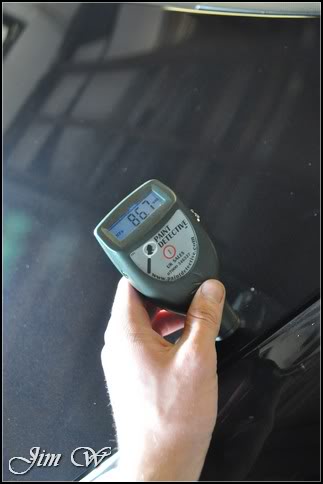

Although only 4 years old, throughout, there were some pretty low paint thickness readings. Averaging ~90/95um. Lowest reading spotted was 76um.
Highest number spotted 121um on the bonnet:
With these low readings in mind, I was pleased I was only there to perform a single pass with a mild polishing approach as otherwise we’d be pushing our limits somewhat with the already thin paint!

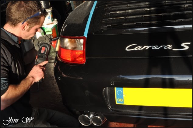

Pads and polish used for the correctional work: 3M yellow polishing pads (both the 150mm and the smaller spot pad), a white Hexlogic polishing spot pad, Menzerna 203s for some tough areas and Menzerna 106FA for the majority.
Starting with some of the smaller spot pad work at the back and I’m not getting on too well.. Switch pads, try another polish combo… “Nope, something strange going on”. Polish isn’t breaking down well, a few new vibrations/jumps on the rotary and generally not having much luck. Come the time to switch pads again though I noticed:

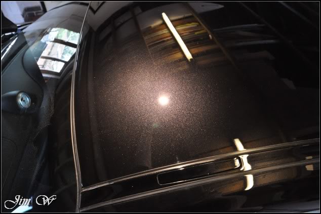

Stepping up to the 3M 150mm polishing pad for some of the larger areas like the roof.

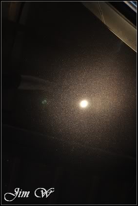

Before:
After:

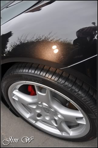

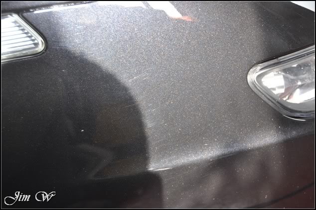

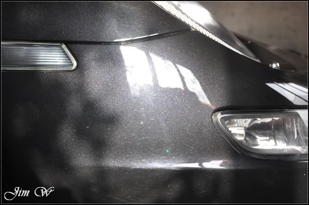

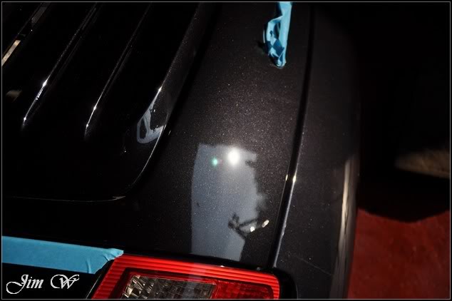

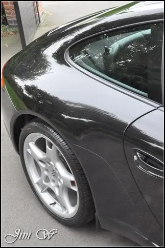

And a few more ‘befores’ spotted on the N/S panels that when in the sun, were showing swirling and ‘movement’ within the paint.

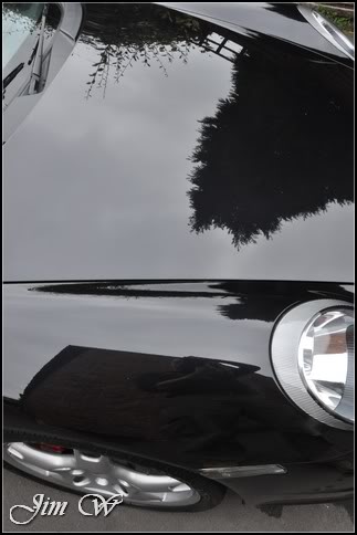

Leading edge of the bonnet complete and haze free:

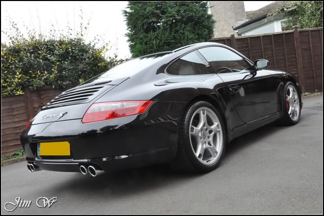

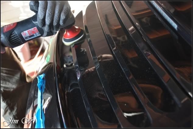

Tricky area this, switching down to the small 3M polishing pad, I carefully machined the vents on the engine cover to the rear: (it didn’t help that my ‘oh-so beloved’ Gloss-It backing plate had broke either!)
Before and After: (much better)

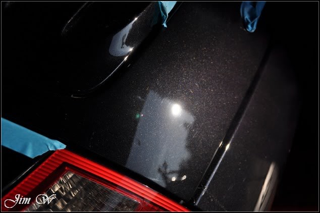

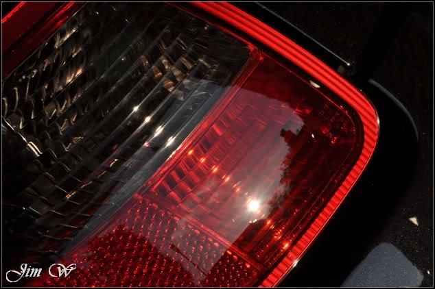

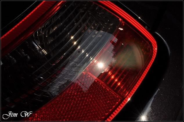

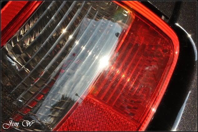

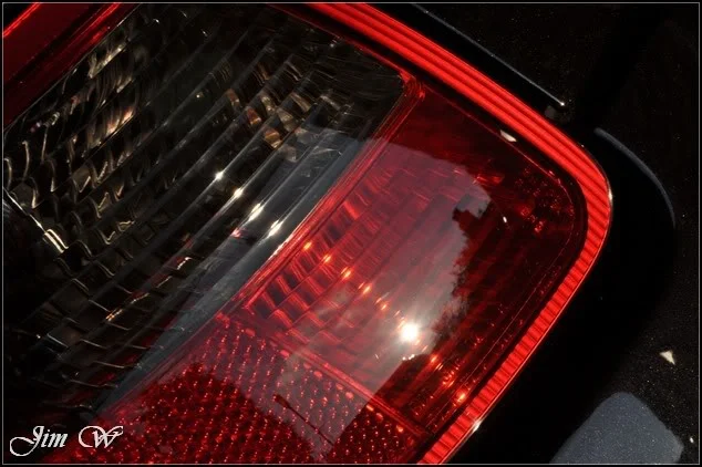

And moving on to the rear clusters with 3M yellow spot pad and Menzerna Power Finish 203s:
Before:
After:

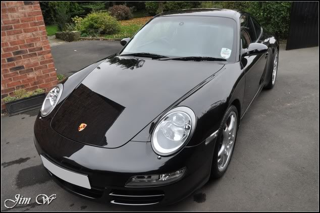

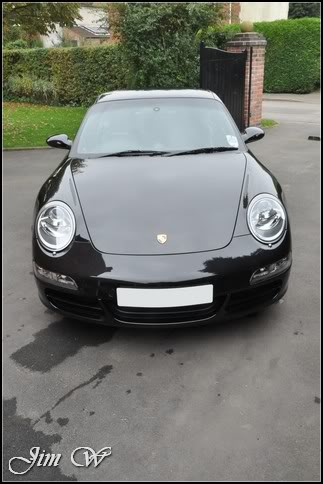

Front nose before/after:

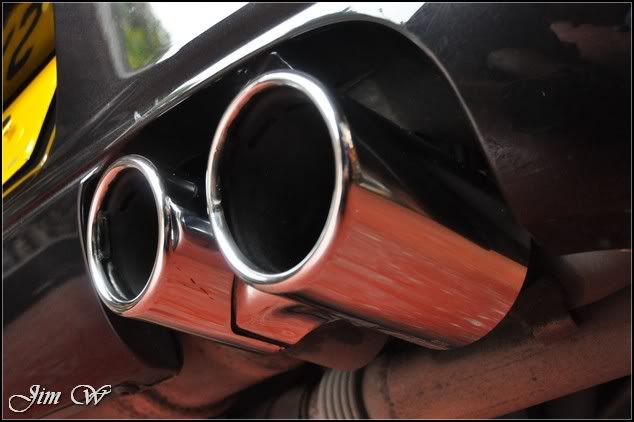

Exhausts cleaned up with Autosol:
Before/After:
Before/After:

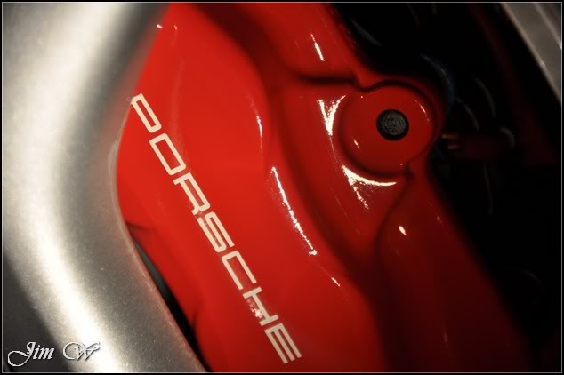

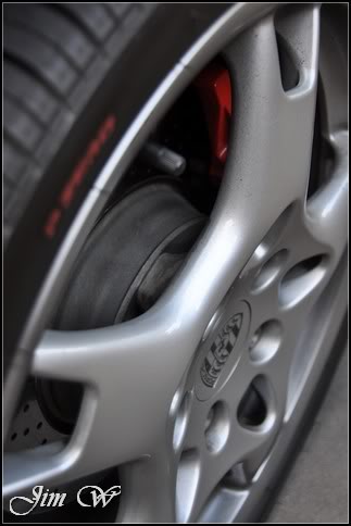

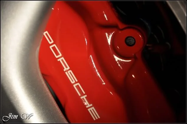

Along with the alloy wheels, the calipers were protected with JetSEAL109.

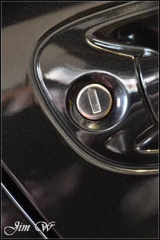

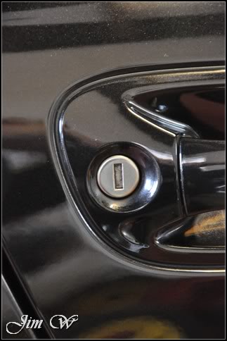

Some toothpickery work:

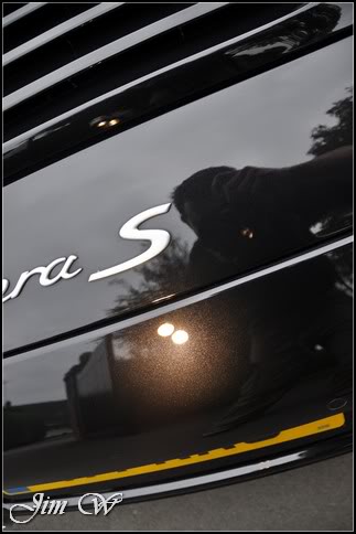

BlackFire’s All Paint Protection system was laid down and in the meantime, I did the glass with 3M’s Glass Cleaner. Sealant residues removed, one or two final touches and we’re there.

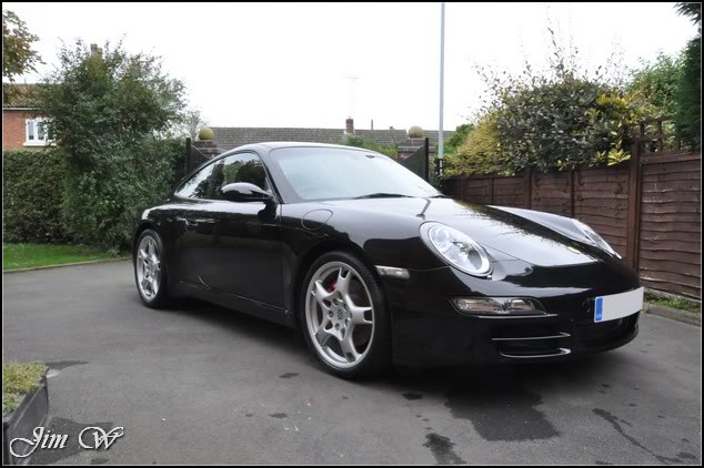

And with the Brinkman torch:

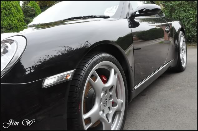

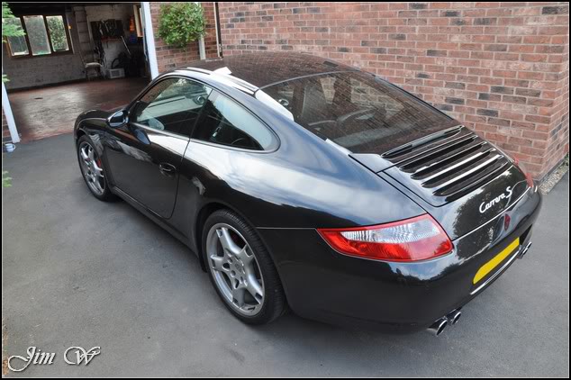

The true finish will be revealed once the car first rolls into direct sunlight.
