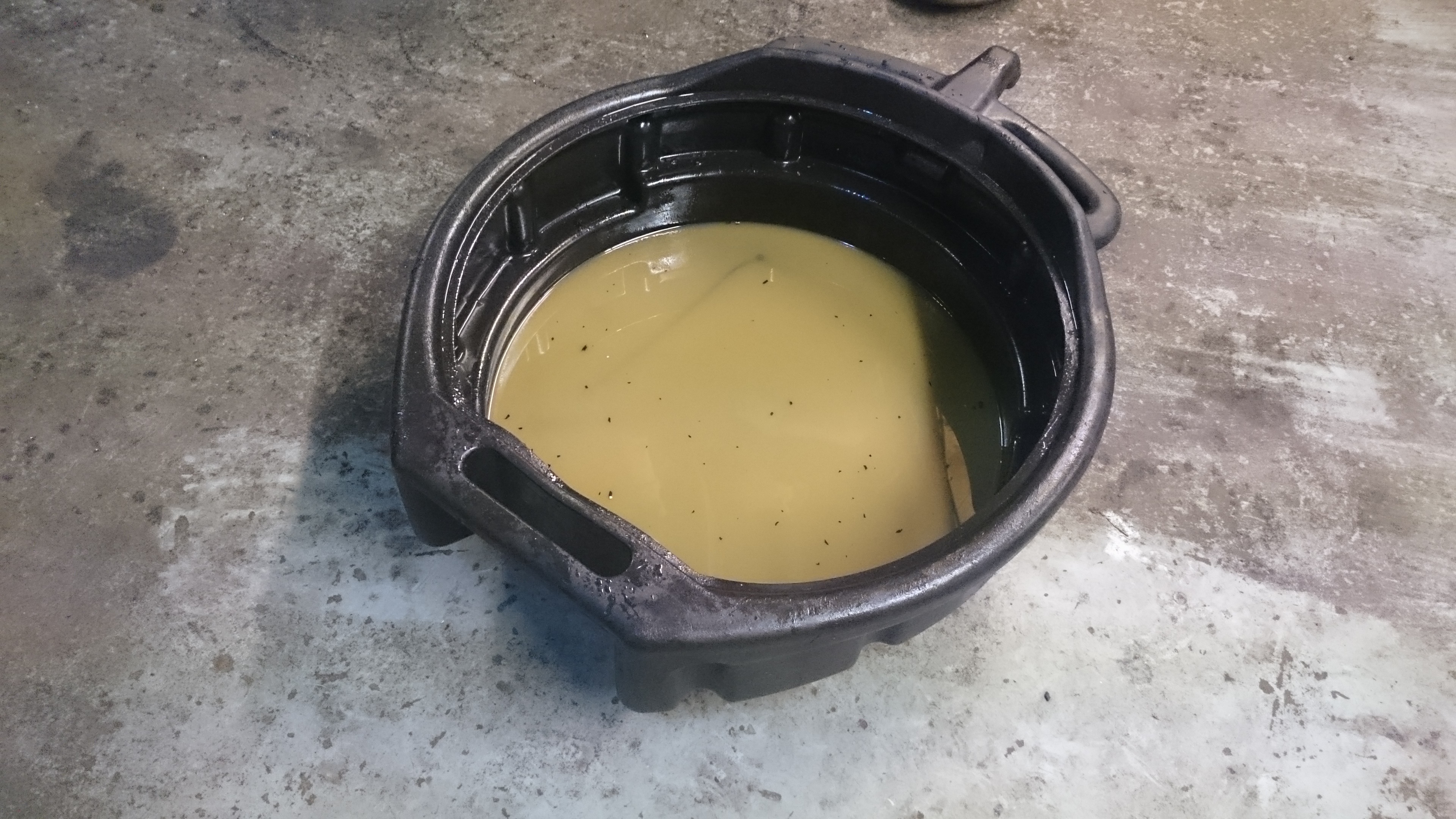

  • Removing the thermostat showed brown liquid pouring out, something that makes me cringe. Also the rear caliper needed replacing so that had been ordered.

I would love to keep it, but the coolant 'issue' is the tricky one - if there is oil going into the coolant then that is the premise to larger problems - here is the coolant that came out:

Erm, coolant that colour is a goosed head gaskets. That's oil and water mixed.

😢 im taking it a pressure test will reveal this definitively?
I want to be 110% sure about taking it back as I will be losing money.
Aye, sorry about that. Take it back, Keith Lemon of a motor.
