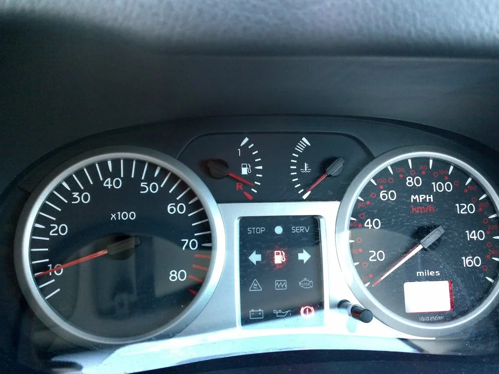

got a 05 182, i run the petrol down to just above red on the needle and the trip was saying 70 miles left.
went and filled up, got £29.56 in (32.5L) before the pump started clicking telling me the tank was full.
did a 220 miles trip and the trip comp was saying 120 miles left when i got home. woke up this morning started my car and the petrol light was on saying i was empty and the needle was in the place as shown on the below photo.
is this normal??
ive been told i should be able to get way more than £30 in my tank before it is full. i went and filled up again today and got £29 worth of fuel in again 32.5L
anyone else had this?

32.5 litres put in,40 litre tanks? 7.5 litres left in tank for your 70miles on red/reserve?
dunno just trying to calculate,
my clio(only a 1.6)gives me 45 miles to the red.and would be about 35ish to fill when over the red/reserve.

I don't think you have an issue there.
Mine when just filled says I've got about 400 miles worth in if I reset the trip computer and drive sensibly.
The thing to bear in mind is that the fuel guages aren't entirely accurate. For example, when mine's in the middle it still says I have about 250 miles left (assuming I haven't been thrashing it and reducing the MPG calculation).
If I leave it until the warning light comes on before I fill up, then put a tenners worth in (hard times and all that), it moves the needle up to about the same position yours is at in the picture above. It usually states I've got between 80 and 110 miles left at that point.
If I rag the knackers off my car during my day to day driving I get roughly 230 - 260 miles from a tank. I've got a Ph2 172.

your petrol light shouldnt be on with the needle at that position...
either the dial is knackered..
or the petrol sensor light thing is jiggered..

Hold down the stalk button to make the dials dance, then one of the menus is to view the petrol left in the tank in litres isn't it?

For info :
I tried what Gumby suggested " Hold down the stalk button to make the dials dance, then one of the menus is to view the petrol left in the tank in litres isn't it?"
Since the dials danced its worked fine, on a full tank (about 40 litres) getting between 250 - 280 before the light comes on again.

i got this issue. im gonna put a new battery in mine as it only does it when its icy..
i would guess yours need a new battery as its not got the full amount of juice to hold the records while the engine is cranking.....
