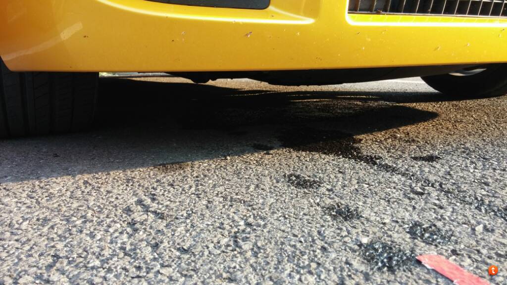

Power steering failed on way home. Just a few miles from home luckily.
Could smell oil and thought was someone else as you usually do, until I was only car on road and realised it must be me! :eek:
Steering started to feel odd, then just as I turned sharp bend into my street the steering went very heavy.
Its now parked at local garage about 5 doors down from my house, which is handy!
Probably a hose gone. Possibly pump. Will let you know the outcome.
Just thought I'd share my joyful experience with you all :eek:

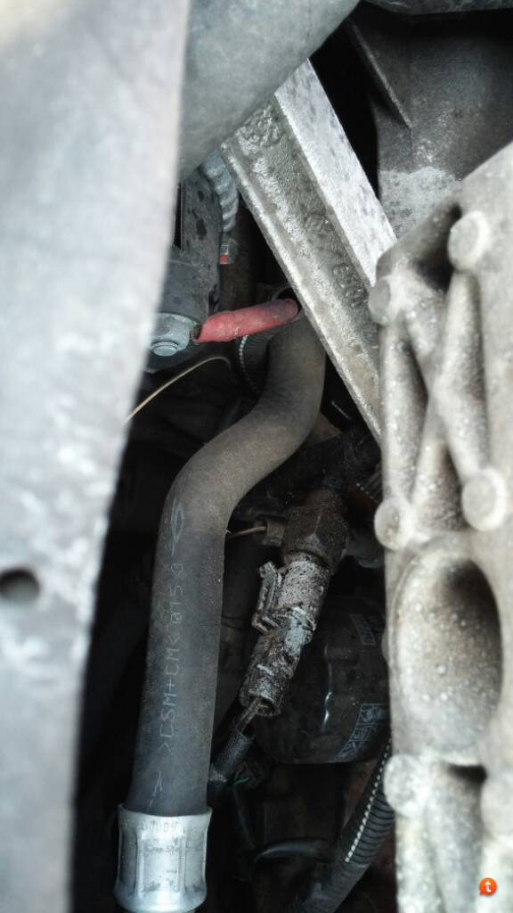

Check if there is oil over the tensioner/alternator pulleys and belt, if not check the high pressure(metal hose) and the low pressure(rubber hose) aren't leaking at the connection. There must be a break somewhere along these hoses and where I've mentioned if its all over your engine bay.
Good luck!

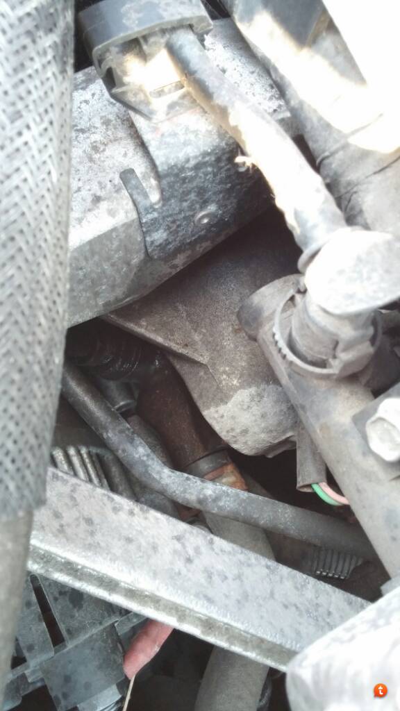

Thanks for info. Oils on side of engine where the pumps situated. Belt looks to be free of oil.
Garage have had a look today and said leaks coming from pump itself. May be the shaft seal same as your mates.
Going to fit new pump and belt. Gonna end up costing about 230. Plus it's due a service. Lol.
