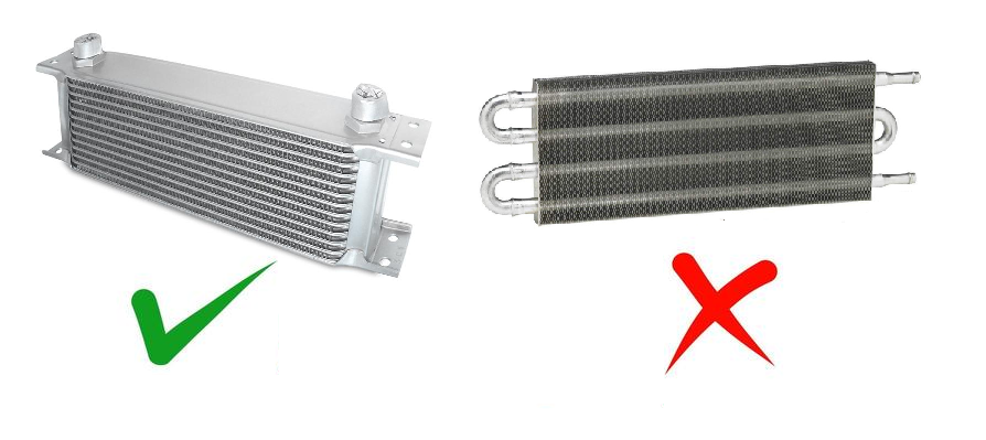

You need a cooler with as little flow restriction as possible, so not the mishimito style ones.
Okay, and bleeding is just lock to lock lots of times isn't it?
Cooler wise, is this correct? Christ I feel stupid!

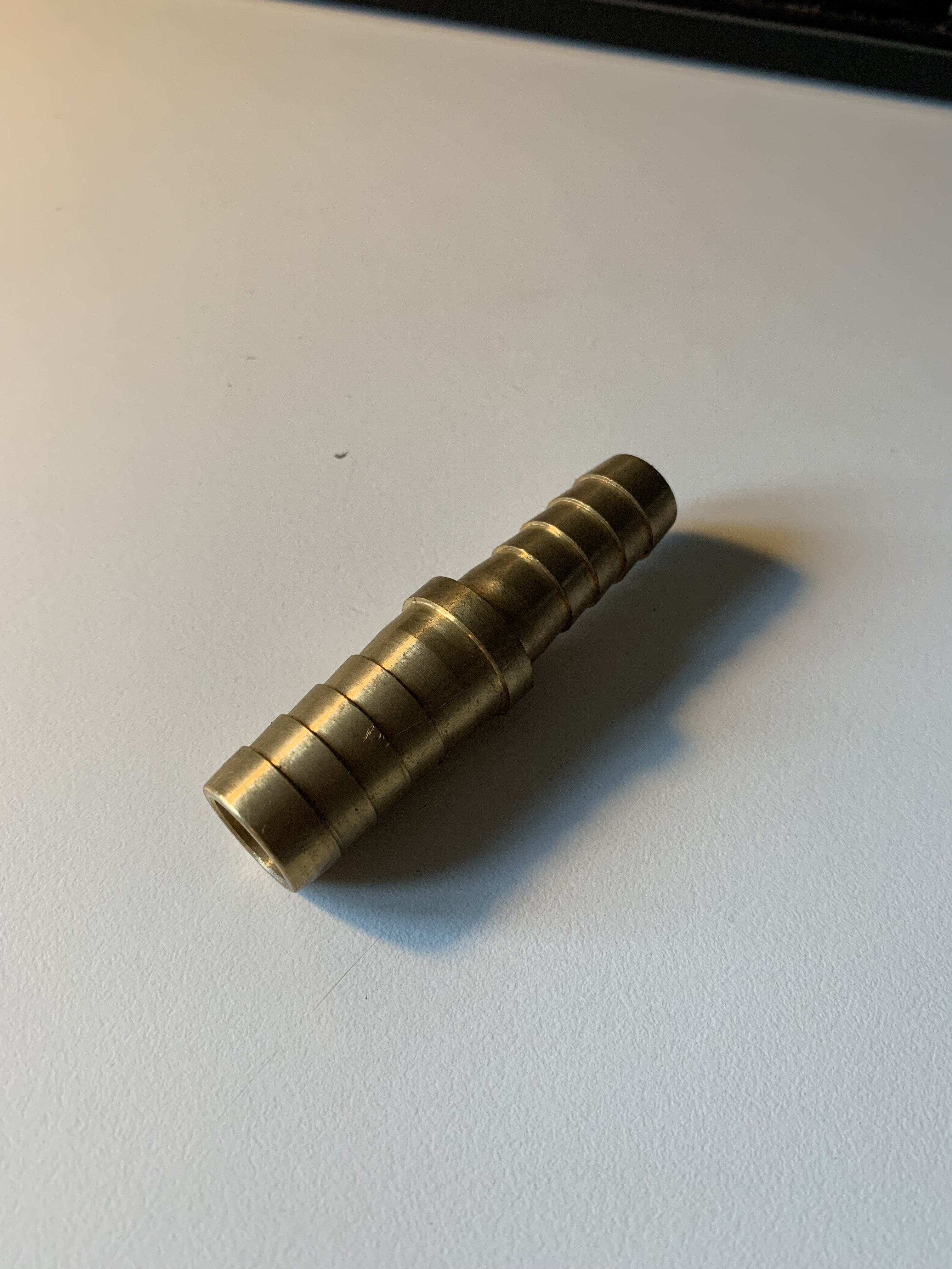

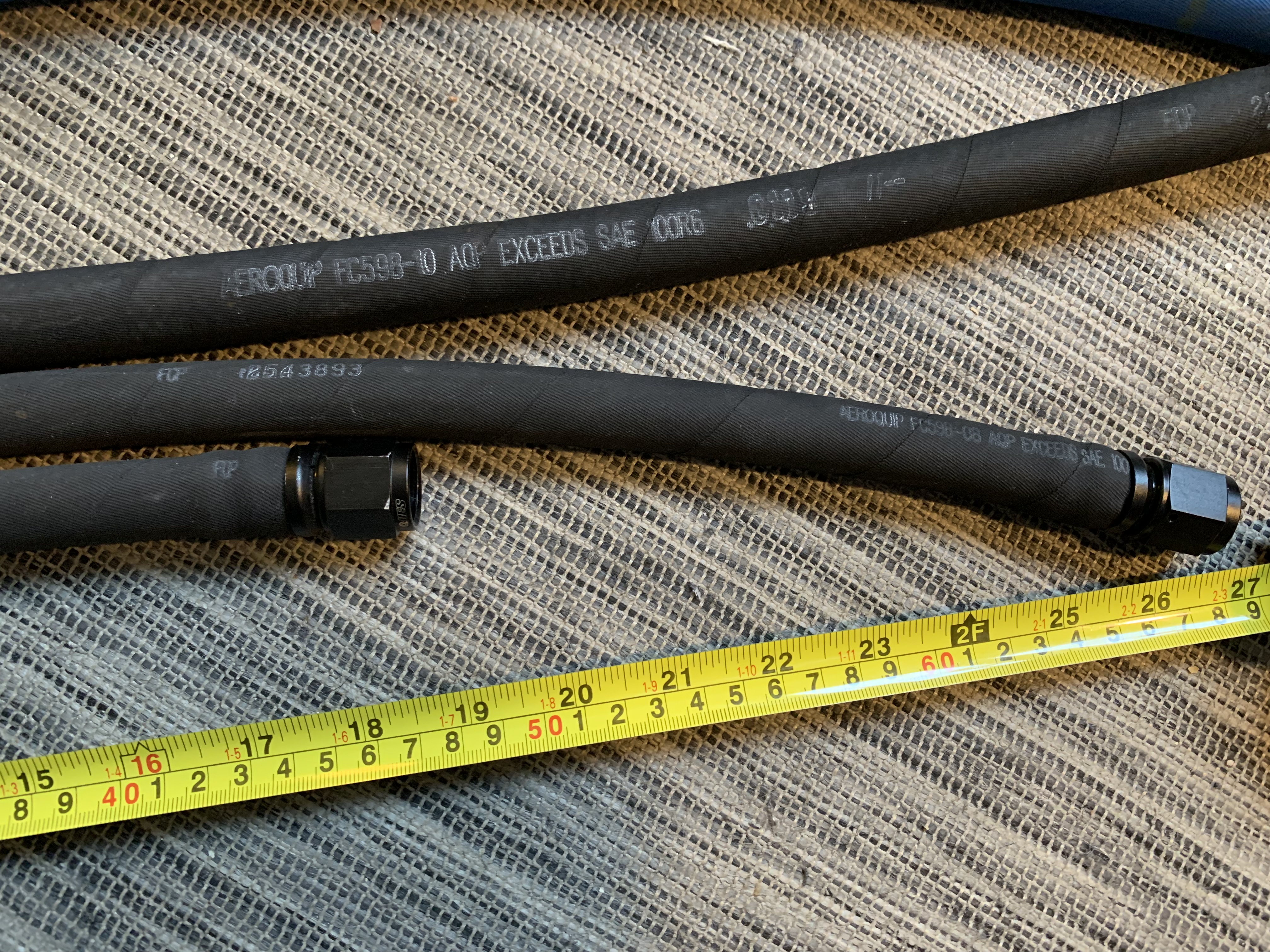

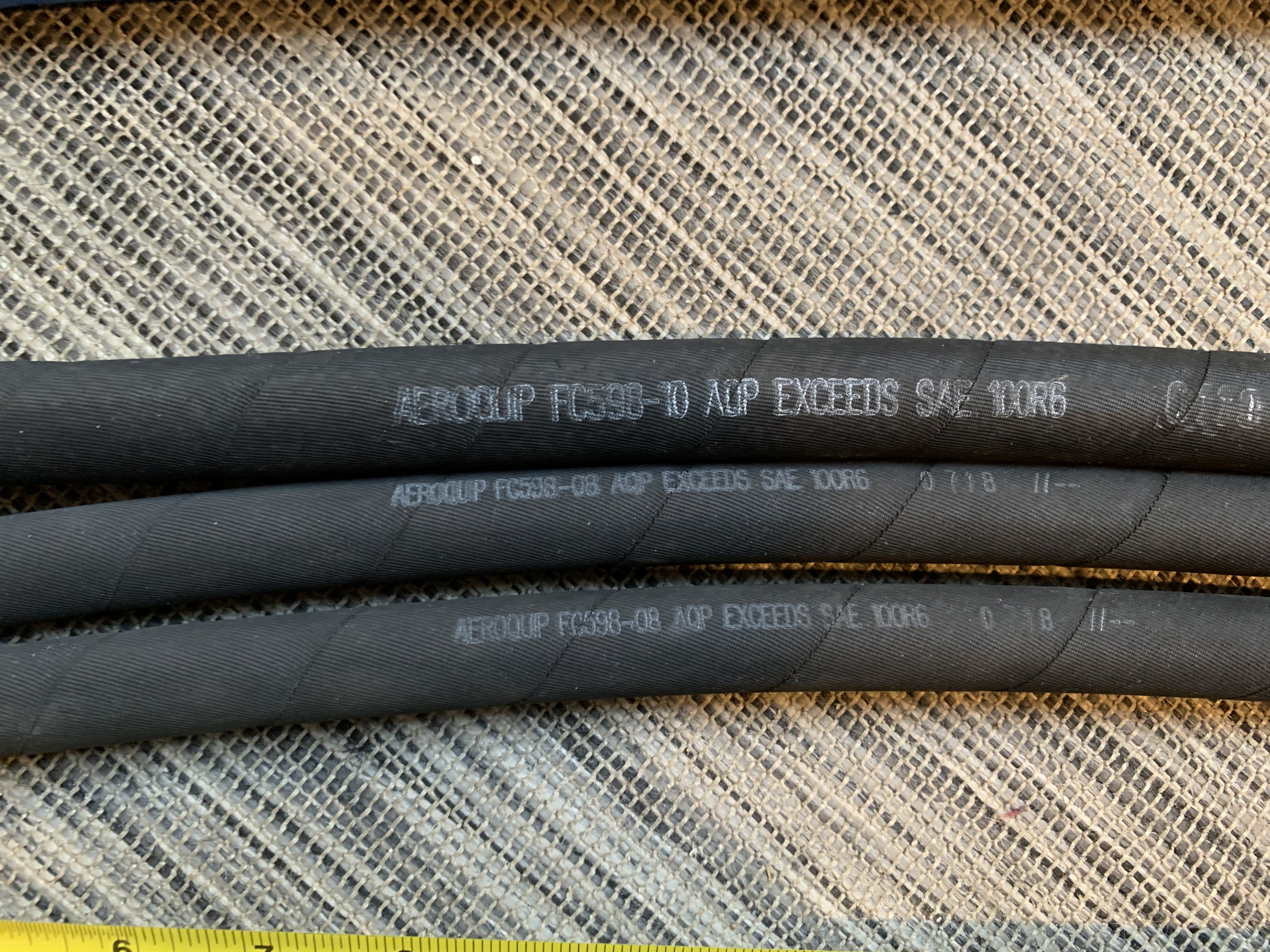

So the barb is 17.2mm ish which fits the -10 hose, which cant be used throughout the system due to the vacuum rating..
So I used a barb like this to go from -10 to -8, I also had to use a -12 to -8 barb for the reservoir.

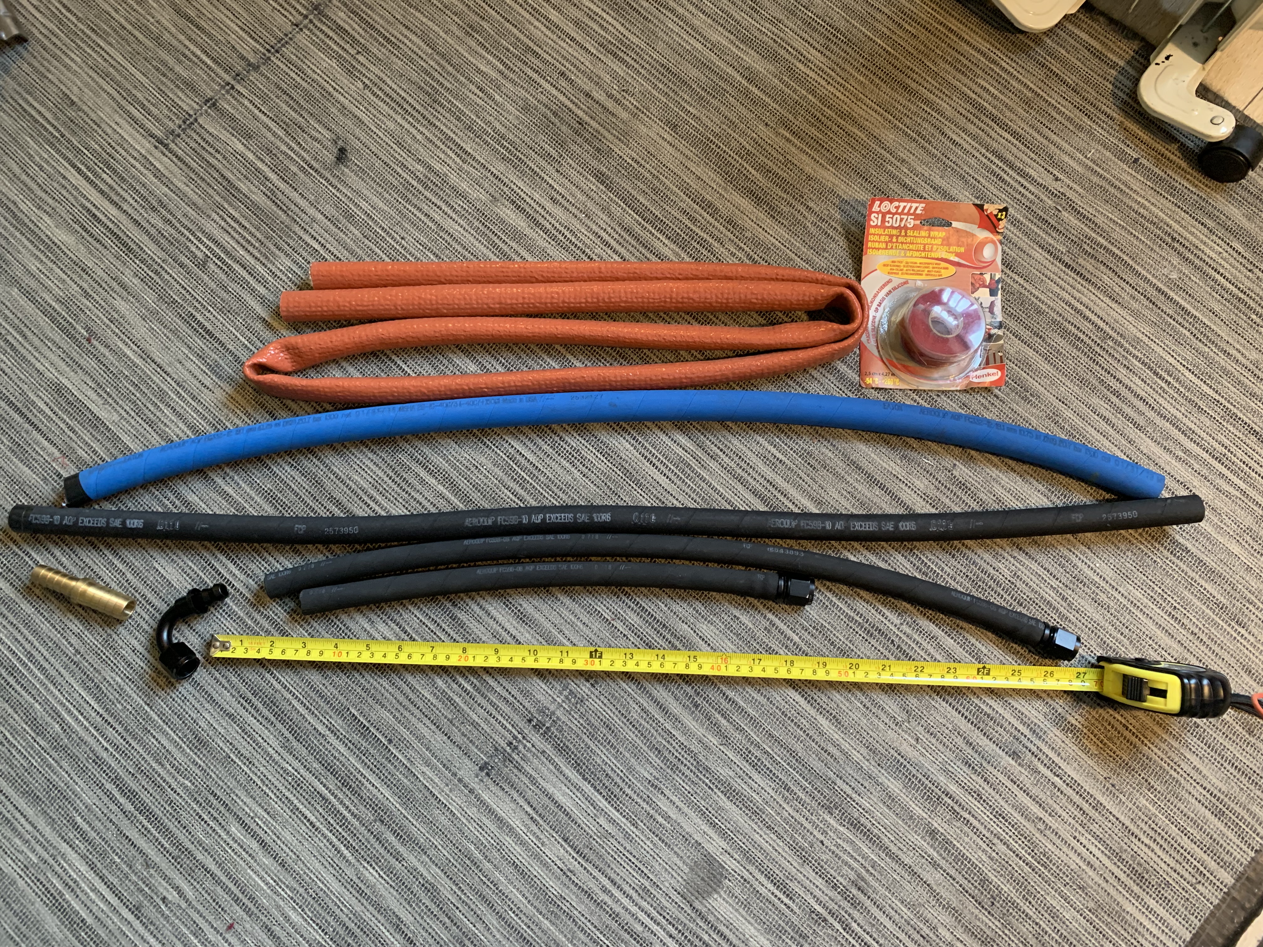

I have 80" of aerospace fire sleeve for the -8 which is more than enough because you honestly dont need much but its also good as a protection for chafing. Also I was going to include some silicone tape to wrap the end of the of the sleeve and fitting, keeps dirt and crap out and gives it a finished look. Although just realised its way more red than orange and wouldnt look so good. 🫤
Example...
Both off cuts of -8 hose have a couple an-8 fittings pressed into them and I have a spare 120deg fitting, the barb is no use as it was -12 to -10... ( was just for example)
Let me know if anything will be of use for you (y)

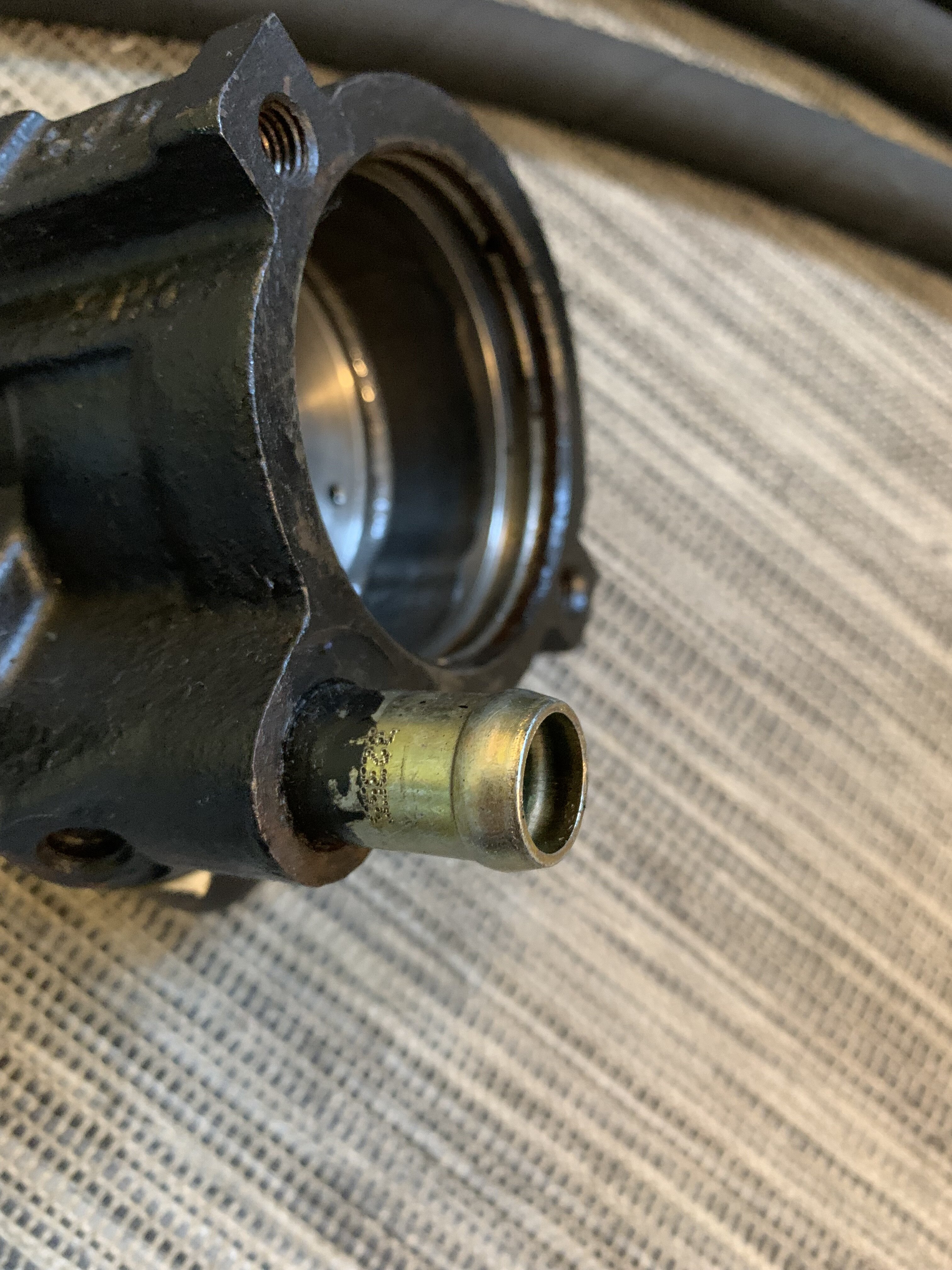

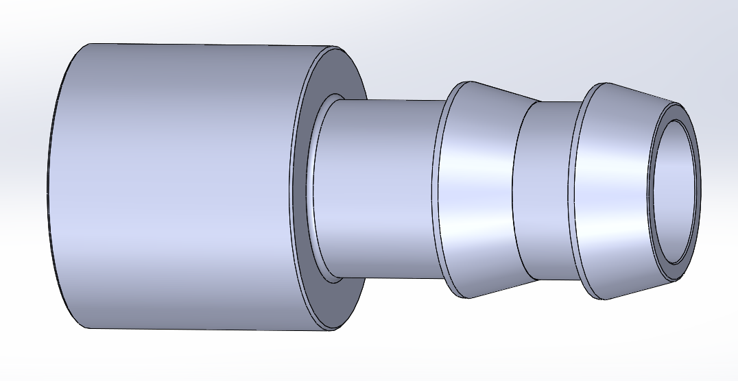

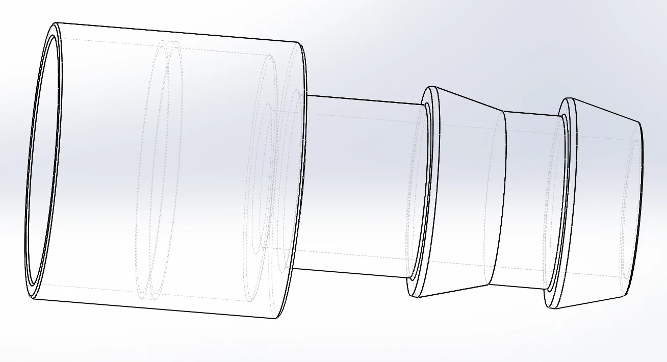

If you shave down the barb on the pump, you can press fit a custom piece on.. :unsure:
@Touring_Rob Do you reckon a press fit and an o ring would seal the fluid?
Yes, but the original barb was probably pressed in so would presumably tug out so a whole new bit could be rammoed in however some hose and a jubilee clip is going to be to cheapest, fastest option.
Or you might be able to take the mushroomed section off the end and fit a compression fitting if the gods are all agreement and the size is something common. Still I would probably just go with the simple option.

Is a smaller cooler better than a larger one? i.e. Any cooling is better than what's on now, and a smaller cooler would keep the pressure up? I've been looking at generic 10 and 13 row coolers, approx 300x100mm.
Flob
Any cooler is better than no cooler.

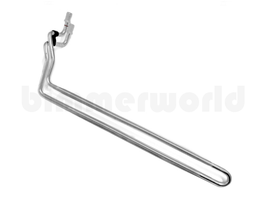

This is the sum total of an E46 M3 cooler:
I've seen multiple cars with a single finned section of pipe as the cooler too and I don't often read about an e46 M3 boiling its fluid on track, it does happen according to the net but compared the Clio where the engineers thought - meh, no room, can't be fucked its not such a big issue.
My powersteering boiled on the Clio within a few laps, granted the pump I was using was already noisy so that won't have helped one atom but its a problem.
Essentially, if you add any form of oil cooler to the system you are going to be miles ahead of the nothing that is there right now (y) I would fit the one with the biggest hose size which you can conveniently fit behind the grill.

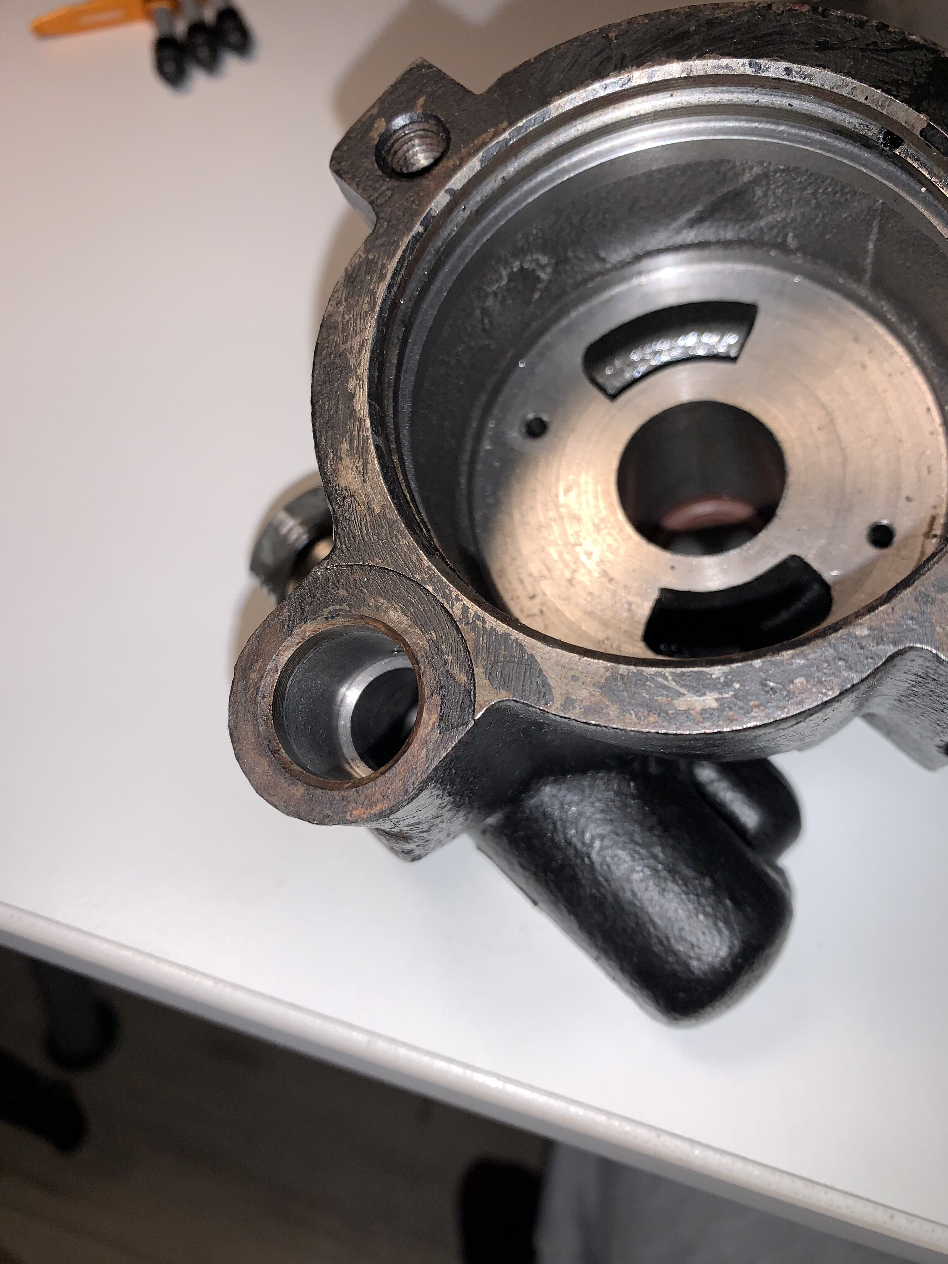

The pumps fail because either the seals get so hot they melt (this is what happened on mine, explosively!) or because the pump gets starved due to the fluid boiling which means it loses its only source of lube, after this they go noisy pretty much at all rpms.

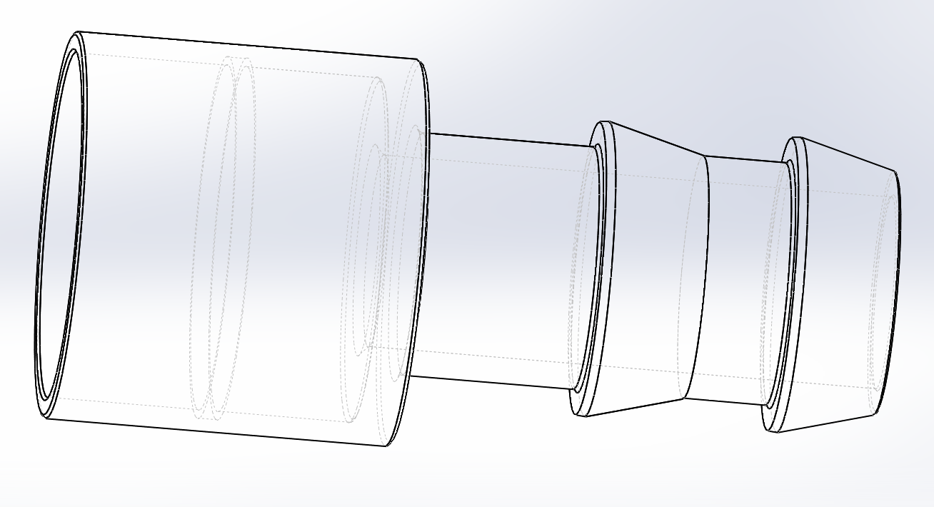

It won't be particularly interesting, but I'll see about getting one done!
In fact I might have one on here somewhere from 100 years ago...
JimF
  Clio 172
That's tempting. How much room is there nearby when the pump is still in the car? Car is at my dad's so haven't got it here to look at.
Tempted to go the simplest way though and just use a jubilee clip onto a reducer.
