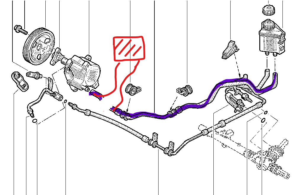

Negative - you are not making sense.

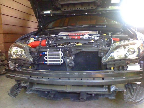

The cooler goes into the low pressure line between reservoir and pump so fluid is always going through it.
I need to fit a cooler also, I plan to fix it to the crash bar behind the grill so it gets some airflow across it, on the pump side of the engine the low pressure line looks pretty easy to modify.

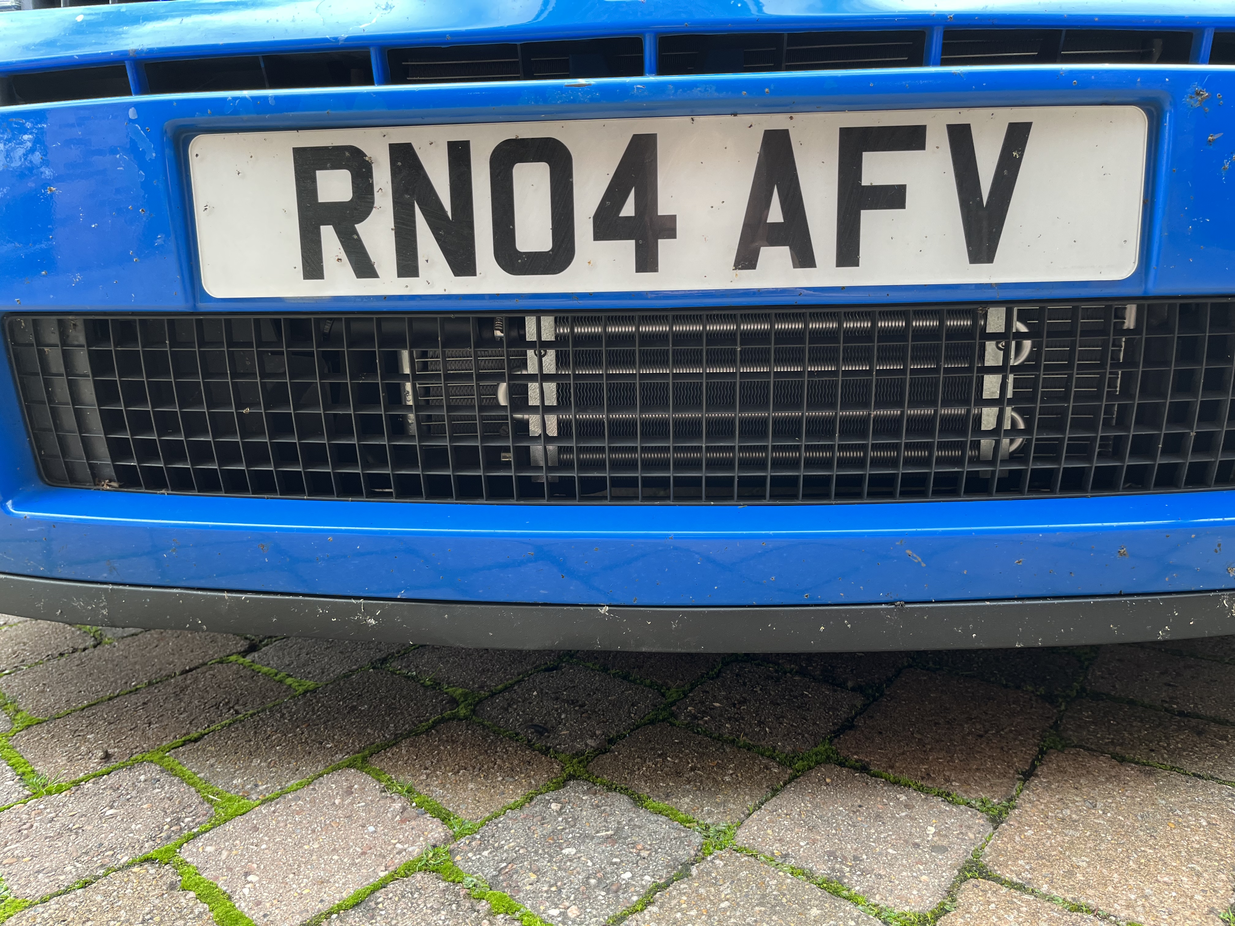

Bump on this thread I’ve fitted a power steering cooler as I too had a boil over at Cadwell.
And I too bought a re con one from the same place on EBay.
Now mine is noisy when you start the car, lock to lock bleed and drive and clears in a few minutes and no noise!
Now is it going to clear or get worse? Or should I get back to them to complain!

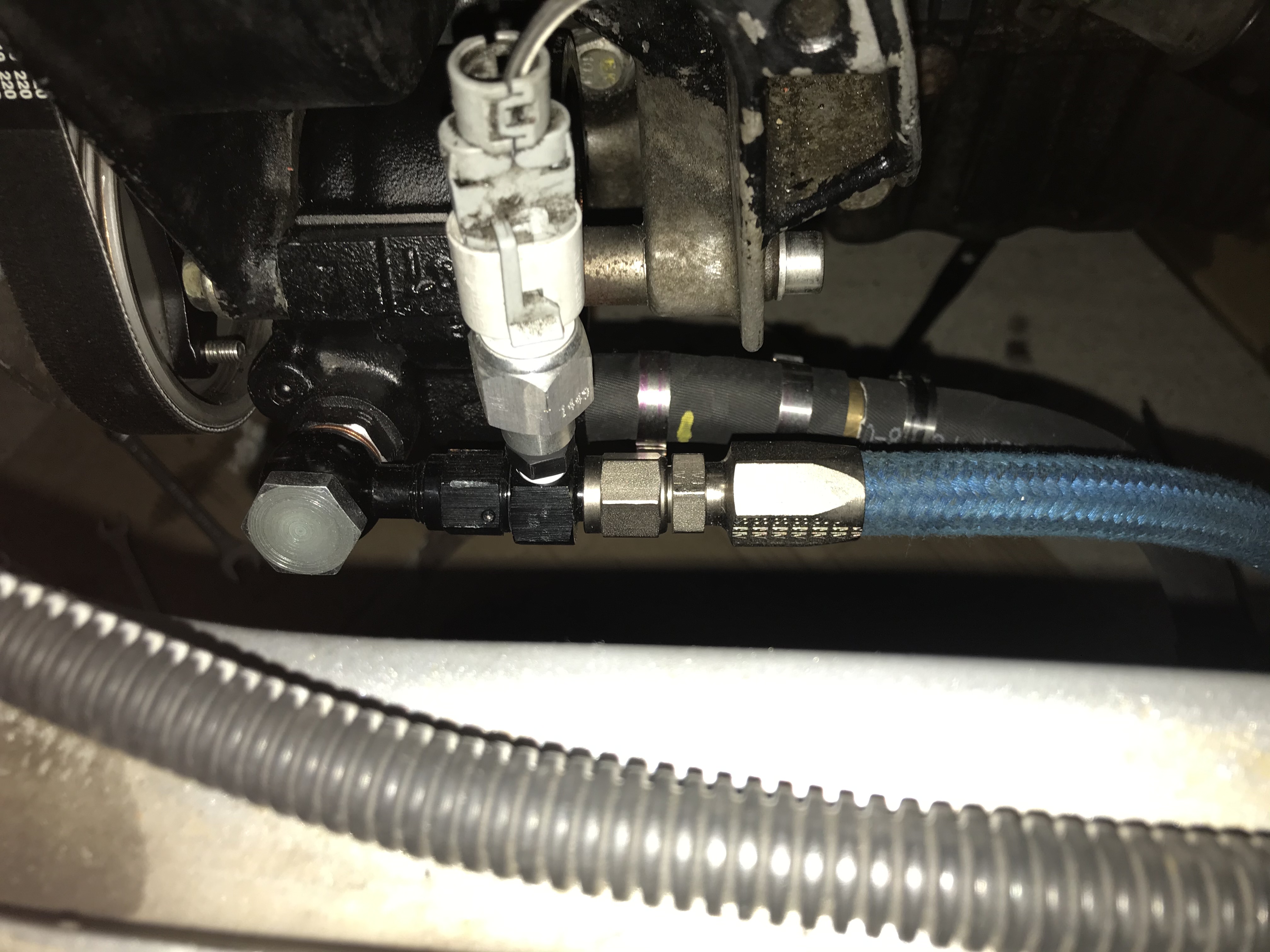

If you add the cooler line into this point it will still whine until bleed again.
I removed my cooler line from here and added it into the low pressure line from the rack before returning to the power steering header tank.
This way the feed to the pump is unchanged, you add some fluid due to the feed and return lengths, and your power steering will stay cool.

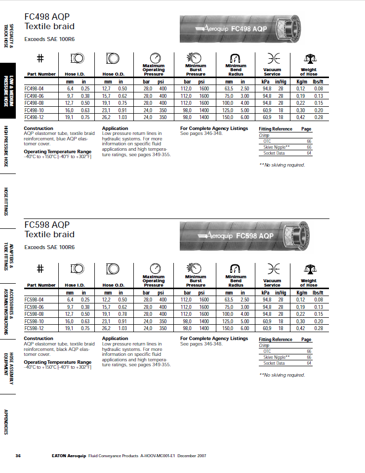

This -8 1/2" I/d hose is required, FC498-08 hose is the required spec for the vacuum rating but with large enough I/d
. Both the same hose just either blue or black (much harder to get blue fc498-08.)

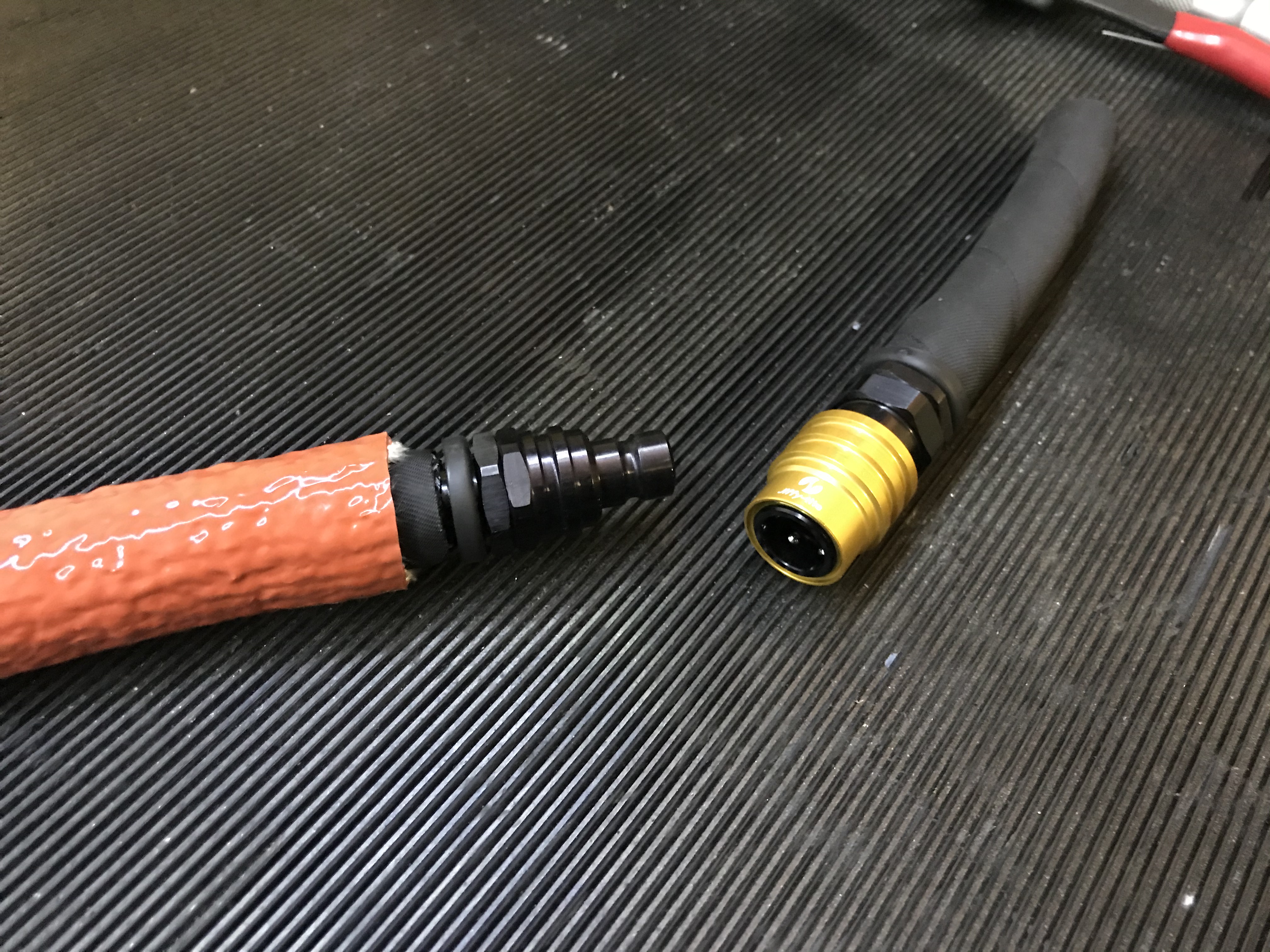

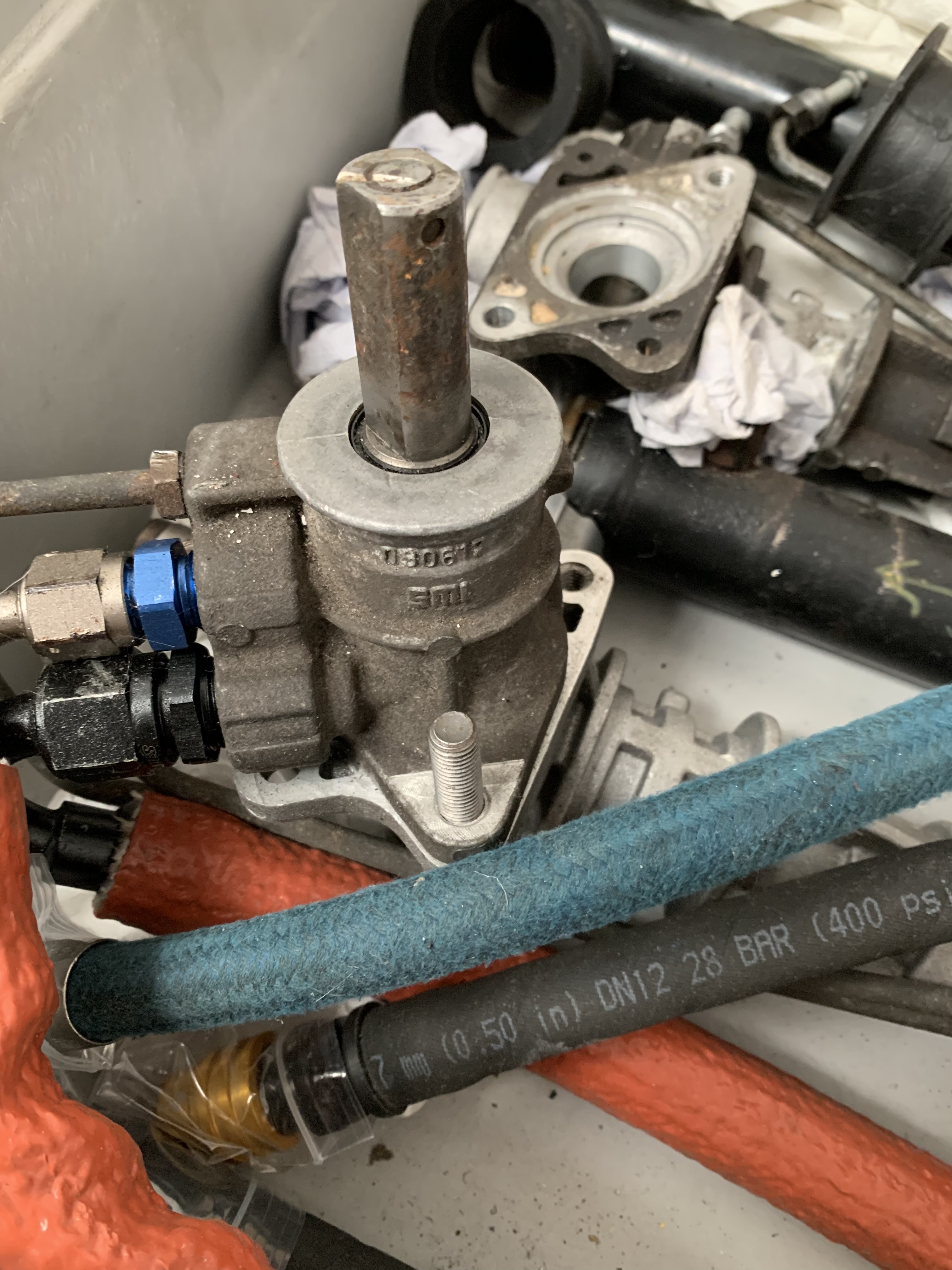

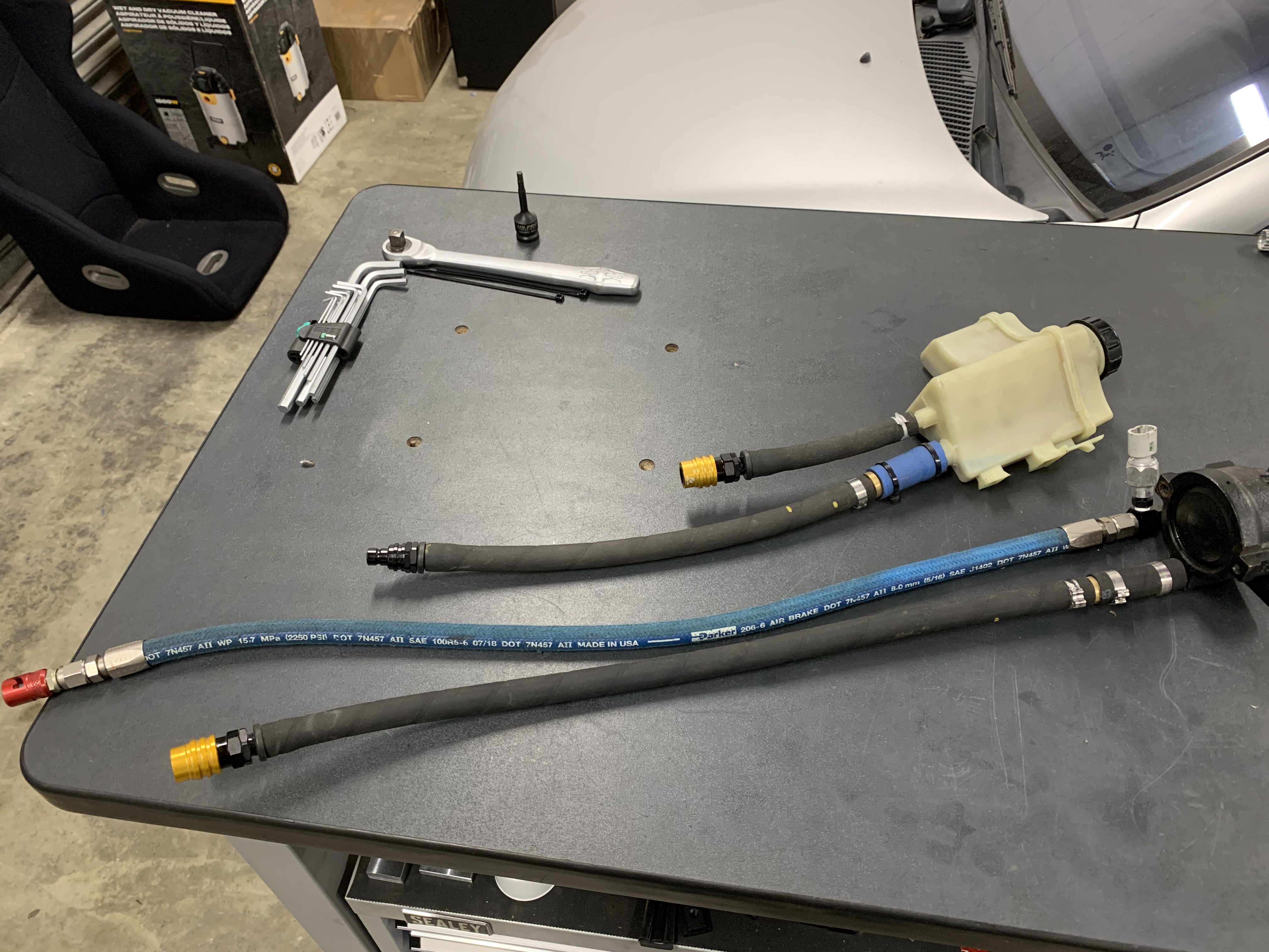

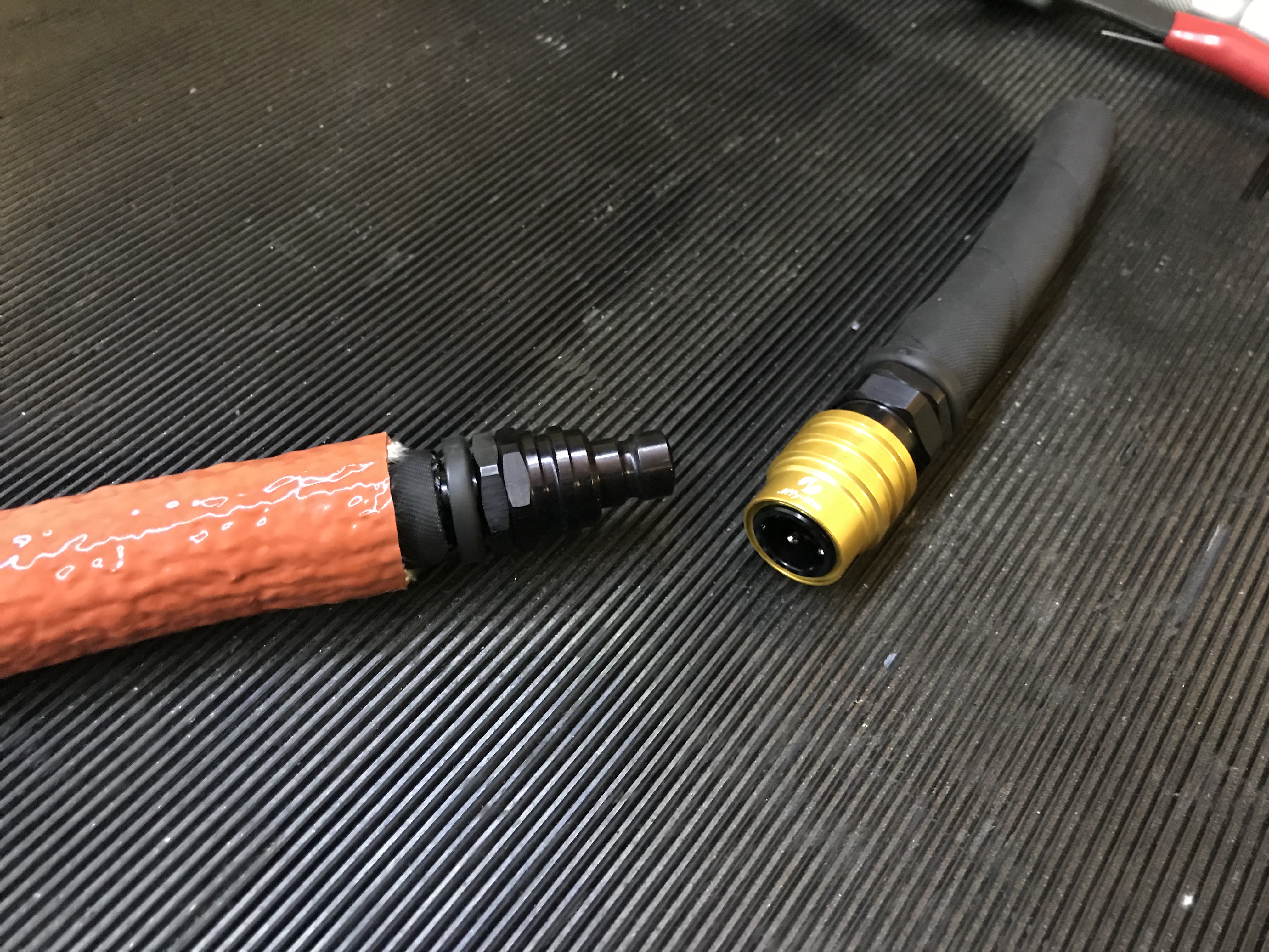

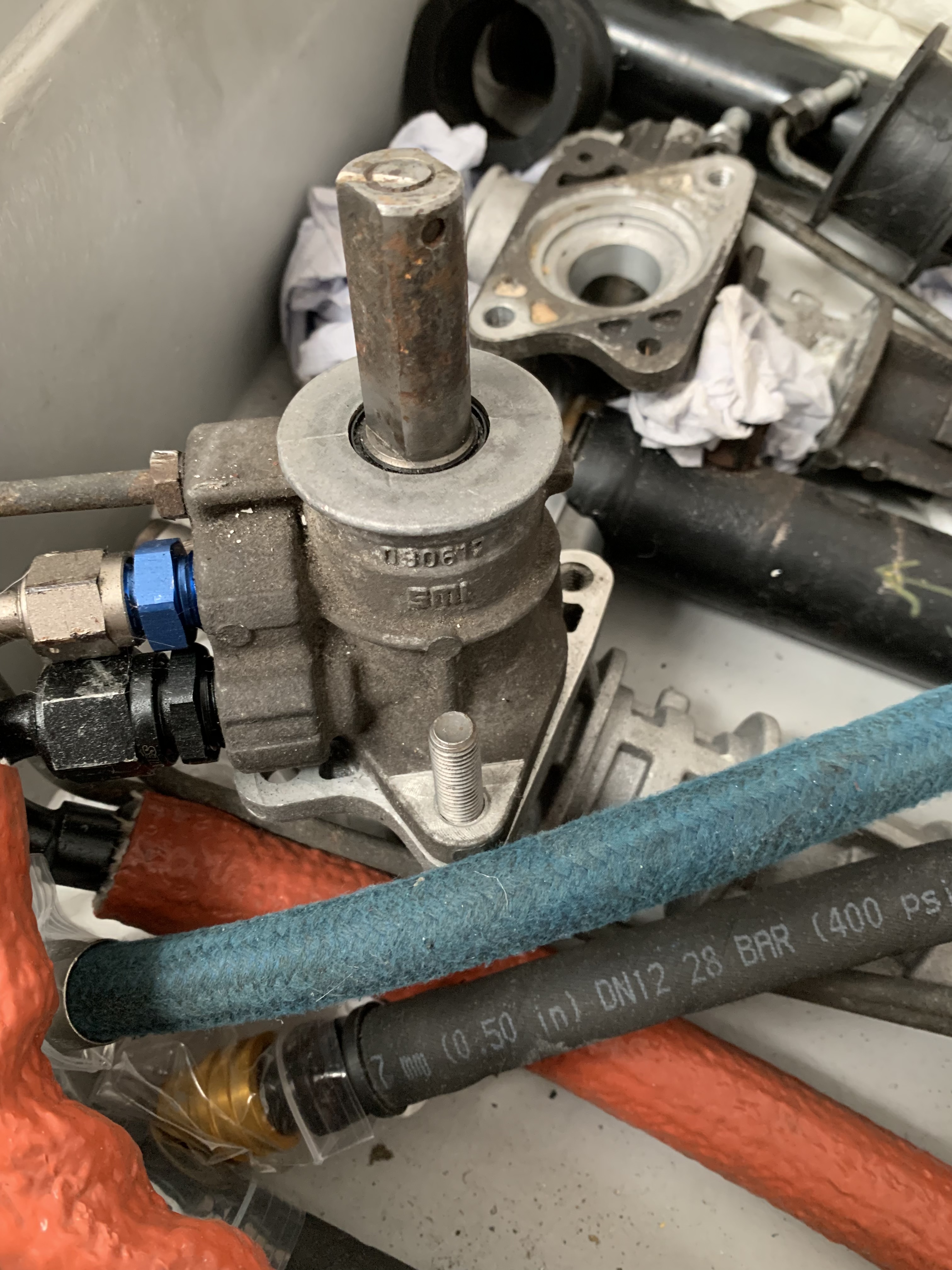

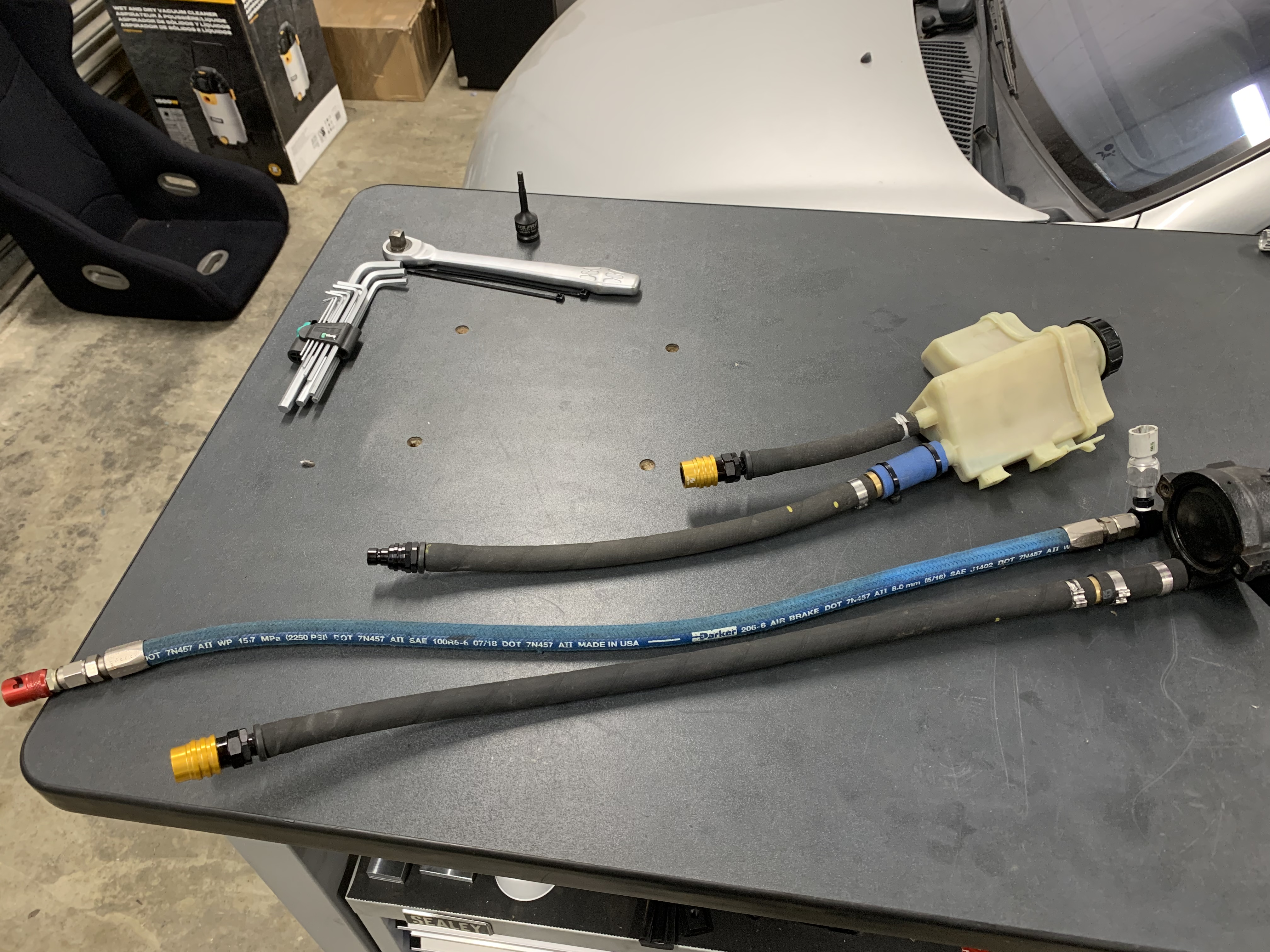

The lack of space by the rack is grim, and very close to the exhaust. This pic I posted was the return line back to the Rez and conveniently it has a coupler just before the Rez making it easy to plum a cooler.
The 2 lines without sleeve by the rack pic are the inlet/outlet pump lines (quick disconnect before in easy accessible location far from exhaust before they get near the rack (and heat) I have sleeve on the rack high pressure line and return lline.
It was a lot of work and I achieved nothing apart for now I have some cool motorsport parts.
