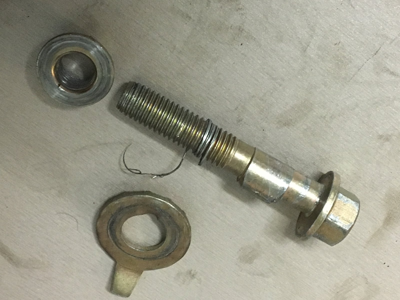

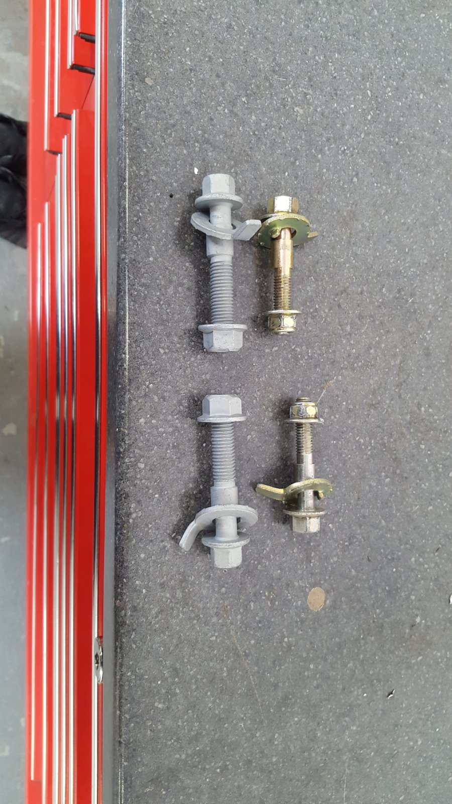

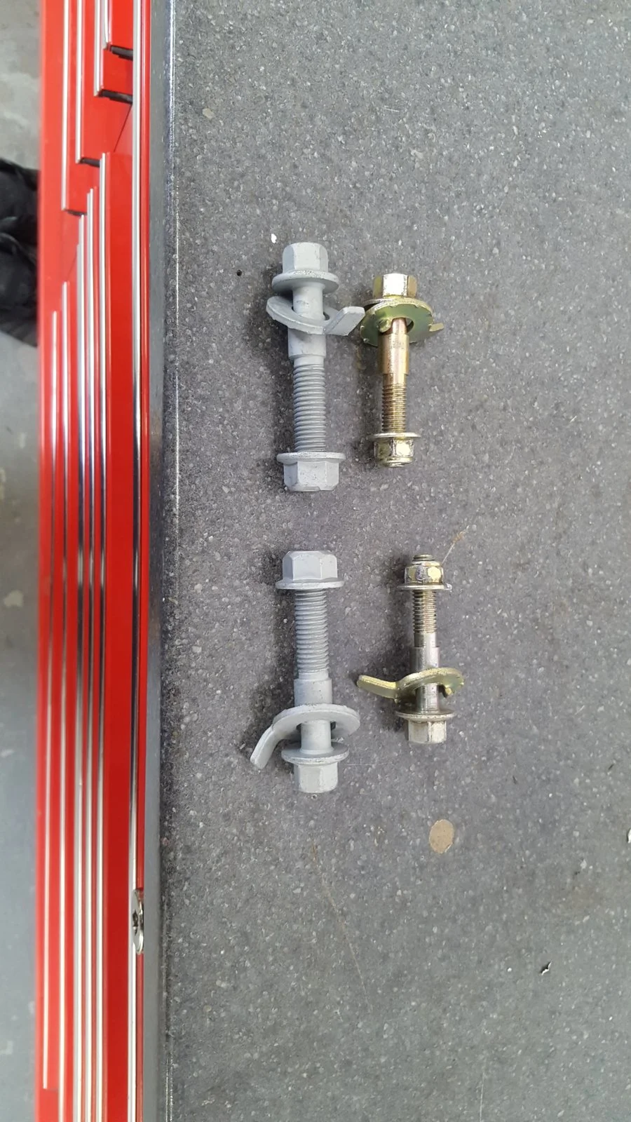

Tried to upload the picture but I don't know how to do it. Powerflex bolts were 12mm on the cam lobe bit and eibach ones are 14mm on the cam lobe bit thus explaining why they were slipping under high load. Im surprised they didn't snap to be honest!!!
