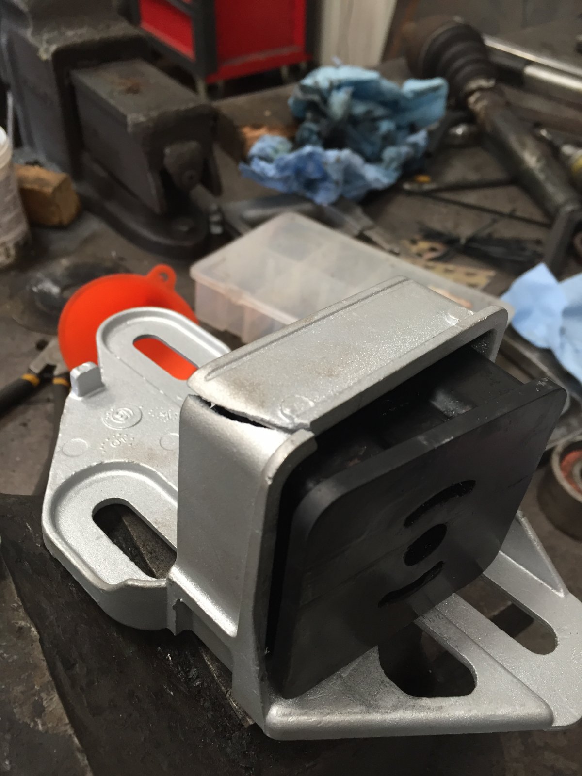

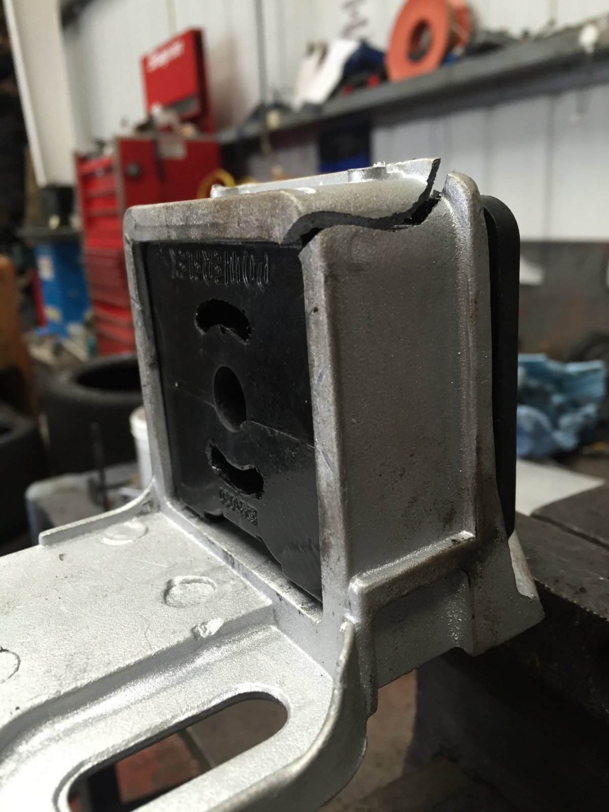

i purchased these but have had major issues trying to get the bush pressed into the brackets , i completely removed all the existing rubber and 1st attempt using G clamps i broke the bracket , 2nd attempt using a proper press broke the bracket and 3 rd attempt using a vice and some sockets broke the bracket , this bush would just not press into the bracket :/
i ended up having to remove the lips on the sides of the bush which allowed it to press fit fairly easy , i have contacted the seller of these bushes and he guarantees me that he has sold lots of these with no probs . the instructions for fitting these recons they can be fitted while the mounts are still on the car which i doubt , just looking to hear others experiences with them .

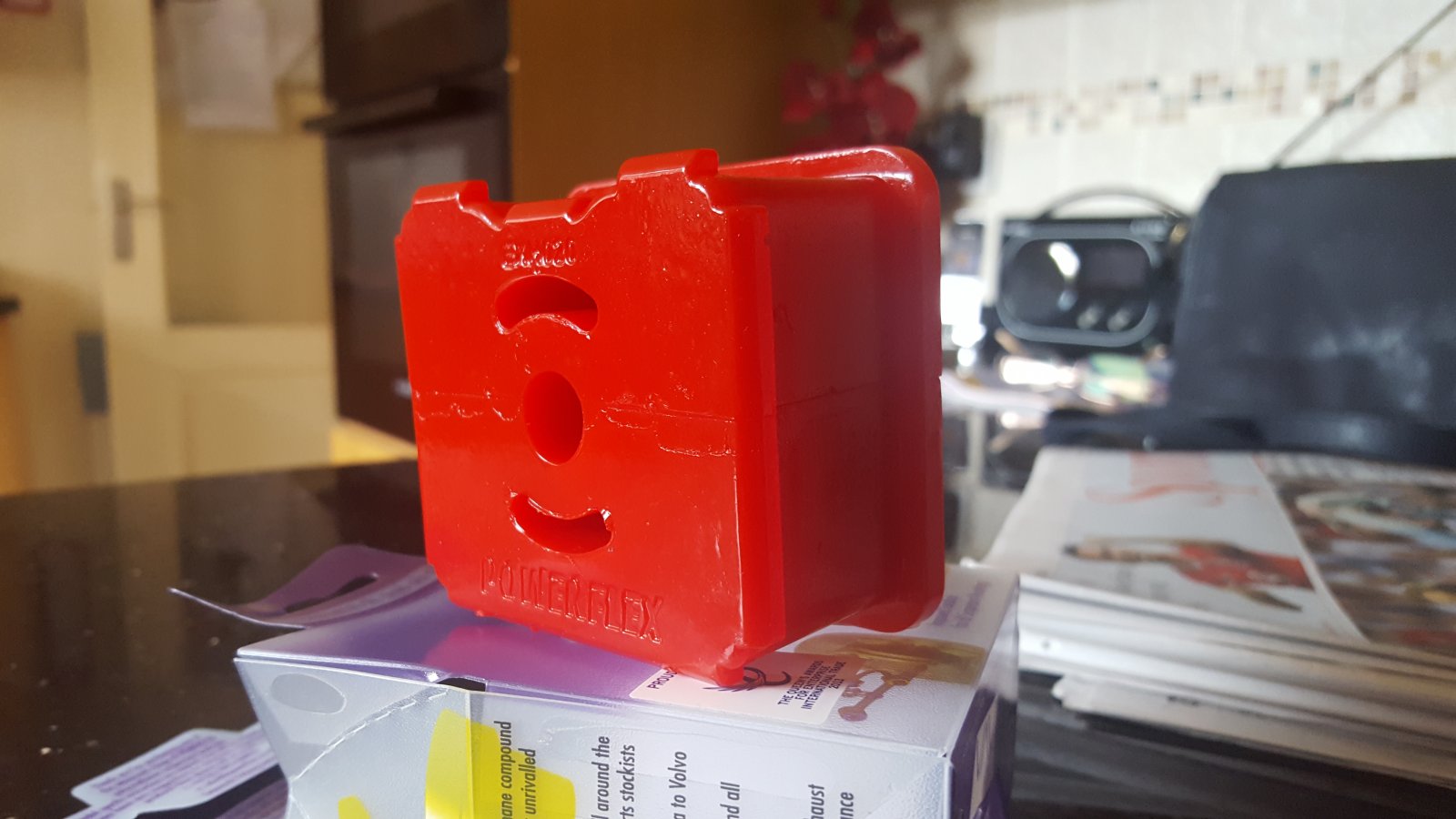

I've brought the red 1s which I should imagine are the same size. I hope I don't have this problem.

the 3 i broke were all genuine Renault brackets , i finally got them to fit by removing the side lips on the bushes and i had to use the old ebay brackets that were on the car , was getting the exhaust fitted today so i couldnt get new brackets , but thats £22 each per bracket from renault wasted .

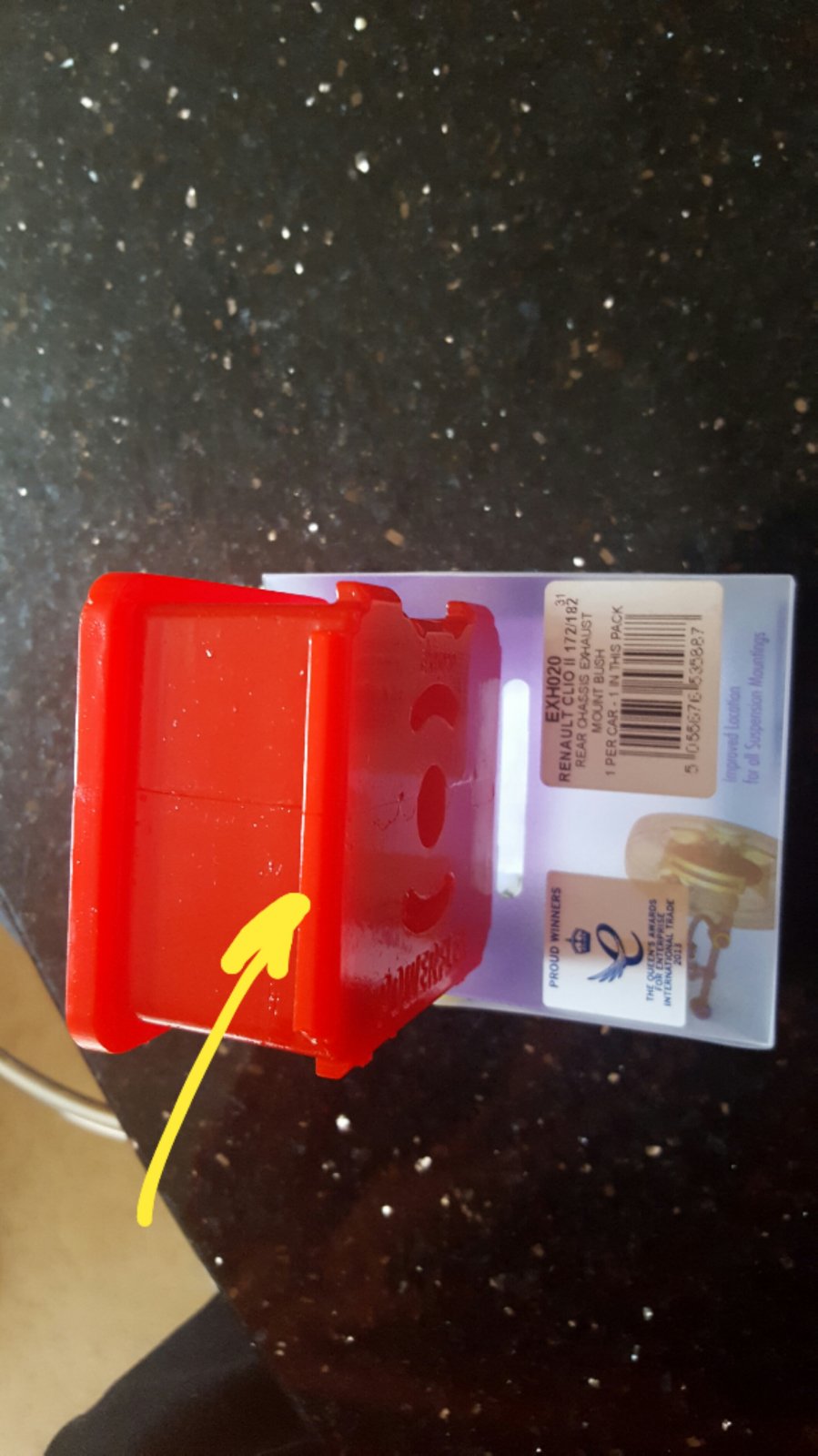

i think the red bushes are a little bit softer although i may be wrong and yes that is the lip i removed to get these fitted

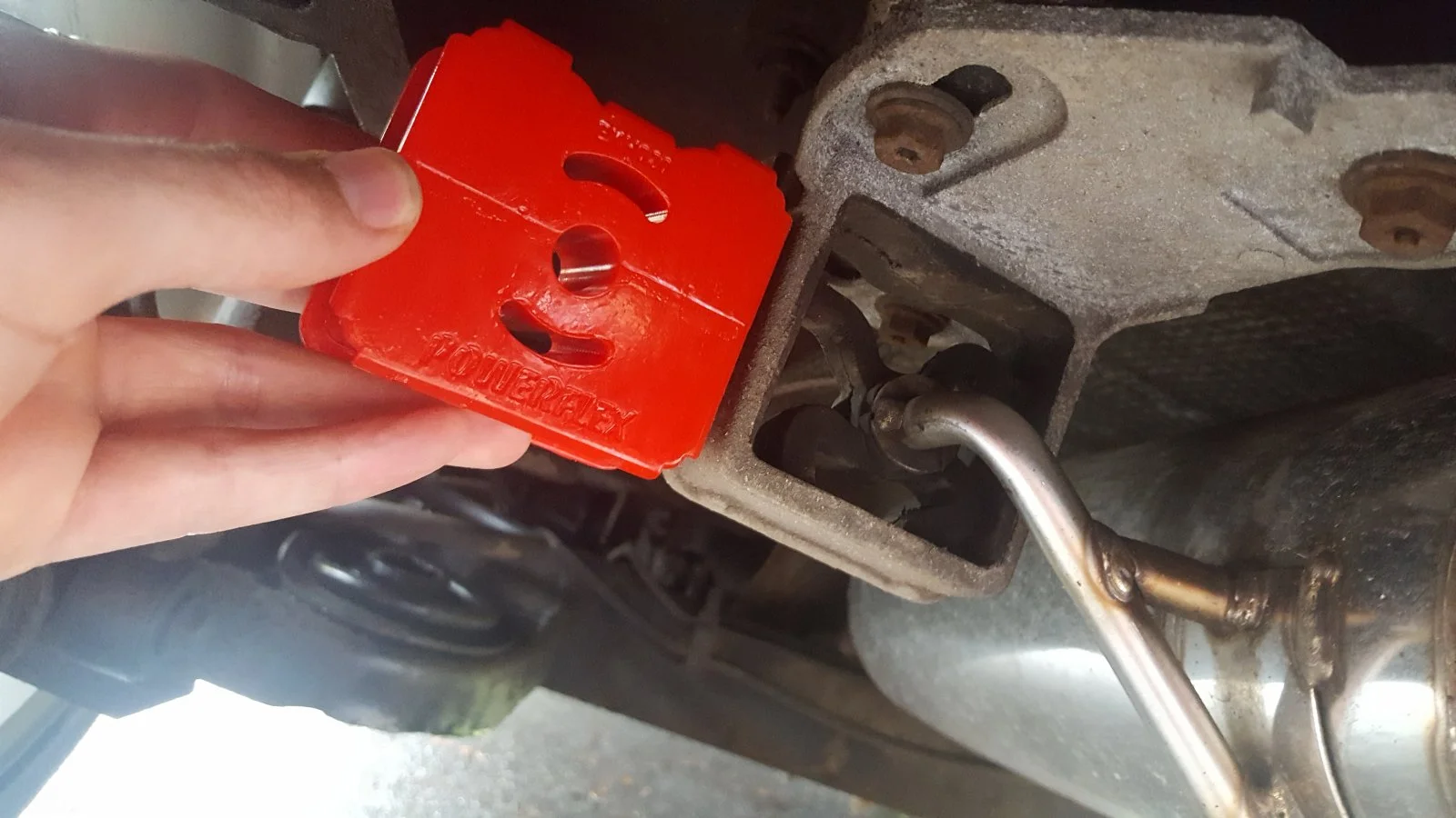

Make sure you remove ALL the old rubber including the stuff from the inner edges and then pop a bit of fairy liquid on and jobs a good'un.
I fitted a red one recently. It took an hours swearing but got it in there come the end. They are tight and not helped by the fact they squash as your trying to press them in. I wonder if it's because you got the black ones and they are solid. I do get a bit of resonance at full chat but adds to the charm, it's a cup after all so I'm not after comfort... Don't be put off as it's a worthy upgrade over the crappy one ones that collapse on themselves.
  dan's cast offs.
fitted about 20 or so, all red though, never had an issue. trim old rubber out apart from top, silicone spray and they push in 90% of the way by hand, finish off with small bar to hook the lip in place.
takes longer to get old rubber out than to fit new bush.
