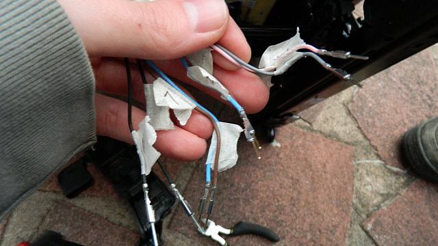

The reason is this

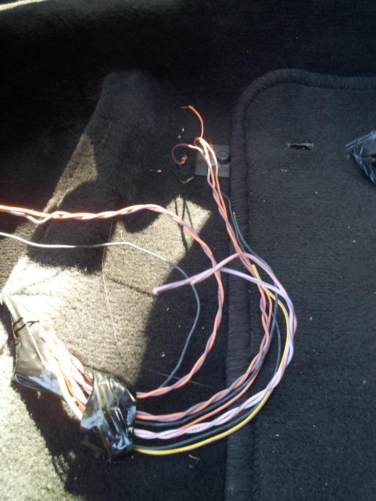

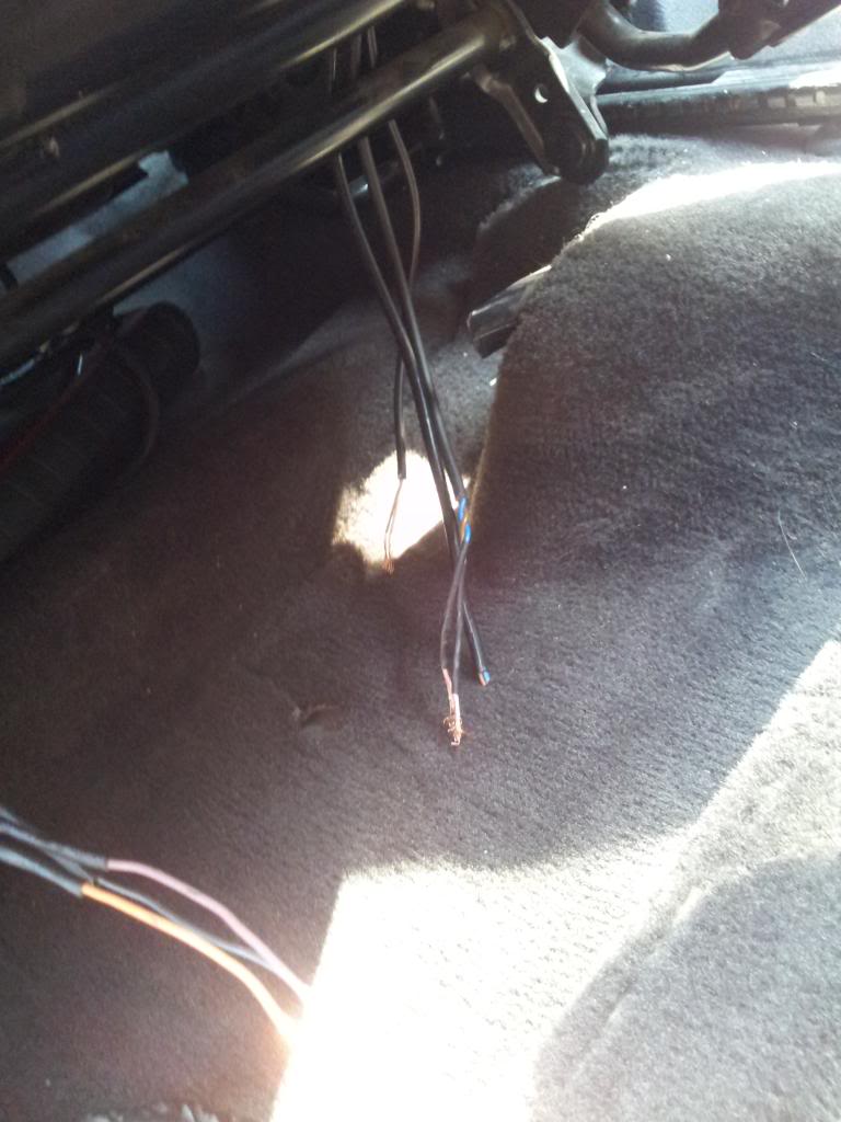

The pretensioner has had the plug cut off, and so has the car side of the wiring. However, then no attempt has been made to reconnect them!?
Im now left with 8 or 9 different coloured wires on the car side, and 4 on the pretensioner side, with no idea what goes to what
Can anyone help with some pics or a guide to which colour corresponds with which, as I've searched high and low and on the pics that look like they'll help, the pics aren't clearenough
Thnnks

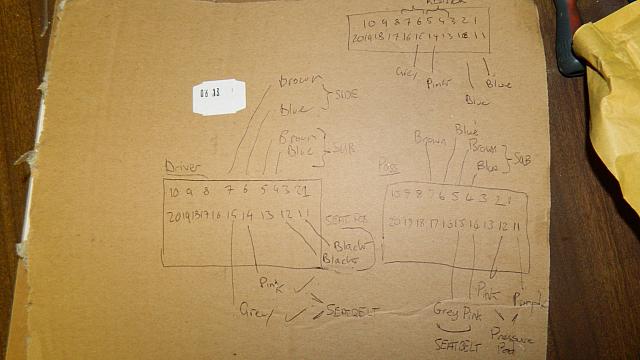

Ooft proper bodge that! You need to source some replacement plugs from a car being broken as trying to mate wire > wire is just going to be another bodge ontop of an existing bodge. You will struggle fixing this via pics too your best bet would be to attend a local meet and compare with someone who has the same model of car as you and start tracing wires. I did something similiar when fitting Recaro's to my Megane:
I'll try and remember to get some pics of mine when it stops raining.
