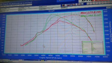

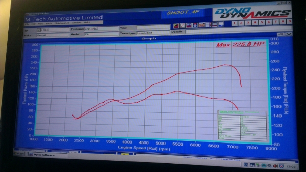

The turbo doesnt need to either, but the turbo gives you the option for a big midrange torque increase as you can add extra boost at that point, but with a supercharger you cant really, whatever the charger is geared for it does everywhere, where as the turbo you have control.
So on these two graphs for example, both from a turbo car, you can see the difference in peak torque from utilising this opportunity or not, where as on a centrifugal charger install, you would only be able to achieve the lower peak torque (red) one:

  182/RS2/ Turbo/Mk1
That's a mental increase over 1000RPM!
Thats why its so important to have throttle angle controlling the boost IMHO.
Those graphs are both my car, green on is at full throttle, red one is at 3/4 throttle
And at half throttle it pretends its an ITB car, lol:
