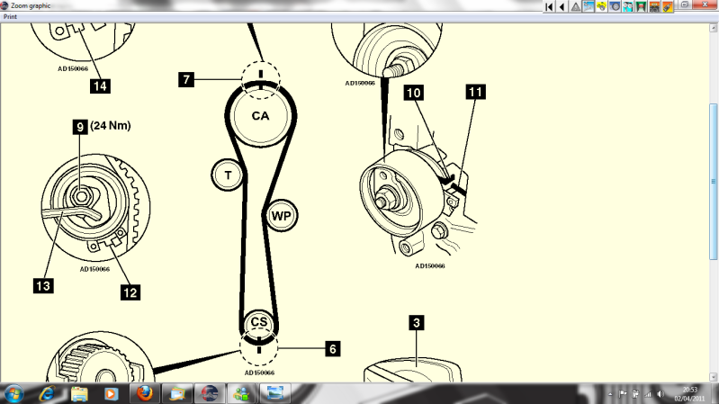

i have took the head off my friends 1.2 16v and not sure on how to time it back up due to not having any timing marks,anyone have any ideas?
do i get get piston 1 to tdc?

there's hole in the block that lines up with a hole in the flywheel. use an m8 bolt

is the crank pulley mark the cut out mark? any idea where the hole is?
cant see all the pics on ure pic

seriously? thats a screen shot of the autodata diagram. It's also the easiest cambelt in existance, the belt should have 2 lines marked on it, line them up with the pulley teeth that have marks on them
