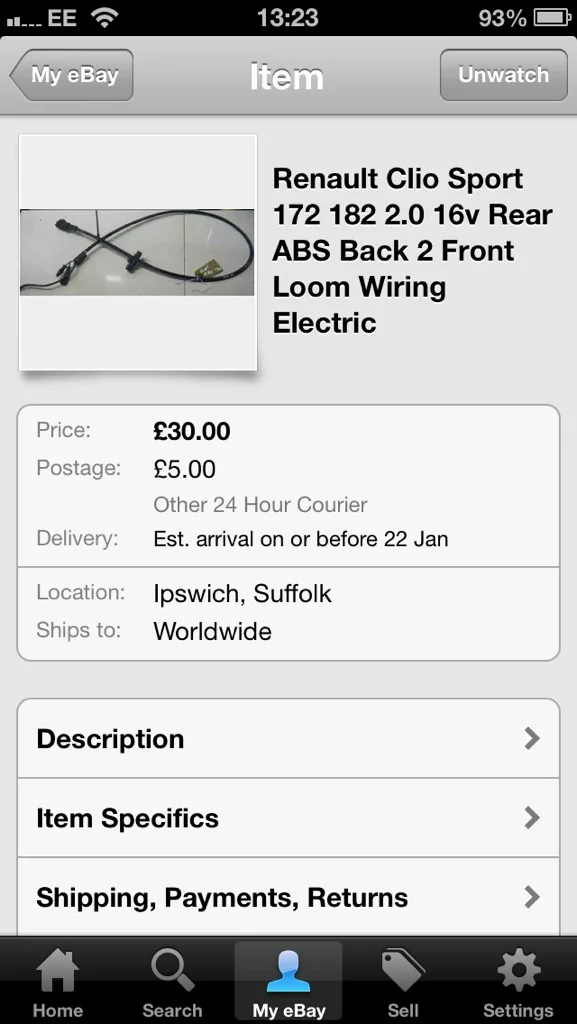

is this the part i need ??????
I've seen this a fair few times before, normally fixable like this:
Sometimes I can do it without the fire tool.
Mick
You really want someone electrically biased with this issue rather than a jack of all trades garage.
Mick
