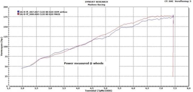

Their power gains however, are a little debatable:
Power increase + 11 HP @ 5800 RPM
Power increase + 7 HP @ 7200 RPM
Torque increase + 12 Nm @ 4800 RPM

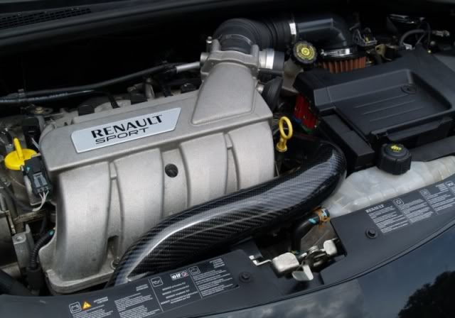

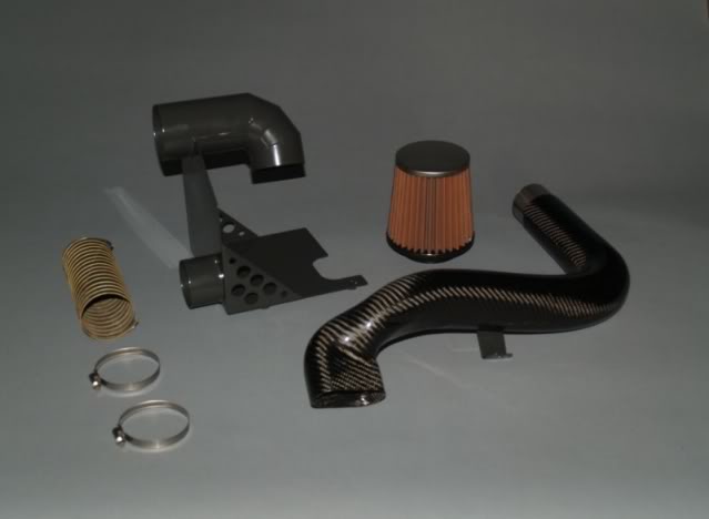

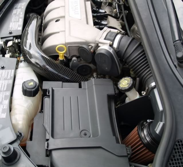

Heres a few pics of the setup, any professional insight into whether this kit looks like it would make the claimed gains or not etc etc would be appreciated.

i honestly think you'd be better off with the standard air box and a panel filter. On my first 172 i had it rolling roaded before and after with a £300+ ITG Maxogen fitted and it lose 2 bhp and gained 4lb ft. i really would not expect those gains, especially when you look at the cost mate.
£700 is frankly ridiculous
  BG 182
Too expensive.. and i would have thought that fully enclosing the filter would have been a more sensible idea?
It will, at best, not lose power. How they can claim its had lots of development into inlet length when it uses a carbon copy of the original air feed and then connects to the original post airbox pipe is beyond me!
I can think of much better ways to spend £700.
  SG9 Forester STi
I thought it seemed dubious, too good to be true ay?
It'll be the ktr big brake setup instead then please sir :p
aucky
Basically £700 for a fancy caf and a cheap filter. You could do a DIY version on a laughably lower budget.
Well they say it took months of development on the dyno with adjusting of the inlet pipes length and shape, and specific type of filters and sizes etc.
Plus the genuine carbon inlet pipe that takes '7 hours of build time in itself'.
That is puuuure marketing talk right there trust me. For them to have spent months developing it they would of needed to design and manufacture different prototypes which is a stupid excercise in itself because with today's cfd programs, you could calculate the optimum flow rate for the dimensions of inlet that they design, and by making changes to the design on their cad program they could see what affects this would have on the flow in the cfd program. If they did that it wouldn't cost as much to develop, unless their trying to charge for the engineer's time. They say it's a "specific type" of filter but doesn't look like anything new or space age to me, just looks like any other cone filter, in fact it looks like a very cheap one. Making that inlet out of carbon fibre is just unnecessary, they've done that just to make it look expensive and it will increase their manufacturing costs hence the ridiculous price. Seriously for £700 im sure you could get some other bits for your car that would give you something close to 11bhp, perhaps more.
