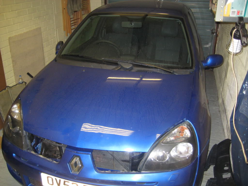

Eventually this one came up for sale on Autotrader in my price range----
With full service history, 80k. miles, all the docs, handbooks etc. but a cat c insurance jobbie due to frontal damage that had been bodily repaired but leaked oil, water & PS fluid. So I set about removing the front bumper, grill, radiator, airbox and all the front hoses that leaked. Coolant, PS fluid, engine oil, gearbox oil were all drained and later refilled with new fluids. The radiator and top hose had to be renewed, they were easy enough but the high pressure PS hose was a pain to remove.

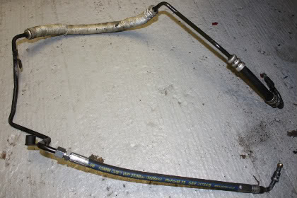

I traced the hose around the engine bay and it turns out to be the longest pipe going from the pump - along close to the radiator bottom -under the battery tray - then dives under the bulkhead and runs along the front of the rack. 4 brackets hold the pipe steady en route.

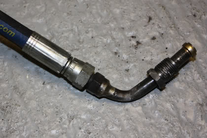

My first choice was to go to Renault and buy a new one, £230, shocker. As I some previous hydraulic pipe repairs from Pirtek I went down this route but 1st I had to take the pipe out without any further damage, with help from a friend it took us 3 hours to remove after removing many other parts for access. The nice Pirtek engineer renewed the leaking flexible hose and inserted a union to allow us to refit the hose assembly much easier than when we took it out. The difficult part when refitting the pipe was screwing the connector back in to the steering rack as there is not much space to work in.

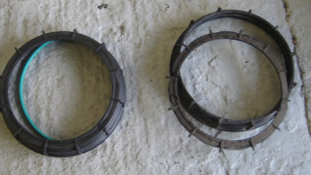

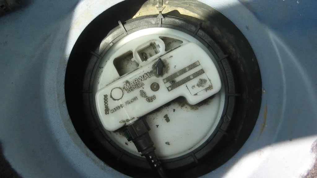

Since I bought the car I was always aware of the smell of petrol in the garage and hunted down the cause of this. sniffing my way around the car and eventually to under the rear seat I found the culprit.
There is a plastic cover to access the top fuel tank connections with a plastic collar and O ring to seal the fuel pump to the tank, you can see the flange had broken away from the collar on the right hand side of the photo and the new collar with O ring on the left. I fitted the new collar and O ring nice and tight
After another couple of days still I could smell petrol fumes coming from the same place. The reason, there is no other seal between the pump mounting plate and the tank lip, so an old tyre inner tube was cut up and a flat rubber washer trimmed to shape to make an extra sealing ring, the result now, no petrol fumes.

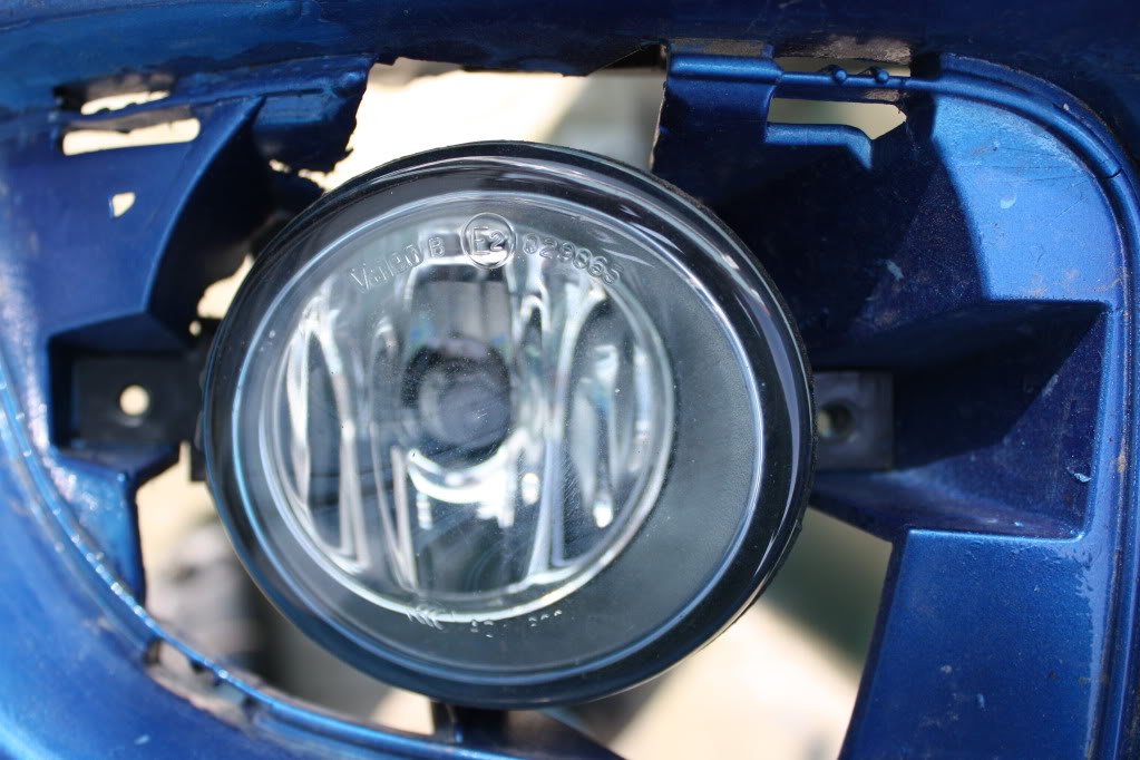

Now it was time to fit the the front body parts back together again. I spent two days re-aligning the the front wings and refitting the front bumper to get the right gaps, you can never get it back to factory like finish but I managed to align the panels to a reasonable standard. Last thing to fit was the the foglights, which needed new bulbs and a loom to link them together.

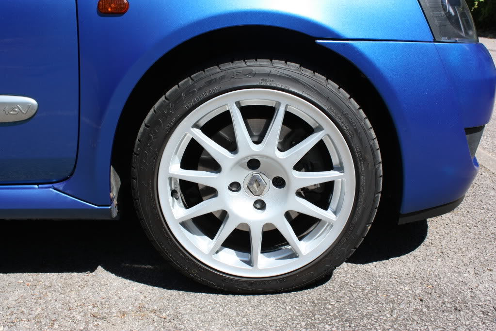

After its first wash the Turini alloys looked rather sad, corroded and kerbed so I splashed out on a re-furb for the 5 wheels ( Don't like the idea of no spare and the inflation kit went in the dustbin) and new Toyo T1r tyres. It's now looking a whole lot better.

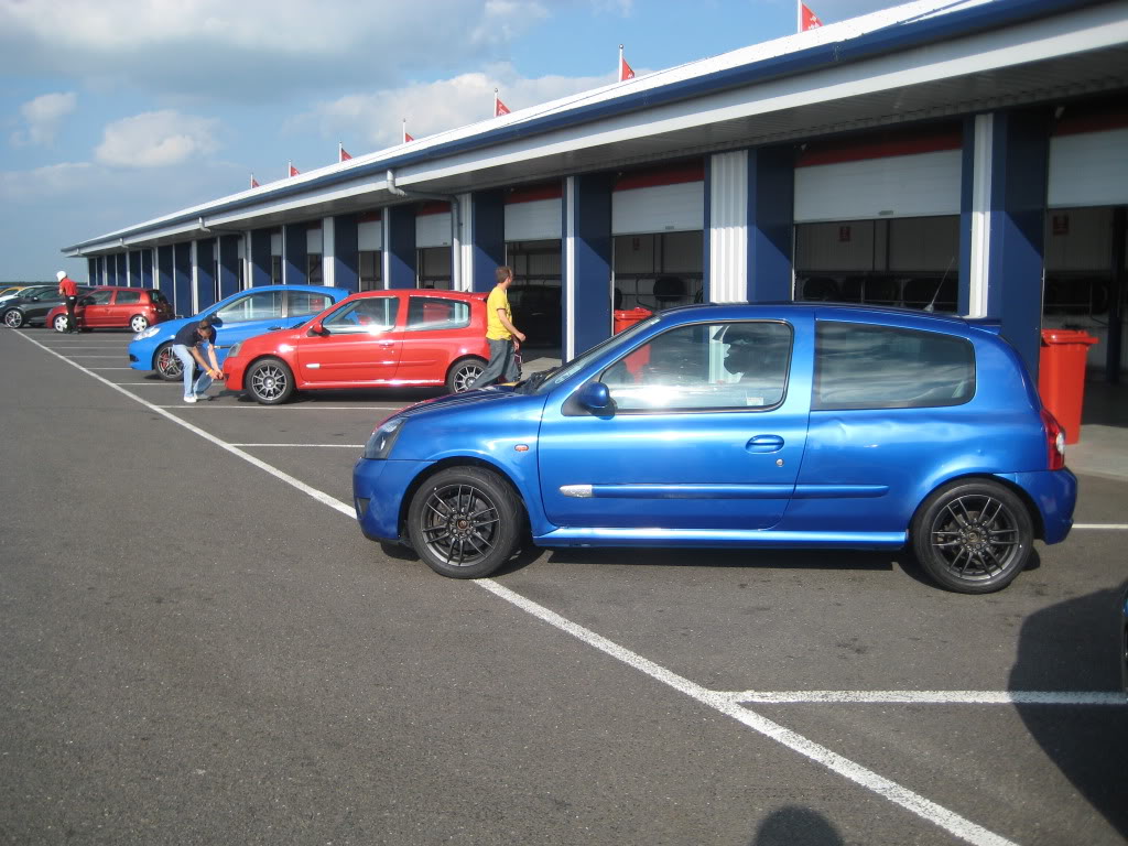

June came along and Bedford Renaultsport Track evening was booked. As I didn't want my nicely refurbed Turinis damaged I came across a set of 15" trackwheels with used Advan tyres for the princely sum off £175, bit off a bargain I think. So here we are on our first Track outing

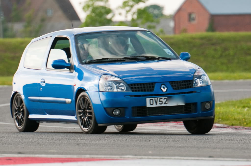

No dramas on it first track sessions, all went well, I'm chuffed.
Good stuff, must have cost a few quid getting it to the standard but does sound ideal for a track car.
Have you had an alignment done at all, its maybe just the pic but the front wheel looks a bit forward of normal imo.

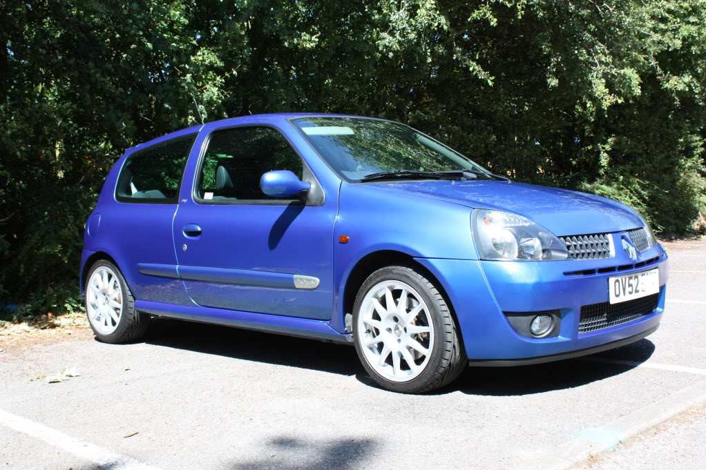

After a few weeks and many smiles per miles the weather is dry warm and sunny so it was time for some paintwork attention.

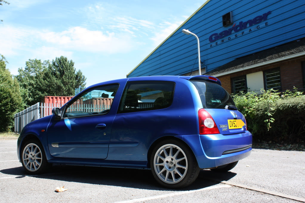

After a soak and shampoo, the chips and scratches needed some touching in with a Mondial Blue touch up pencil, the rest of the day was spent with a bottle of Metallic T cut and I went over the car twice and it is surprising how much dirt came off, I used about 4 polishing cloths in the process. The next day was spent polishing with Autoglym Super Resin, again, two treatments were needed. Final touch was the famous Skoda lip spoiler mod, a bargain at £11.

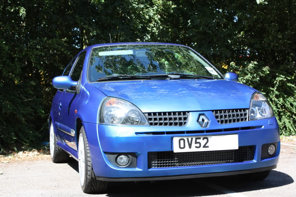

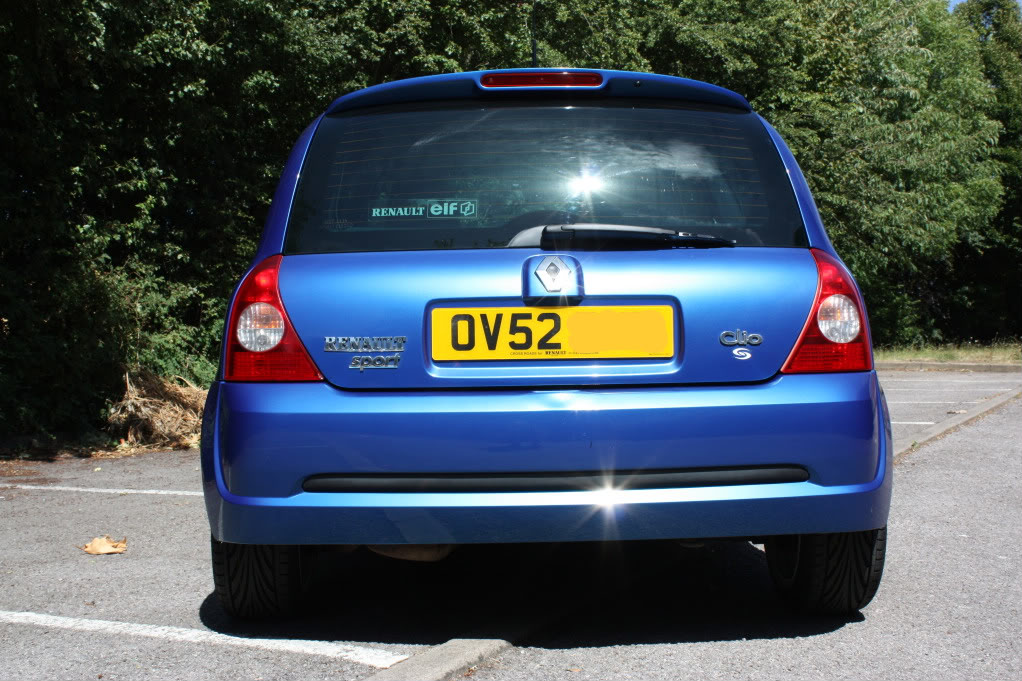

So here are the obligatory photos ---
The project cost me £2150 in the end not including the track wheels and new T1r tyres which were not really required to make the Cup usable on the road.
I'm happy with the result, even if it doesn't have the pedigree of some of the the really nice 172 Cups on Cliosport but I'm enjoying it just as much.

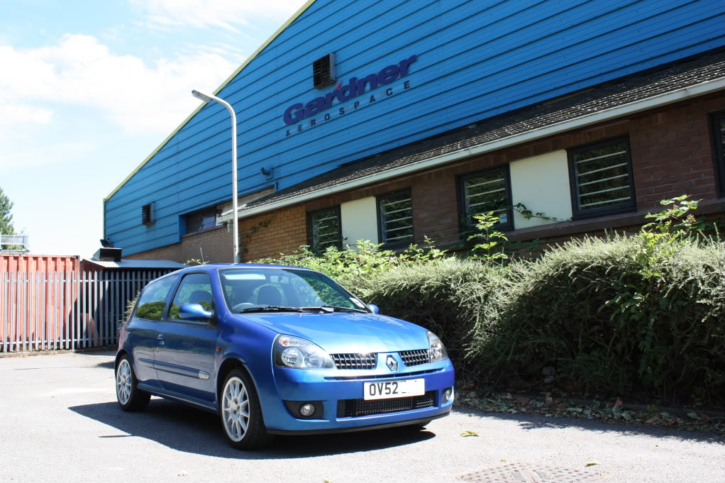

Do you work at Gardner Aerospace? I know that company very well as a supplier.
No alignment done yet, I'm fitting Eibach pros soon and possibly new OE shocks/top mounts if needed, then have it aligned. Keeping it OE all the way except the Eibachs.

I don't work at Gardners, just use their car park for photos as I live near buy and its quiet at weekends.

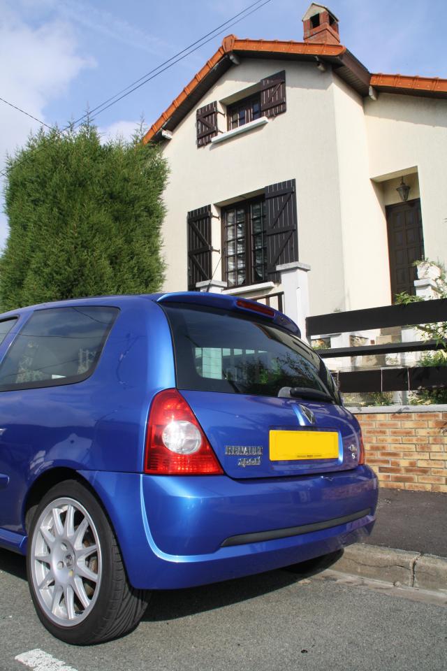

Now its my new car !
She is in France.
At home
She has need a new tyres. And go to track in France.
I do my first experience in track with my CUP !
Its wonderfull ! the engine is nice, the springs are just limit but the Toyo T1R are good.
I love my new car ! TY Sootie ;)
