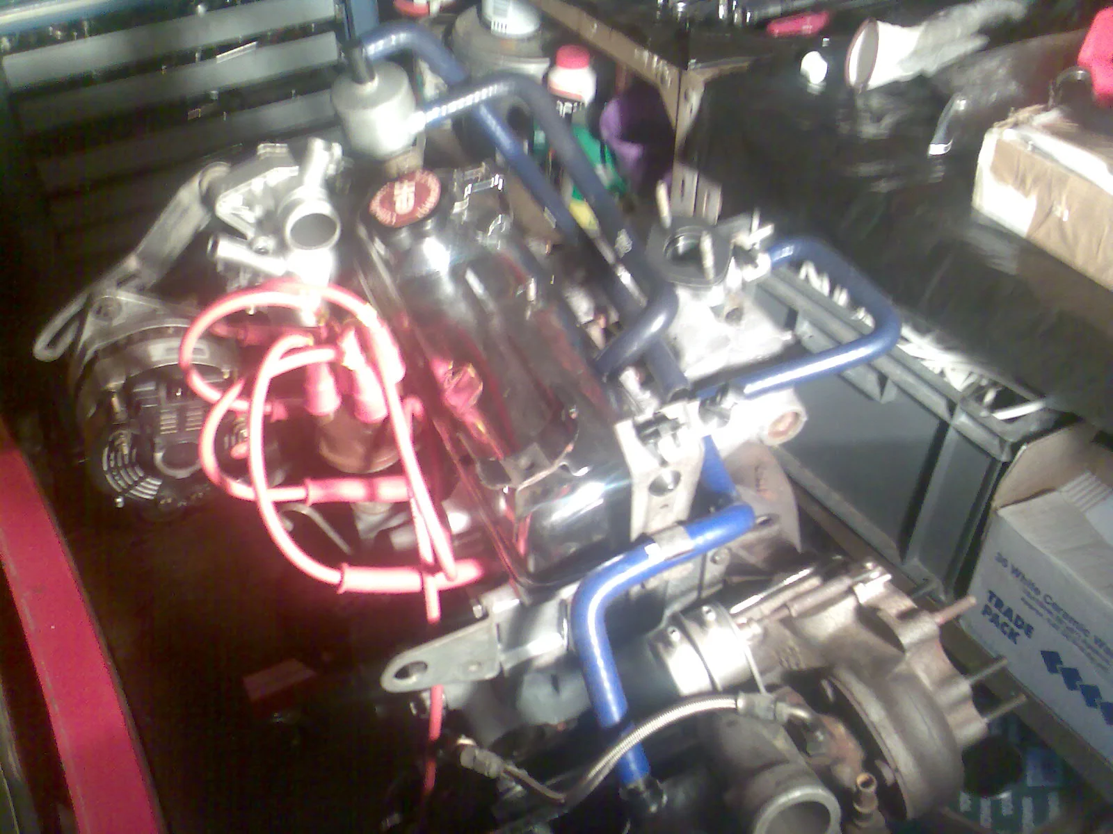

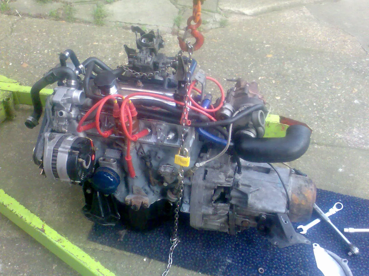

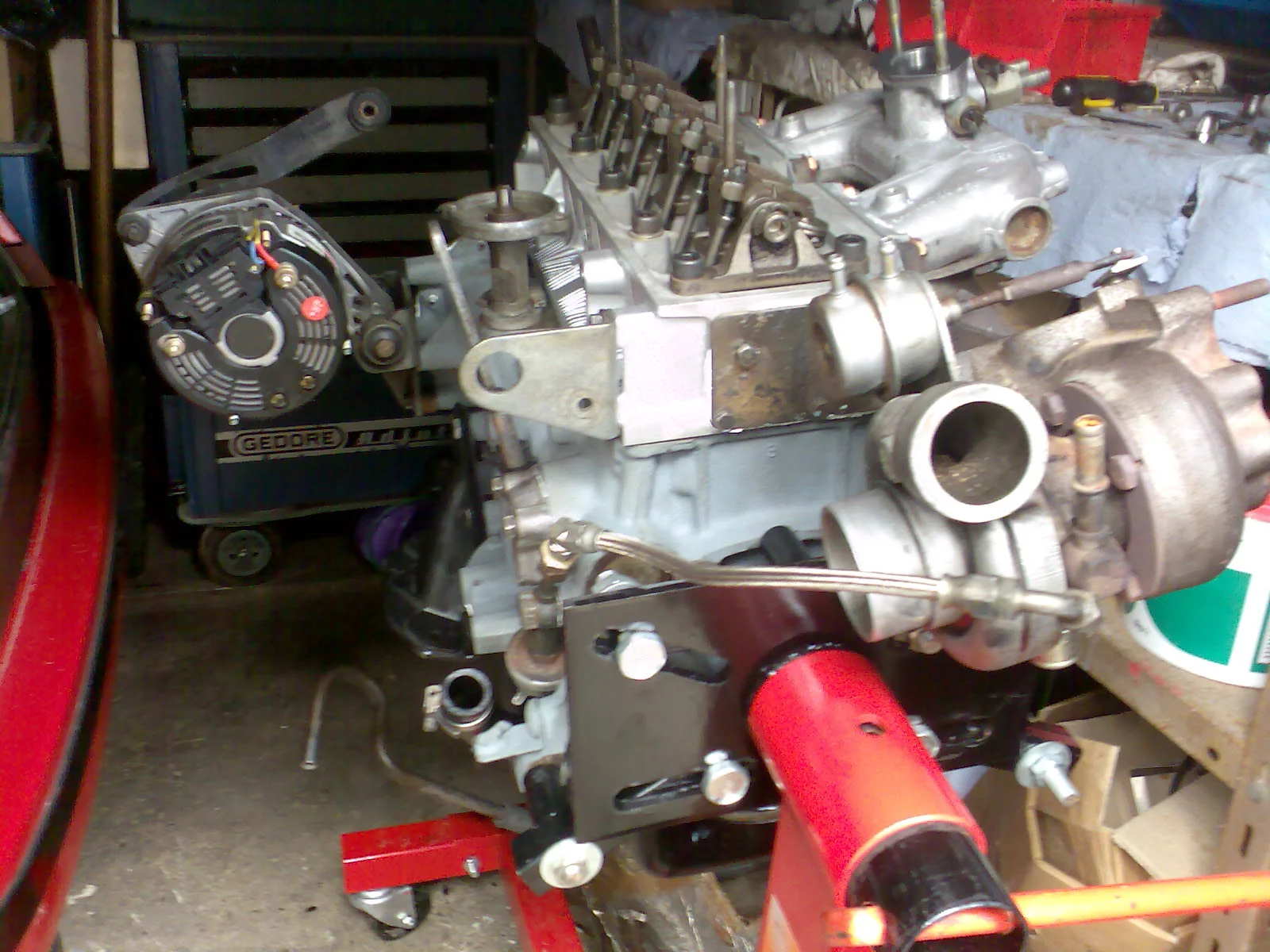

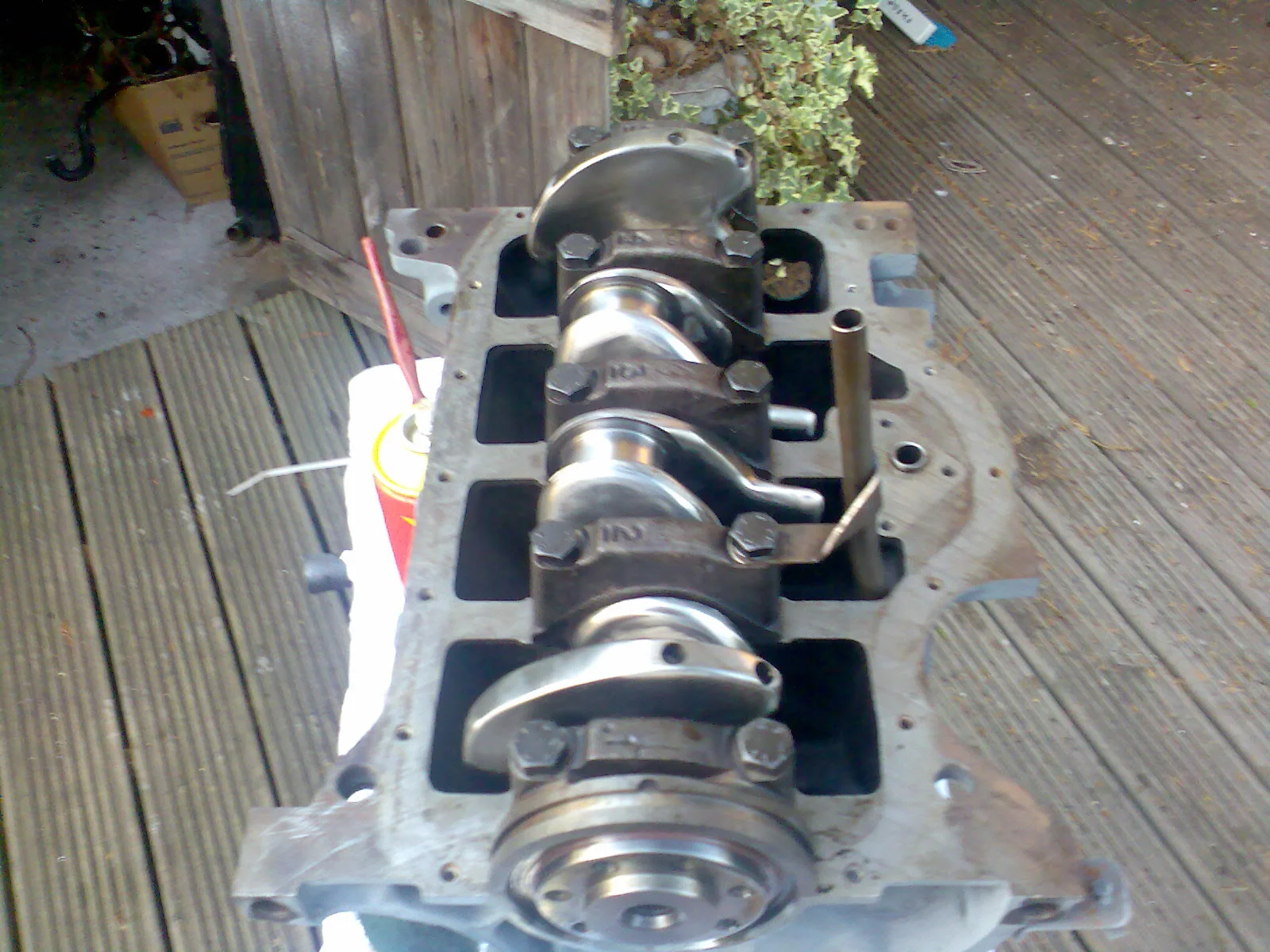

Over the last 6 months I have had a little project as I bought an R5 which was totally wrecked engine wise but had a few good bits, bigger turbo ,samco's big intercooler.
Decided to rebuild it my self and thought i'd just post some pics of it and the spec.
Spent the last few days putting it back in the car and firing it up tomo
See what you think, sorry bout quality of the pics as they were taken on my camera phone.
Spec is as follows
Knife edged and balanced crank
New shells and bearings
New Pistons and Liners
Group A Head gasket
Gas Flowed Head
GT Spec Cam
Vernier Pulley
High lift valves
The list goes on more pics and videos hopefully tomo if it works lol:rasp:

High Miler head gasket gone and had been run on high boost normal problems.
Just decided that a total rebuild was best for a project really.
