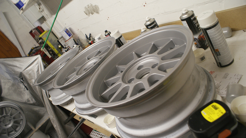

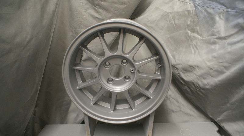

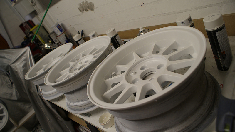

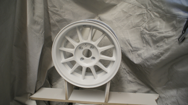

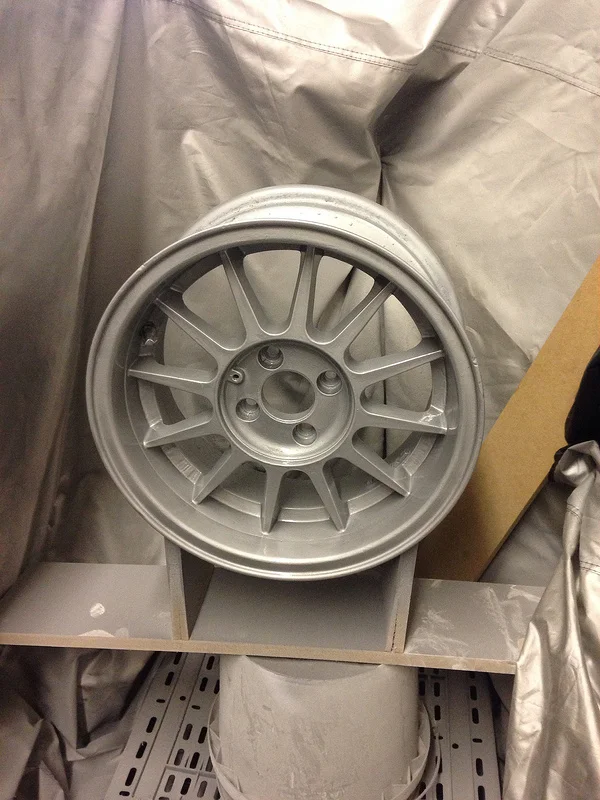

Some pictures of the wheels in white primer, sprayed the other day:

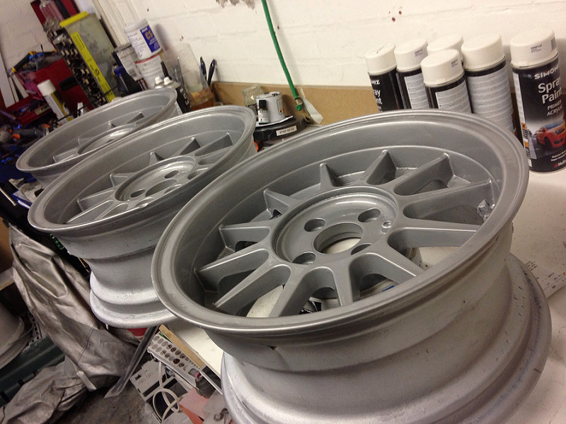

In the meantime today, I got the base coat of silver on the wheels:

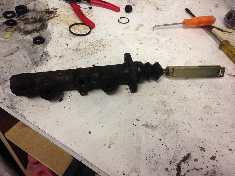

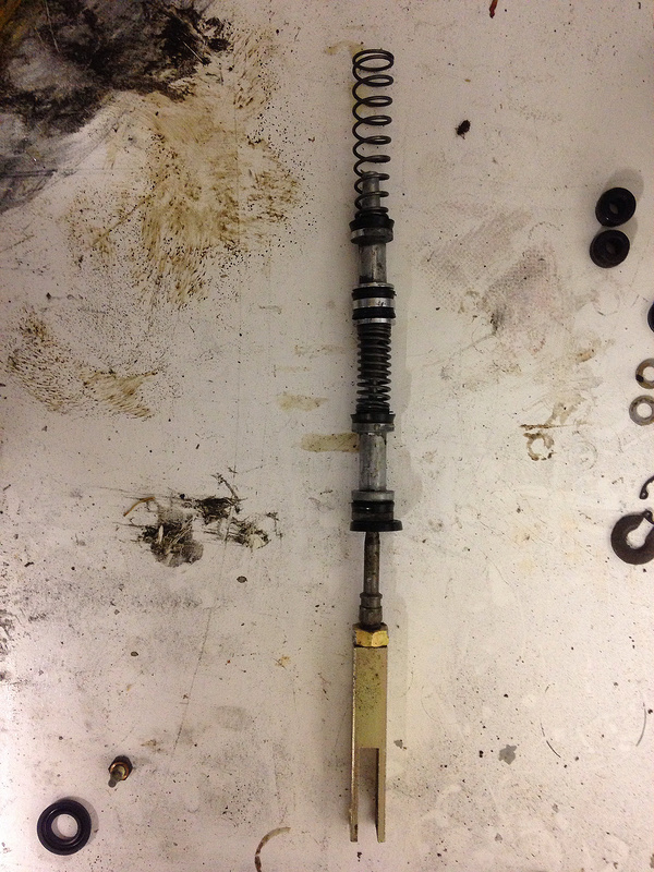

Master cylinder rebuilt yesterday.
Pistons rebuilt with new seals:
All reassembled, ready for bench bleeding and refitting:

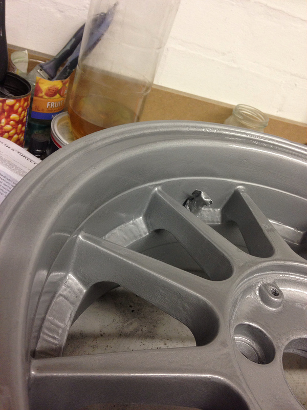

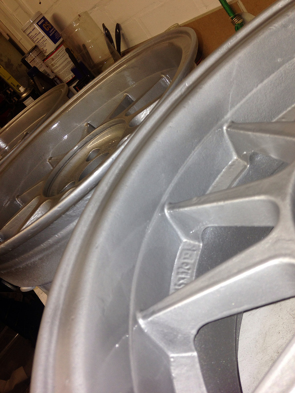

Wheels were flatted down, and then the final coat of base:
Then a few coats of lacquer:

That wheel colour looks a little flat Edward? Not fancy metallic?
What was the result on the MS?
Yeah, the paint I bought was just flat sliver unfortunately, a bit of a shame, but the whole point of this was to decide if I actually like the wheels. If I do, they'll get a proper refurb. (The home jobbie has only cost me £70 or so)
The M/C is rebuilt and back in the car, it needs bench bleeding (removing the air from the M/C before hooking it up to the brake system) so I'll do that and then bleed the system again, fingers crossed that should sort it.

Shame you did the lacquer though you spaz, you could have done a single coat of metallic to finish, then lacquered, so it would have only cost like 8£!!!
I know, I got giddy and threw the lacquer on. I then realised how flat the sliver was and kicked myself.

The master cylinder rebuild has worked, or it certainly seems to have done. The brakes work like they used to, and a test drive confirms that the problem would seem to have been solved.

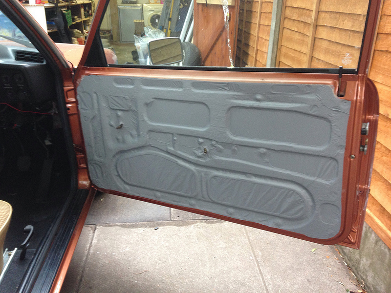

This meant I could press on with the interior, I got the waterproof skin on the inside of the doors tonight:
[url=http://www.flickr.com/photos/65934222@N03/9579082194/]9579082194_951f215b5c_c.jpg
[/URL]
Then rain stopped play, so I had to call it a night.

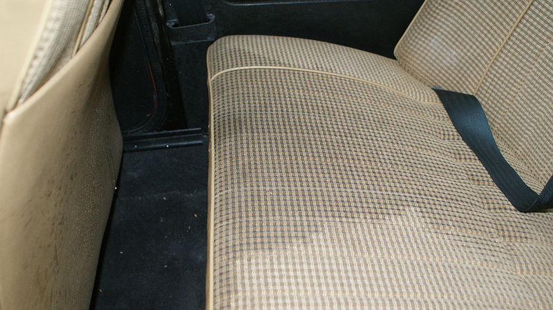

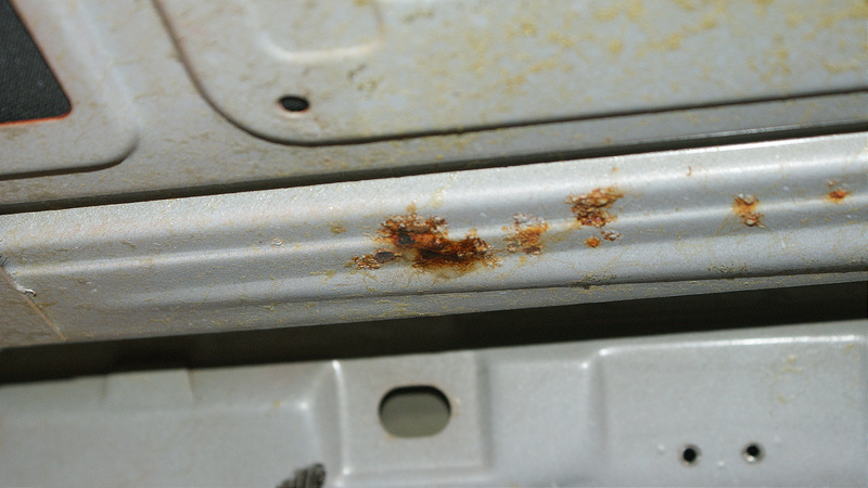

I noticed a leak on the rear seat/carpet behind the drivers seat.
Looked up to see this:
Causing this:
That was immediately dealt with in the form of some silicone.

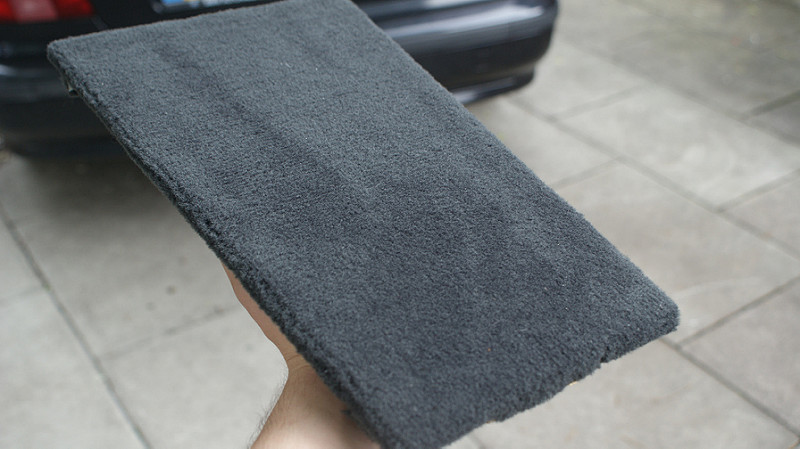

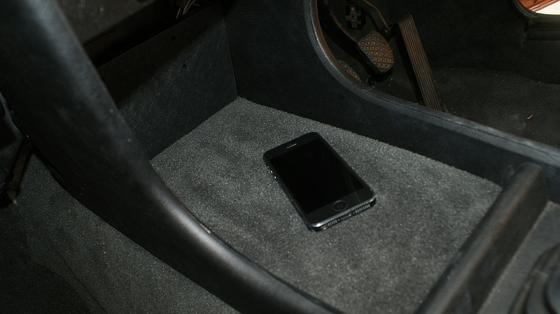

After that I started putting the final bits and pieces back together. Carpeted my centre console section:

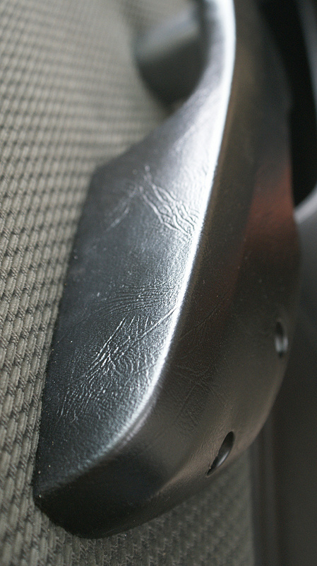

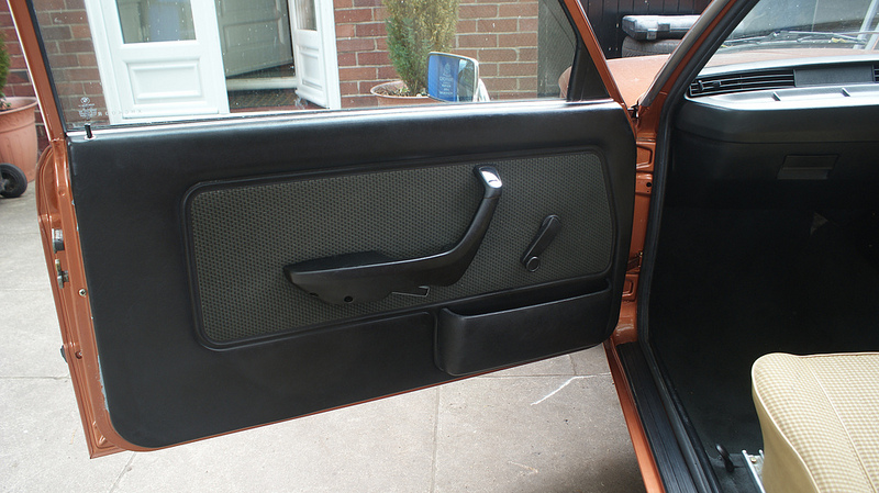

I also sprayed my armrests black to match the new door cards. Left them to dry for a few days and they've come out brilliantly.
Most importantly the paint hasn't filled the "grain":

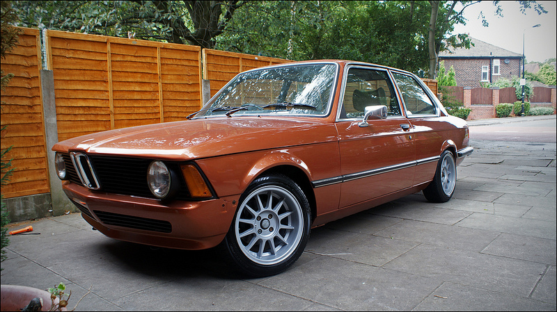

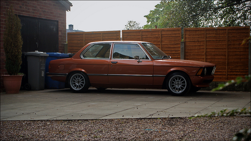

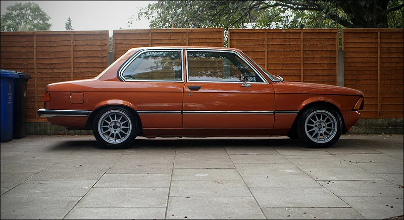

But of all the bits done recently, the best was getting some tyres on the wheels and getting them fitted :D
The front still needs to come down a bit, and they could do with some spacers, but I think the wheels look brilliant, very happy :)
So, it goes in for an MOT on Saturday, I see no reason why it shouldn't pass :)
-J-
  RS2'ed 172 Cup
That looks great, is the front bumper going back on? (IMO they look better with the bumpers, don't know why so many leave them off)
Pep
  M2,XJS,S1000RR
You sir have won some man points right there.
Looks amazing, real credit to you!
