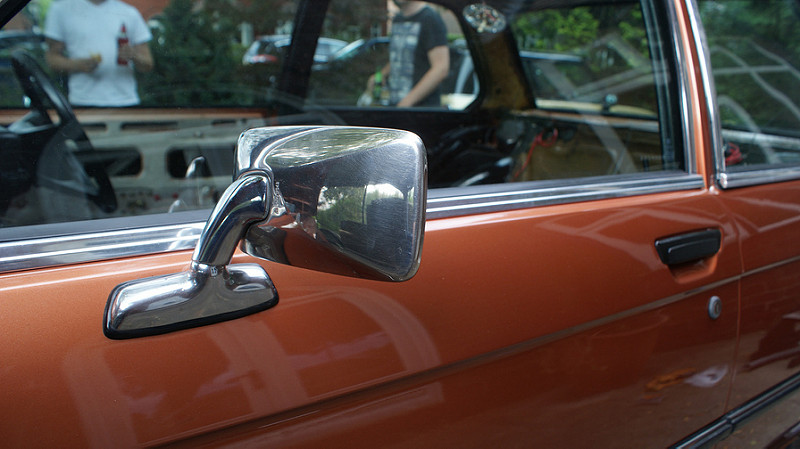

First up, my new grub screws arrived, meaning I could fit my wing mirrors. I love them, and they're a lovely feature of the car:

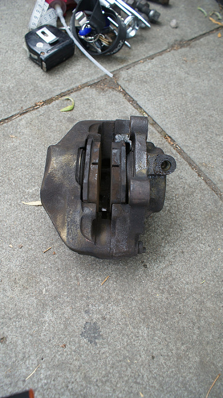

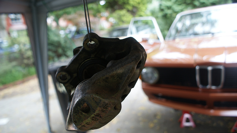

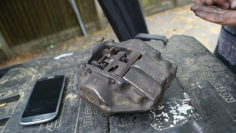

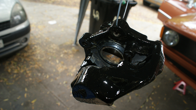

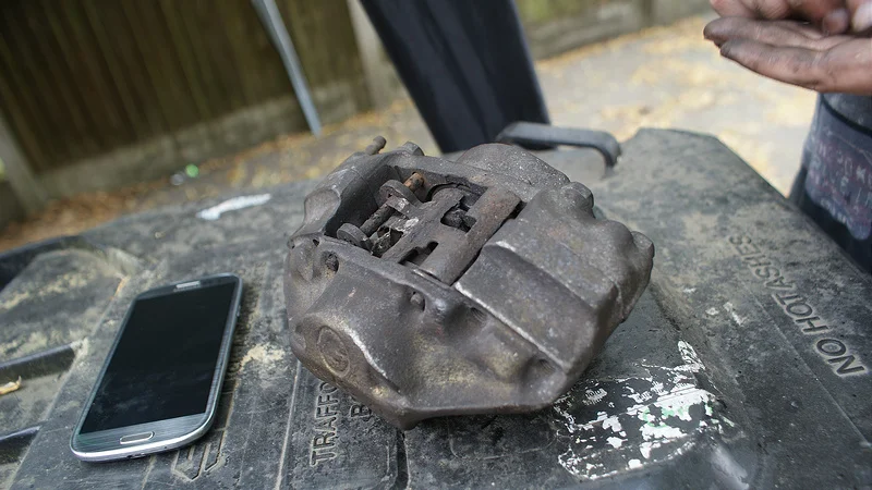

After that, we took the brake calipers off, as the hoses need replacing (more on that in a few days).
They were cleaned up:
And given a couple of coats of paint:

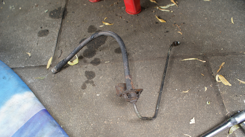

Wheelarch section of brake line that will be replaced by something, a little more premium :)

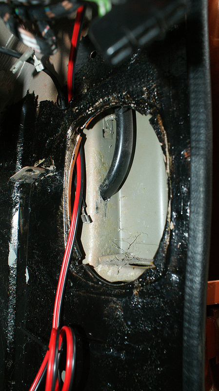

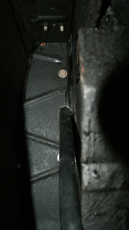

One of the worst design flaws of the BMW E21 is the front sunroof drainpipes, which pass down the A pillar, and through the chassis, but instead of emptying onto the floor, they empty into the sill.
As you can expect, this is a haven for rust and rot, so I decided to reroute the drain into the wheelarch.
So I drilled a 20mm hole in the back of the arch, into the space behind the speaker, then ran the rubber drain through there and into the wheelarch, so the water can now drain freely onto the road.
The hole was sealed up after taking some shots.

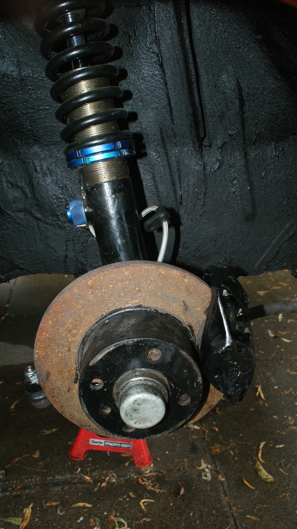

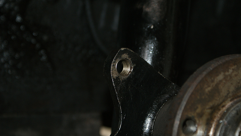

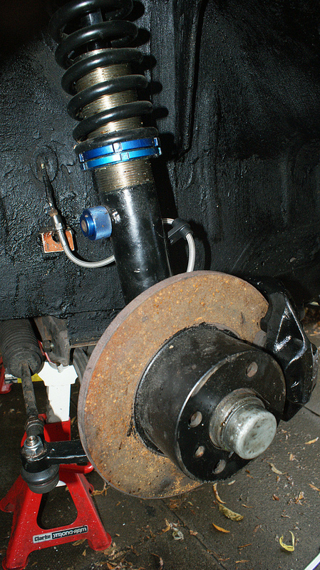

Next job on the list was to sort out a couple of damaged threads.
The caliper mounting point on the coilover had been drilled prior to me owning them, presumably to remove a stiff bolt.
So, I ordered a Helicoil kit off eBay, I didn't fancy paying the high prices for a genuine kit, so a £12 eBay special was ordered and frankly, it was perfect. If anything, the crappy keyless chuck on my drill let me down more than anything else.
Caliper mount with it's new M12x1.5 thread:

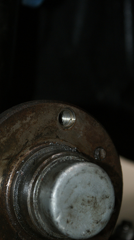

Also, to use the coilovers, I needed to upgrade to the bigger 323i hubs, which I did a few months back. Unfortunately one of the threads for the wheel bolts was crossthreaded, so to save me having to use just 3 wheelbolts, I drilled it out, ran a tap through it, and inserted a new M12x1.5 Helicoil.

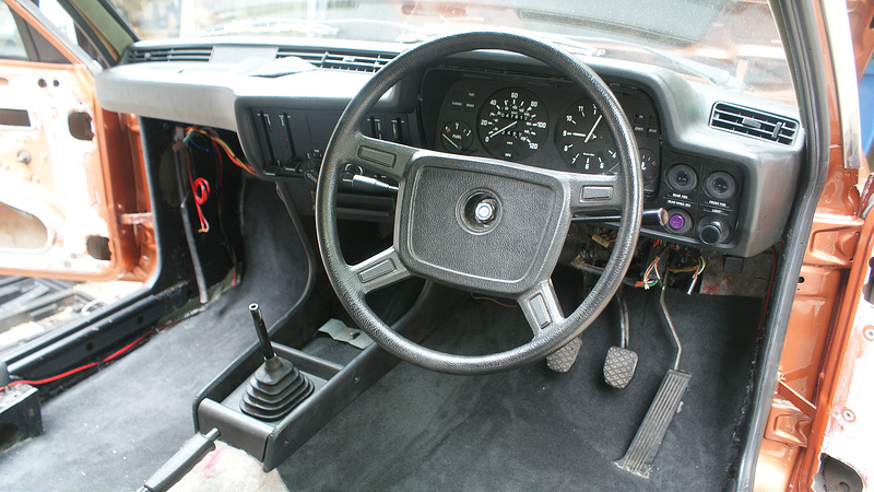

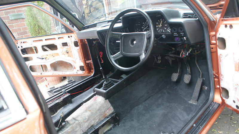

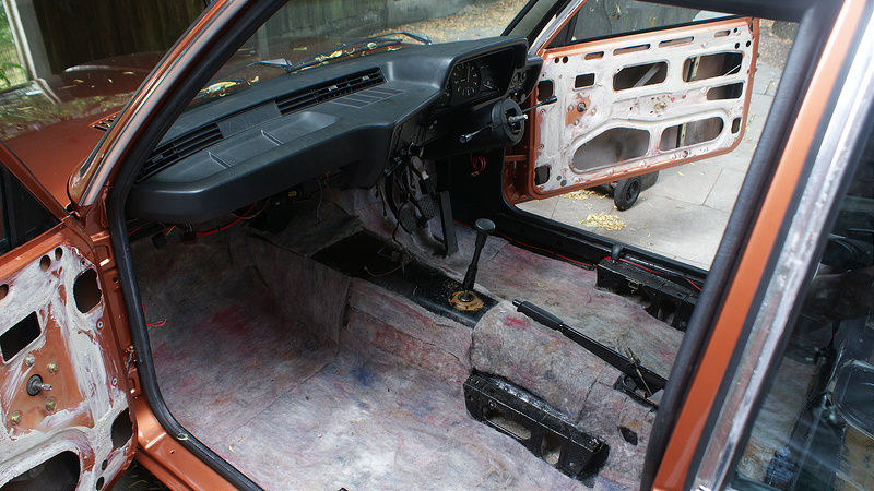

With all that done, it was time to do some "fun" work, in the form of carpets :)
Started out with a nicely underlayed cabin:
No progress shots, as there isn't much to see, and unfortunately these two photos are actually the best I have, shocking I know :(
Anyway, a good amount of carpet fitted:
Centre console is only mocked up for now, but it gives a good idea of how it will look.
Massive, massive thanks to Rhys and Jon, who put in a monumental effort this weekend to help out. They sanded the wheels. Hot, dusty, minging work, but they didn't give stick once, cheers lads :)

Looks ace so far, what carpet did you use? Links?
do you have any "modernisation" plans for the dash? iPod/phone dock/new radio/cd player etc etc
We've started wiring in a HU, which will be mounted out of sight (hopefully in the glovebox). Its very nearly drivable now, hopefully some bits will come this week ;)

Rob, He has no audio player what so ever. It was an option that wasn't selected on his, hence the new HU.
Scott, I know where he got it from, but I've no idea what shade its called. Its pretty much the same as the carpet in my E46, which is what he wanted.
From a place called Segals Motor Trimmings, just near Renault Manchester.
The carpet is called "Charcoal Schwarz" I swiped the last 2 rolls they had in stock.
http://www.segalmotortrimmings.net/
Very good bunch of guys in there, very helpful and clearly passionate about what they do. If you can't find what you need in there, it probably doesn't exist.
As for modernisation, as Jon said, it will have a hidden Bluetooth HU, allowing me to play music, while retaining the original dash.

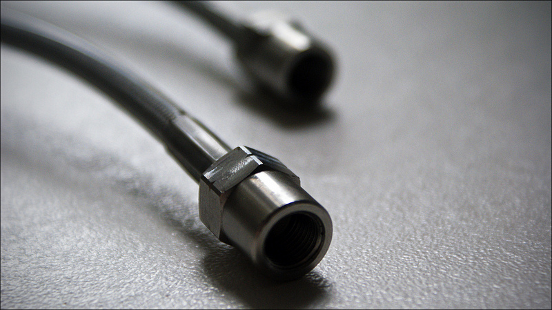

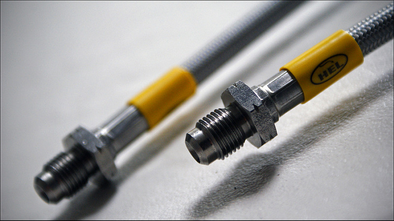

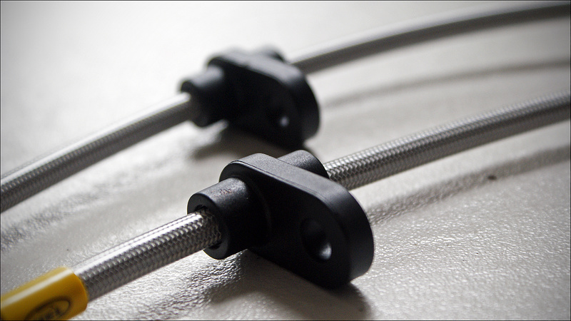

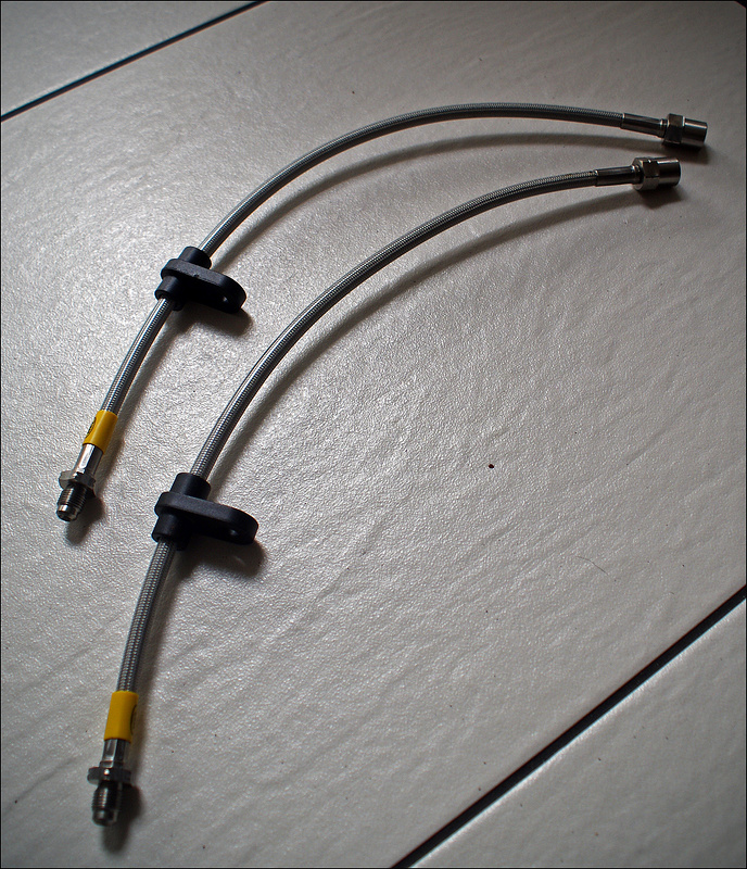

So my new brake lines arrived yesterday.
They're custom lines from HEL.
The quality of them is sublime, they really do look and feel like a very premium product.
Hopefully get them fitted this weekend.

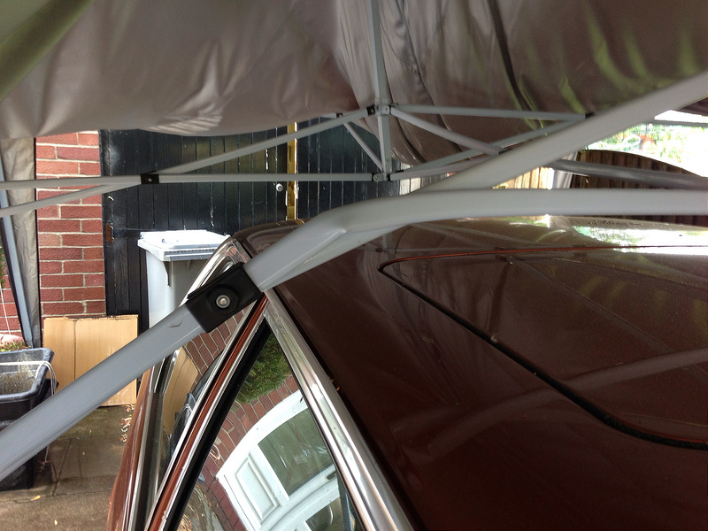

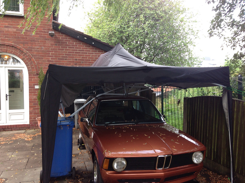

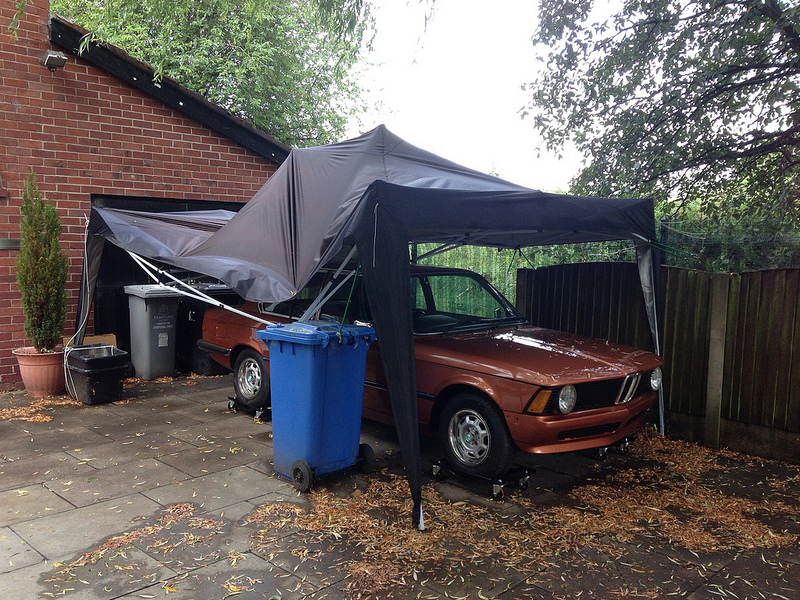

Today was supposed to be another mega productive day, get loads done and get the car close to being finished.

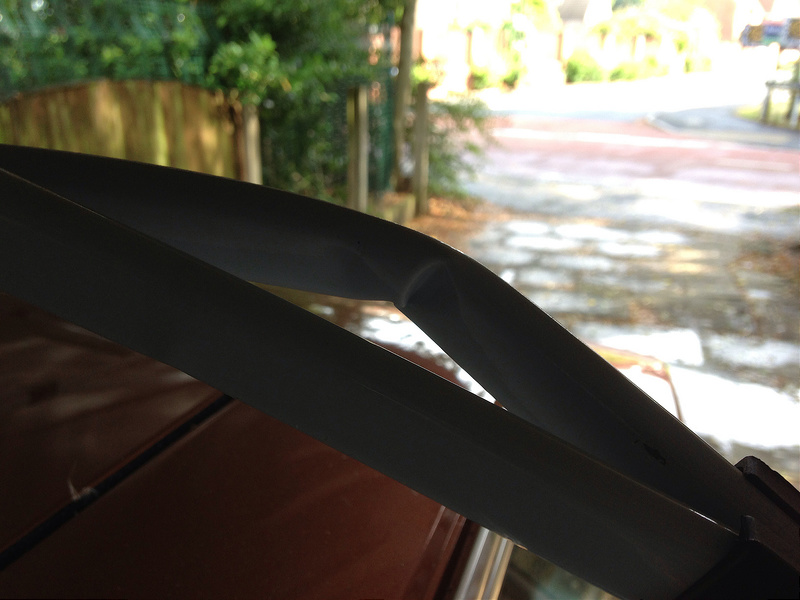

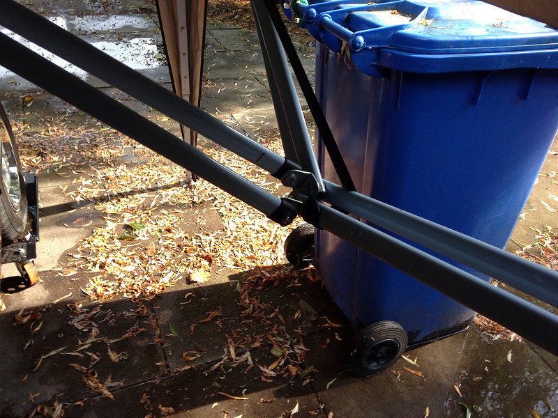

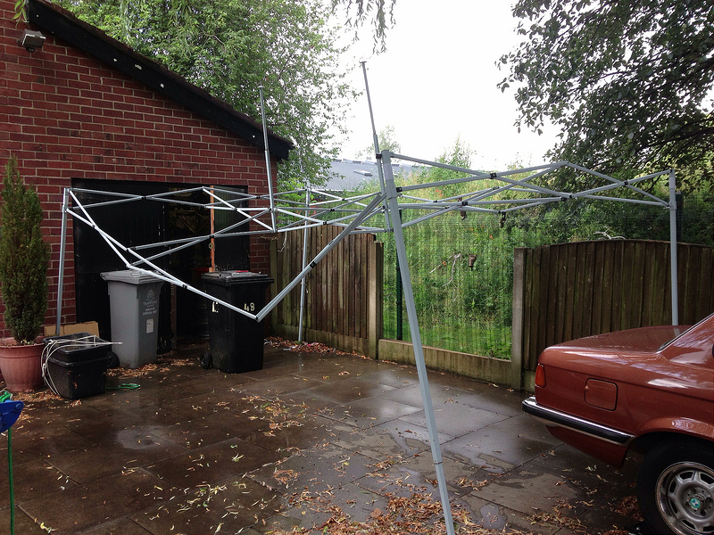

I came home this morning and was nearly sick when I saw this:
It had collapsed during some storms last night. By what I can only describe as a miracle, the car is completely unscathed. The BMW gods were feeling kind it would seem.
So the car is now open to the elements, a good test for those seals.

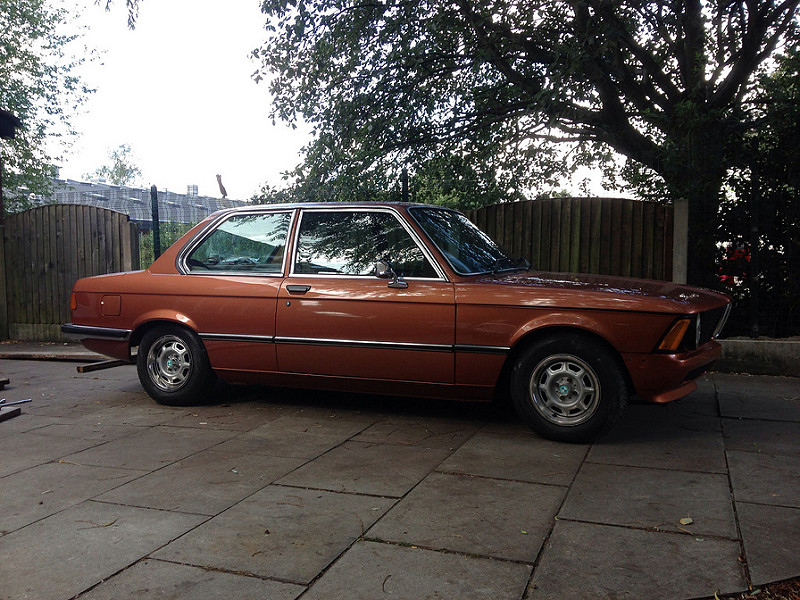

Dropped the coilovers all the way down at the front.
Here you can see the issue with lowering old BMW's, they don't go all the way down. So custom springs might be needed.
The rear needs playing with too, but it does look so much better for being lower.
