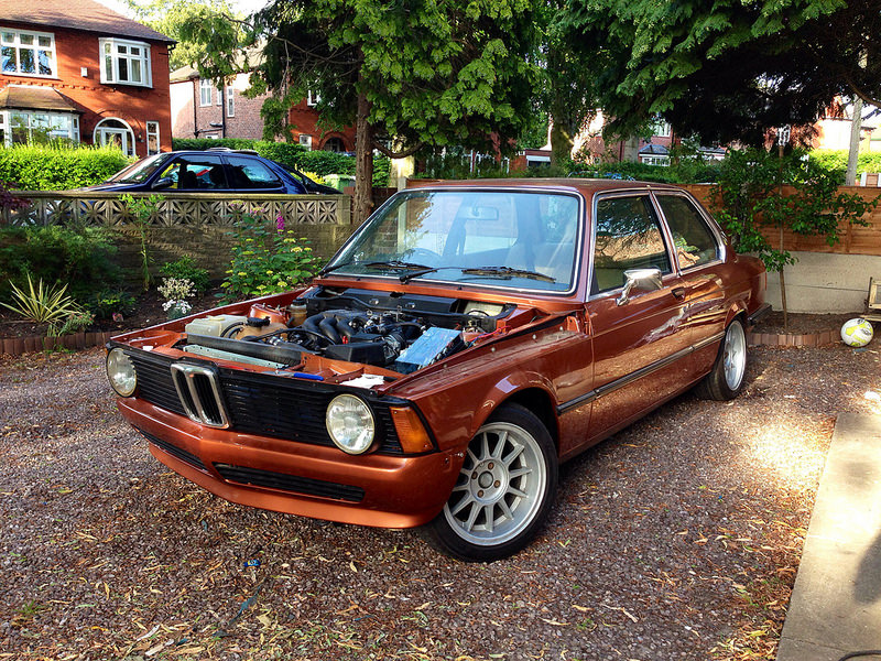

So the time has come to button the car back up.
Engine wise, I'm happy. Coolant system needs a bleed, and I probably should replace the 'blue plug' (coolant temp sensor for the ECU) but that's it.

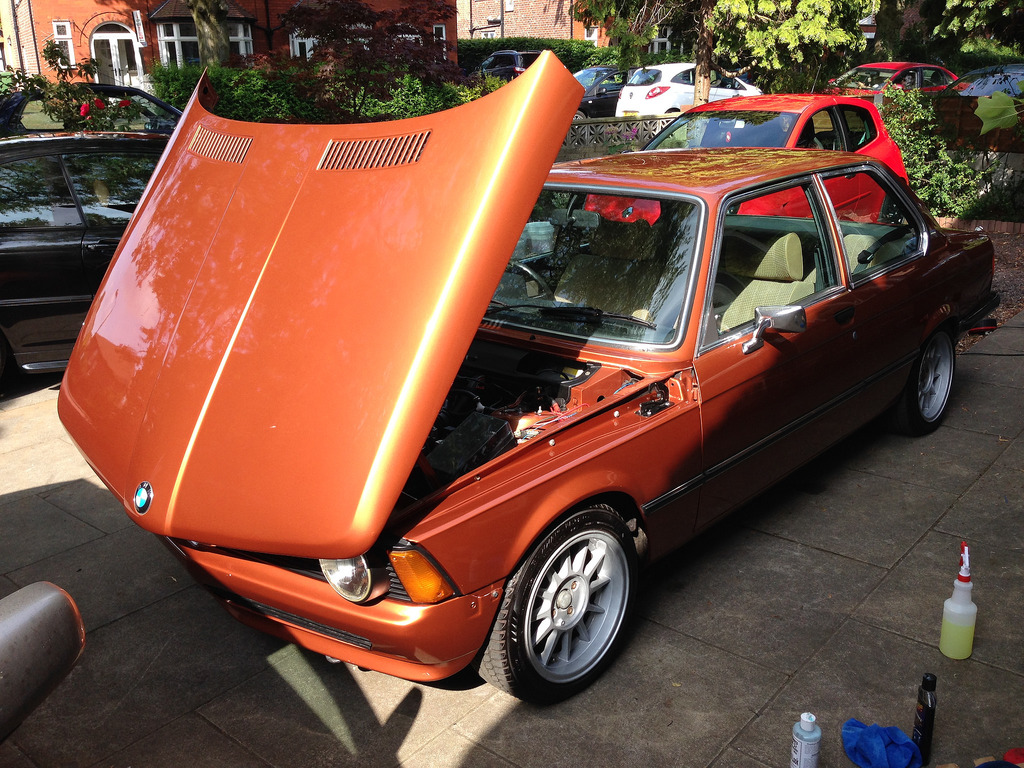

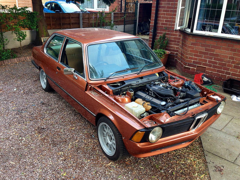

So yesterday I got loads done, it looks like a car again!
I really love how the engine sits in the bay, looks so at home and I think it really suits the car, appearance wise.
So I think I've got the cooling system bled correctly, turns out I do have a bleed screw, bad information led me astray. Anyway, I bled it how I understand to be correct, but time will tell.
So with that sorted, it was time to put it back together and it can finally become a car again!

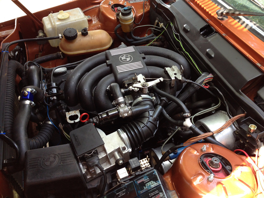

[/url]
Engine bay looks as tidy as it's going to get for now, I didn't want to wrap all the loom up yet incase it needs to be worked on. So for the first few hundred miles it will remain open, but zip tied up.

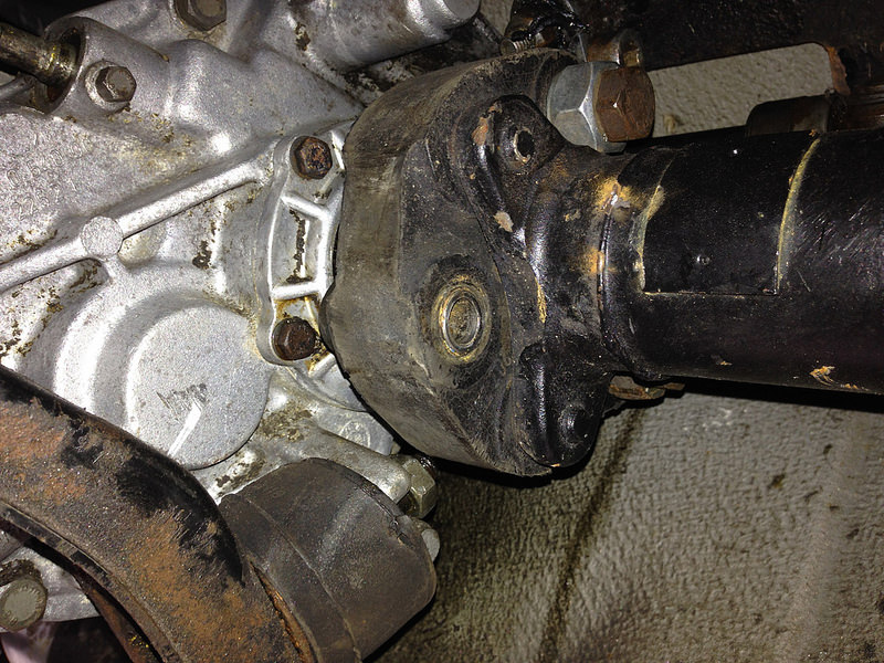

Also, on the motorway, doing about 70mph in 5th, I got a loud bang and a judder from the gearstick. A quick inspection under the car on the drive shows a some oil/moisture on the underside next to the gearbox. Needs further investigation as to what the bang actually was.
So I figured out what the bang was the other day, one of the nuts came off the bolt that holds the prop onto the gearbox. The bolt then wriggled its way out and departed at whatever revs I was doing. Understandably, it made a fair old racket!

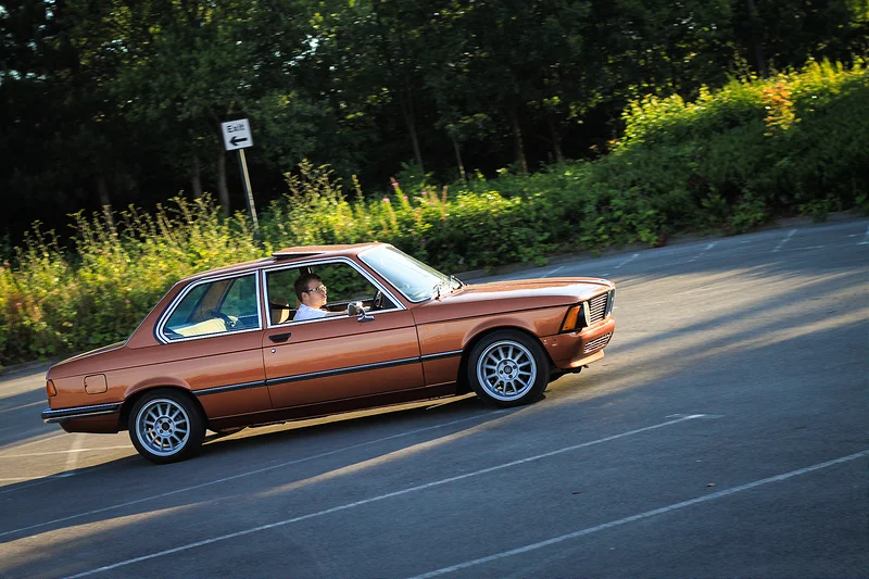

I did get a couple of decent shots on the 50mm from when I went out the other night though:
