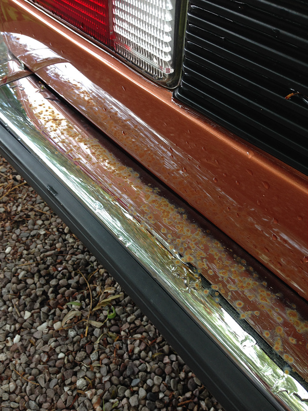

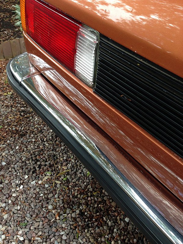

The chrome on the rear bumper was a mess and I wanted to tidy it up a little. A friend told me about a trick that utilizes Diet Coke (Diet to prevent stickiness from the sugar) and alluminium foil.
Essentially you pour the Coke on and gently rub down the chrome with some scrunched up foil. The results are fantastic.
Before:
After:
Of course the rust will come back, but I've sealed it with some FK1000p wax for now, so it should keep it looking fresh for a little while.

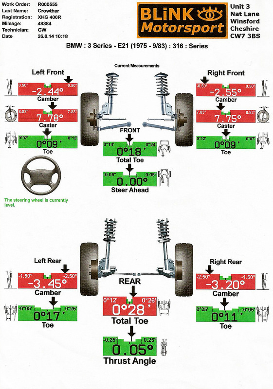

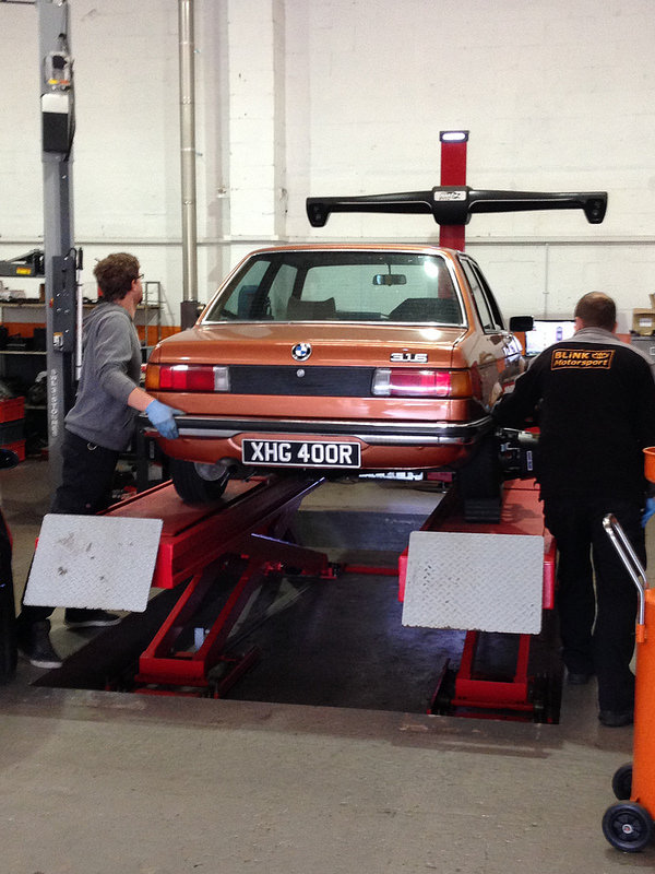

I also took the car to Blink motorsport for a full alignment. Very happy with them, they've transformed the car from a very nervous feeling thing, to something that feels very capable and really quite sharp.
The rear settings can't be changed as I don't have a slotted rear end yet, so that camber is a result of the lowering and nothing else.
Couldn't recommend them enough.

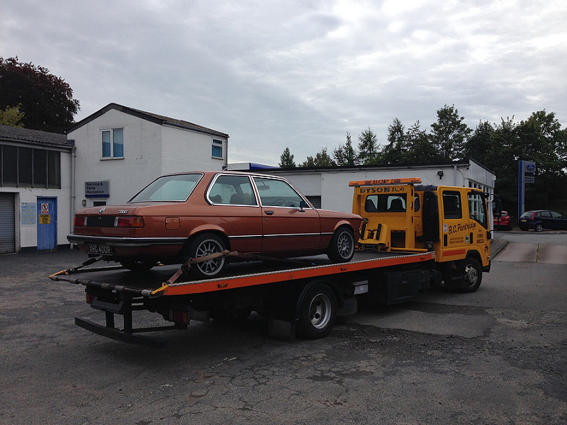

After brimming the tank, I noticed a pretty serious fuel leak. The culprit was the fuel sender unit, which should have a seal on it but doesn't. A simple fix and a new one is on order, but the damage was done, fuel all around the exhaust and fumes in the cabin made it far too much of a risk to drive, so I called my breakdown cover and they loaded it up and took it back to Manchester for me. Fortunately I was still able to go to the show, as the driver agreed to take the vehicle home for me without me going with him.
So it now sits outside venting off the last of the fumes, I'm hoping to have it all sorted and back on the road by the weekend.

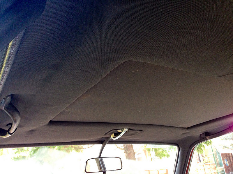

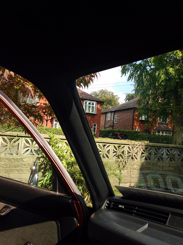

So today I made a start on the headlining, the material is charcoal grey, brushed nylon & foam backed. It's lovely to work with.
The pictures are awful as the colour isn't easy to capture in sunglight conditions, but you get the idea. It's not 100% perfect, but it's pretty good for my first attempt IMO.
I tired to keep the use of glue to a minimum, which I believe is the standard practice for the OEM headliner, so it's tucked into the door and window seals as per OEM.
The material is also used on the A-pillars:

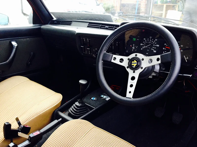

It now has a quick rack, which from the very brief drive I've had since fitting it, feels fantastic.
I have also fitted a Momo Prototipo, which also feels and looks great.

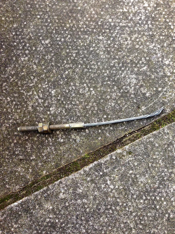

Rear brakes, essentially they're binding and the handbrake isn't up to scratch, which I found out tonight is due to a snapped cable, so I'll fit a new one this week. The shoes are all a bit gunked up, so I'll buy a new fitting kit, take it all apart and clean it and refit everything which will hopefully solve that.

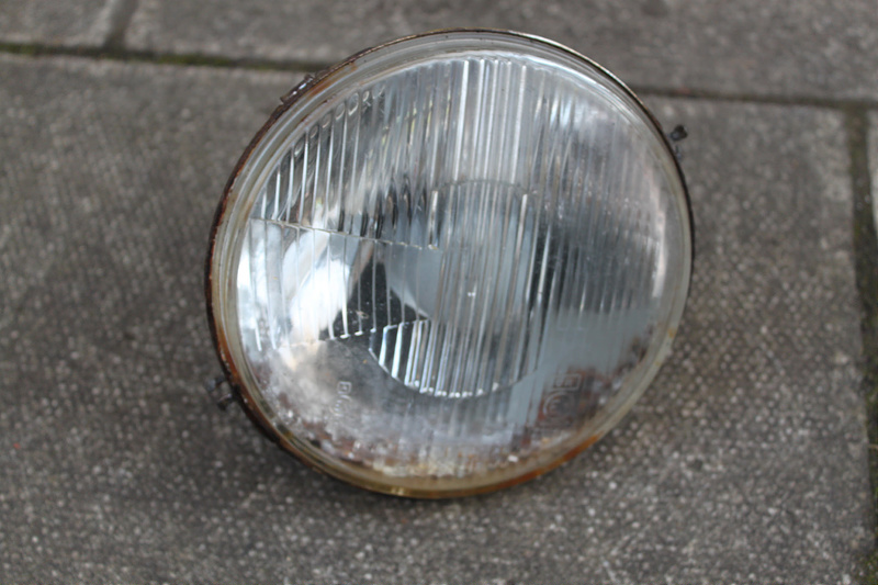

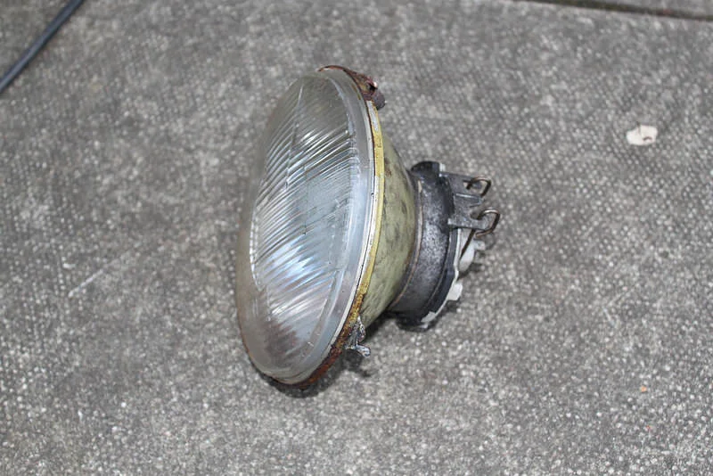

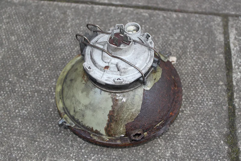

Headlights supposedly have some rust on the reflectors which has failed them, I had every intention of sorting them tonight, but it seems the glass lens doesn't "pop" off them like I thought it would? Anyone have any ideas?

With regards to the headlights, my mates dad just bought some updated units for his 1970's scimitar.
Not expensive and are a 100 times better than the old dates ones.

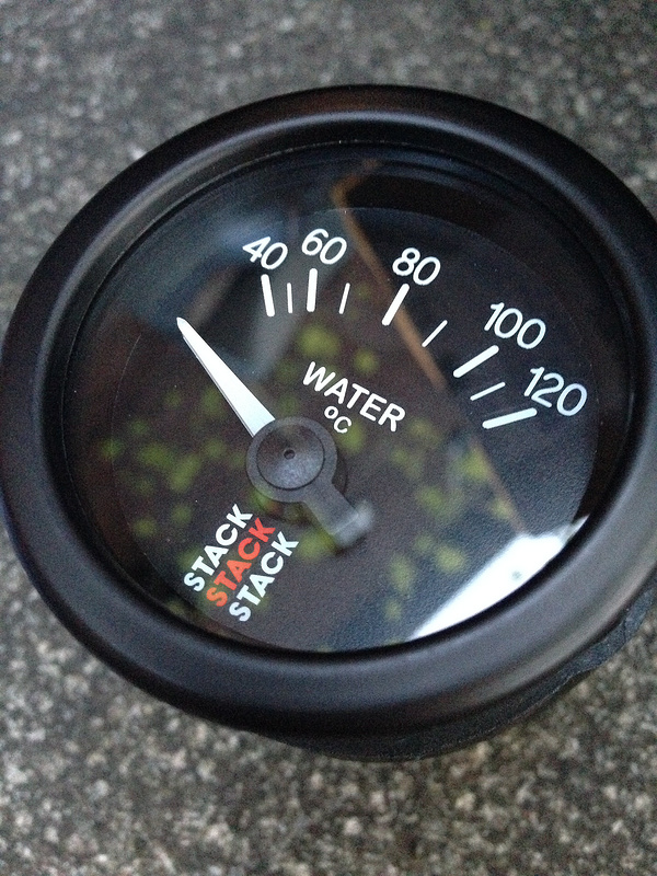

Coolant temperature gauge from Stack:
The car is slightly overcooling so I want to be able to monitor coolant temps (I've had a BMW with cooling issues before, and it's not much fun)

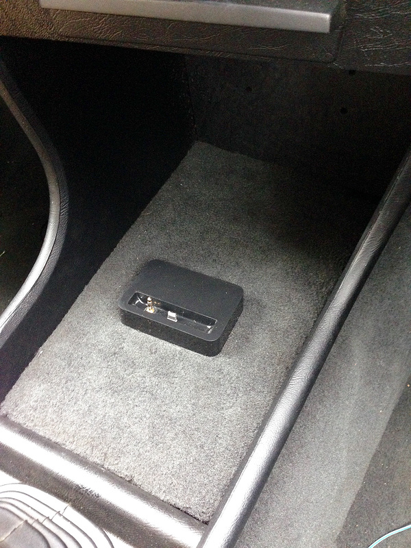

I also mounted an iPhone 5/5S dock to the centre console, so I can mount the phone and play music from it. All wired in and fixed in position:

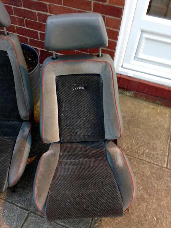

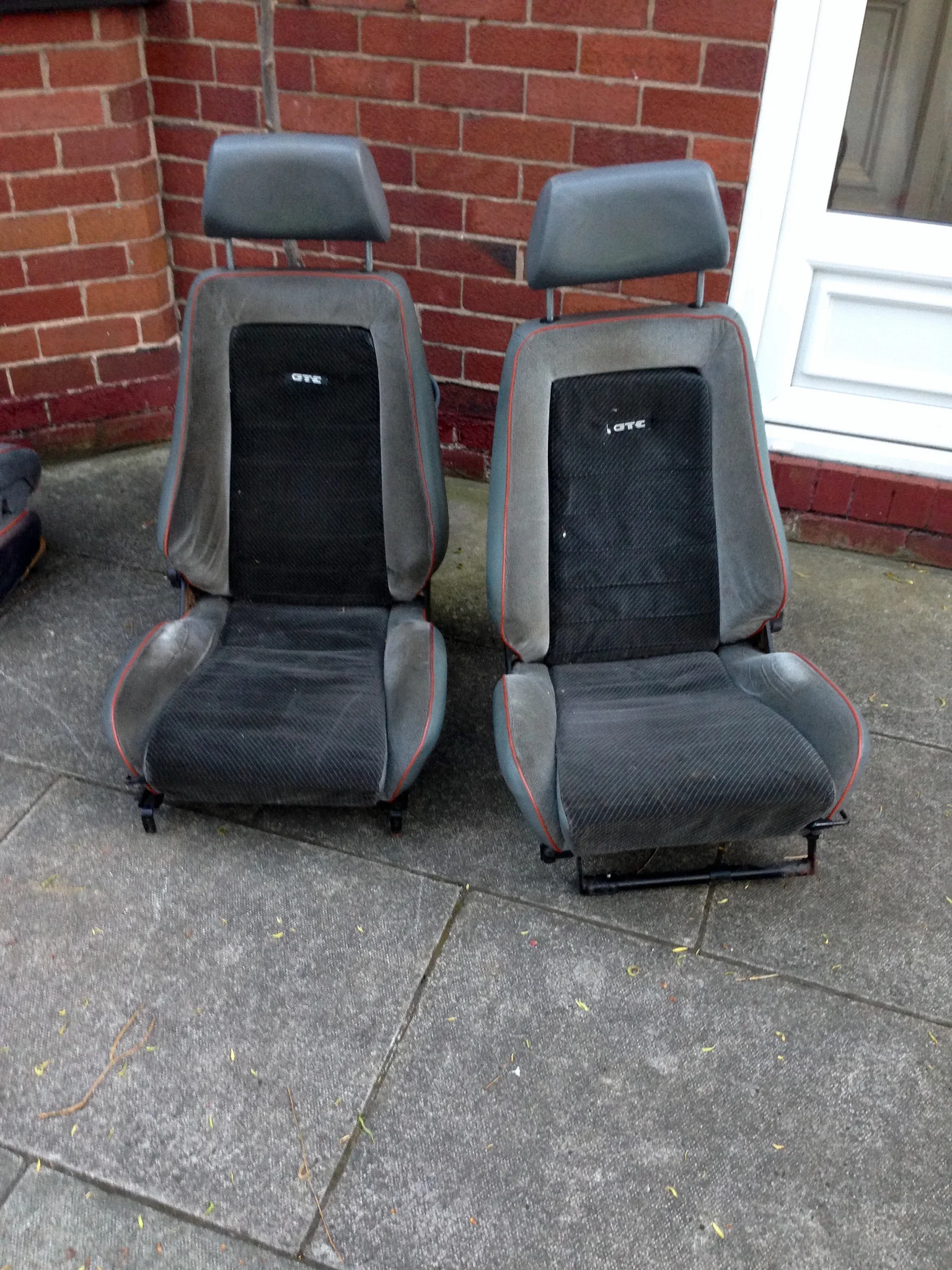

I also bought some Recaros. They're from an Opel Manta GTE and they need plenty of cleaning up before they can go in, but they were super cheap and they're nice to sit in. My interior will be getting wrapped up and put somewhere for safe storage, as it is spotless and I'd like to hang onto it.
I'll make some subframes for them soon and hopefully have them test fitted soon.

New seats are coming along nicely, my design for the subframes is a little bit awesome, but I'll wait until they're in properly before I touch on that too much.

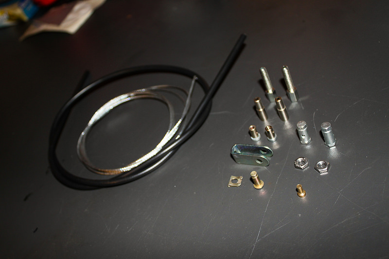

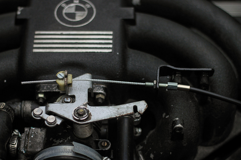

So the time had come for a new throttle cable, the old one was a bit of a bodge and I really don't know how it lasted as long as it did.
Anyway, got all the parts I needed from Venhill:

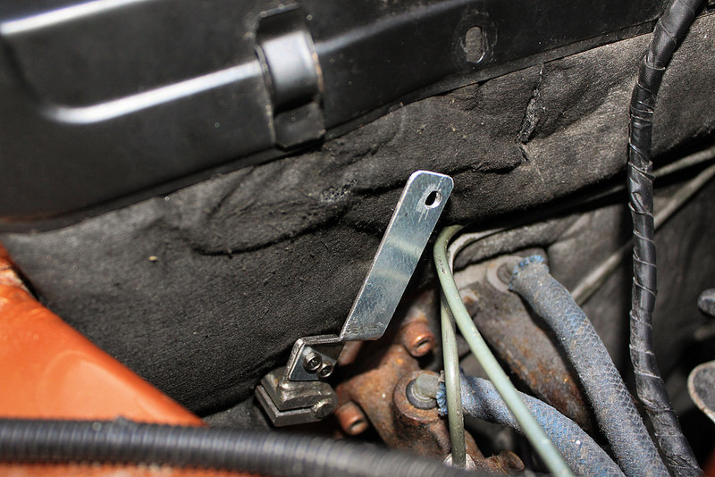

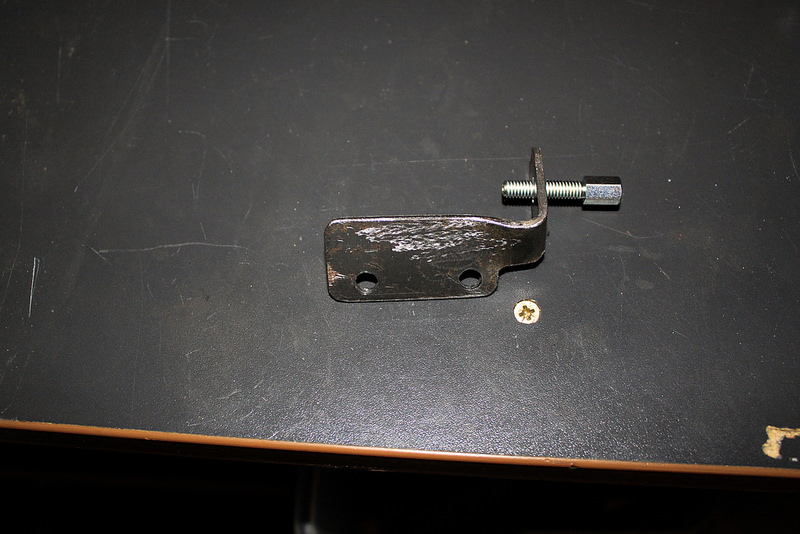

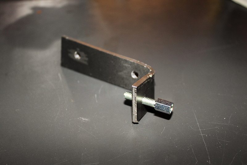

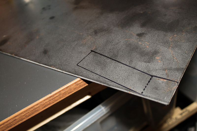

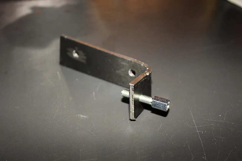

Needed to make 2 new brackets in total, as I wanted a good amount of tension adjustment in the cable, first bracket being cut out, bent up and a thread putting in:

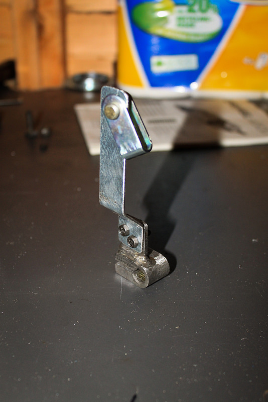

Next up I needed to modify the throttle arm, as it was fouling on the sound deadening I have fitted, so the pedal was struggling to return correctly. I didn't really want to cut up the sound deadening, so I made some basic changes to the arm itself:
This "kink" allows the arm to move freely. I've also included a hole for the clevis pin to attach to the arm.

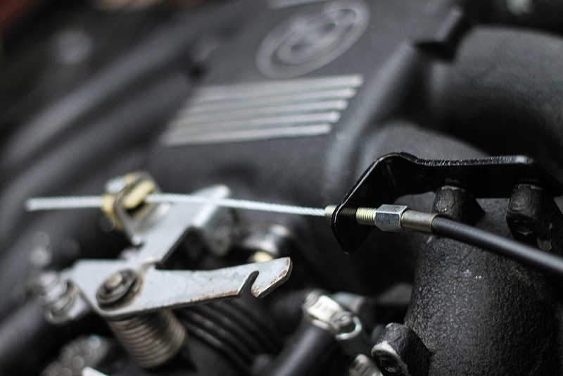

Third bracket made, which picks up on two points on the inlet manifold:

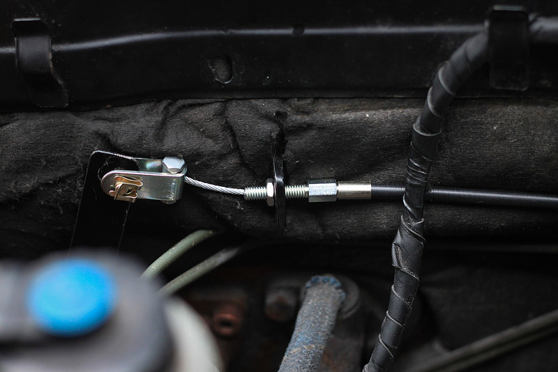

And finally some photos of the brackets painted, fitted and the cable all finished:
