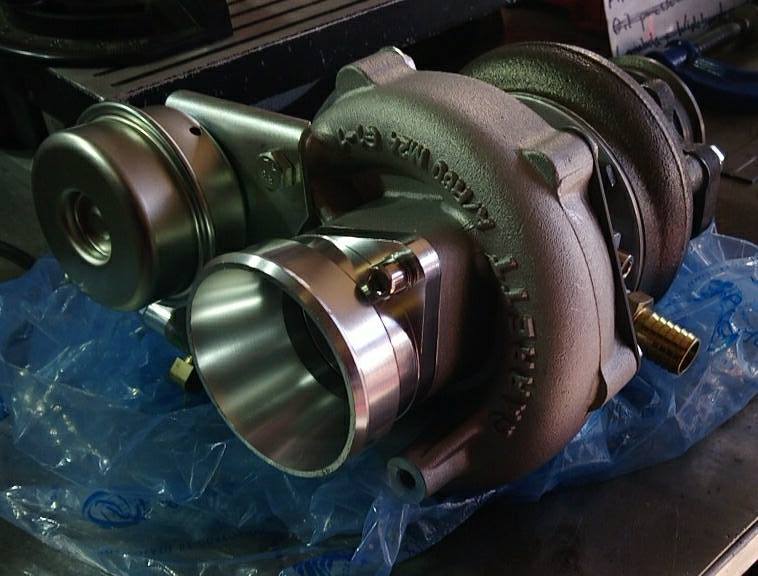

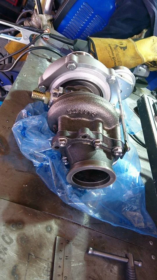

I spent the first few months of ownership getting it sorted out and making it drive properly again... then the next 4 years slowly replacing pretty much everything that could wear out. Around the 4 year mark I started thinking about new cars but couldn't really come up with anything that I really wanted to buy, so I decided to turbo the Clio instead. I didn't bother with a kit as I'm a reasonable fabricator and pretty handy with the TIG, and I wanted some slightly nicer bits. It ended up costing a little bit more, but I've got something that works really well on low boost and will be perfect for when I want to go forged and turn up the boost a bit. She's not the cleanest car on the outside, but she's a bit of a weapon and a hell of a lot of fun to drive.

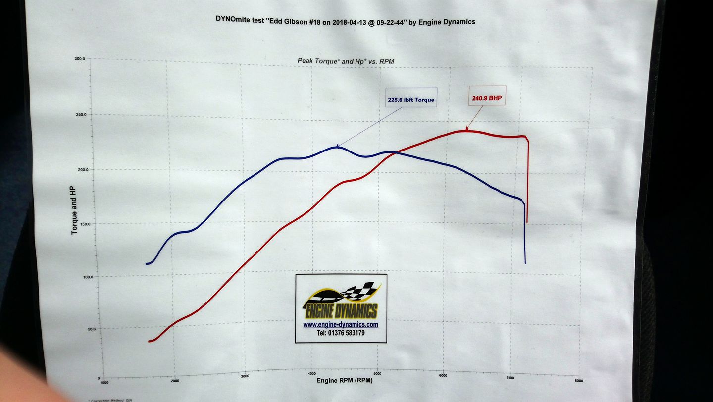

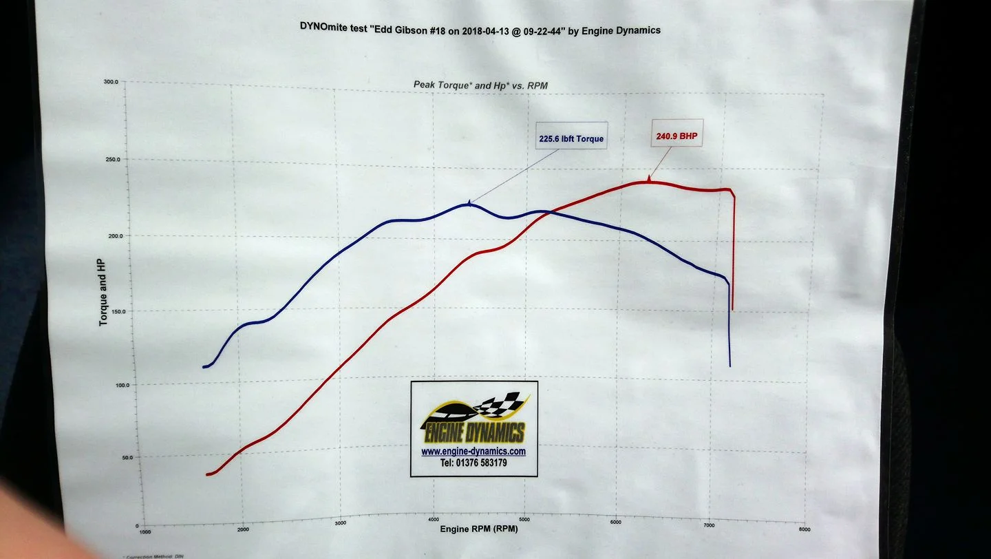

241bhp / 224ftlbs - Mapped by Engine Dynamics

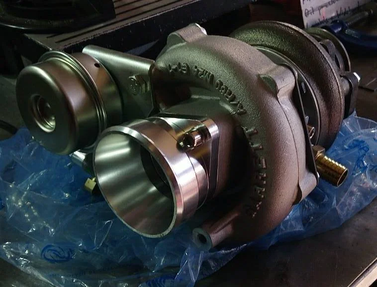

Garrett GT2560R running around 0.5bar

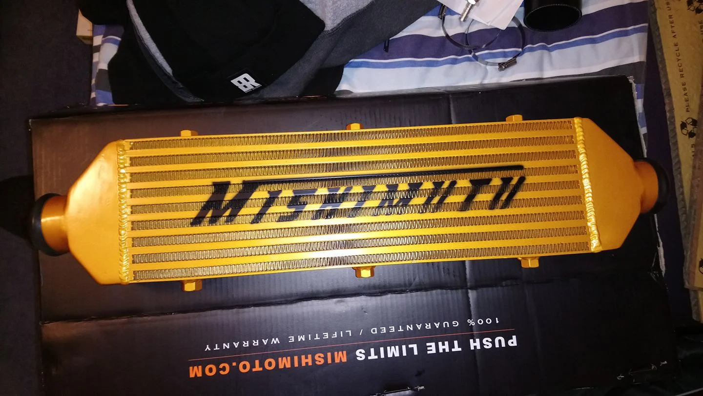

AEM FIC 8 (with MAC boost solenoid for boost control)

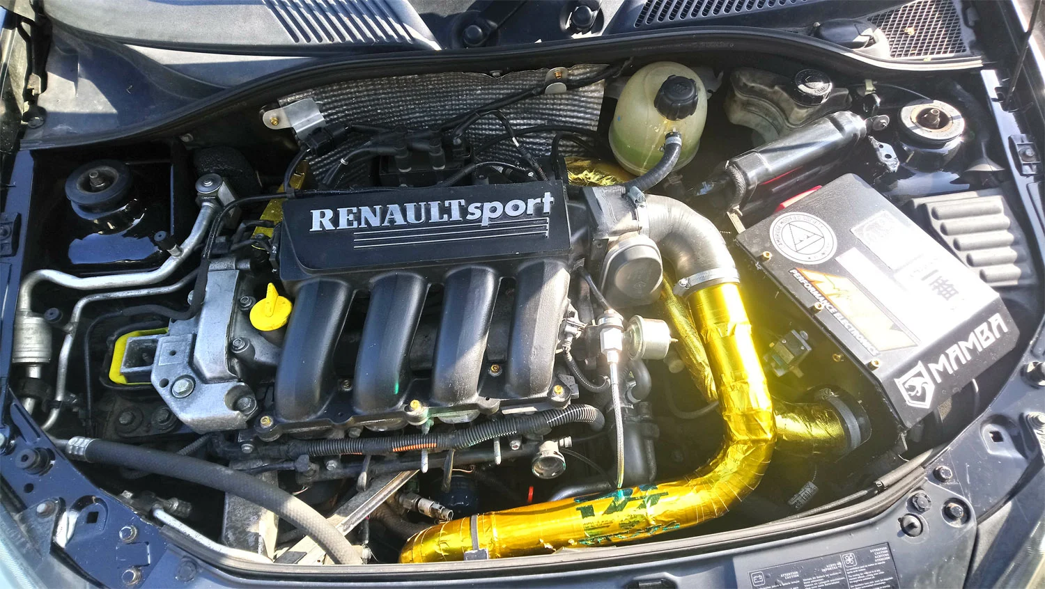

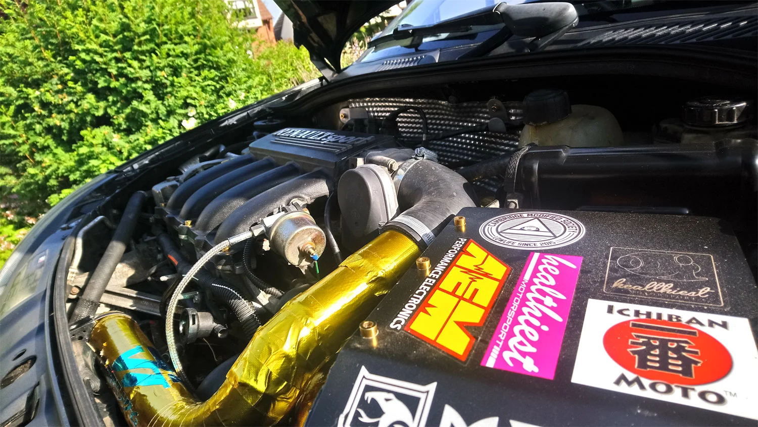

Homemade boost/intake pipes (aluminium, mostly 2.5 inch with a small bit of 2.25)

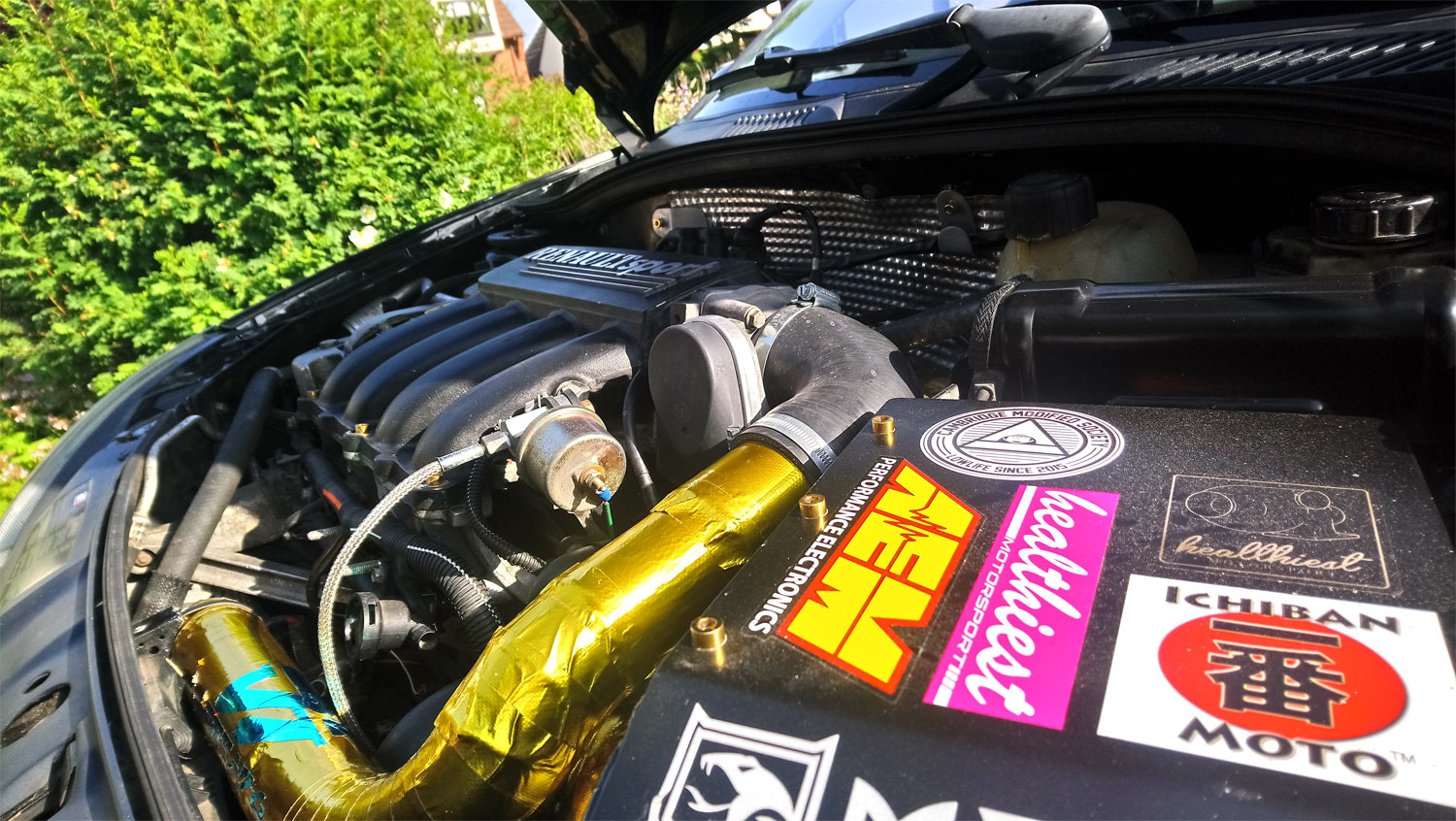

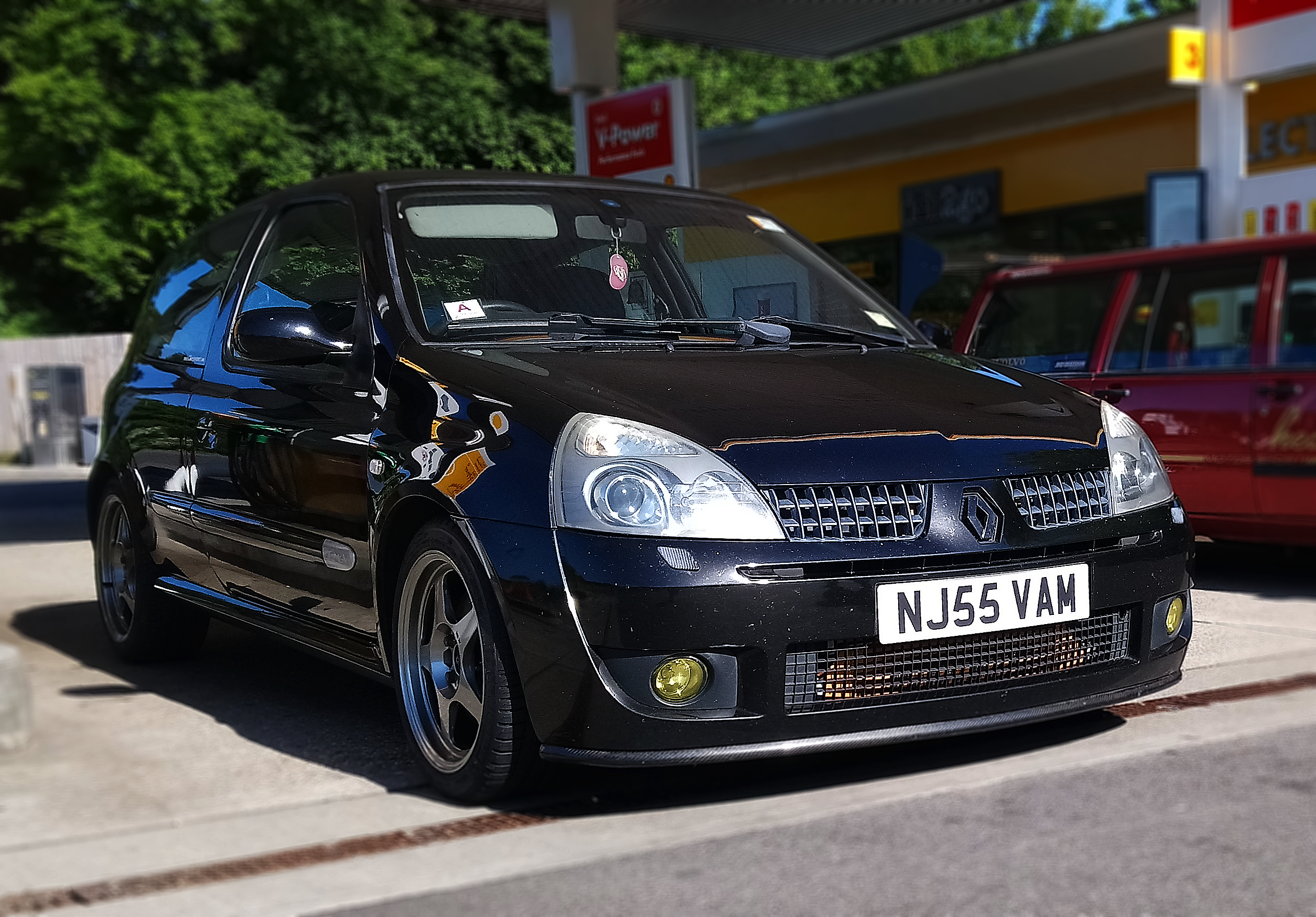

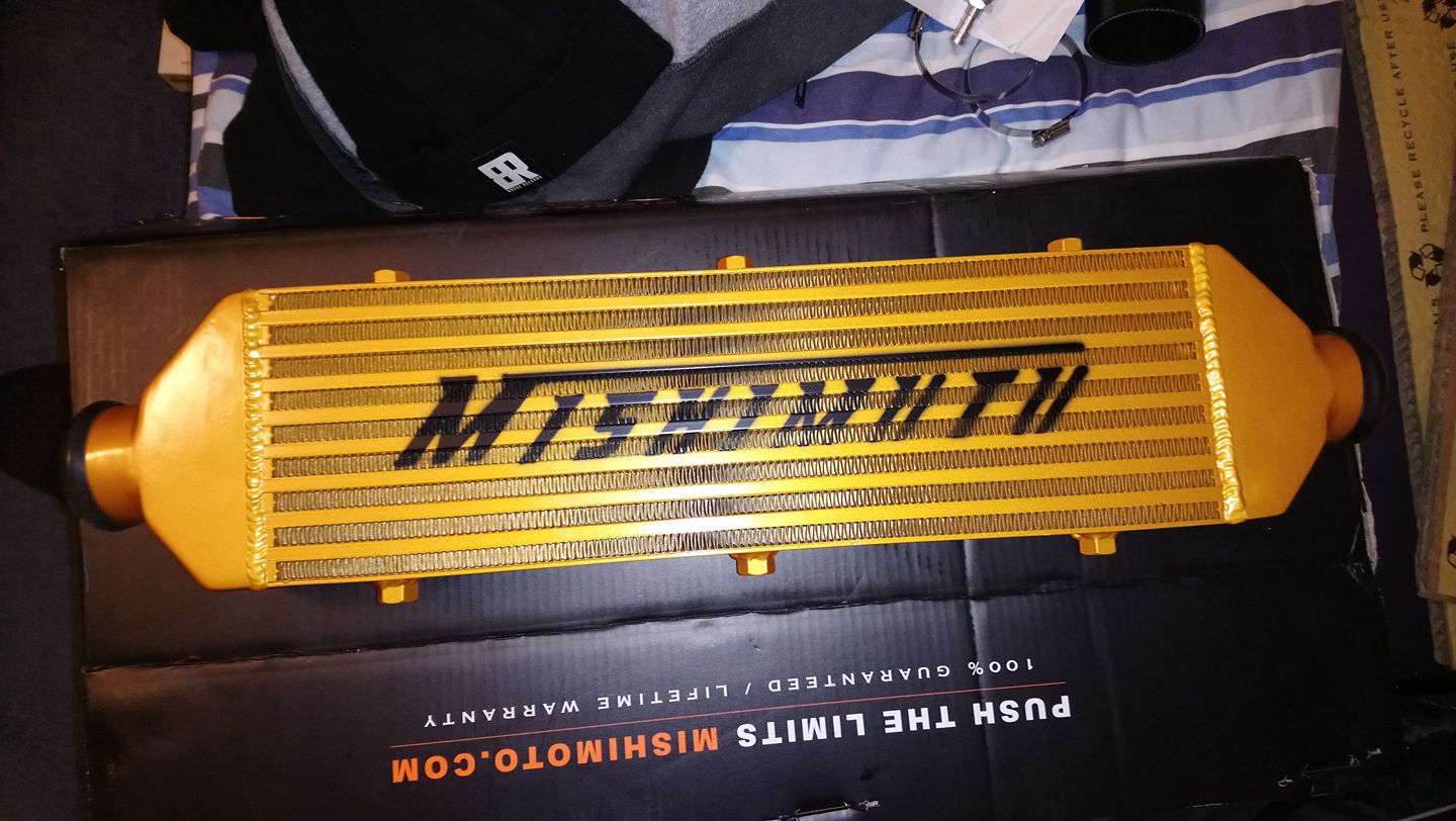

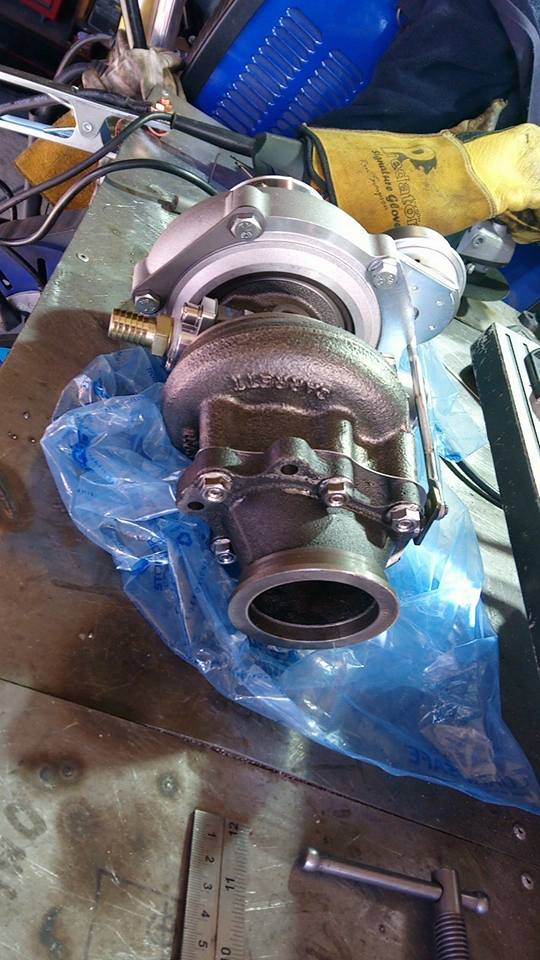

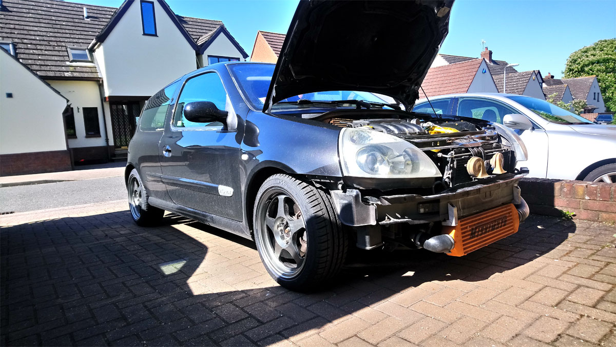

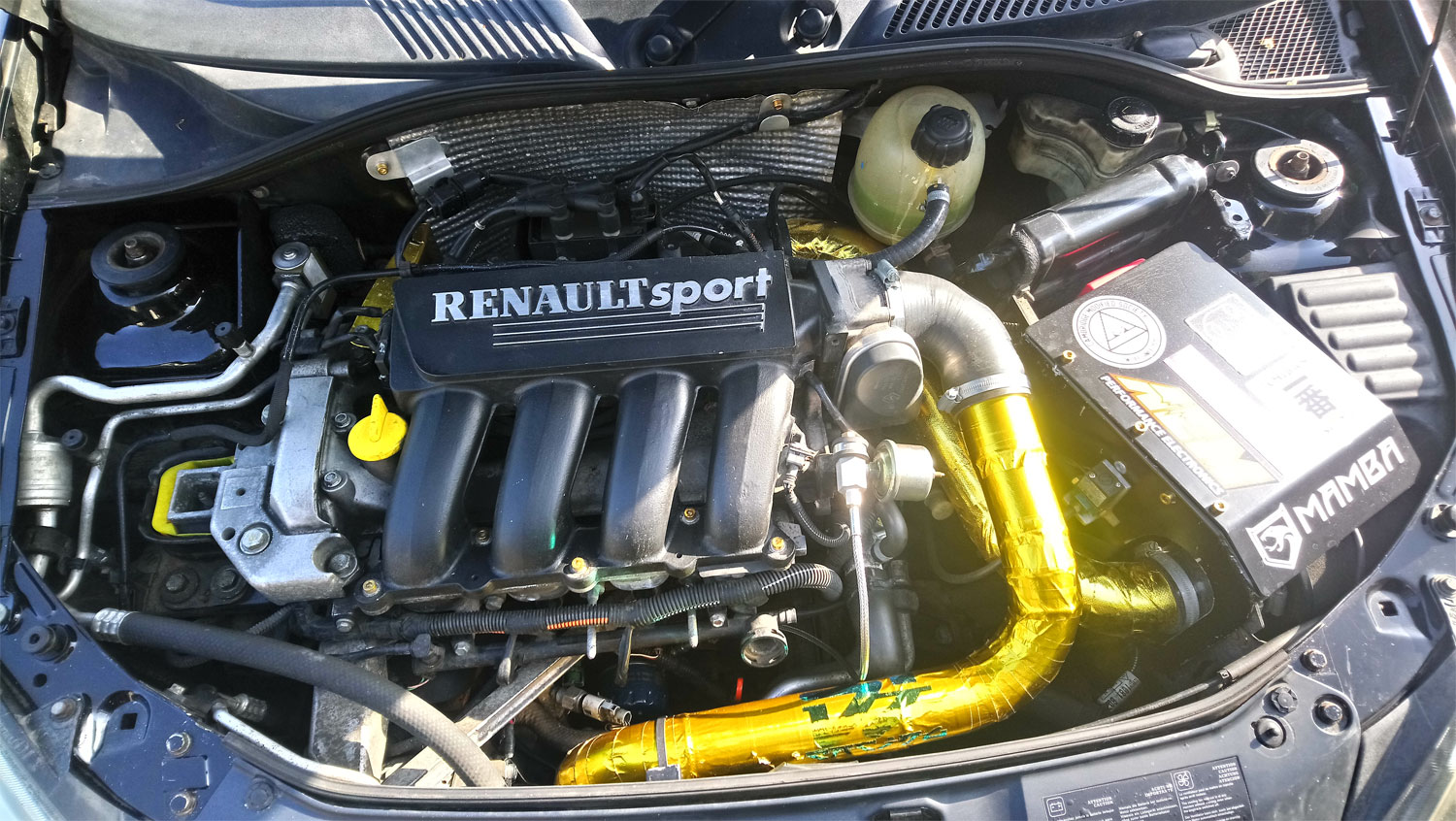

Here's a few photos....

Mishimoto intercooler
