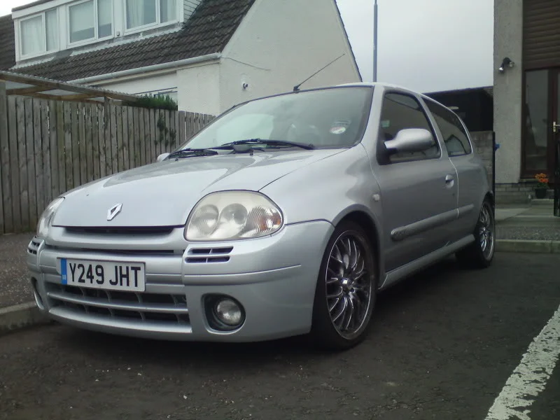

Not again. I sold the flamer back to Djw John after owning it for 2 full years, the longest i've owned a car. I Sold up as the little ones car seat didn't fit in and i wasn't really using it for the last 6 months i had it, i also wanted to change scenes after being into clios for 8 years.
But after a run out in the Flamer and a few plays in awesome stus awesome 72 i had to get another. It had to be cheap and that was about it.
So here she is, project chav. Horrid chrome wheels, shocking lowering springs, countless dents, shoddy interior, 4 fault codes, no service history, that exhaust and some shocking nocking from the front end.
Plans: going to compression test it and see how healthy it is, get it running and go down the fast road/track day route i did with my converted mk1 Ph3. If its i cant get it running healthy i'll break it.
Thanks to John who drove it back from Dundee for me and thanks to Stu who found the ad, dealt with the boy and came up to help collect it on the day too.
Be nice! :quiet:
It not that bad, its pretty bad though. underneaths ok, it's had a hard life though.
My mum wants the chromes for her Micra lol
Shed ;)
I'm sure you'll save it though mate.
Looks a beauty ;)
I don't think the wheels look that bad :/
/flamesuit
Sometimes i kinda like the wheels. But they have got to go, i'll keep the tyres as spares for my Mk4 golf and either ebay the wheels or take them to Daltons.
Seen a lot worse tbh :)
I've taxed alot worse tbh sanders.
Shed ;)
Thanks mate, i'll either save it or kill it.
base for something great! ..if its healthy definitely track it
if the price was right, then bargain, good luck fella, love these models of clio, best shape ever made :)
Cheers guys, it was a decent enough price, if it's healthy i'll proabaly end up rolling it at knockhill.
If i'm being honest I don't think that looks that bad at all, apart from the steering wheel + fart cannon
I hope it was cheap!
Not too bad though in fairness!
Cheap enough.
A genuine 'lol' at the steering wheel. its excellent.
Yeah the wheel is lol worthy, but its a better size than standard.
Brilliant wee car ;) Defo a bargain at 1750! :eek: :)
Yeah i though 1750 wasn't too bad. But people will obv say its too dear etc etc.
The pics make it look better than it really is. Fart cannons quailty gold man, innit.
Dave you need to get pics up of the door badges! ha
Ahhhh the 1 off door badges. brb.
I went to look at this buddy, couldn't justify the work that i felt was needing done. How much did you get it for if you don't mind me asking?

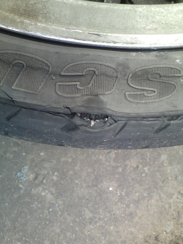

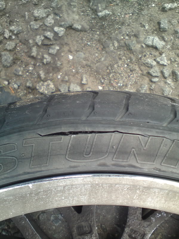

On closer inspection we found some really bad cracking/buldging on the inside of the tyre, john did mention this when we looked at it but i thought he meant the tiny crack in the outside side wall. Not these shockers on the inside!
Sorry for trying to kill you. x

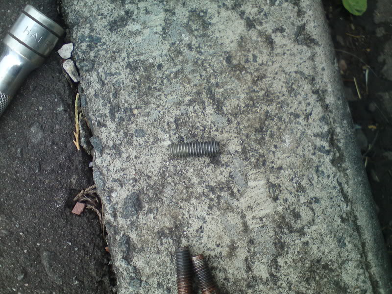

Back onto the checks. I said from the start that if it's healthy i'd track/fast road it, if it was a lemon i'd strip it and weigh in the shell. A check with the compression tester showed that cylinder 1-4 were all constant at 11bar/160ps so very happy with that, a further check also showed that one of the 4 fault codes was for the idle control valve. This not being plugged in had somthing to do with it, the previous owner had trapped it under the inlet when changing the plugs recently. With that plugged in its deleted that code off the reader. Knock sensor and O2 sensor being the other codes. I also removed a broken stud from the inlet, new bolt required there.

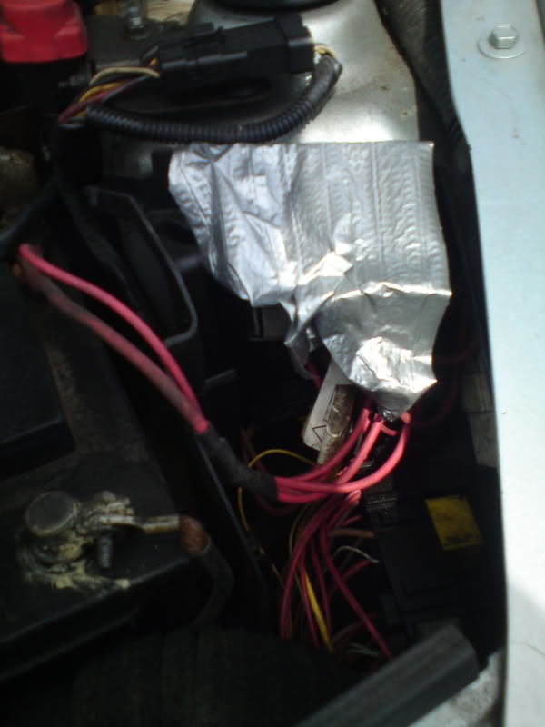

Few other issues that we've found are a missing fue box lid.
Note the gaffer tape fix (not our handywork it must be said)

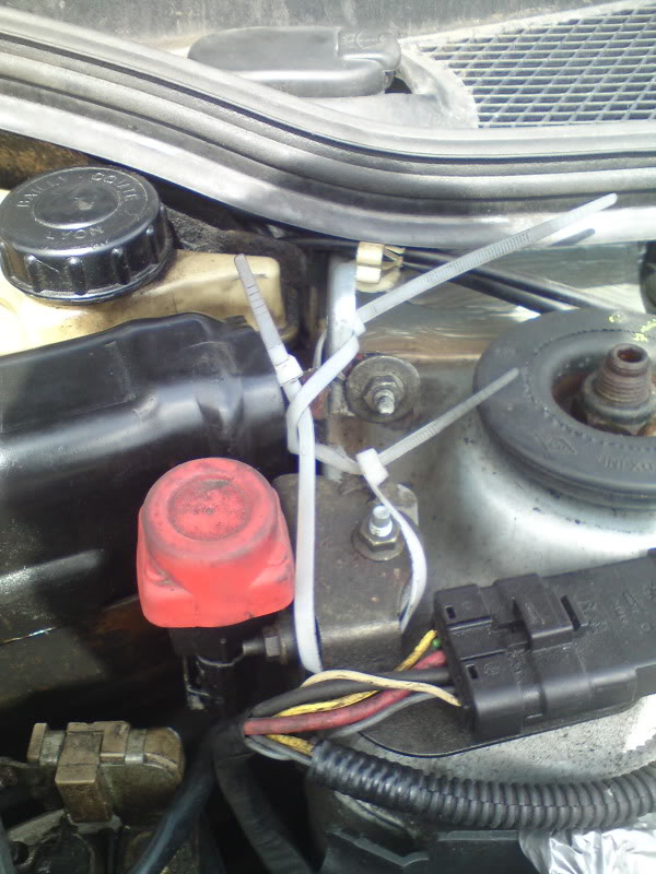

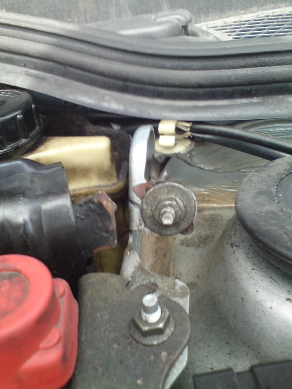

and a broken mount on the cage for the ecu, which was quickly bodged back together with cable ties found in the car.
It'll stop it rattling around till we can fix it properly.

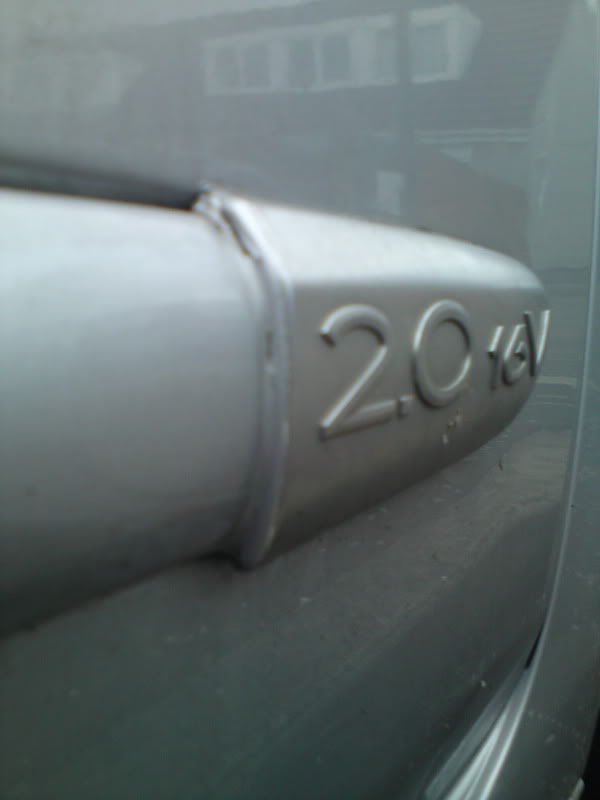

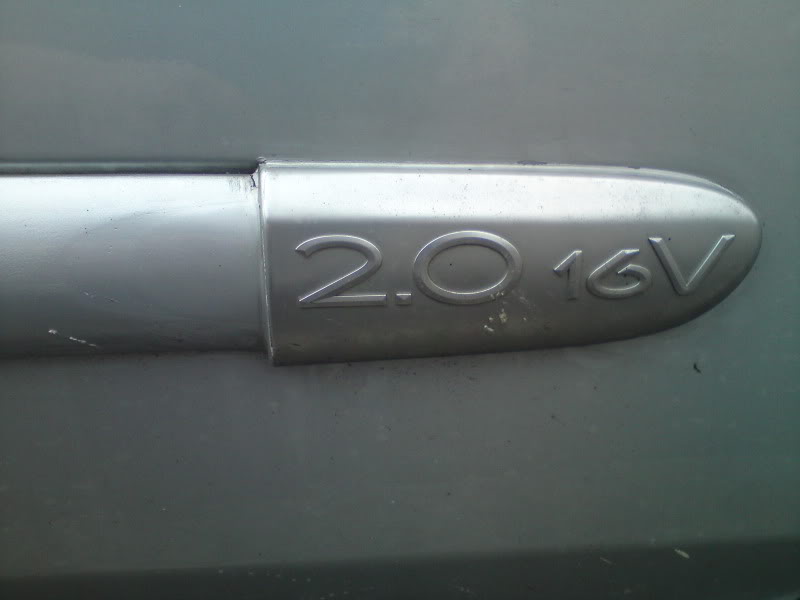

Also as stu has mention its got some pretty special door strips, with the original holes smoothed off and some ph2 badges glued on, really not sure why they didn' just swap for the full ph2 set up??
